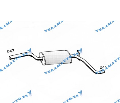

    Another possible option would be this as my rear silencer comes from a montego 2.0 lxi
    reference
    Intermediate silencer Austin Montego 2.0 - HL, Mayfair, Vanden Plas, Family 1994 cc, 102 Cv from 1985 to 1991
      If you use the first one, with the 47mm outlet, you will need an adaptor for your smaller rear silencer....but it would mean that you could fit an efi rear silencer later and have the bigger pipe all the way, which might be better. The second one, with the smaller outlet would go straight onto your pipe, which would make it easier to fit now...depends on your plans in the future I guess....
        My rear silencer has an inner diameter of 45mm. which will adapt properly?
