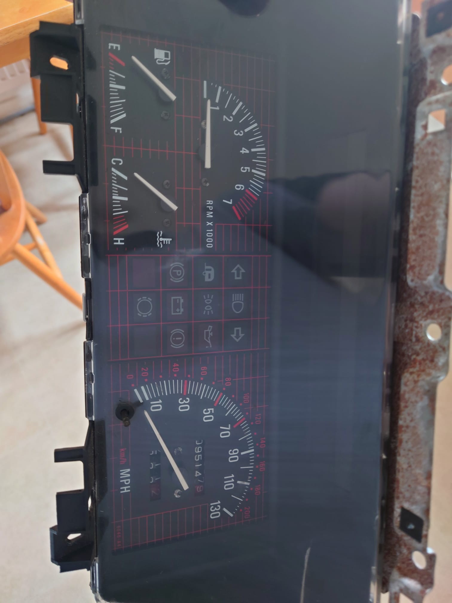

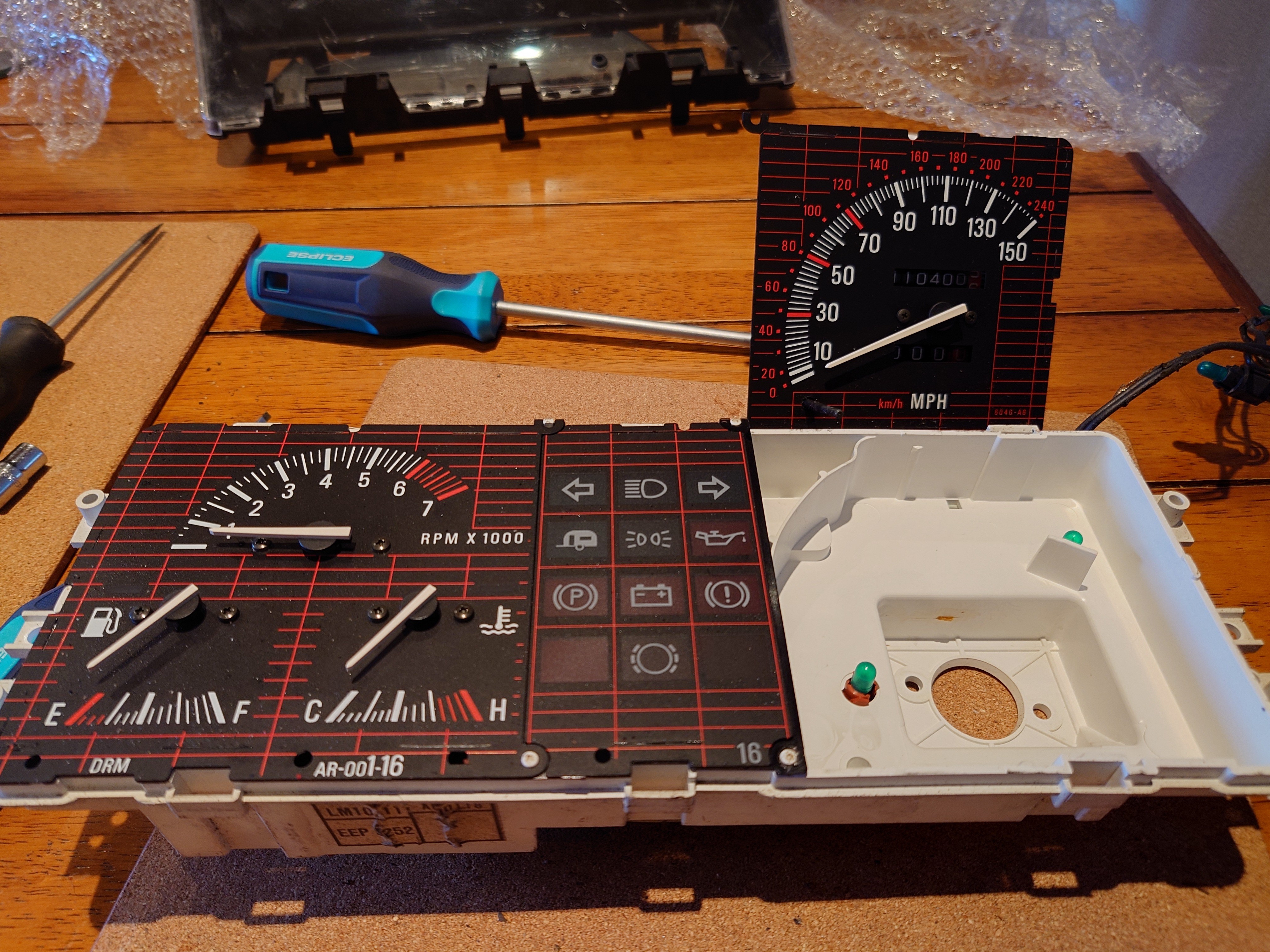

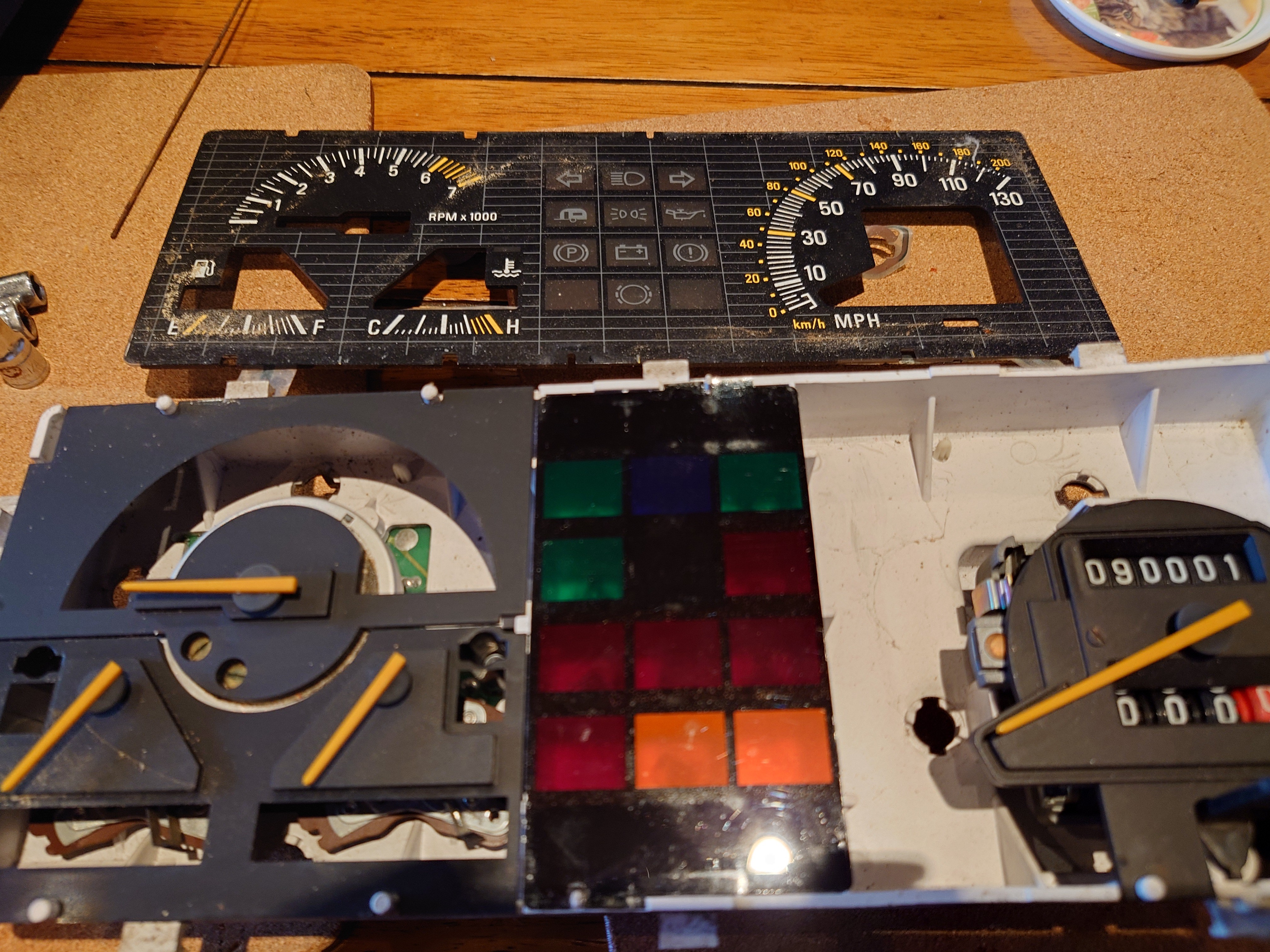

    • Back on this as a bit of time. Stripped down an old early efi dash to find out how easy they are to rebuild but found major differences in the existing and possible replacement. I have now found an efi from an old mate the same year so will swap over the mileometer and try that when I pick it up. The existing may have a faulty temperature gauge as it doesn't work properly and I've changed all else so this would be the last thing to try. Doesn't worry me about the crack and broken clear plastic as the existing is good

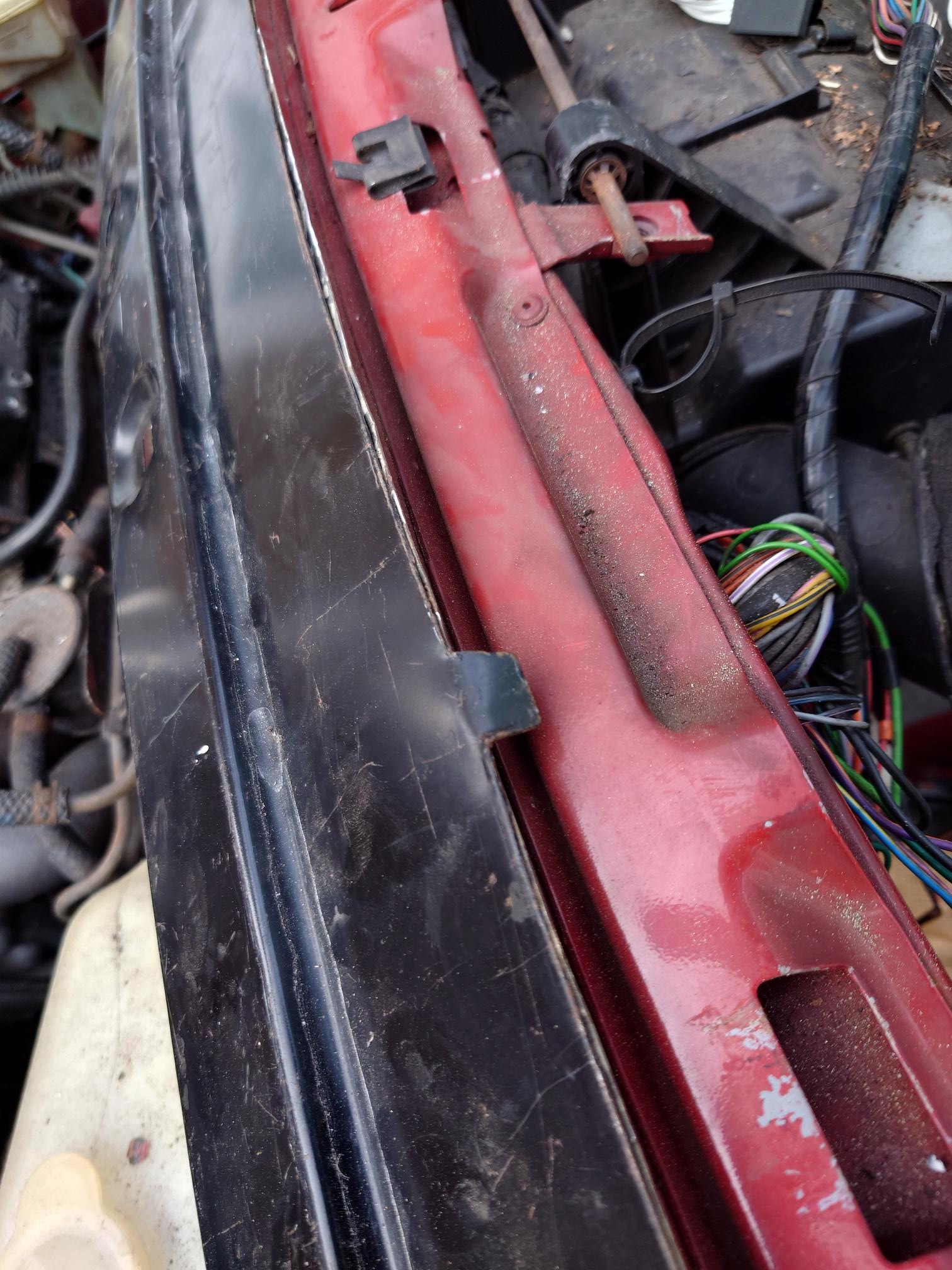

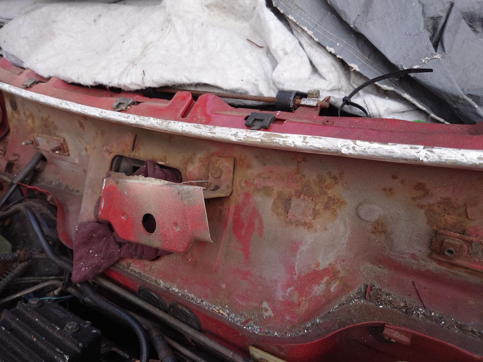

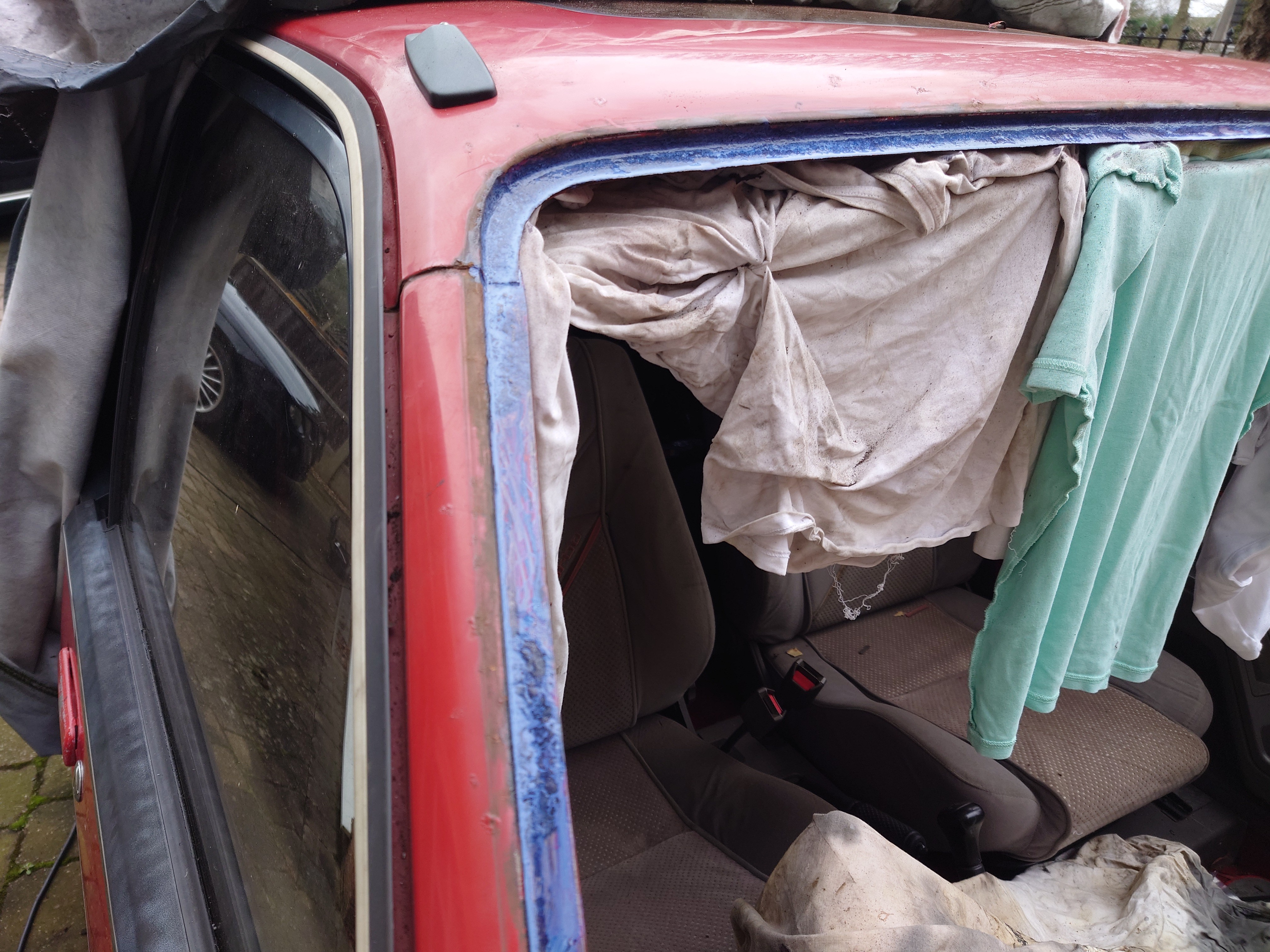

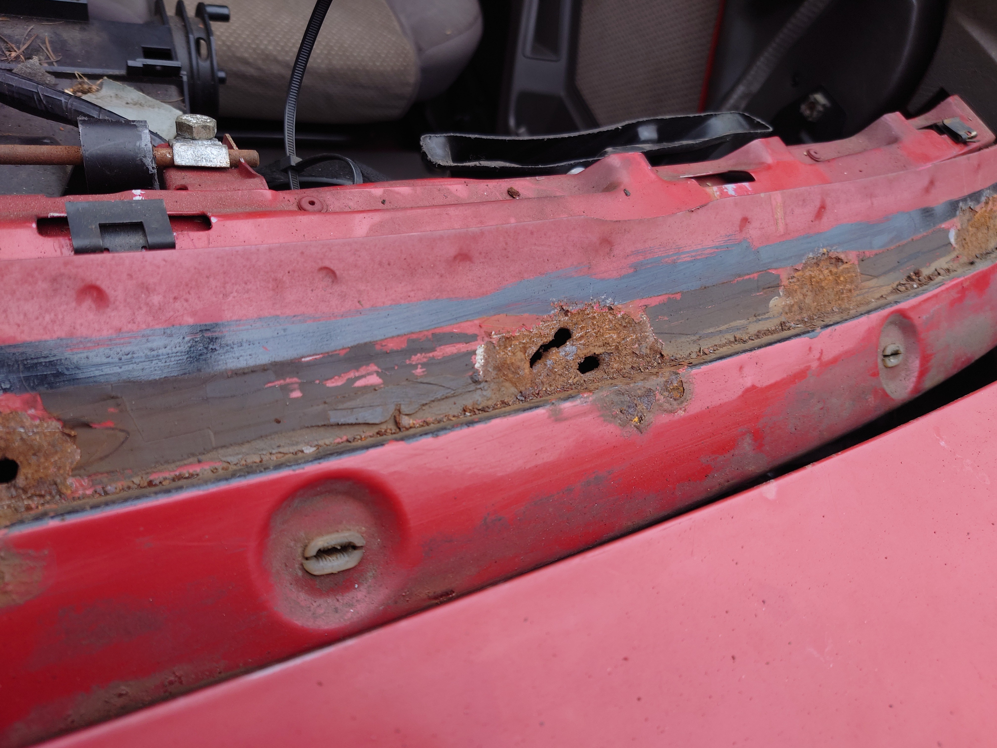

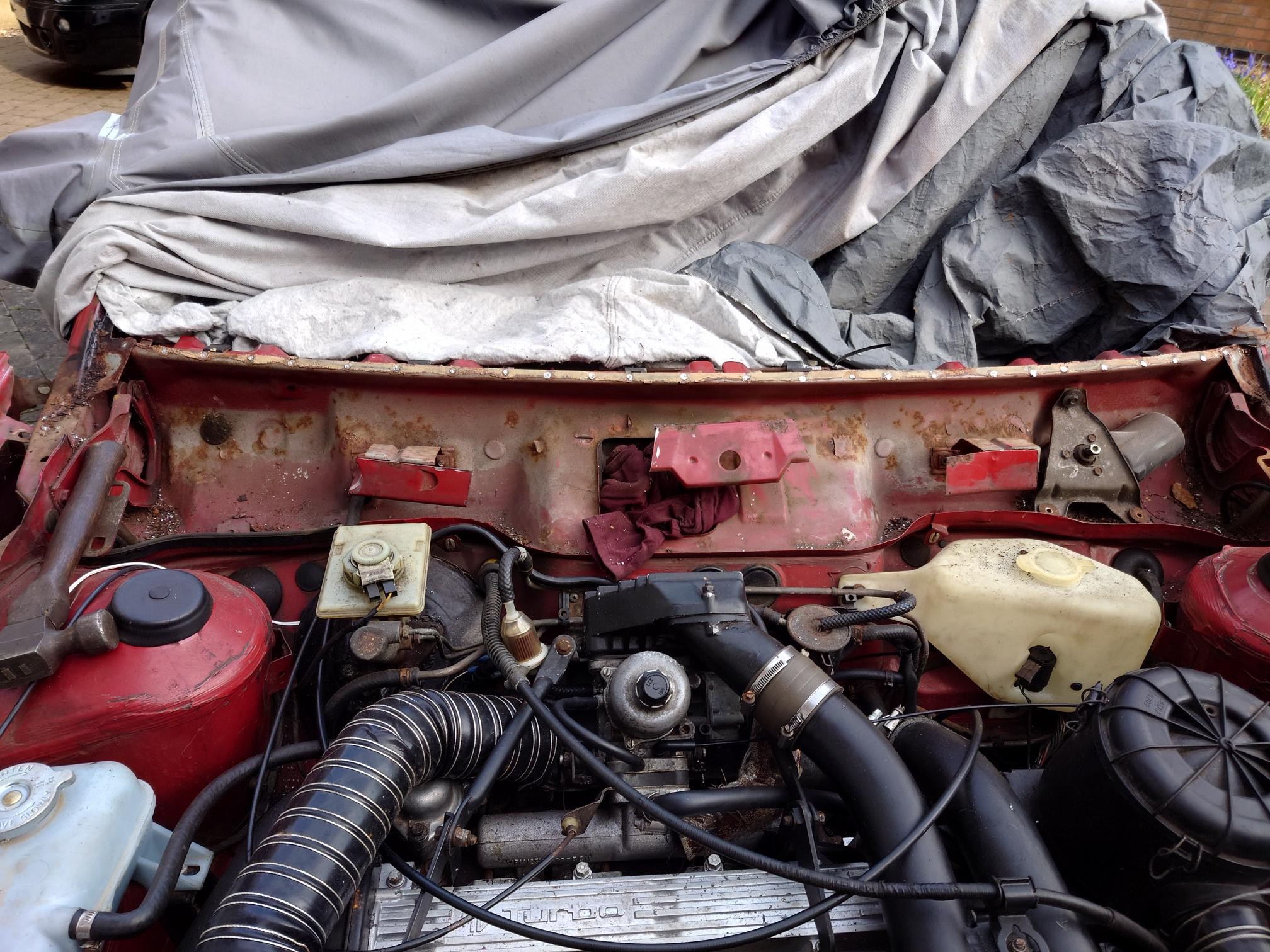

      • Well windscreen removed and lots of rust on the bottom panel, luckily I have a spare but the front of the car may have to come off to get to it. Bumper, lights and both wings . Sigh
        • Well luckily I managed to short cut it, all rust removed from the surround and given 2 coats of rust beater, another 2 coats to go then wait for the spot weld drills to arrive

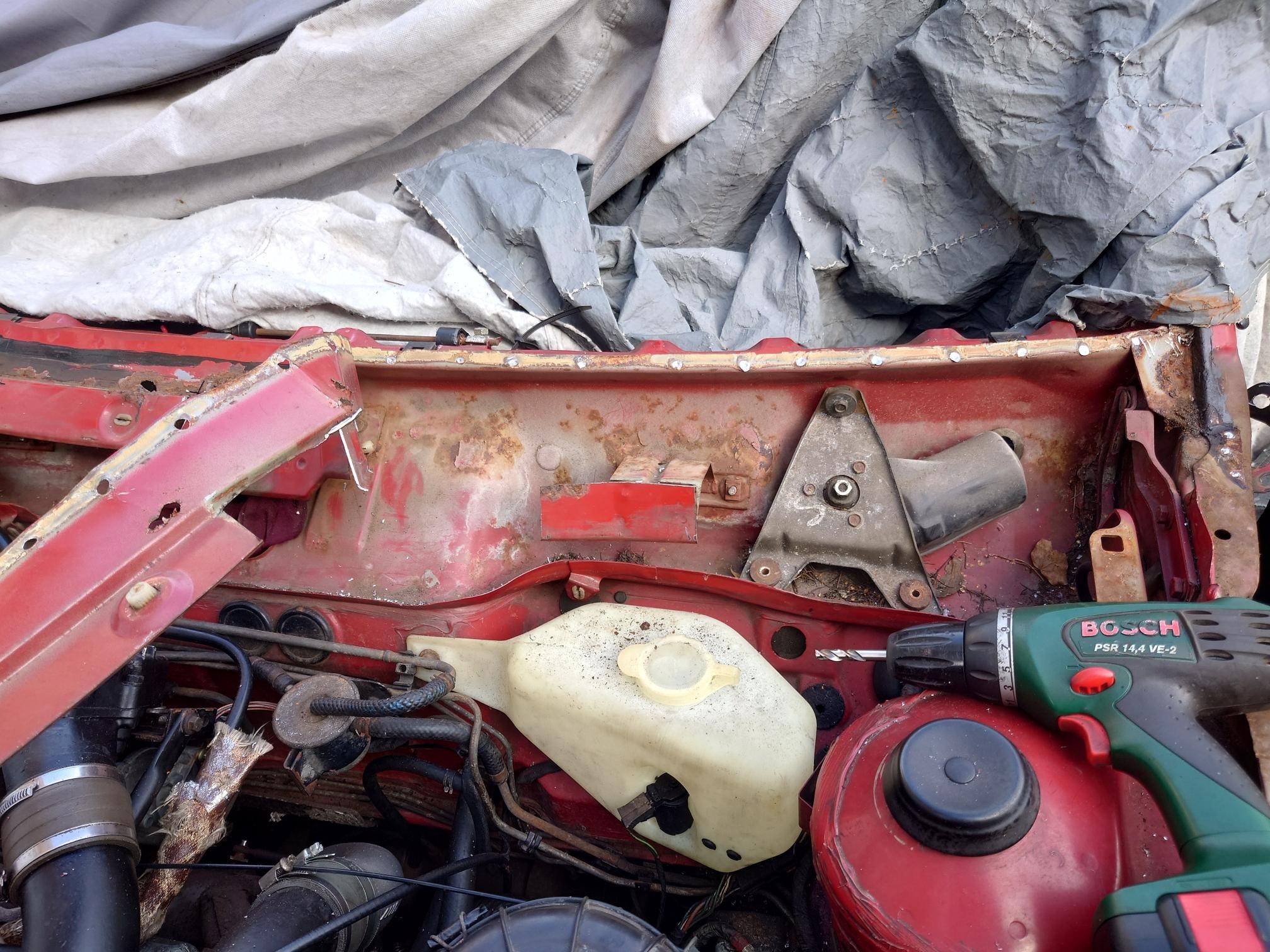

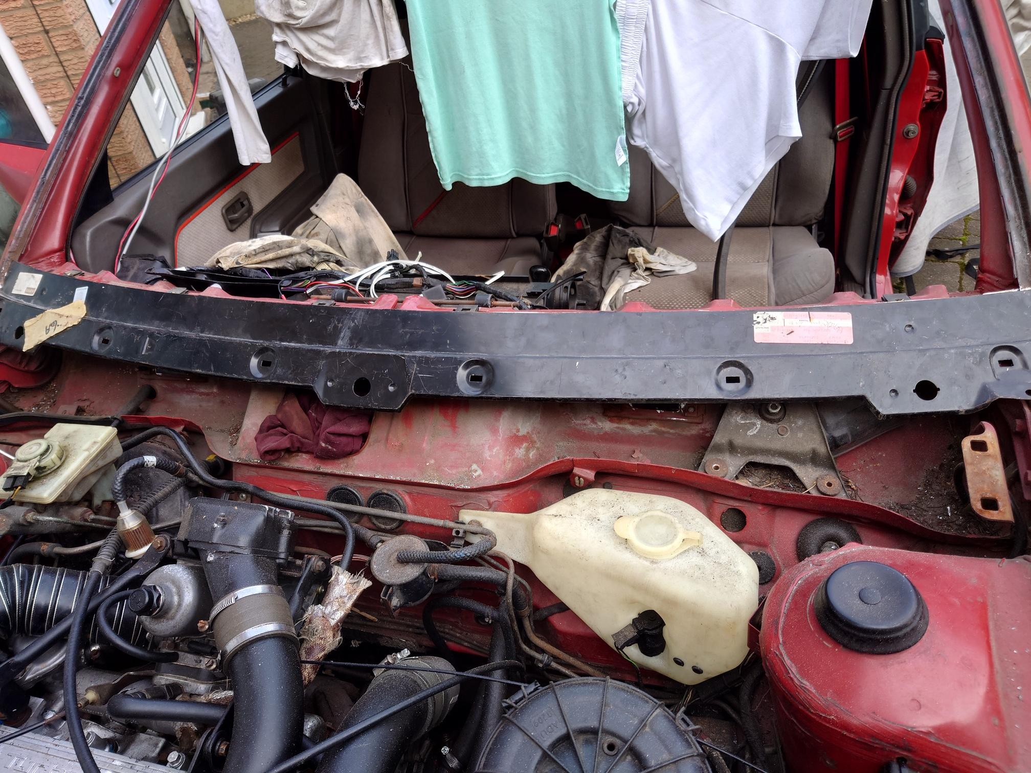

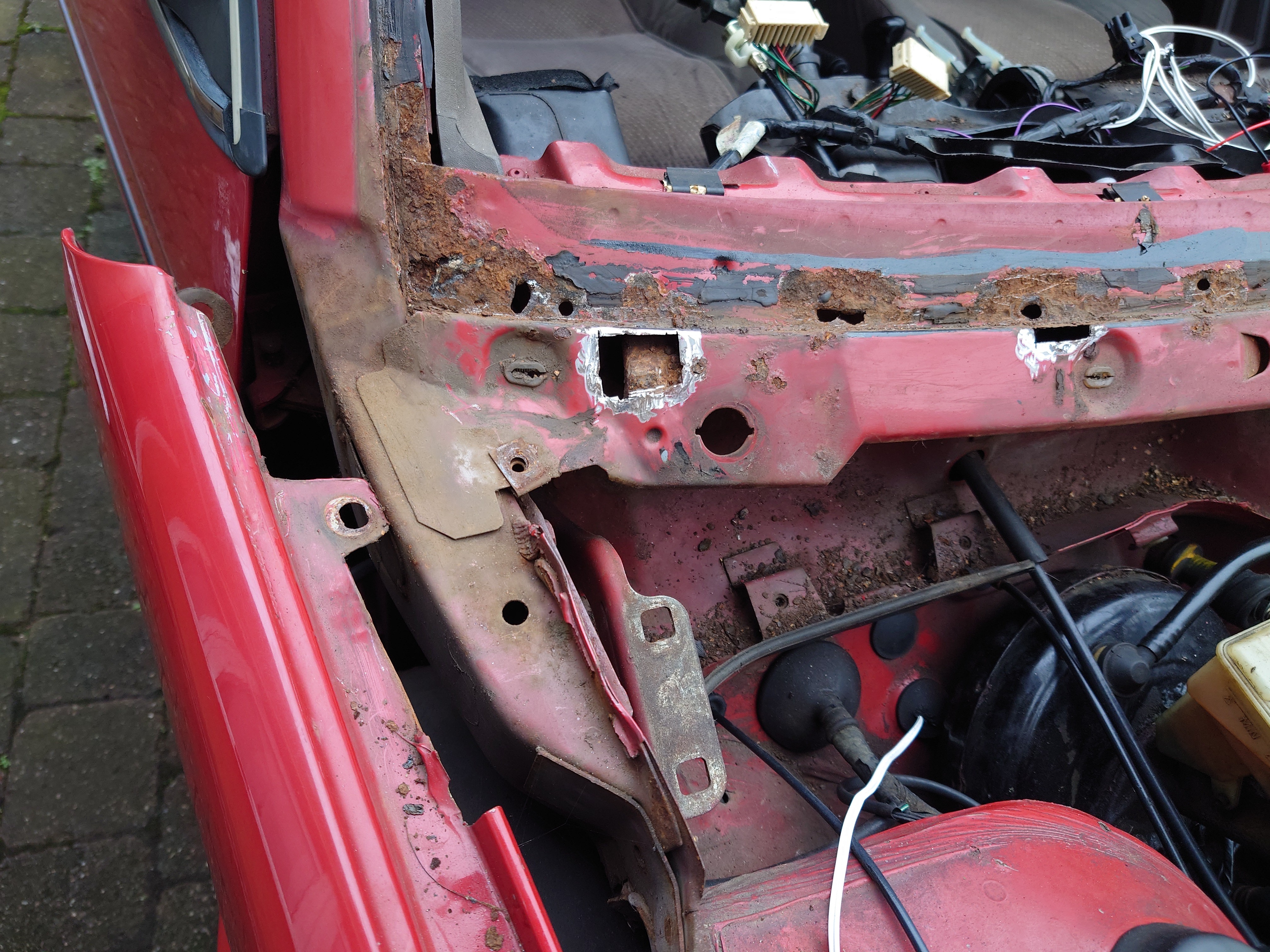

              • Little bit of time to spend on this so off with the panel and had to lower the heater to get the nut out

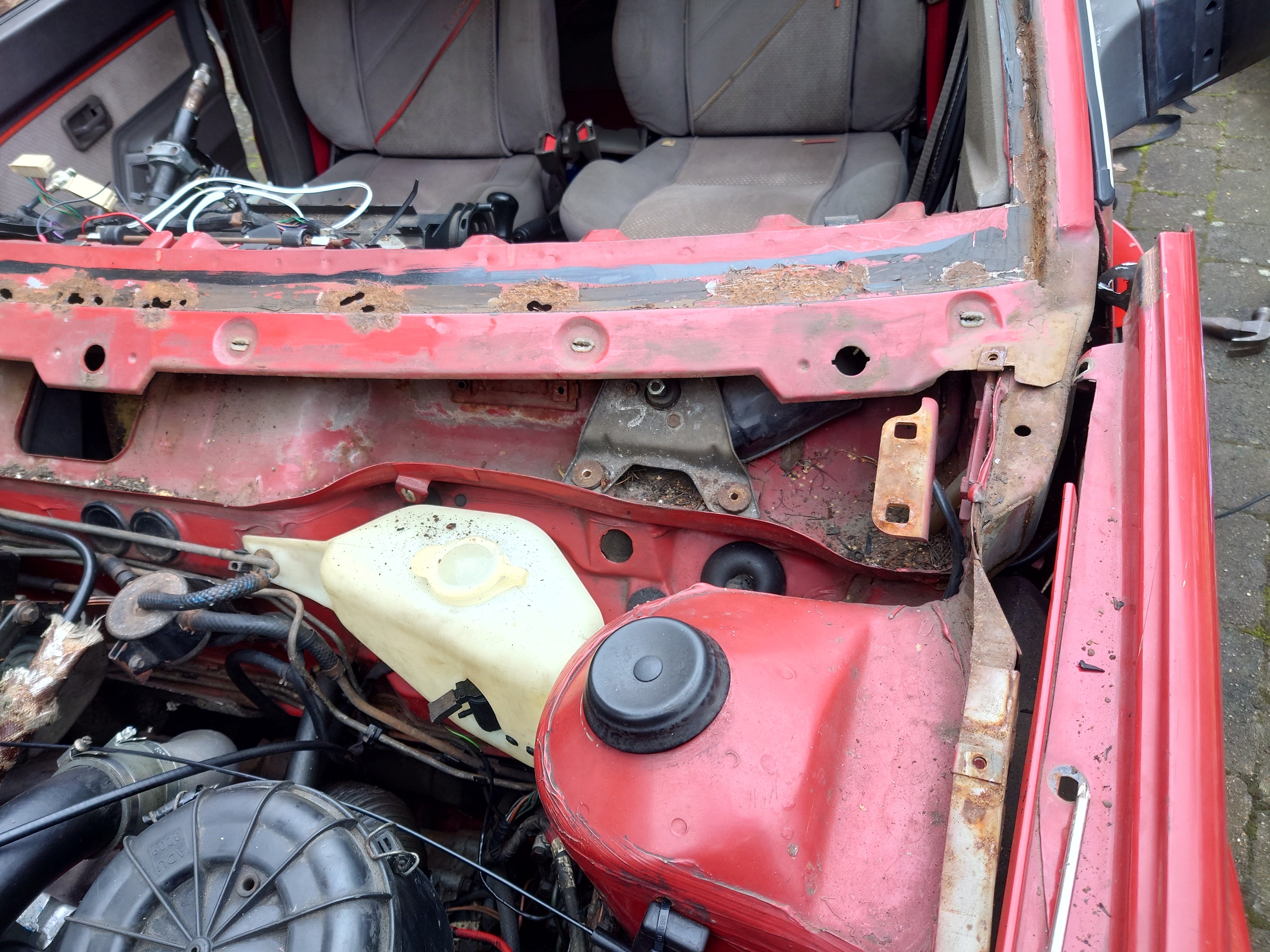

                • All off now and cleaned up the mastic and drill holes, little hole here in the A post I hope to plug weld, trial fit the new panel and not too bad at all . clean up next then measure for drilling holes for spot welding with my welder. Never done this before but it's going ok atm and what could possibly go wrong

                  • Spot weld holes drilled and now fits perfectly. Clean up and paint next before welding
