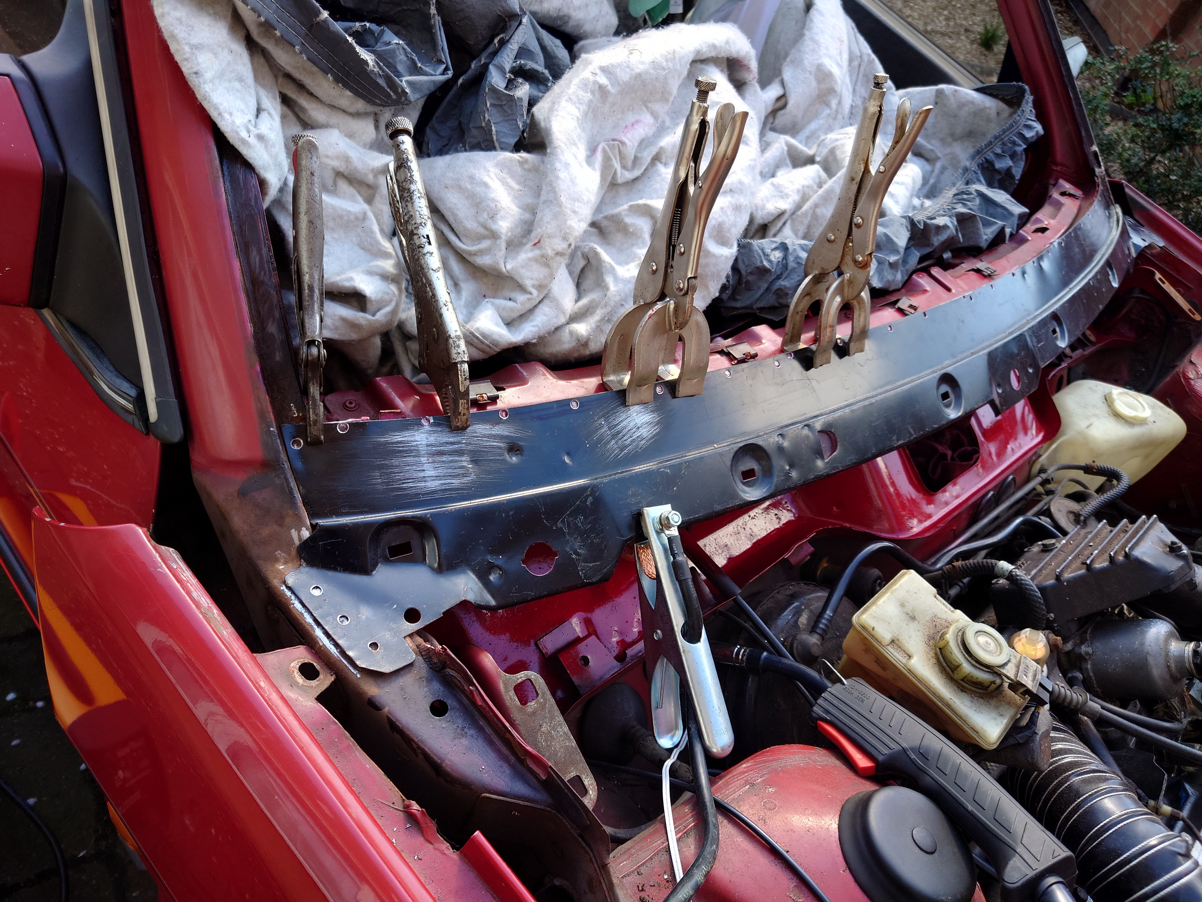

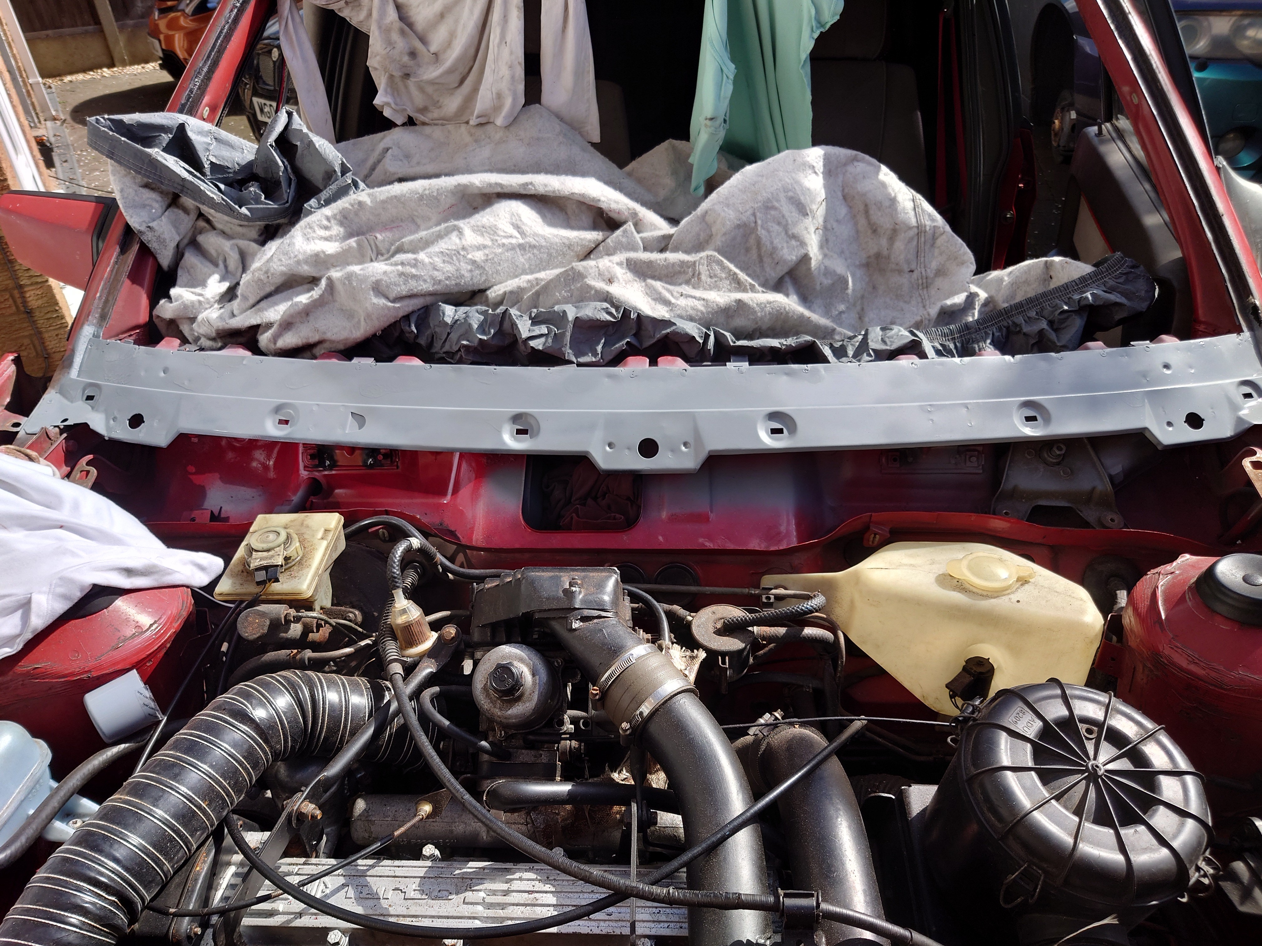

  • Panel all on, bolt at the bottom tightened, hole in the pillar sorted , panel painted, heater back on properly as are the screen vents, wiper motor back on, wings bolted back on. Windscreen surround all painted . Headlining out next. It may not be the best welding ever done but it's on and not going anywhere

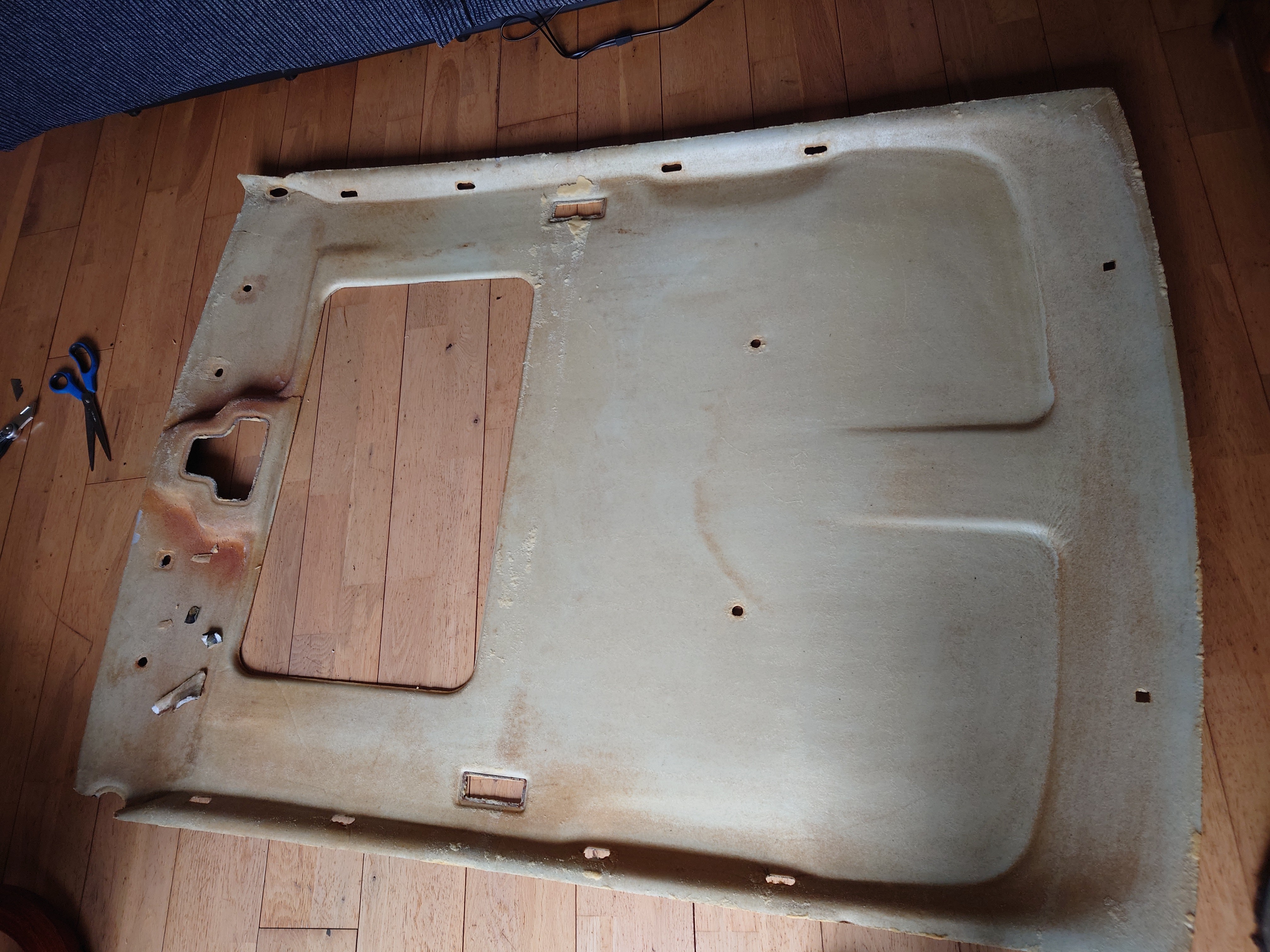

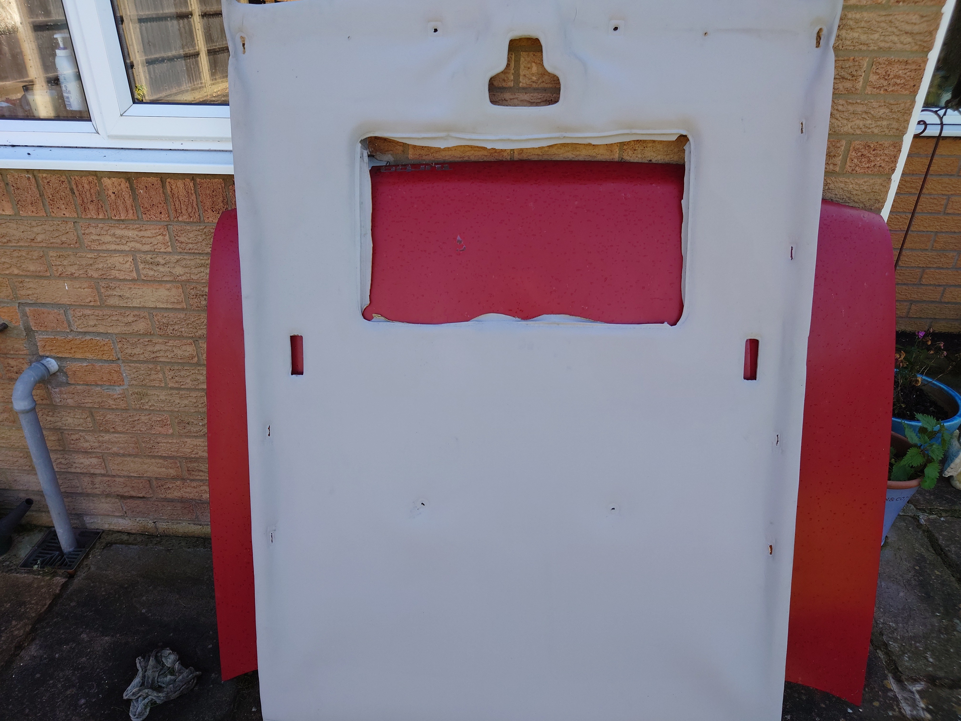

        • Dodging the wind and rain I managed to remove the headliner. Much easier with the screen out to find out why the rear had come down. It must be the glue as there was plenty on it at the time. We also did Chris's MGZS door cards and the stick on that only lasted a summer in the hot weather, so it'll be fun re-doing this soon before the windscreen goes back in in this weather.

          • The glue seems to be the critical component, I hope quality isn't going downhill like it has with rotor arms and so on....

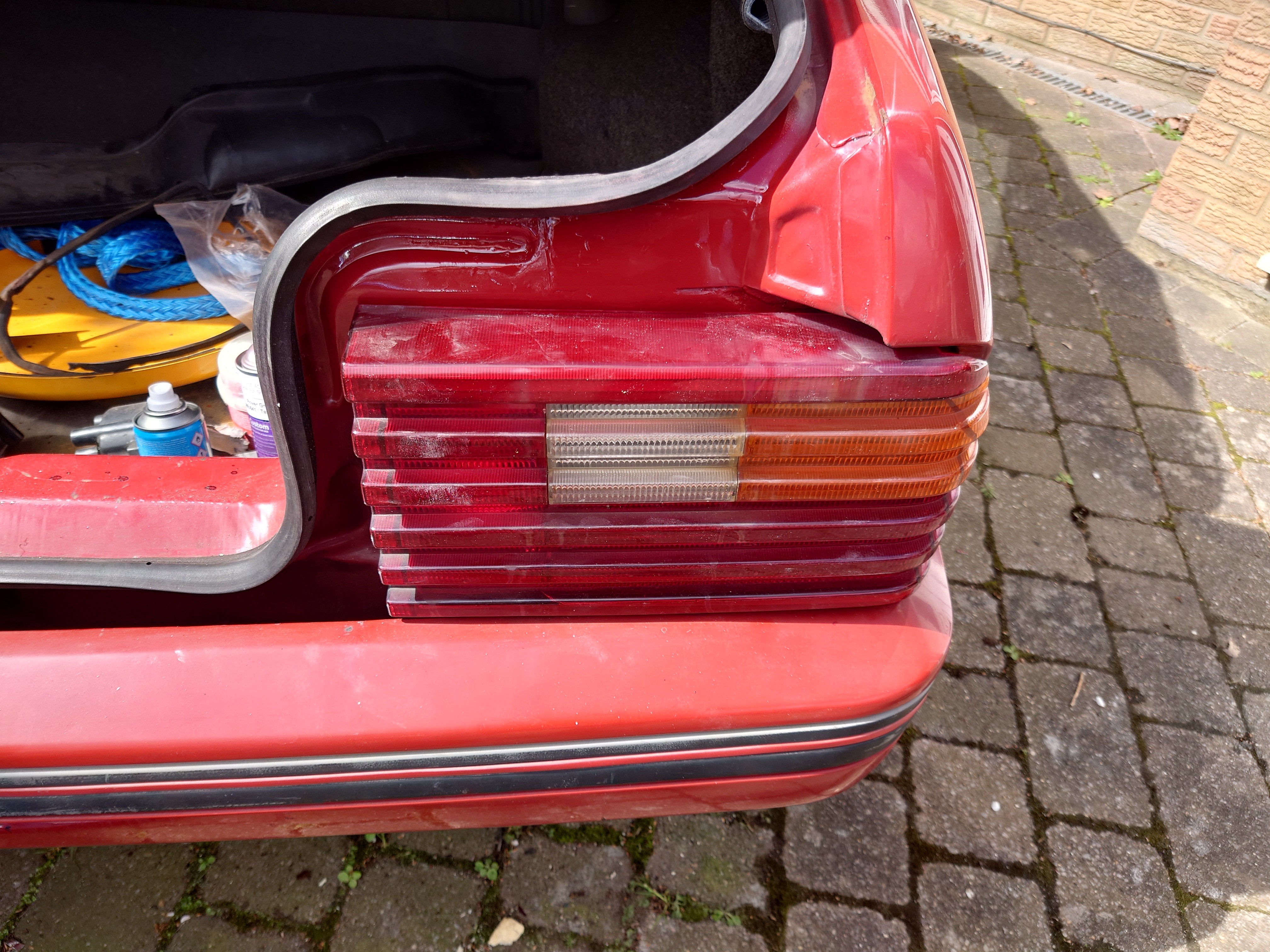

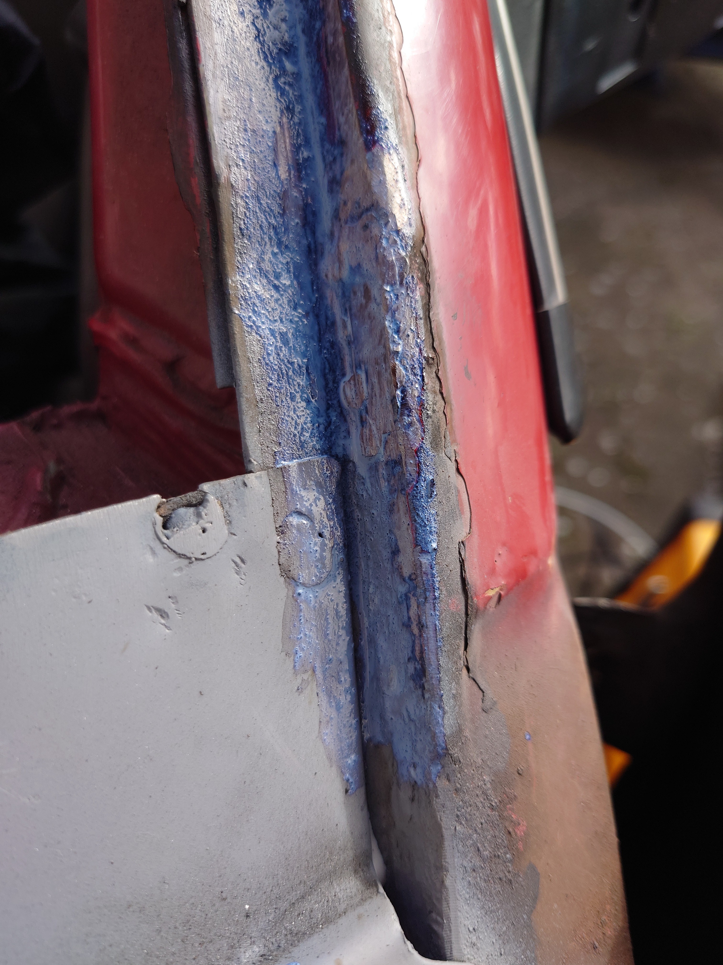

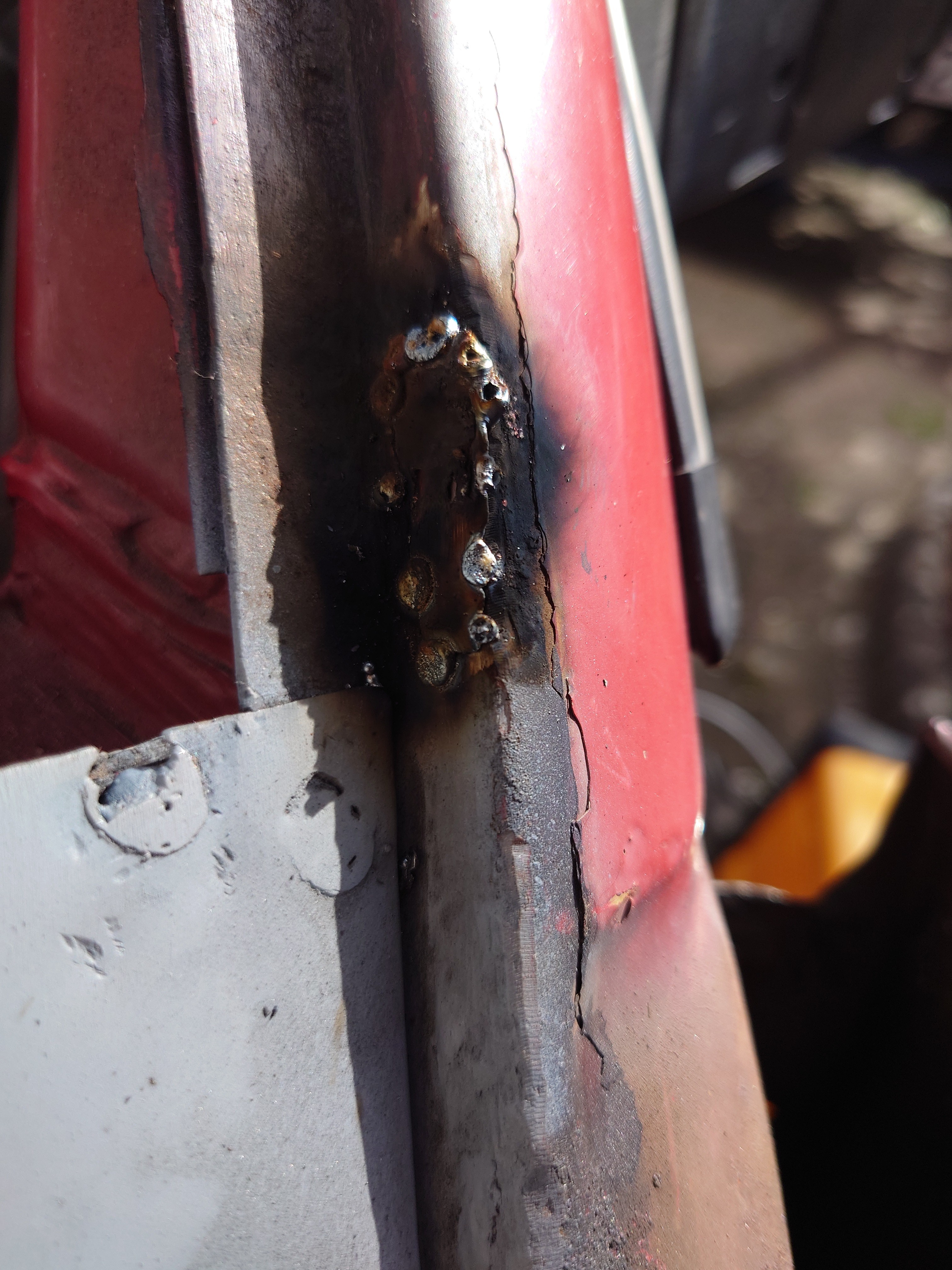

              • Rear light surround had a few holes in so welded that up, again not the best job but you don't see it with the boot shut. New seals on and doesn't leak now. If the wind stops or dies down tomorrow I should be able to do the headlining as the spray glue turned up today

                • A good job done cheap! I would say 'what do you get for two quid?', but you've just told us....a dry boot...
                    Oh yes, had to do my mgzt cdti as well as one of the seals was starting to leak and a boot full of water

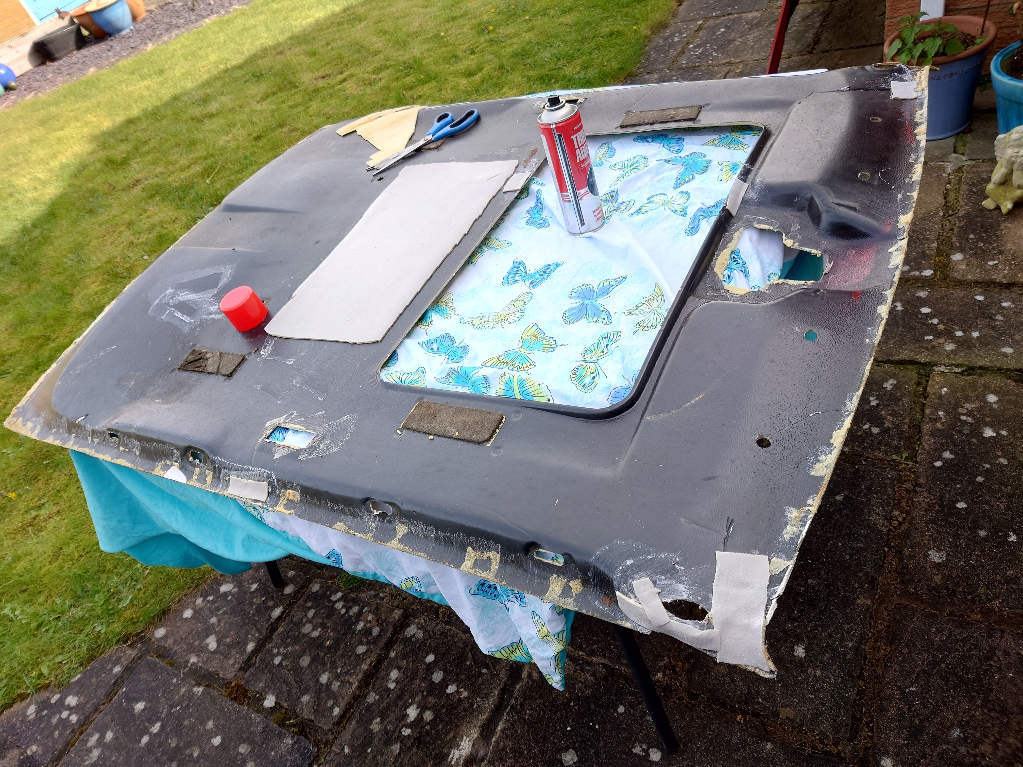

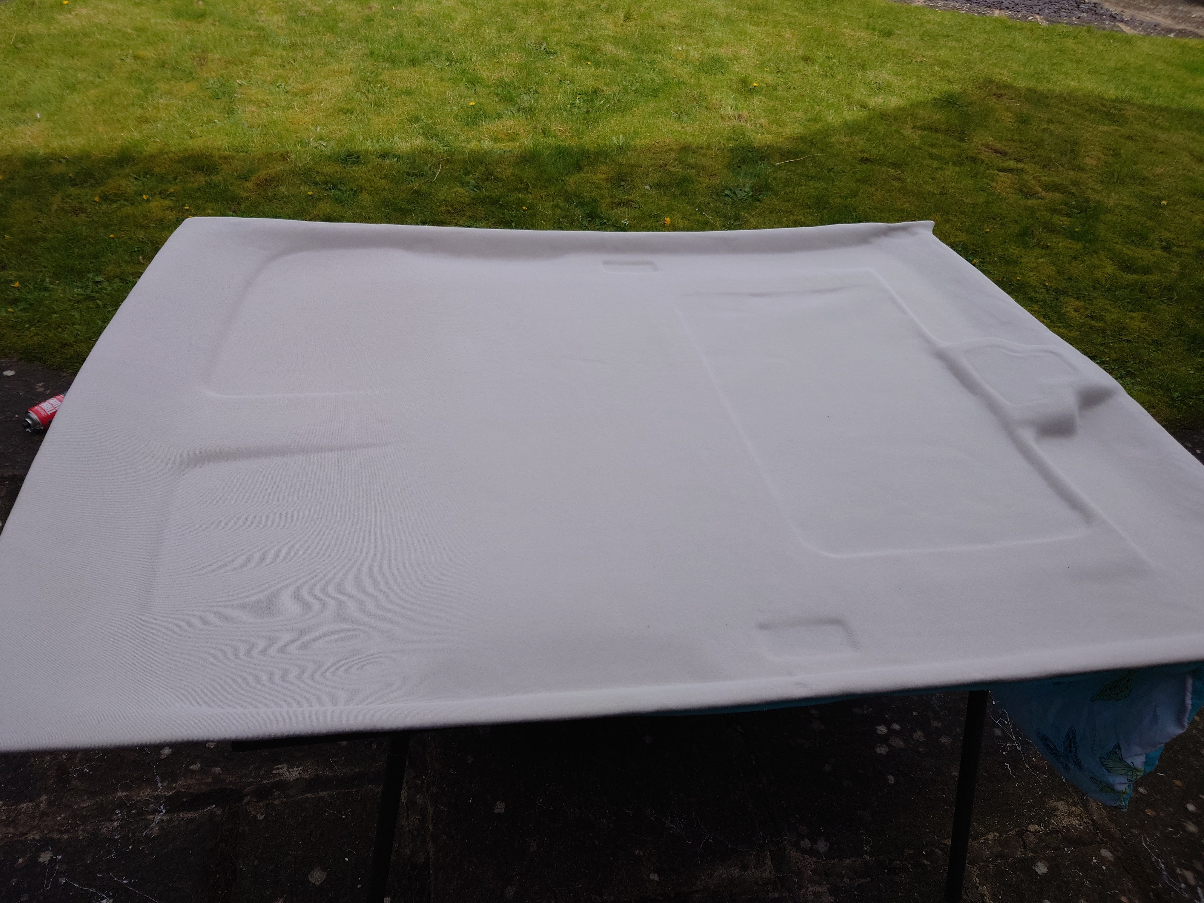

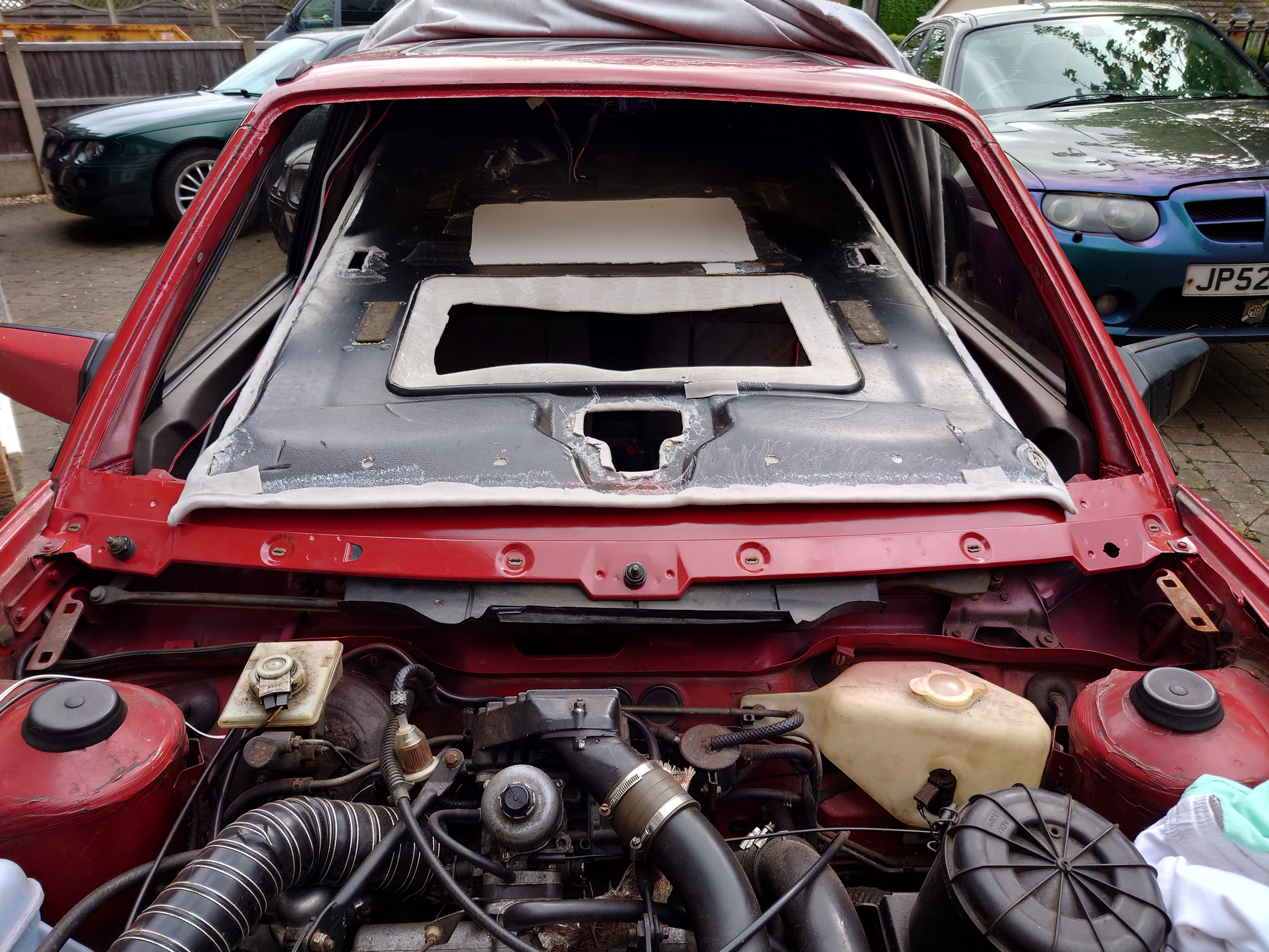

                    • No wind this morning so cracked on. Strengthened a few cracks etc Will let the glue settle before cutting out any openings . Used a whole can on the rear again so I'm hoping this time it'll hold

                      • Now all ready to go back in once I've cleaned out the interior of the car

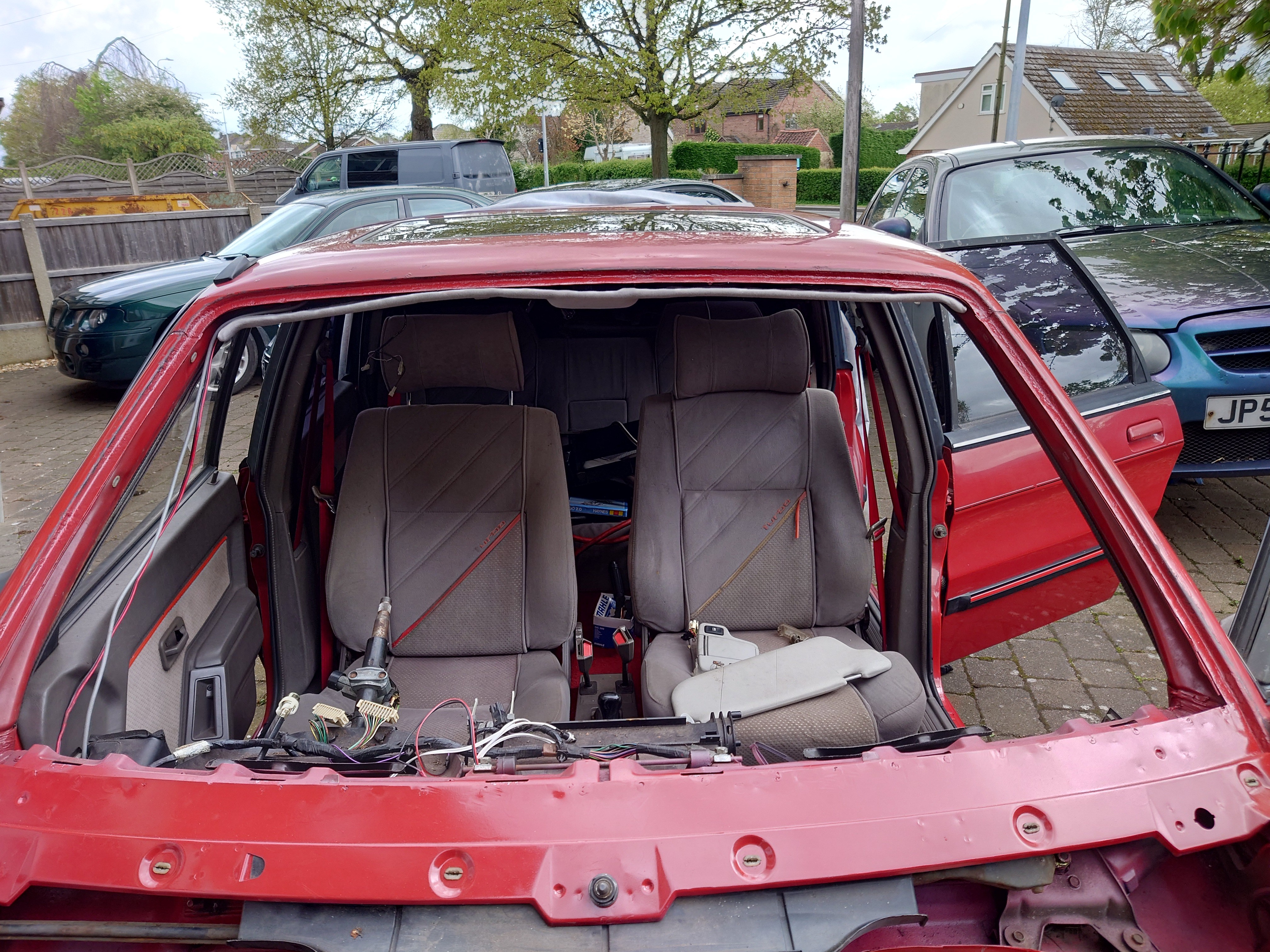

                            • So much easier , will finish cutting round the sunroof once the windscreen is back in as it's raining again, The windscreen is going back in next Thursday so it'll be water tight again

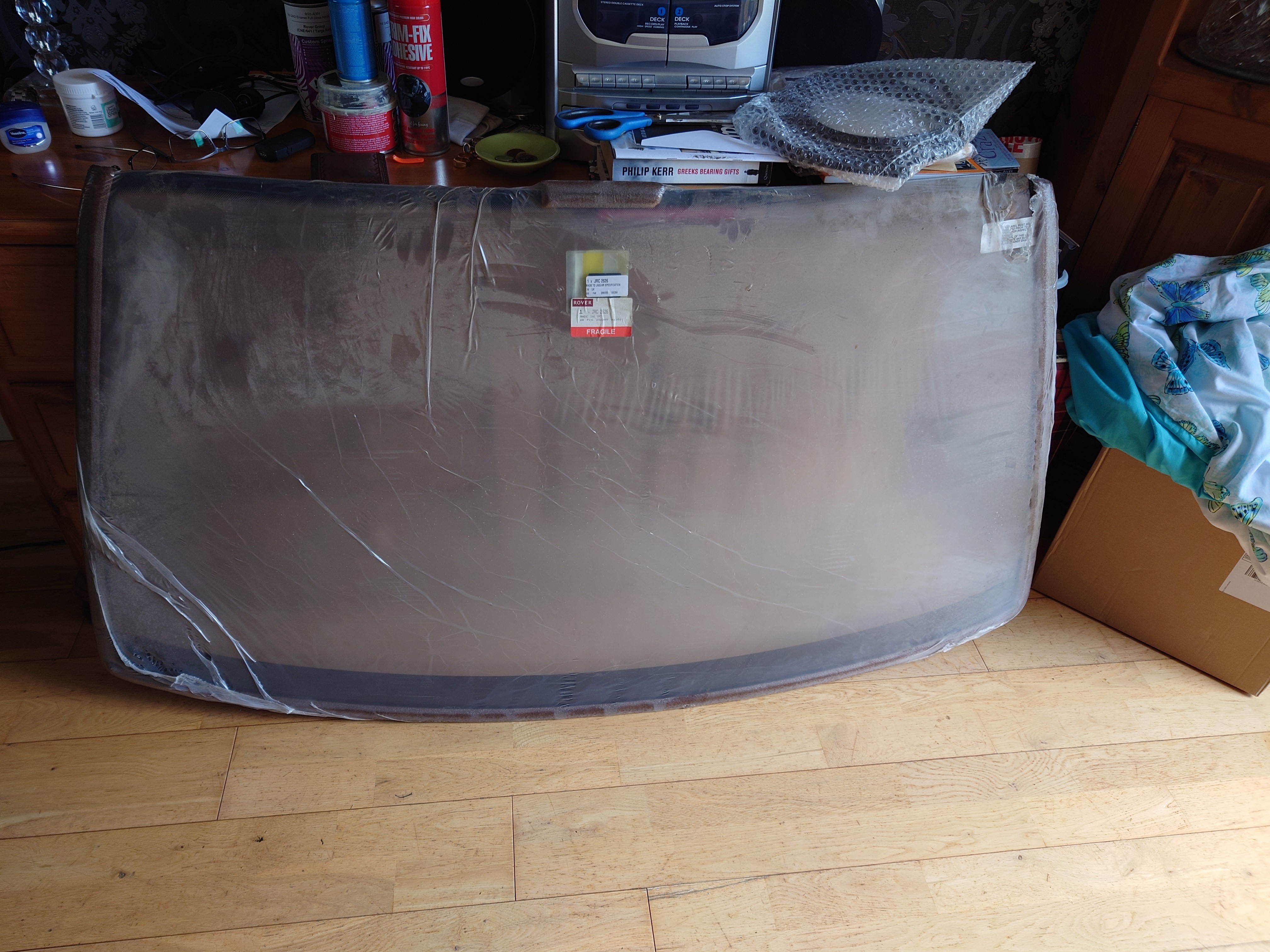

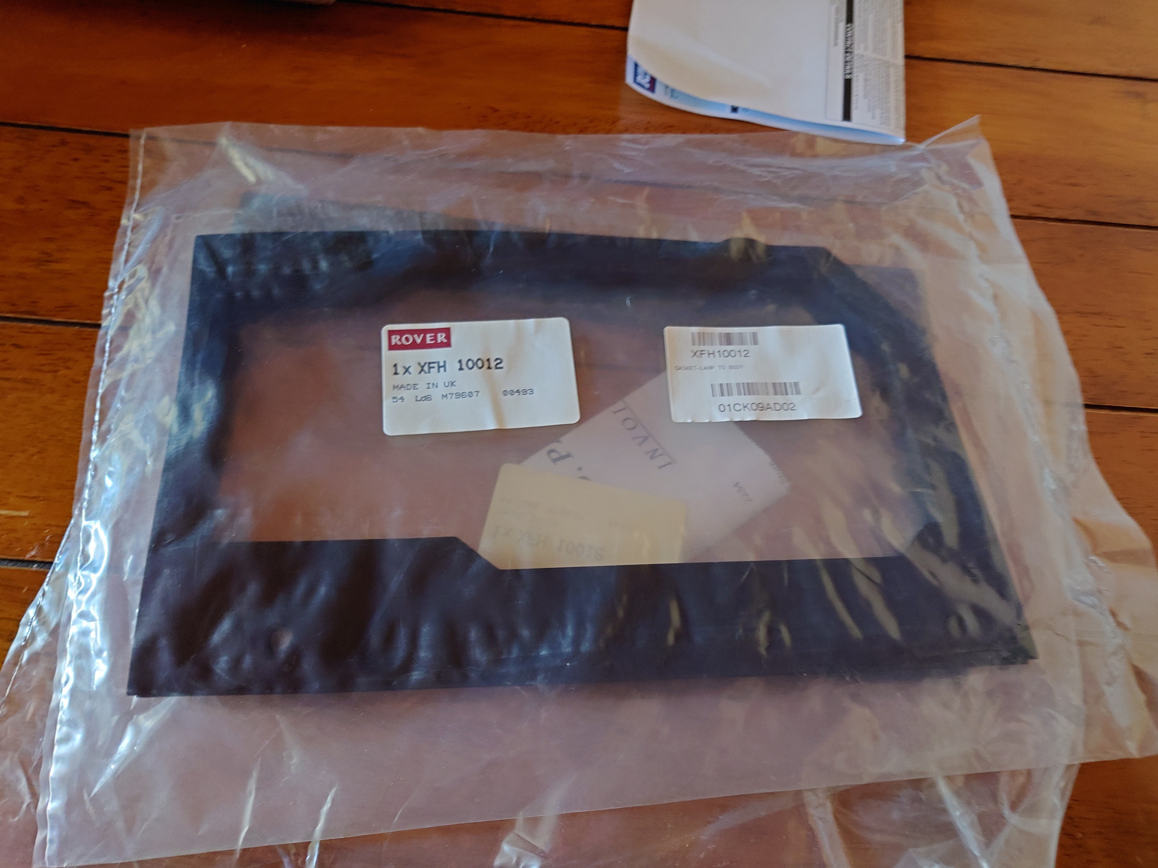

                              • Windscreen couldn't be put back in as the surround was rubbish. I bought the correct one from Rimmers but it wouldn't go on the windscreen correctly so I've had to search for something else, think I've found one now and it's on it's way to me for next week

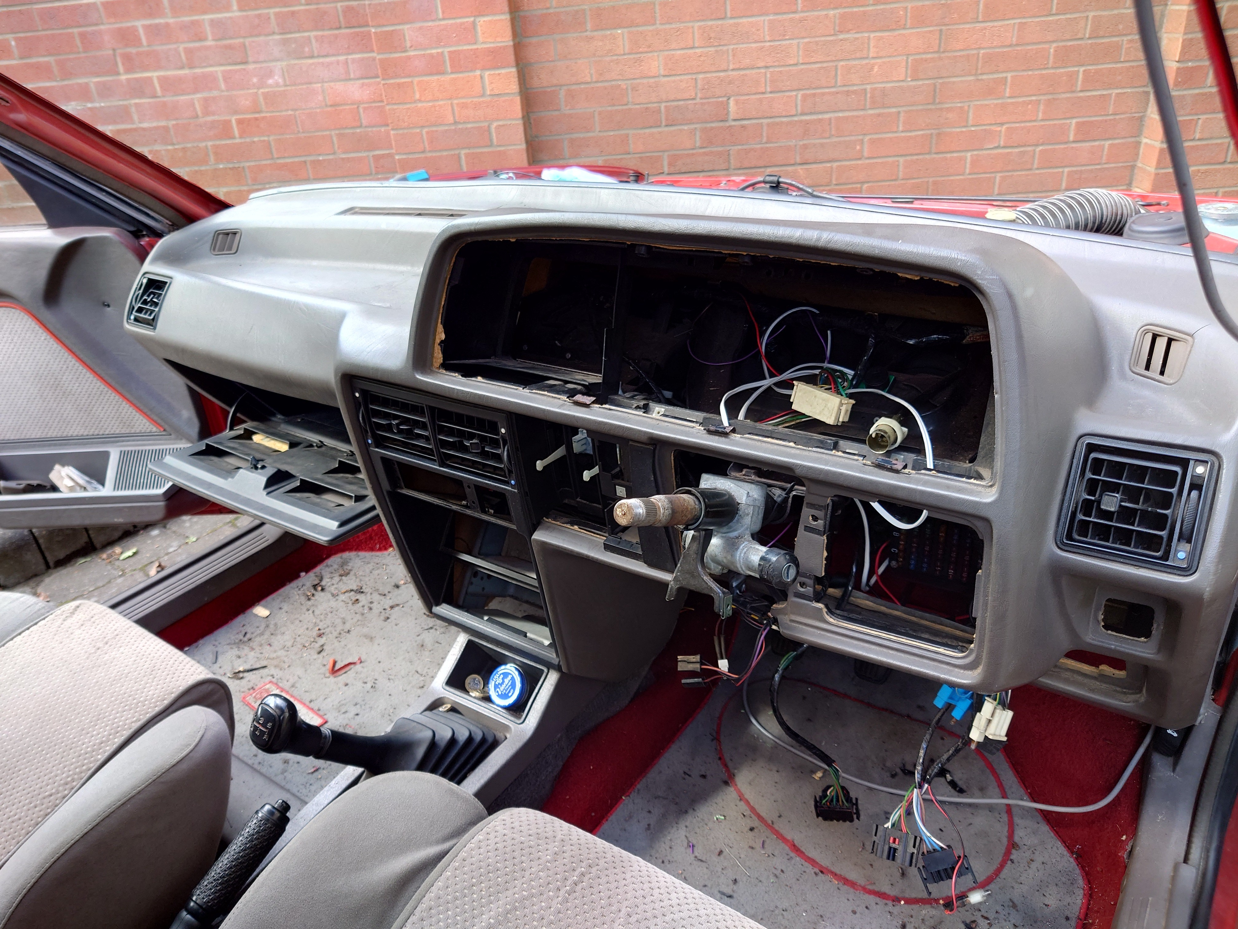

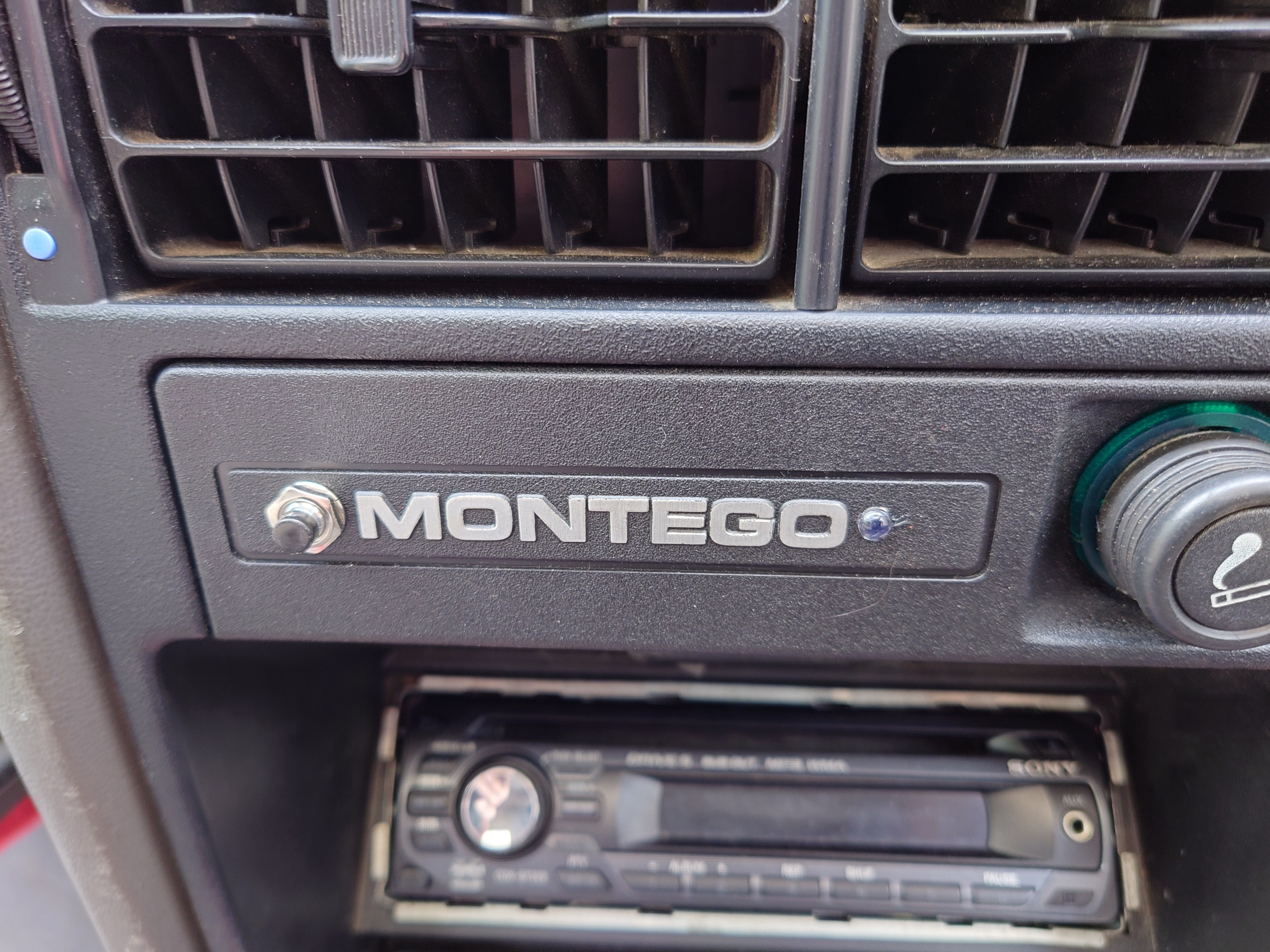

                                In the meantime dash going in , I've put the buzzer and light here and also plugged all in to test next time when I connect the battery back up. I'm hoping the rev counter will also now work as that stopped before the dash came out as I've changed the display as post 257.
