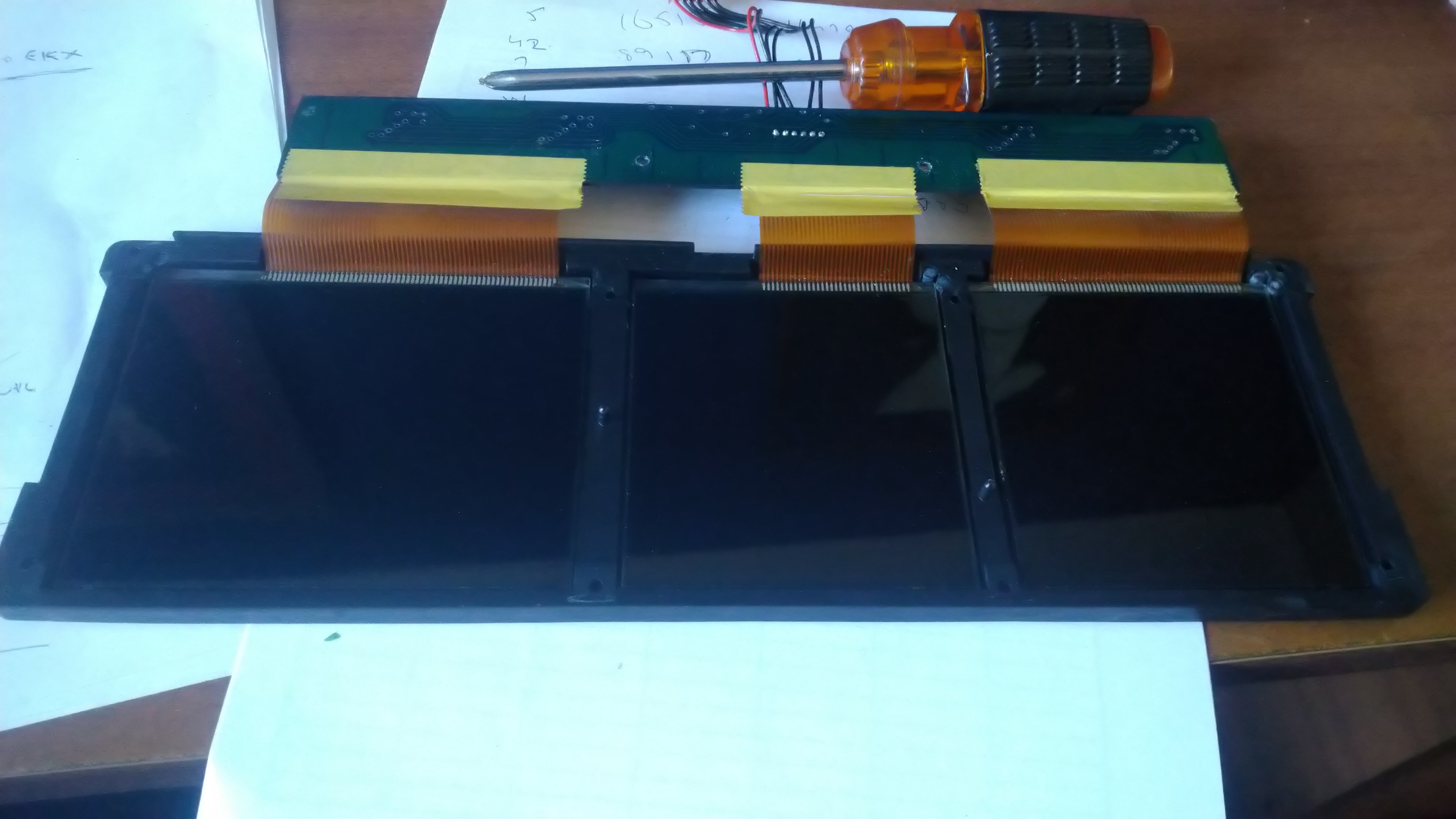

        • This is my spare but looking back through this thread i noticed the fuel level was still at two bars when I had this one plugged in so it must be the sender stuck, as there's £50 of fuel in it I will have use it and carry a petrol can when it runs out before changing the sender

          • Now taxed and being used, I've also set the dash to display everything and the fuel gauge lights up with all segments so I have to believe its the sender.

              As the mileometer still wasn't working correctly I stripped down again this dash that had developed a fault when I last stripped it down a few years ago now, re-cleaned and checked all connections. Took out what I think is a faulty mileage part on the dash that I put in the car when the original wouldn't work properly and it sprang into life and the mileometer is now working correctly after taking it up the road for 3 miles. This dash has an extra 30k miles on it as mileage is stored in the memory which I had forgotten about but isn't a problem as my MOT says mileage not displayed.
              The dash still says only two or three segments of fuel but it does now go up to the top of the orange segments when turning the ignition on then goes back down so its getting there slowly.

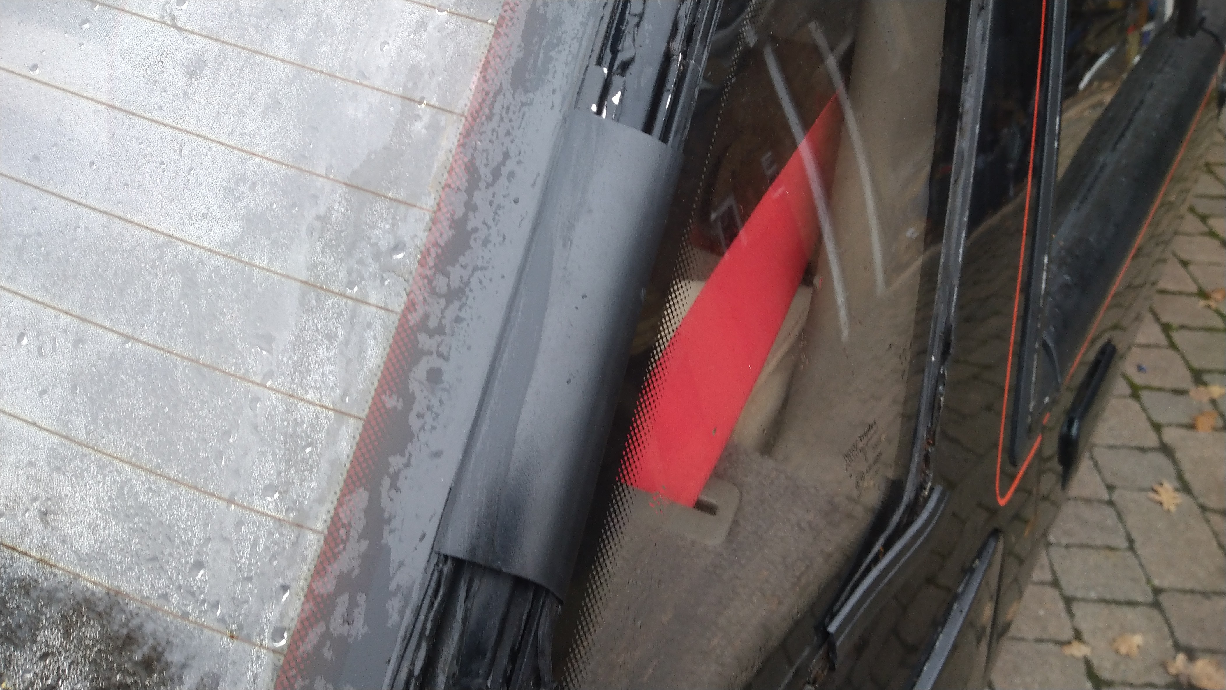

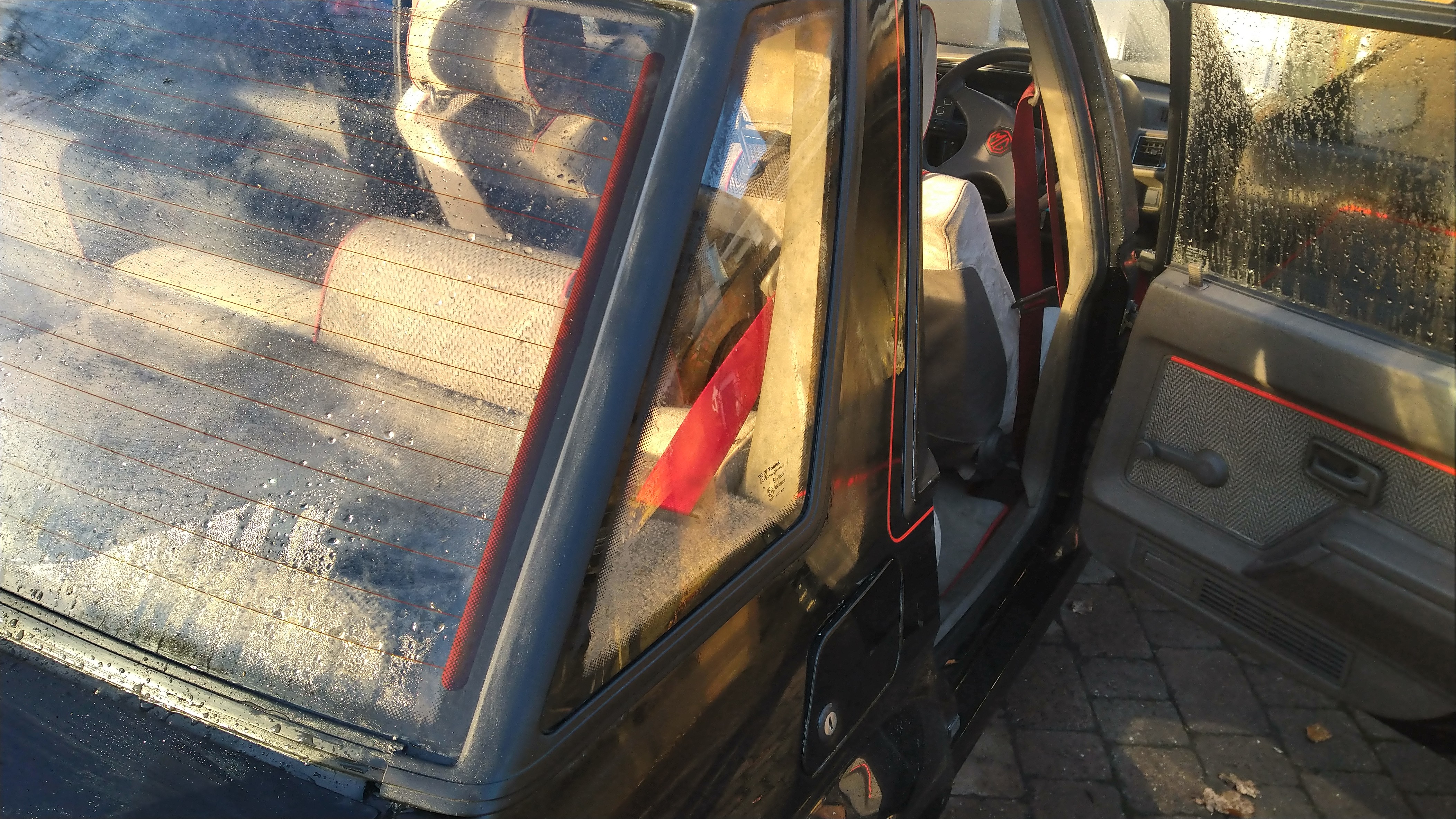

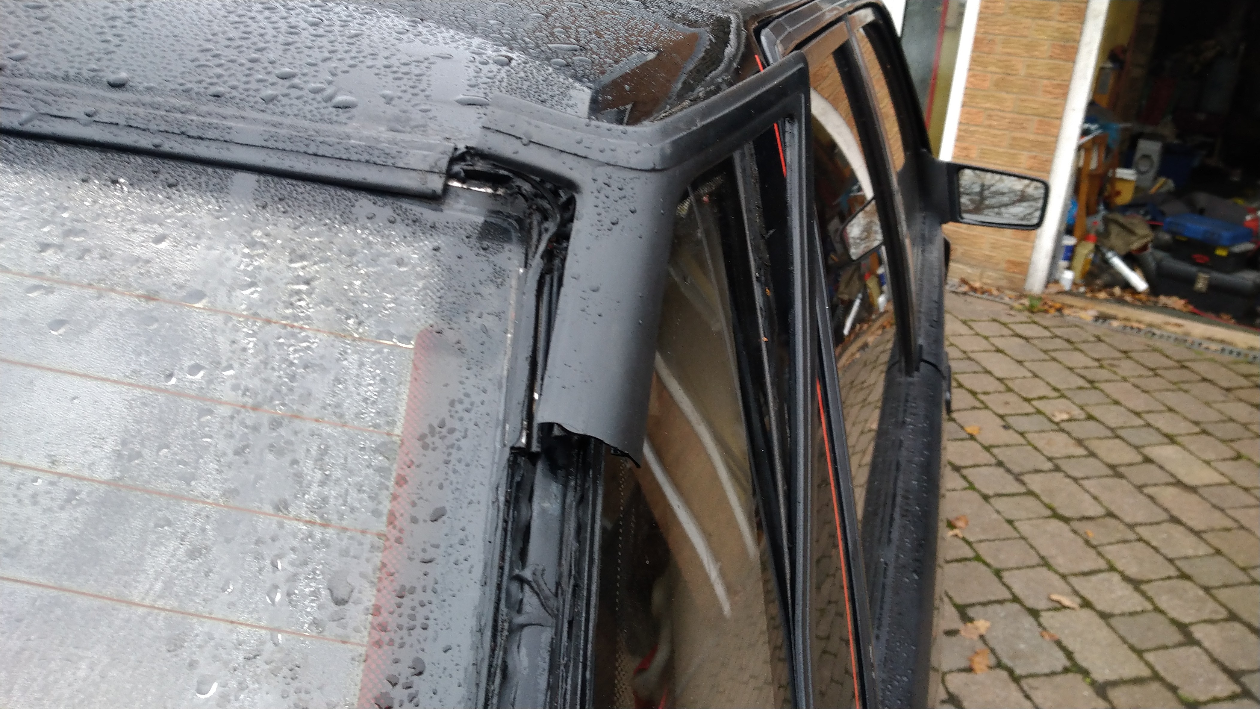

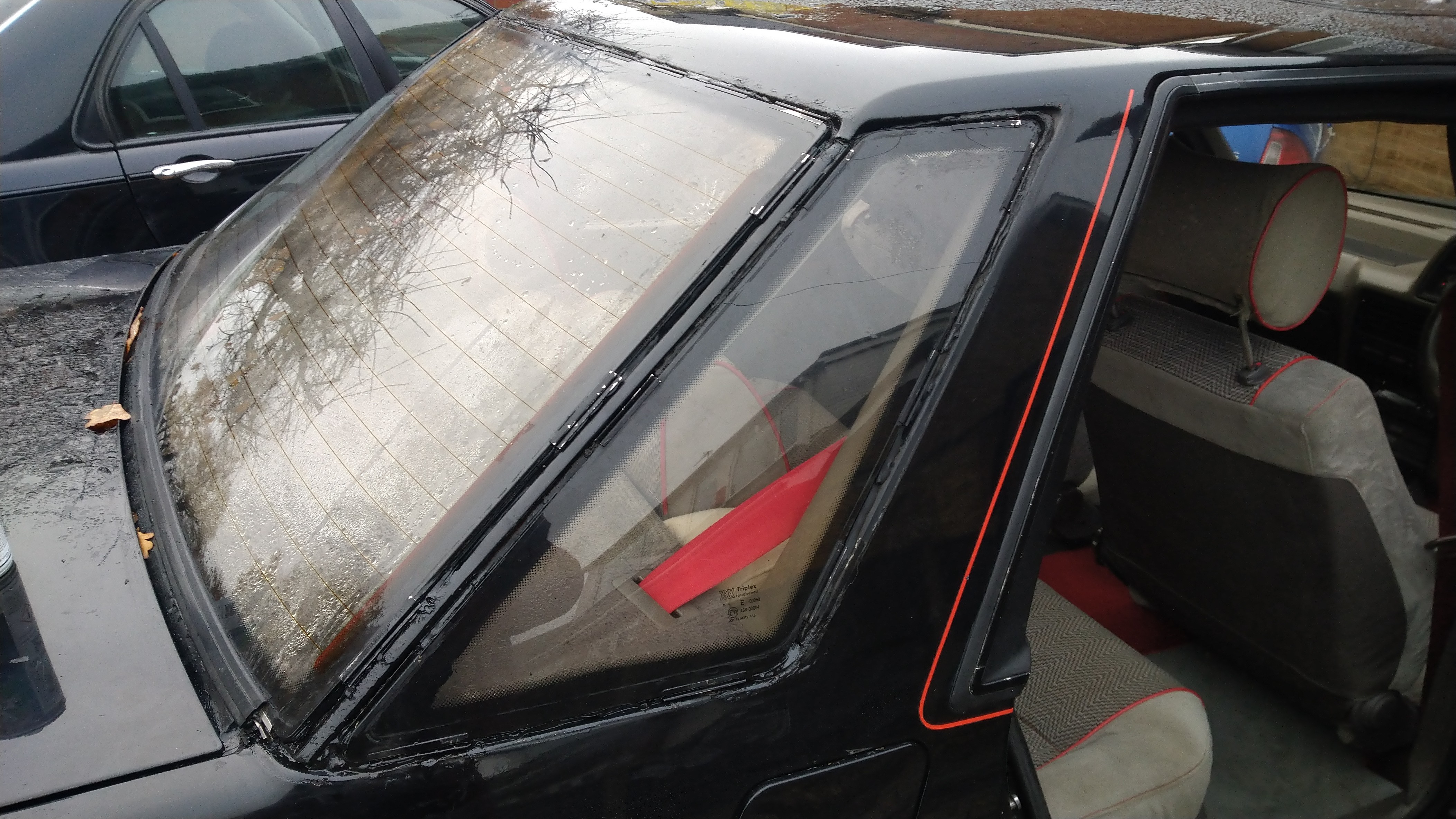

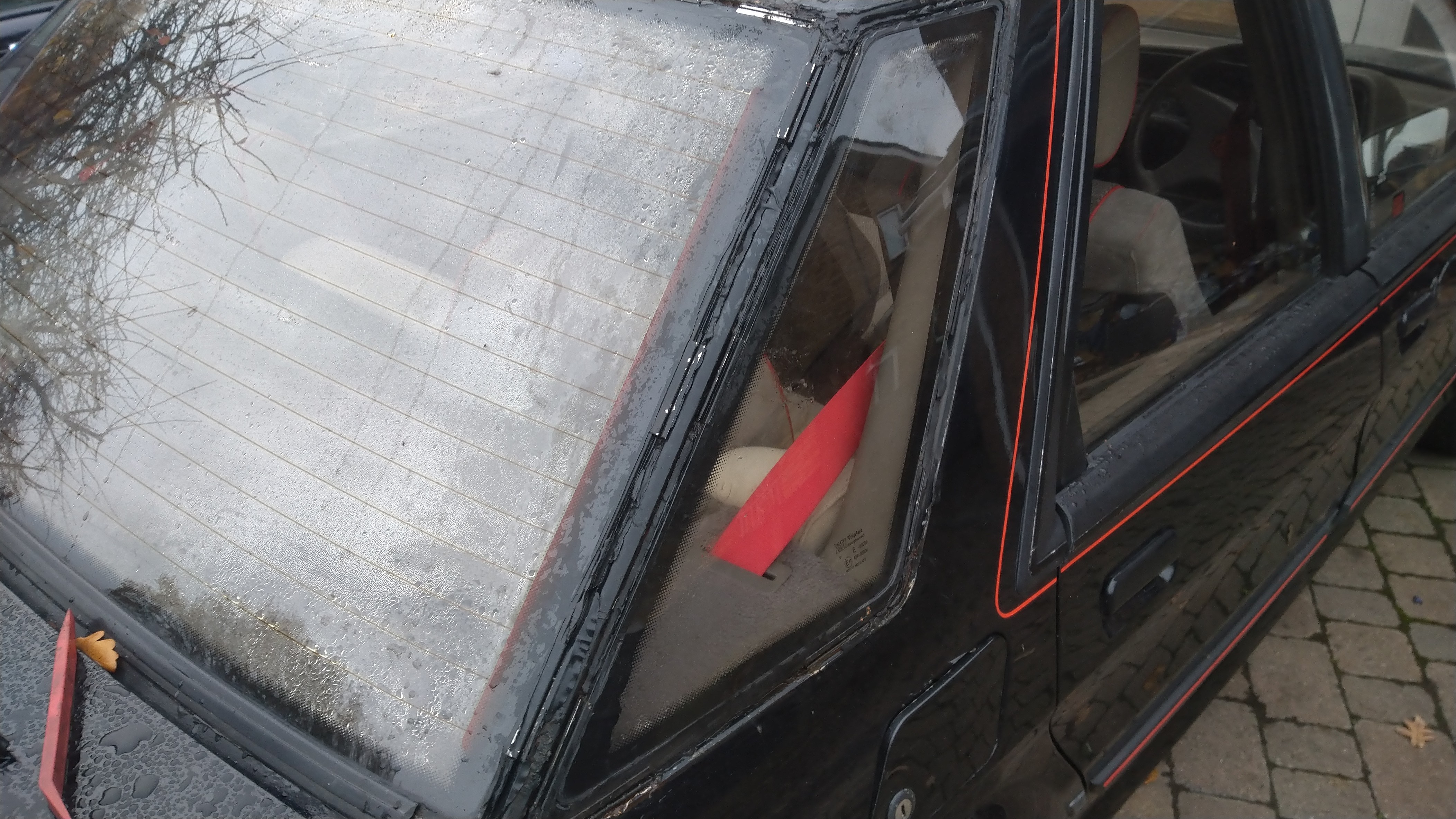

                • Rear quarter trims are cracked and have a small leak on the joint at the top so removed the offside. I don't like doing these jobs as some of the trim is stuck fast but all out. Thanks for the trims John

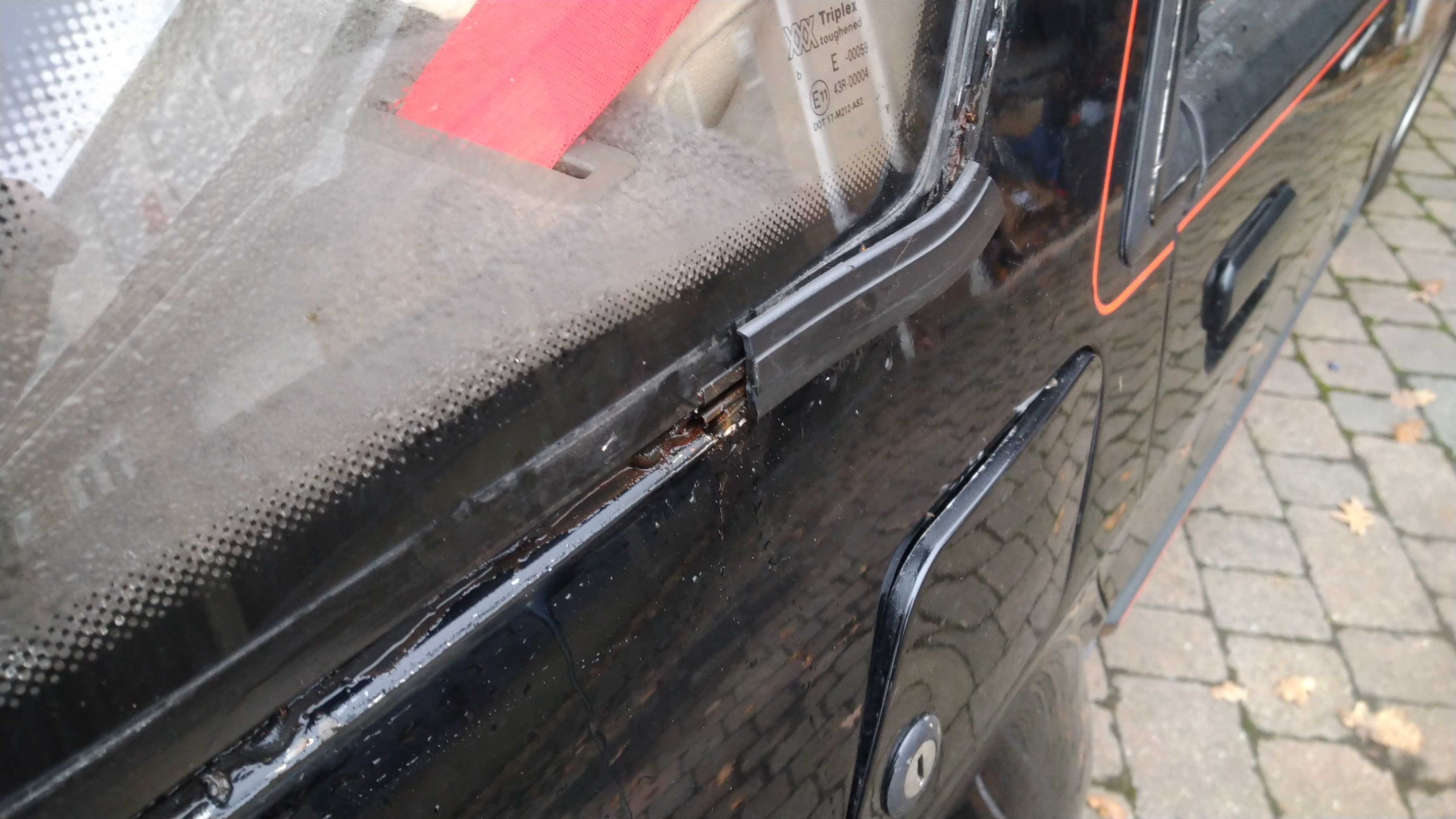

                  • All out and started a clean up ready for new trims going back on. I'm not too sure about the nearside as those are very stuck in so I will leave that side as its not leaking and i don't want to push my luck. Luckily only surface rust on the centre metal part

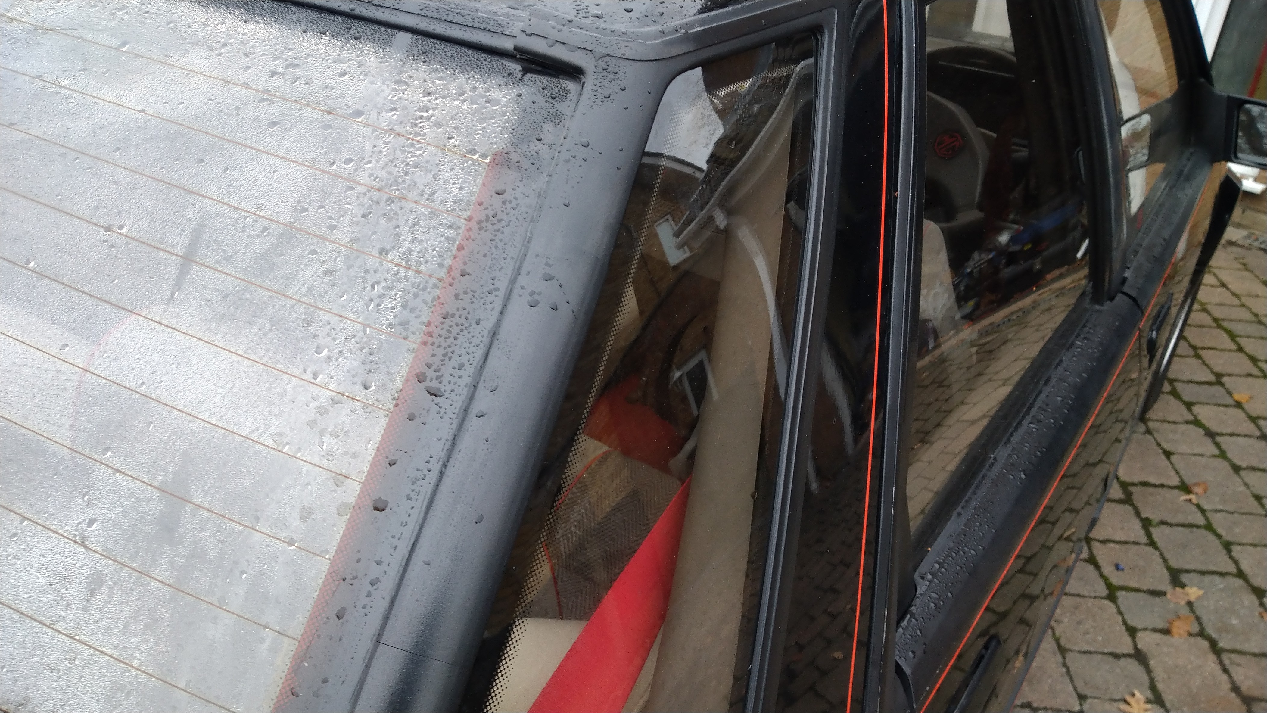

                        • That sorted, don't want to do that again, these are replacements from a company who re-made them but they don't fit as well as the originals

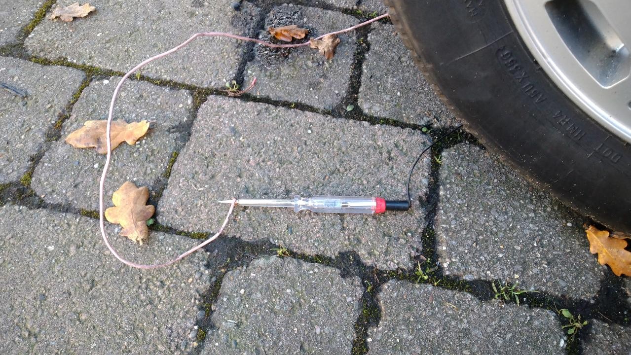

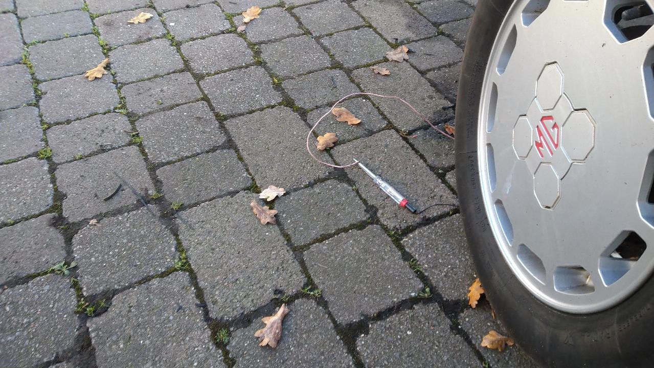

                              • When you can't find your multimeter you have to use other things. When I attached this to the pump connections, power is getting to the pump as the tester lights up when priming and turning over. Even after a tap or two with a hammer the pump is still seized
