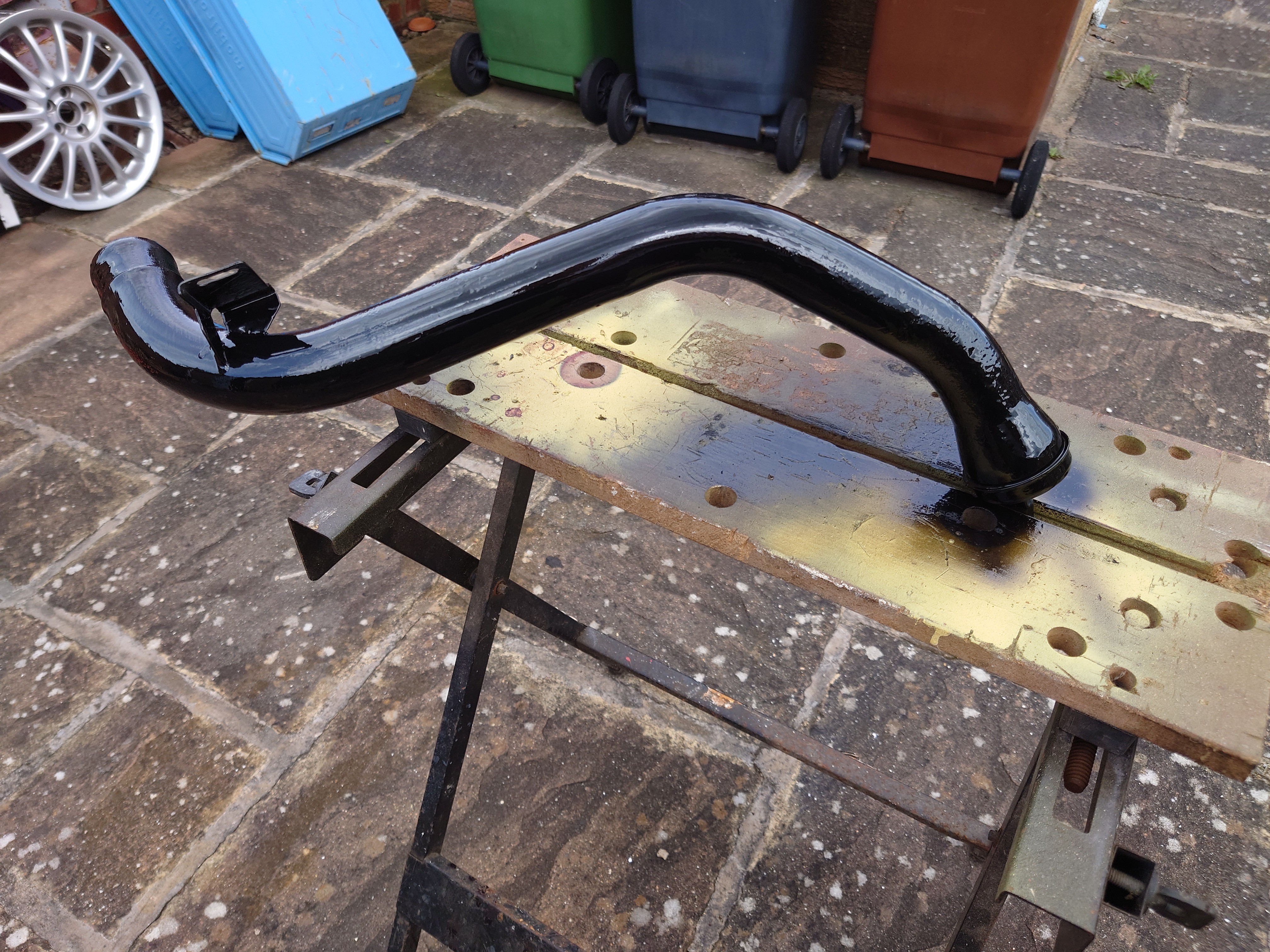

    Back from holidays now and had a bit of time this afternoon to carry on, new fuel pump and filter on, off axles stands and just about to fill the empty tank with fuel.
    Saw a bit of rust inside the fuel filler pipe but that grew

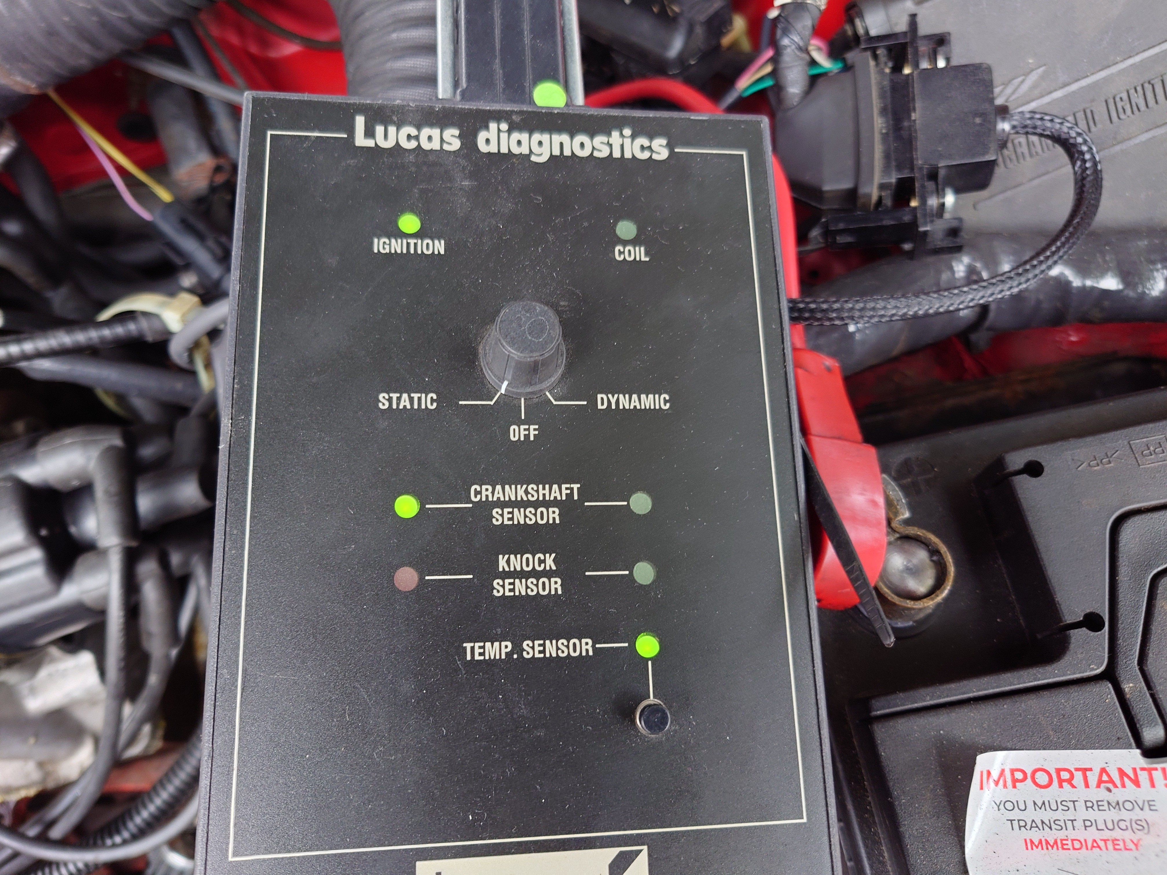

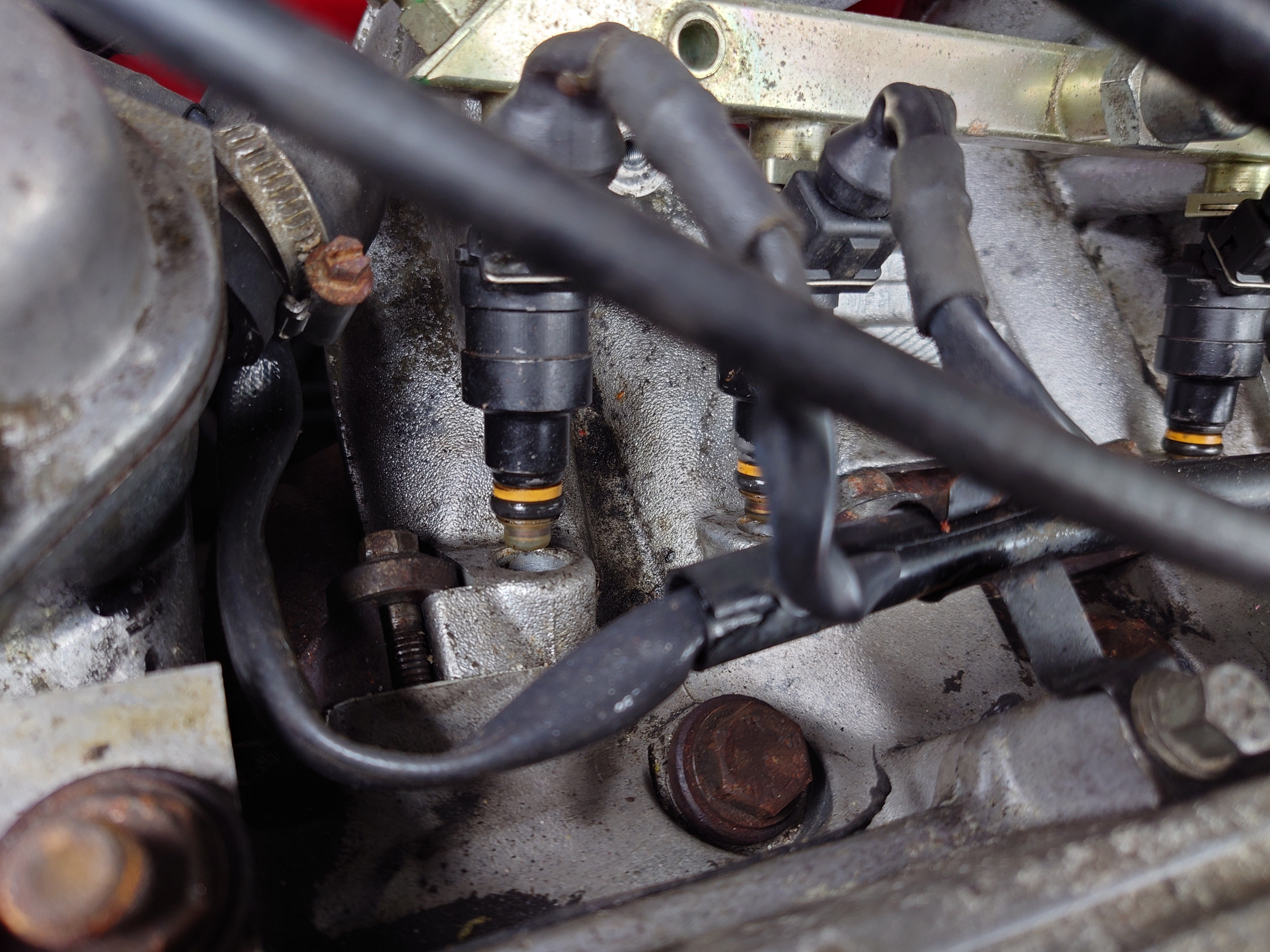

                Put three gallons of fuel in, connected up battery and we finally have a fuel flow. Still non starting so using my testers it found a fault in the coil. Replaced the multifunction unit and the lights came on and now have a healthy spark, still non starting.
                Tested the injectors next for fuel flow and nothing, not pulsing so I now have that to look at.
                Removed the injectors and yeah non pulsing as nothing coming out so I will have to read up on any possible causes

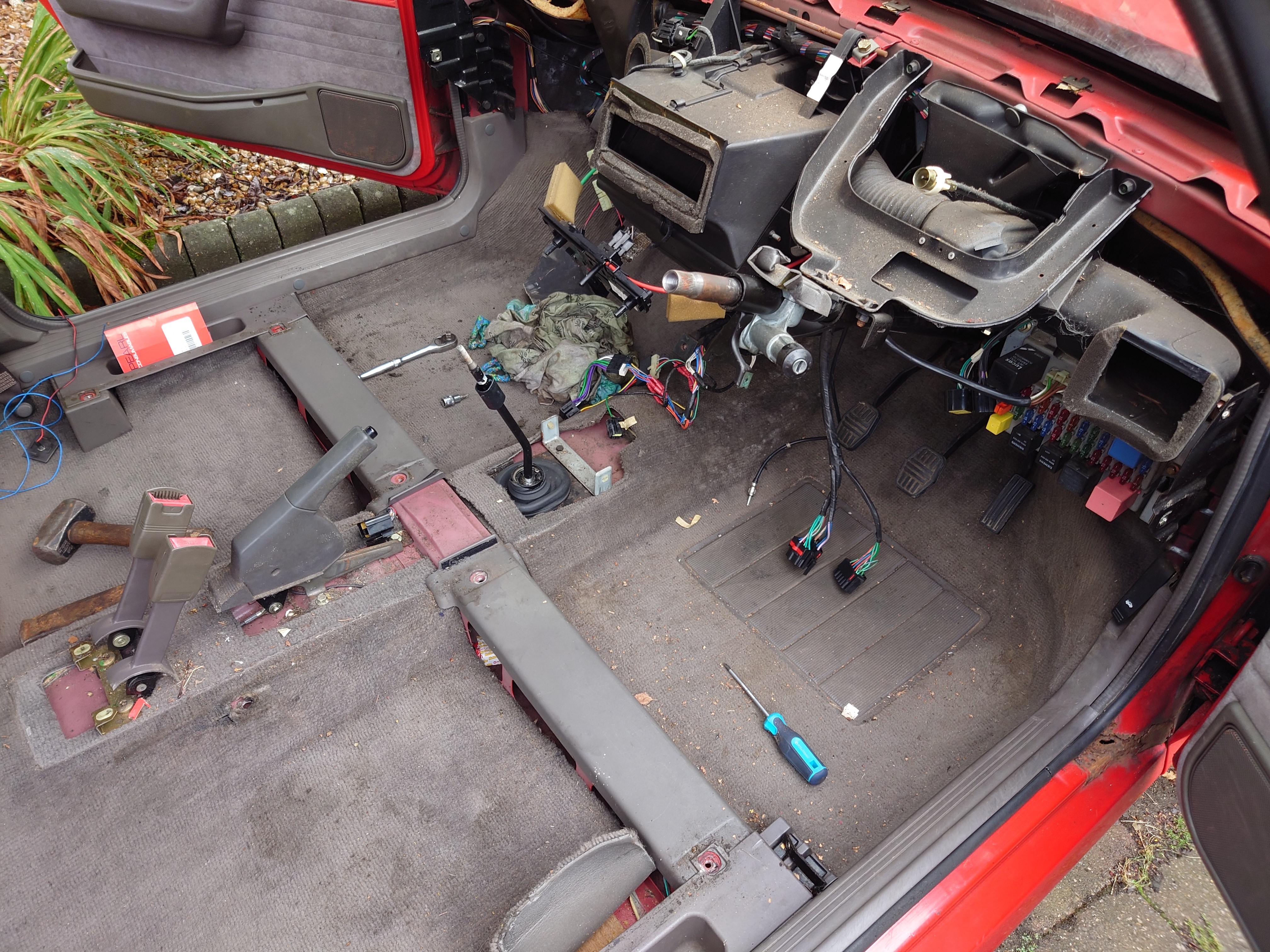

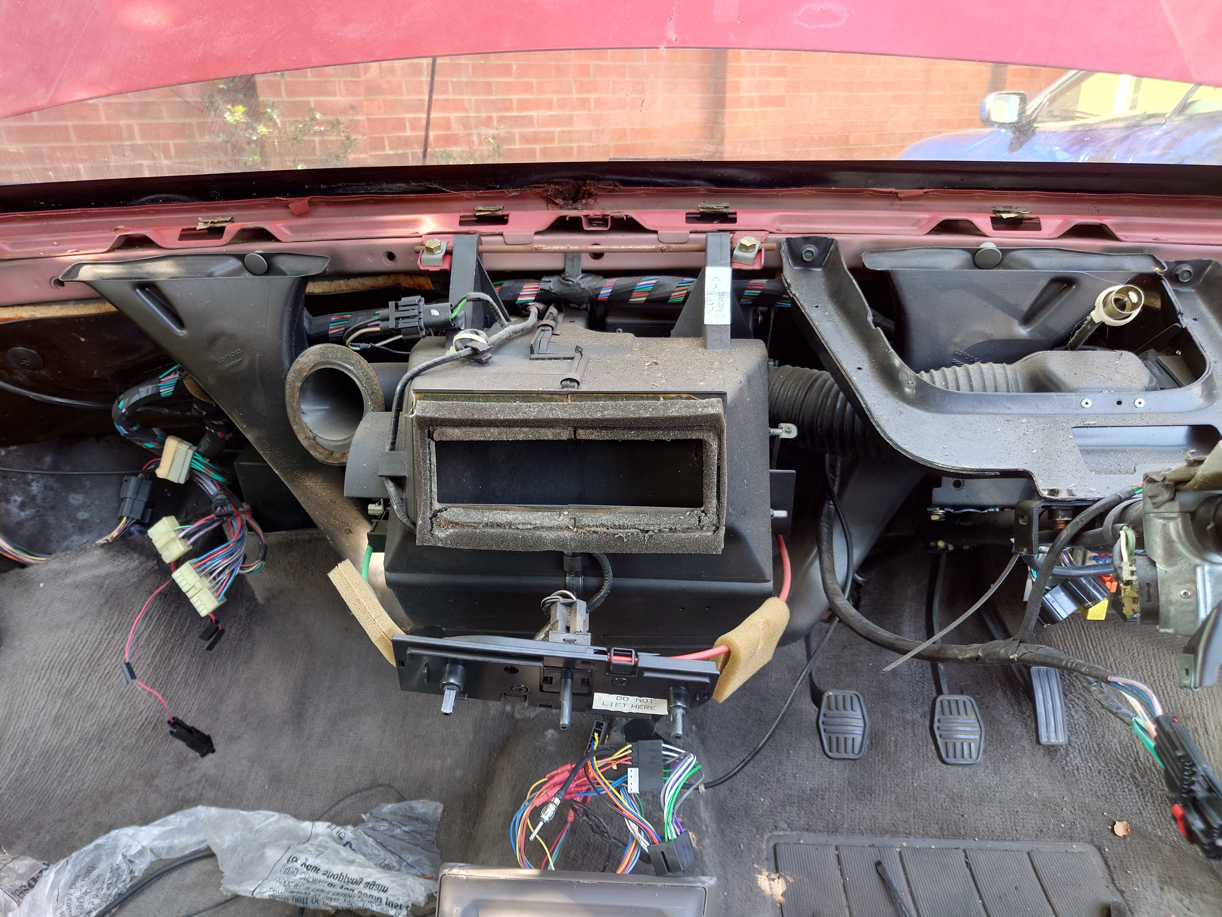

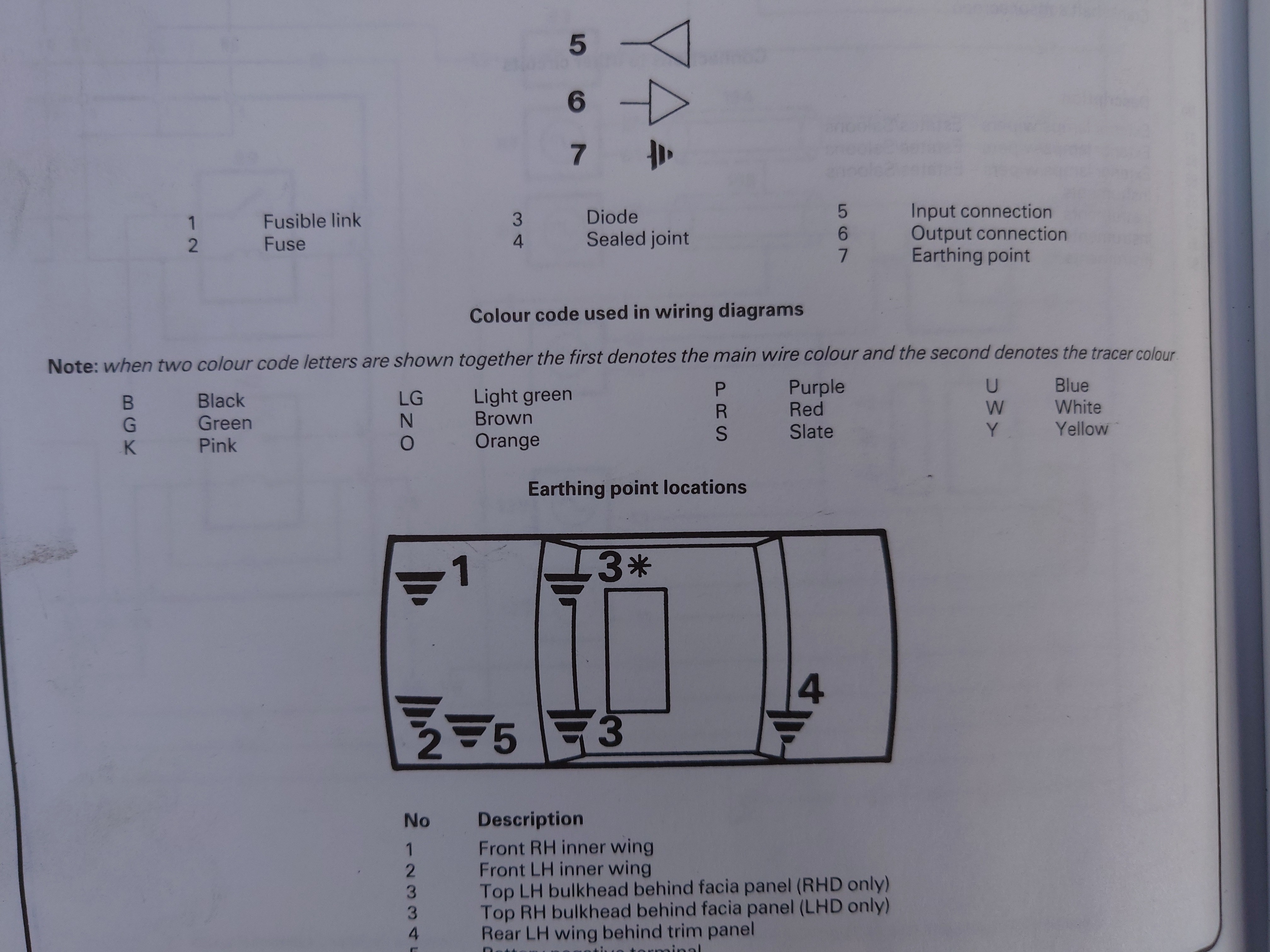

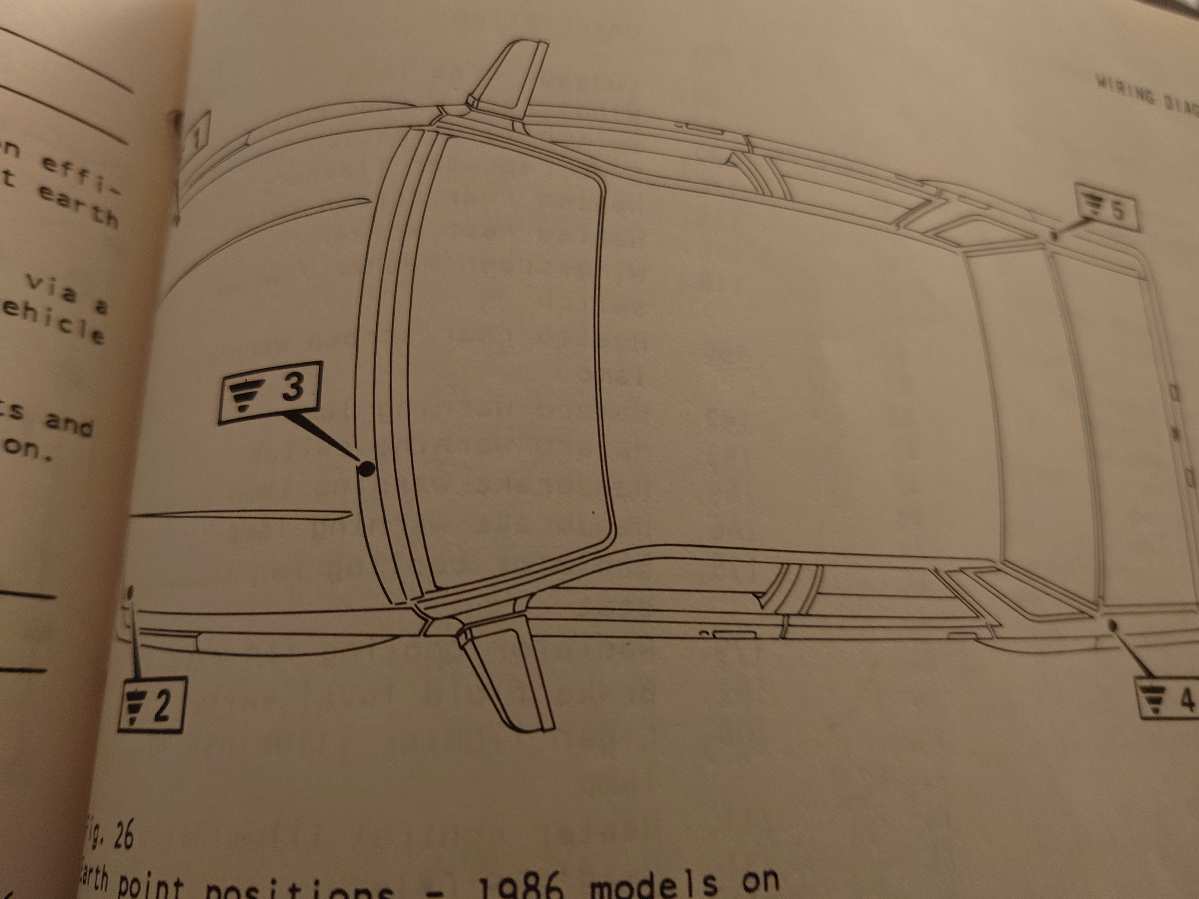

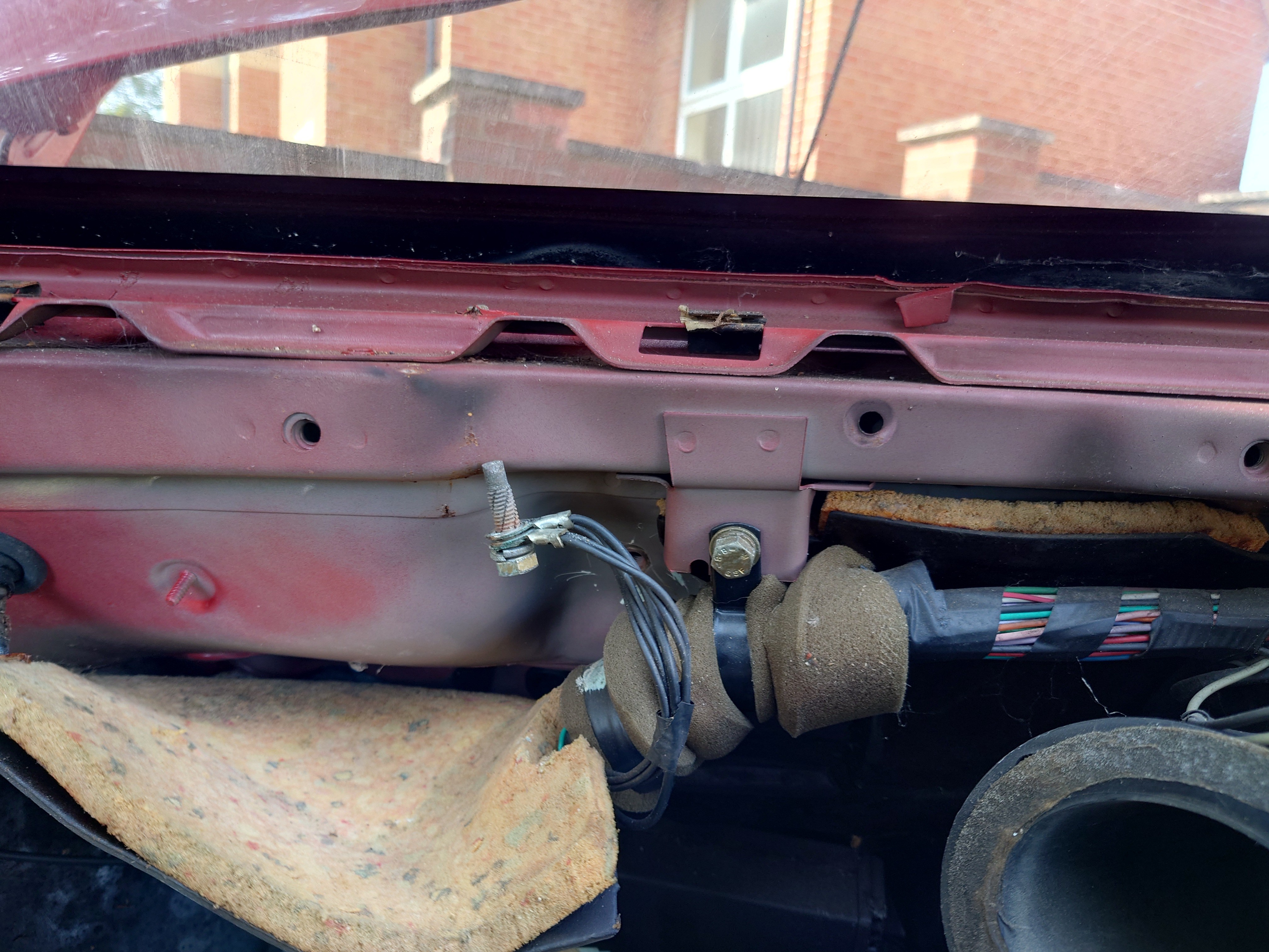

                  Did more research last night and tested again from my fast check this morning. No power to the injectors and the hazard lights light up on the dash so it's possibly an earthing issue, unfortunately it's behind the dash so that's coming out in the next couple of days
                  • #54
                    Dash out in 20 minutes and cleaned up the earth, also cleaned up the earth on the passenger side front behind the front light

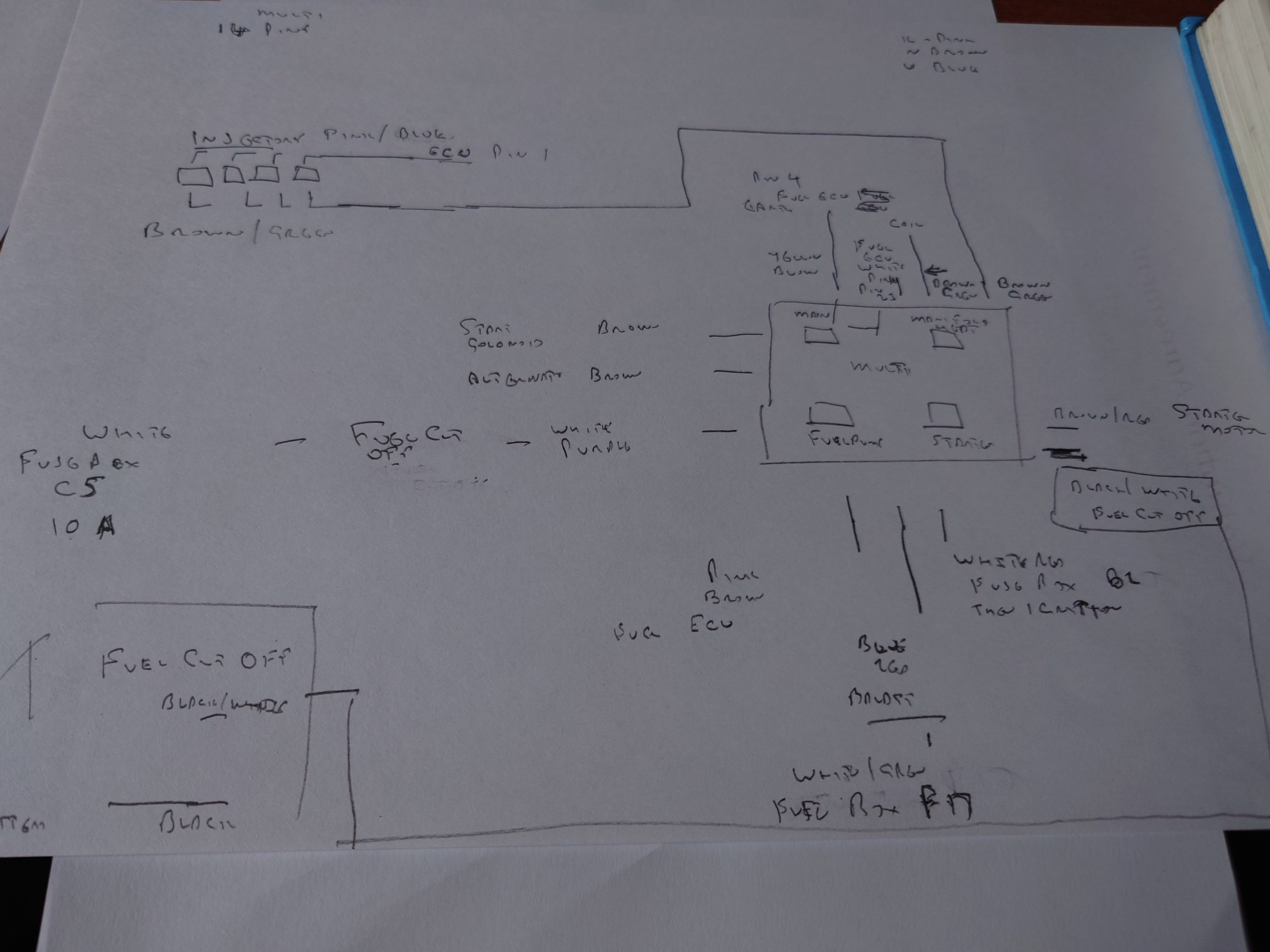

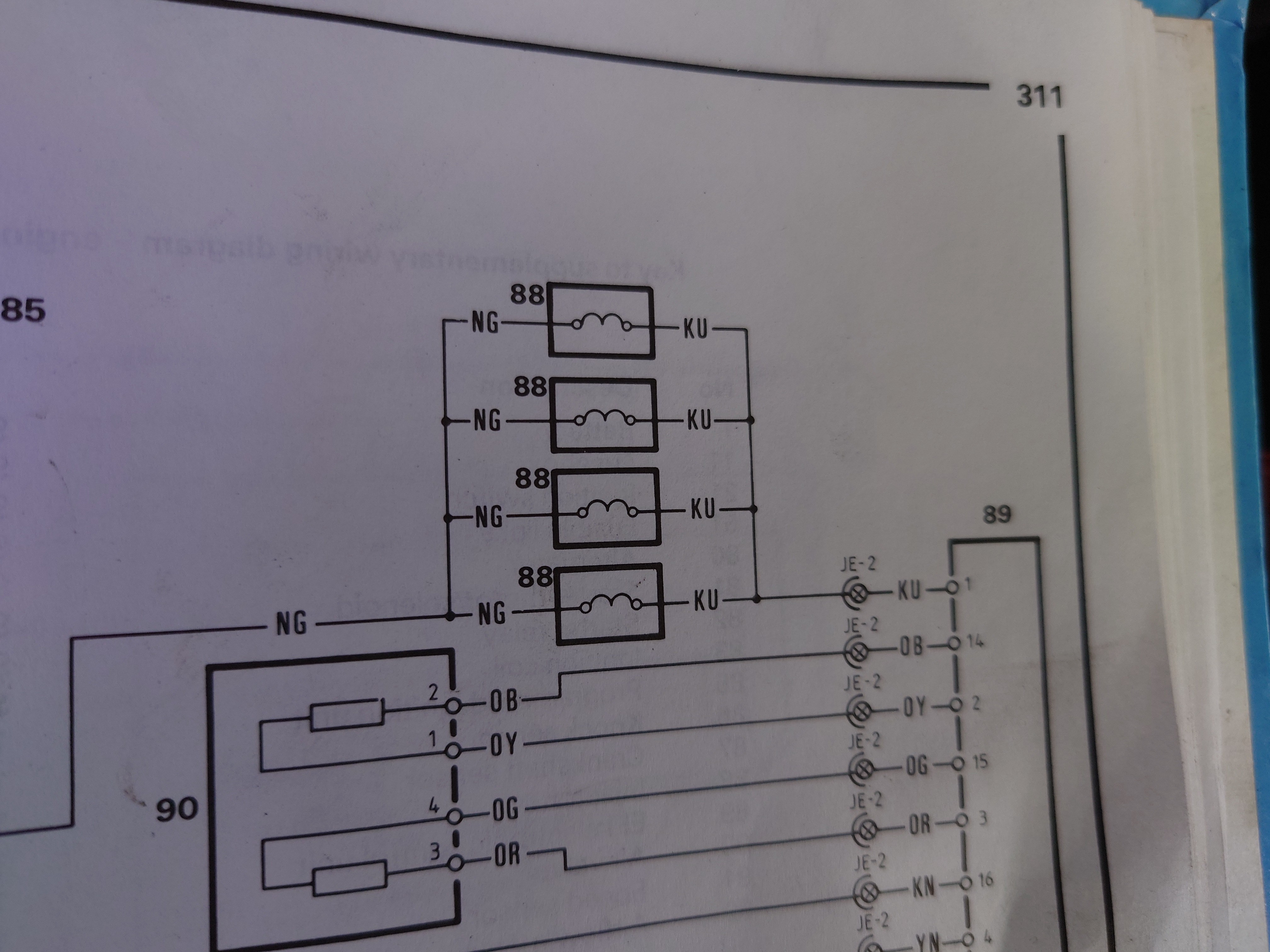

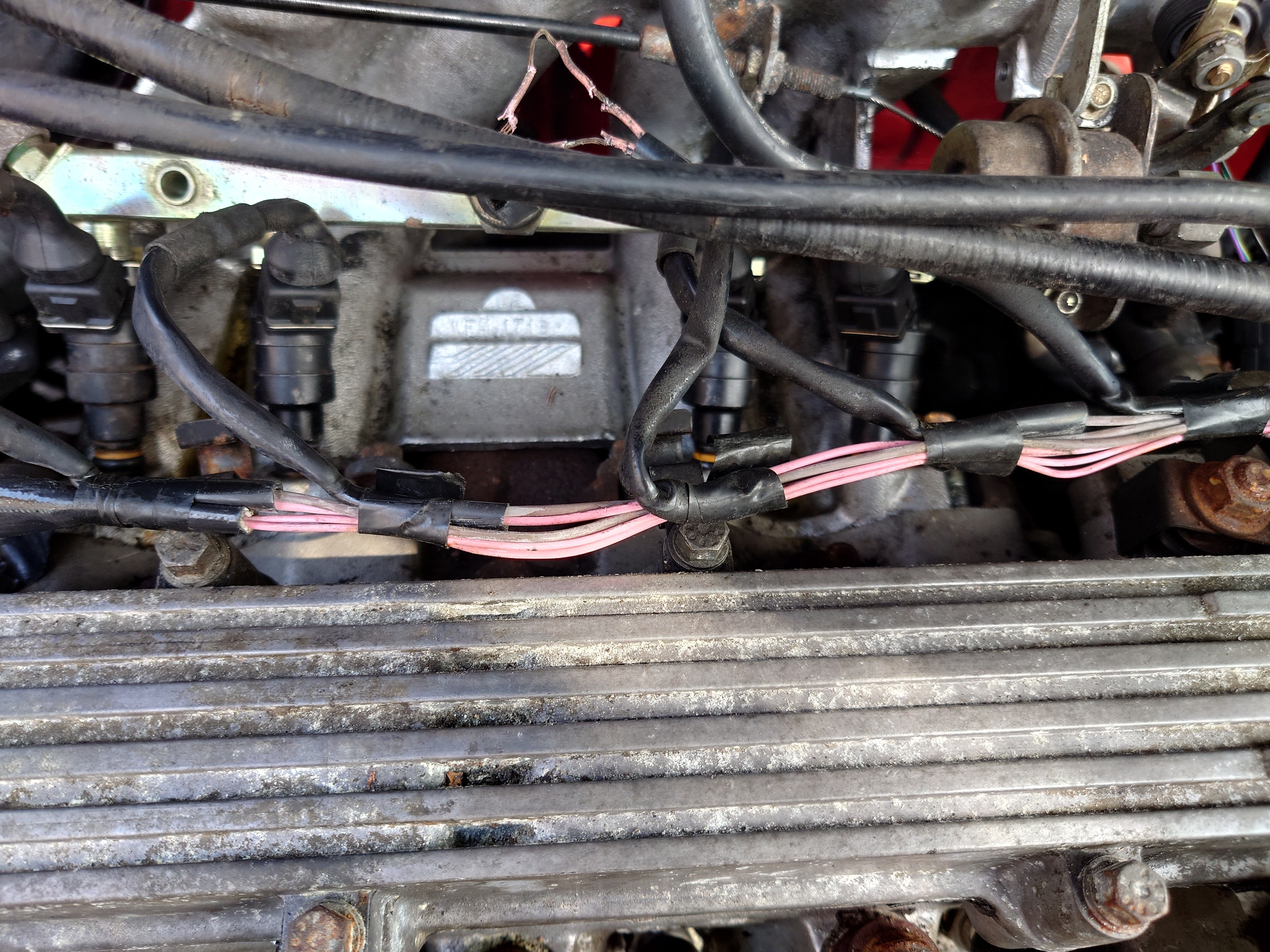

                      Unfortunately it wasn't that. but they did need a clean up The pump now primes, the stepper moves, the pump is pumping fuel when turning over, but the injectors are not doing anything. I tested one with a multimeter and there is resistance so they should work so I started stripping back the wiring. According to the Haynes book of lies which should cover the later models, the wiring is a different colour , it's never easy is it
                      With my fast check when I press injectors the light should come on and put a live to them so the pulse, but I'm getting nothing at all. All else is as it should be so maybe a wiring issue? This is why I'm starting to open the wiring up, unless someone has an idea what the problem is or something else I can look at ?
                      • #56

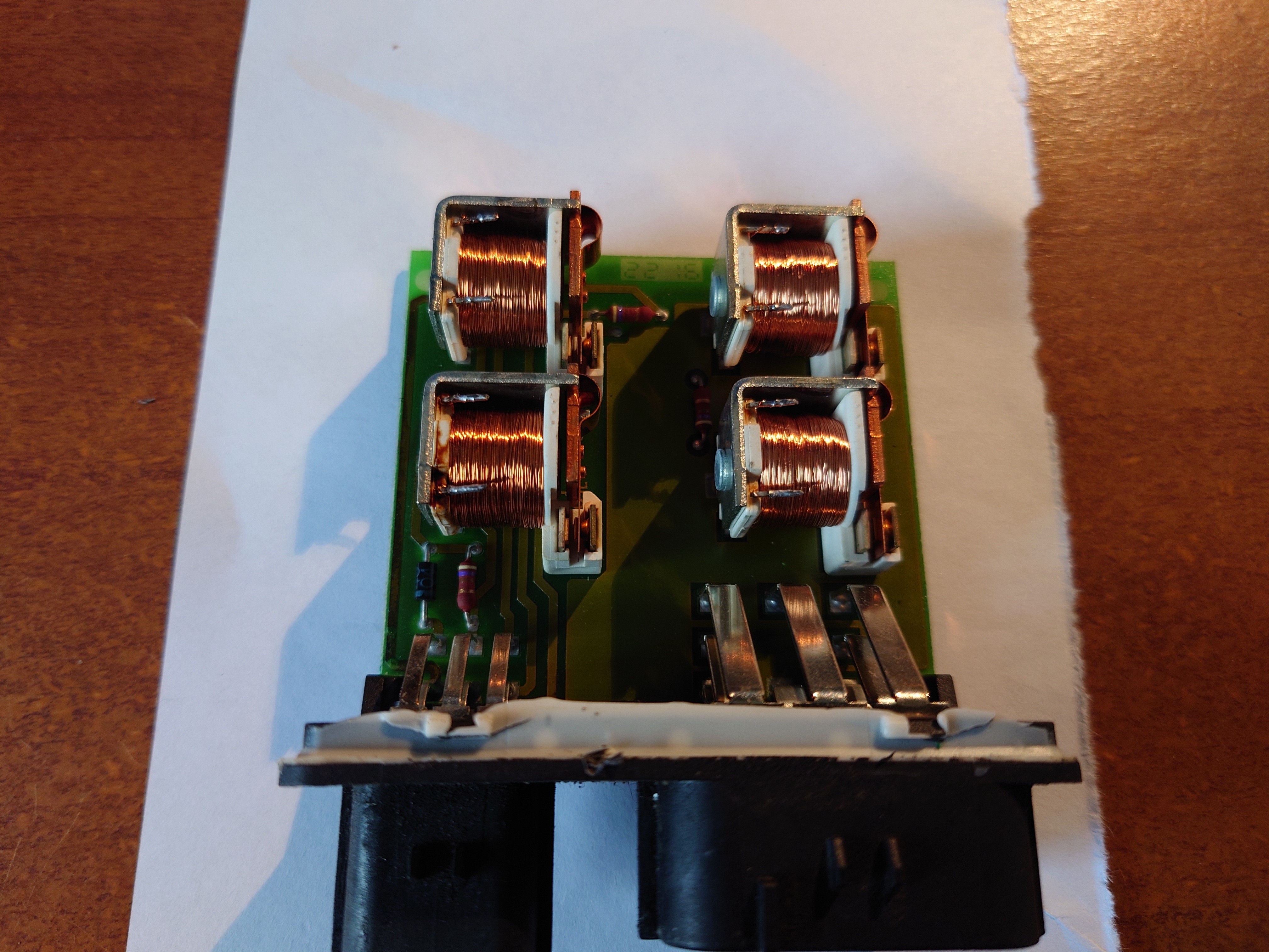

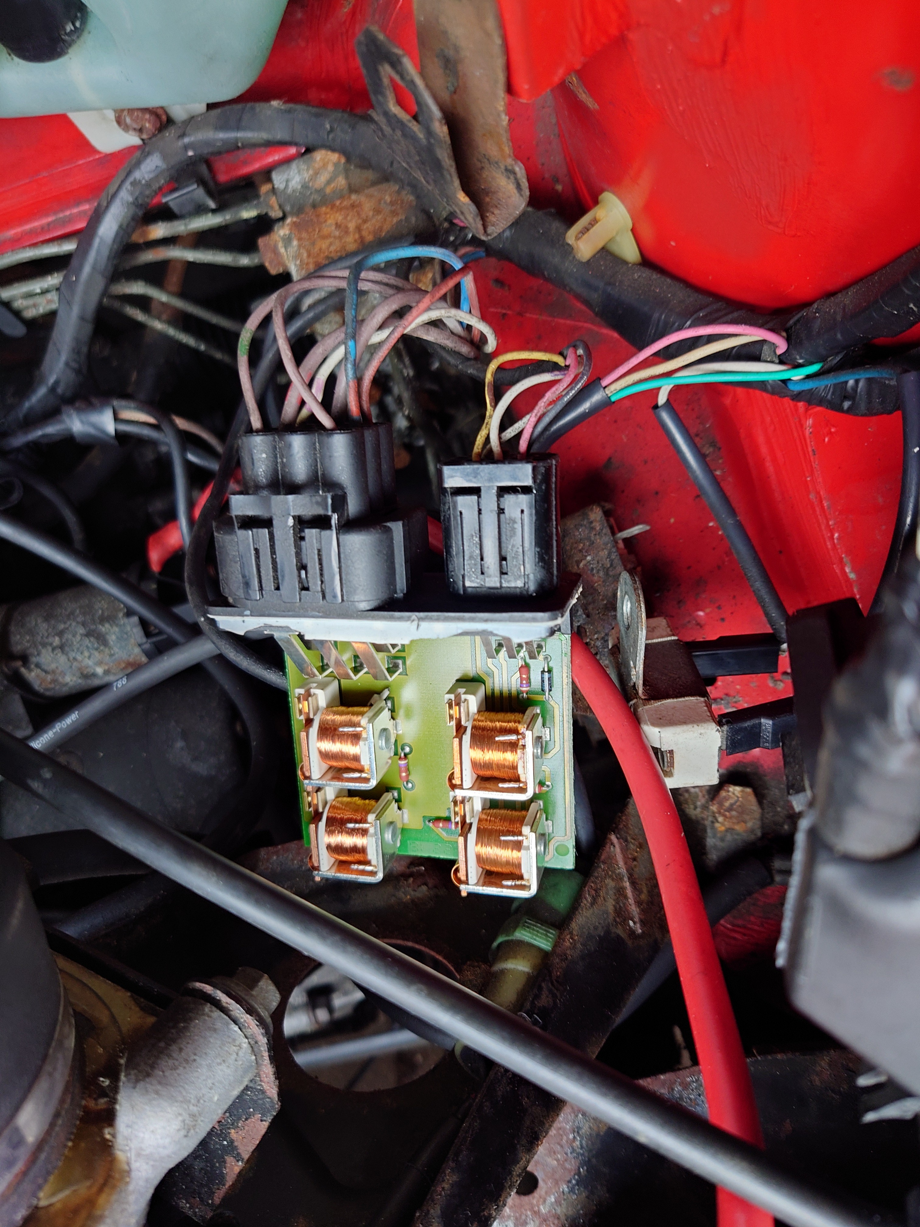

                        Lay mans wiring diagram and inside a multifunction unit, I will check everything before buying a new one from Rimmers as they're £132 each and I'm not sure yet that both are faulty

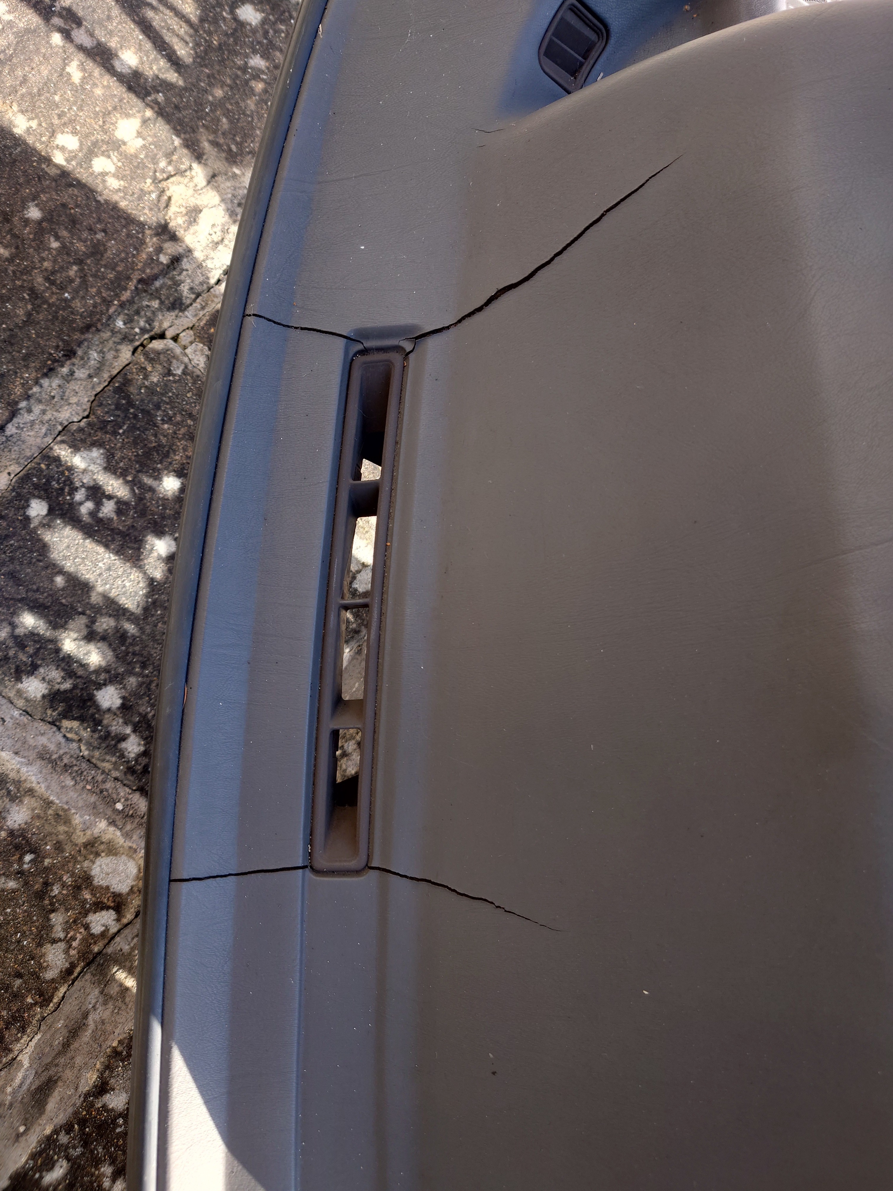

                        • #57

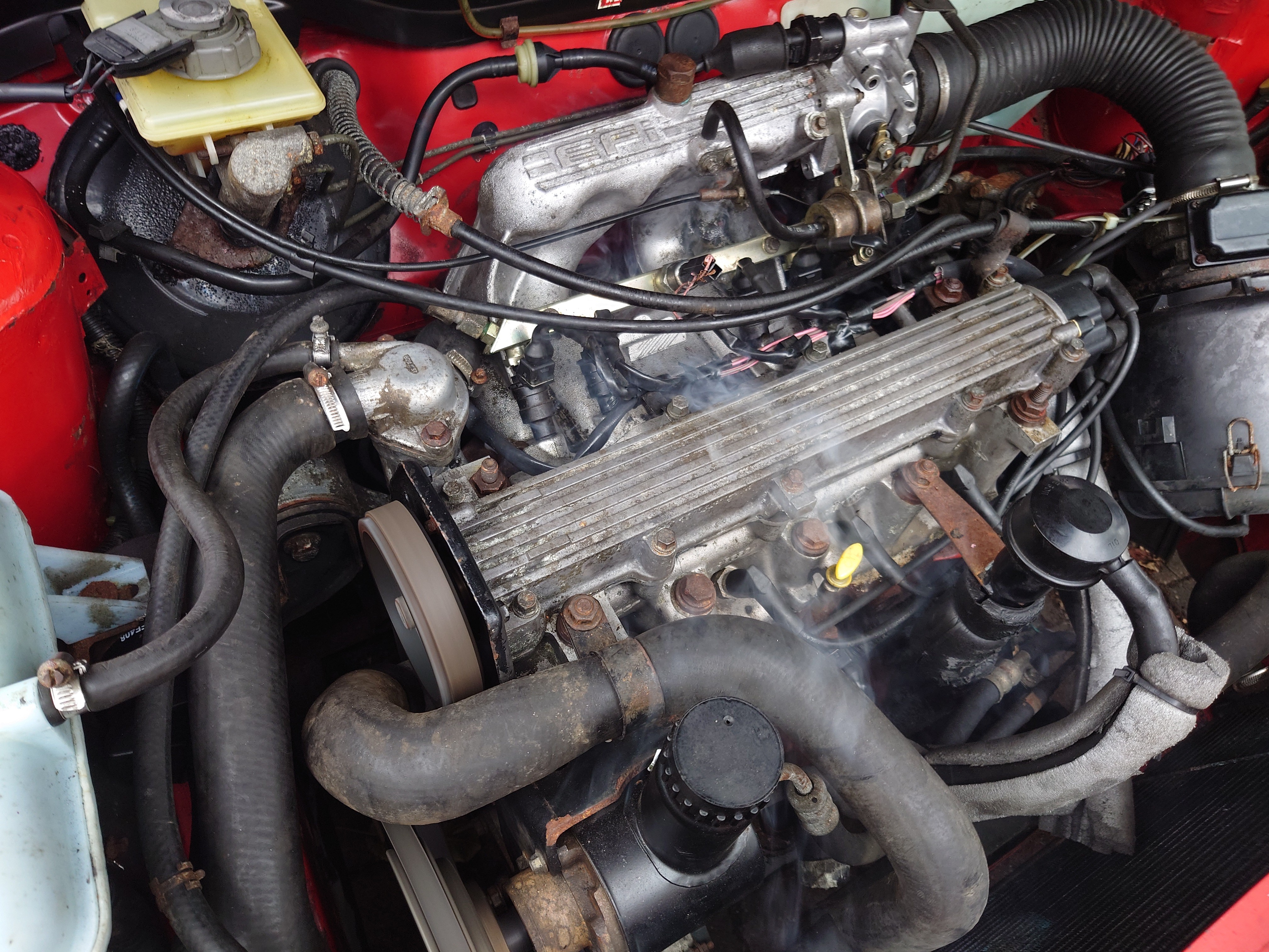

                          It's finally running after 5 years and was a mixture of issues. Main relay contacts dirty, crack in a wire to the injectors, bad earth and one injector stuck. Who in their right mind would only put different colours on the end of the wiring. Now starts and runs and I've tidied up the wiring I stripped out so will have to put the dash back in next time. It's quite knackered with cracks everywhere but I do have a better last spare so will put that in after i've removed the interior and headliner.

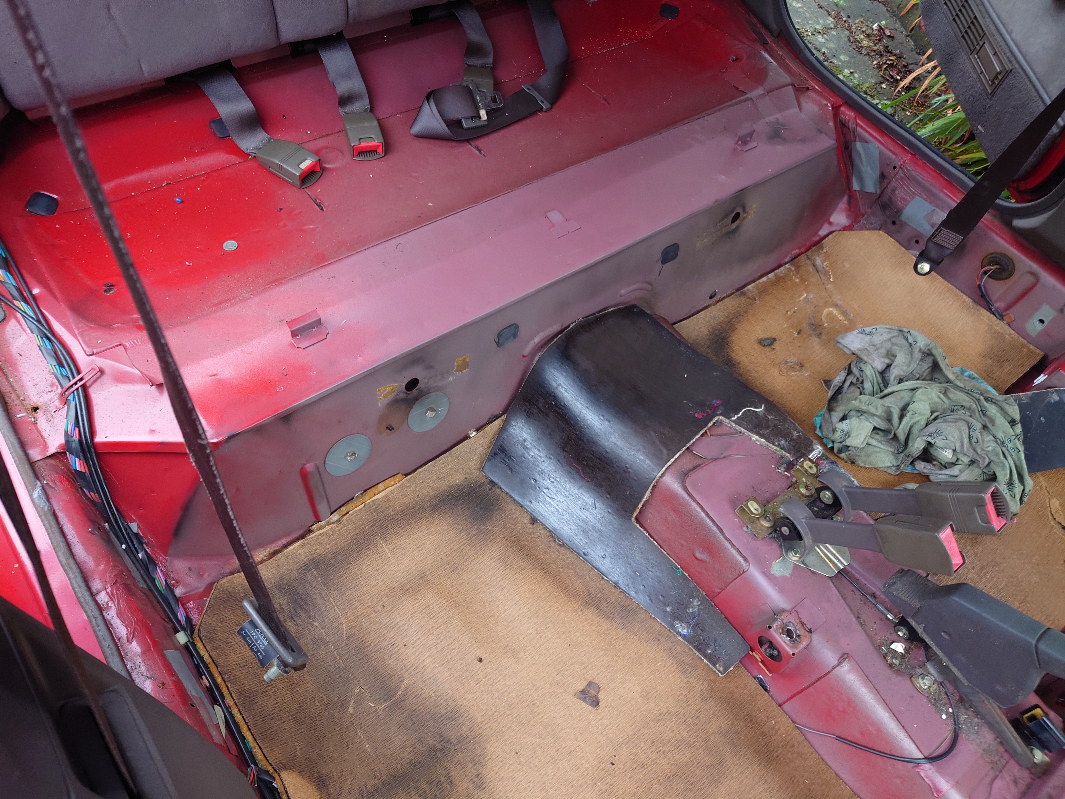

                          • #58

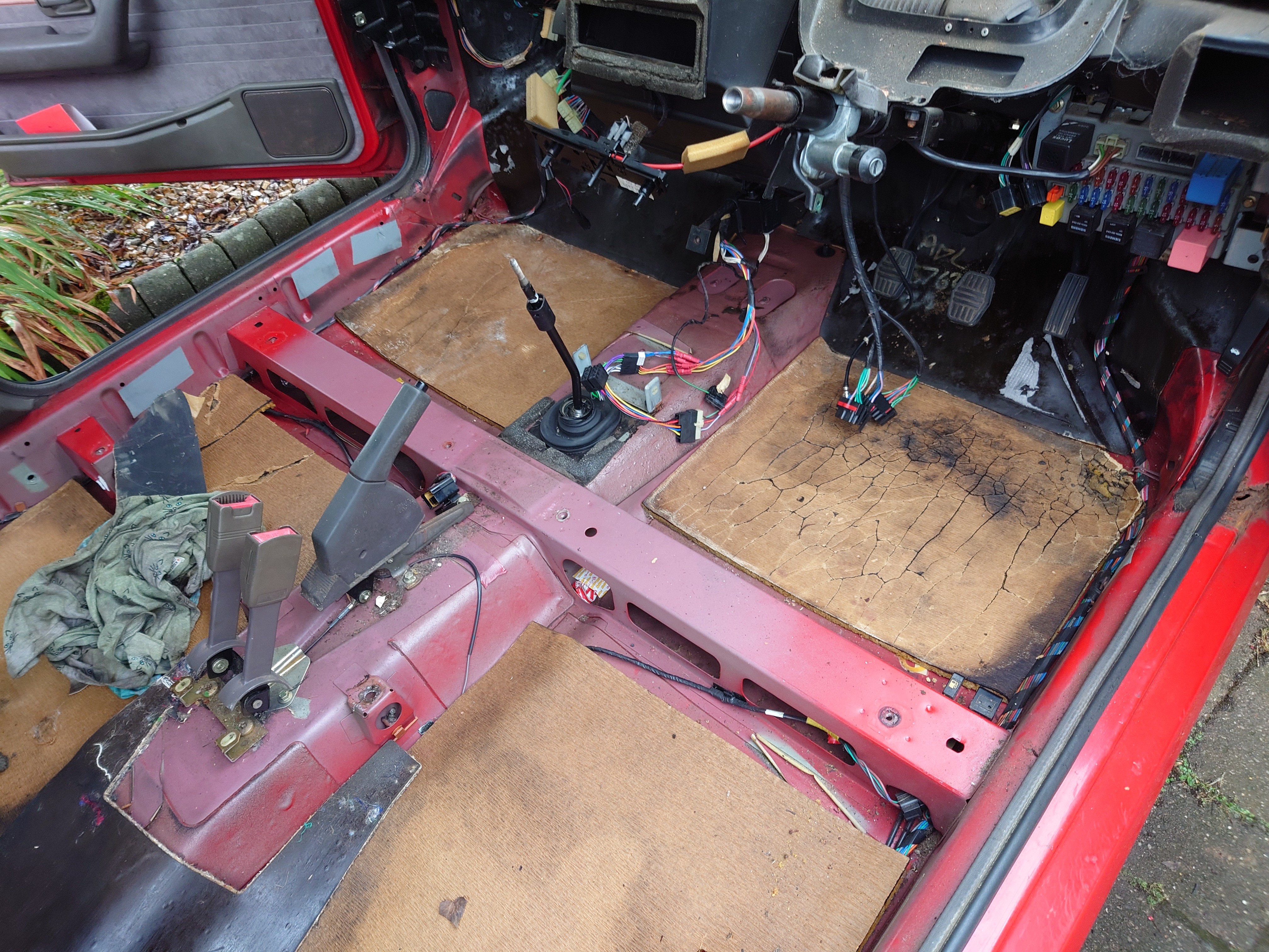

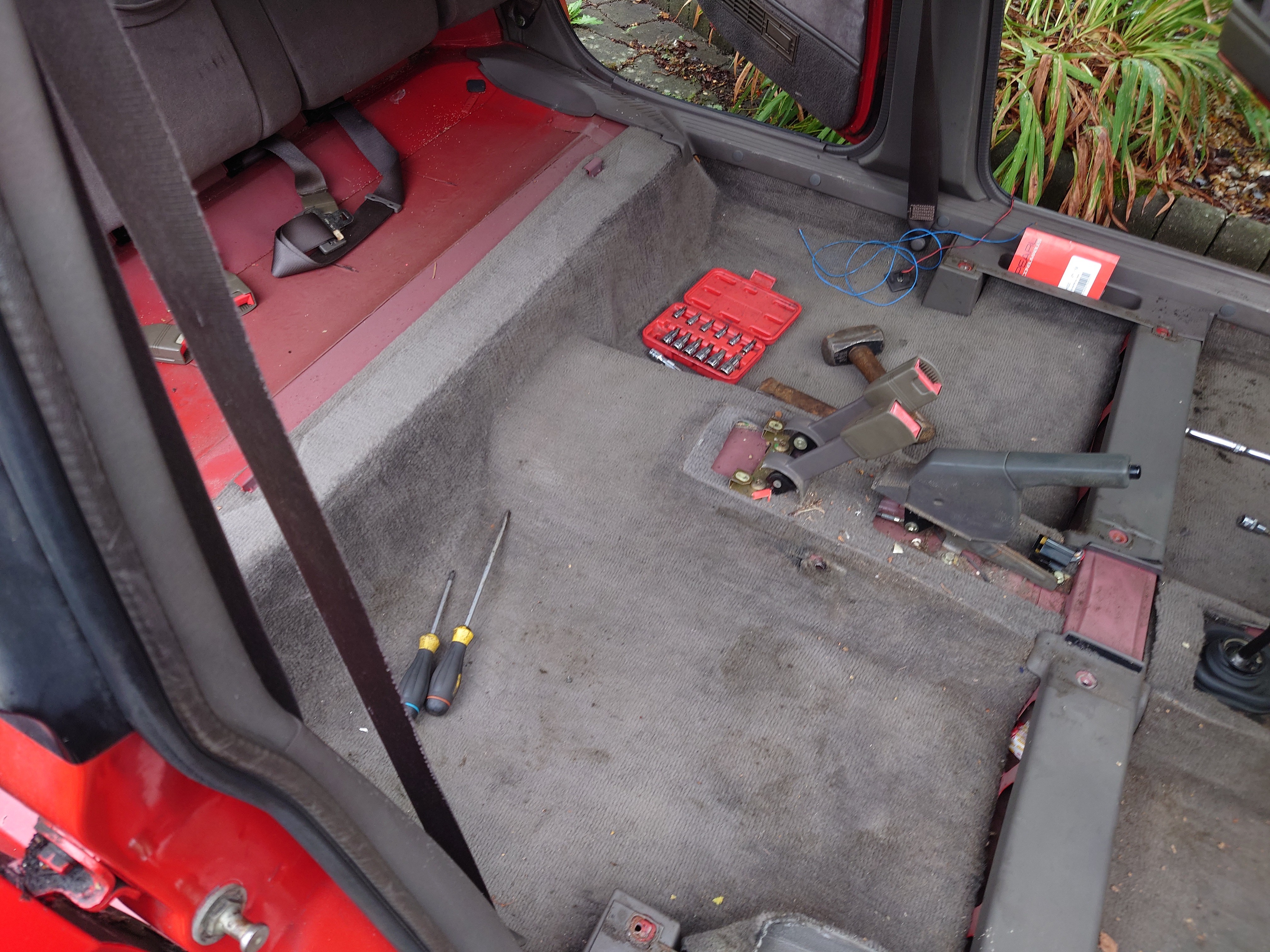

                            Interior removed and now all ready to start grinding out rust and continue practicing my welding. It's mainly the rear box sections, a few things on the sills and I'm hoping to tidy up previous welding bodges.

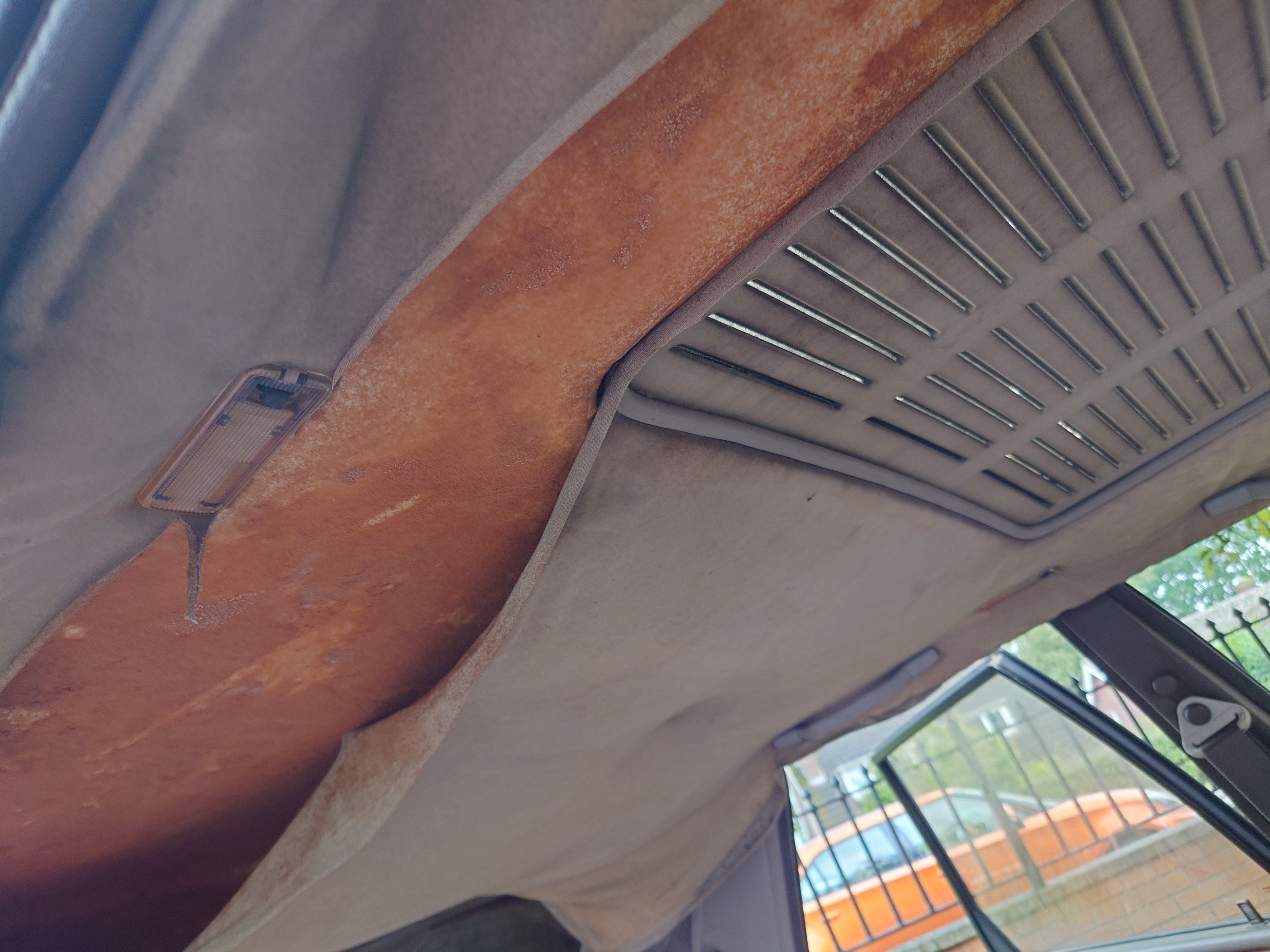

                            • #59
                              Then it's this, the headlining and sunroof

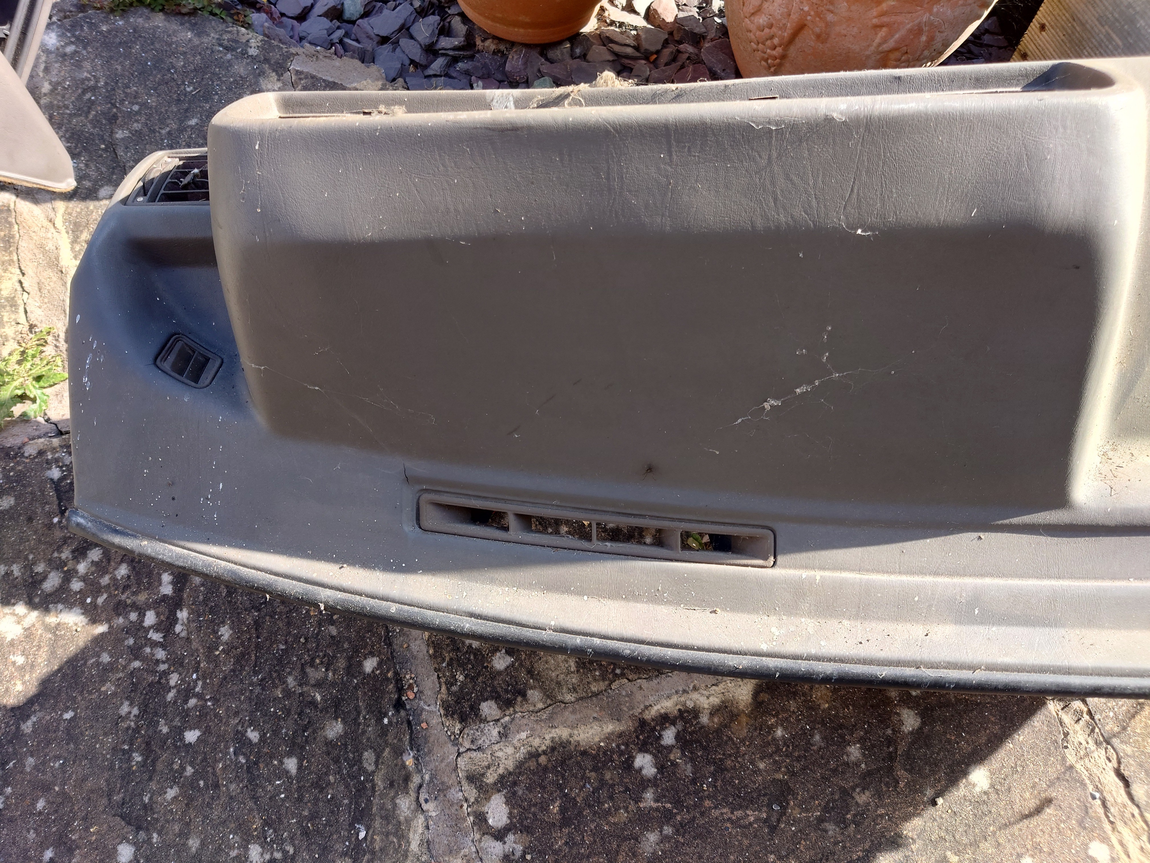

                              • #60
                                Picked up my last good dash this afternoon from my spares lock up Out with the knackered and this will be going in after a cleanup
