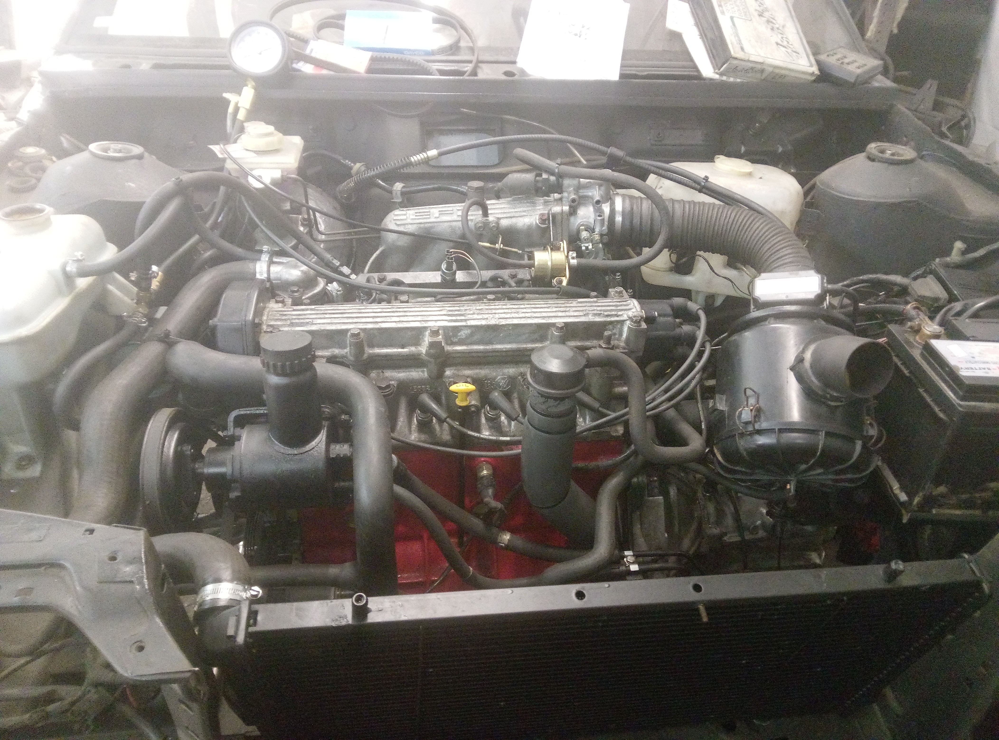

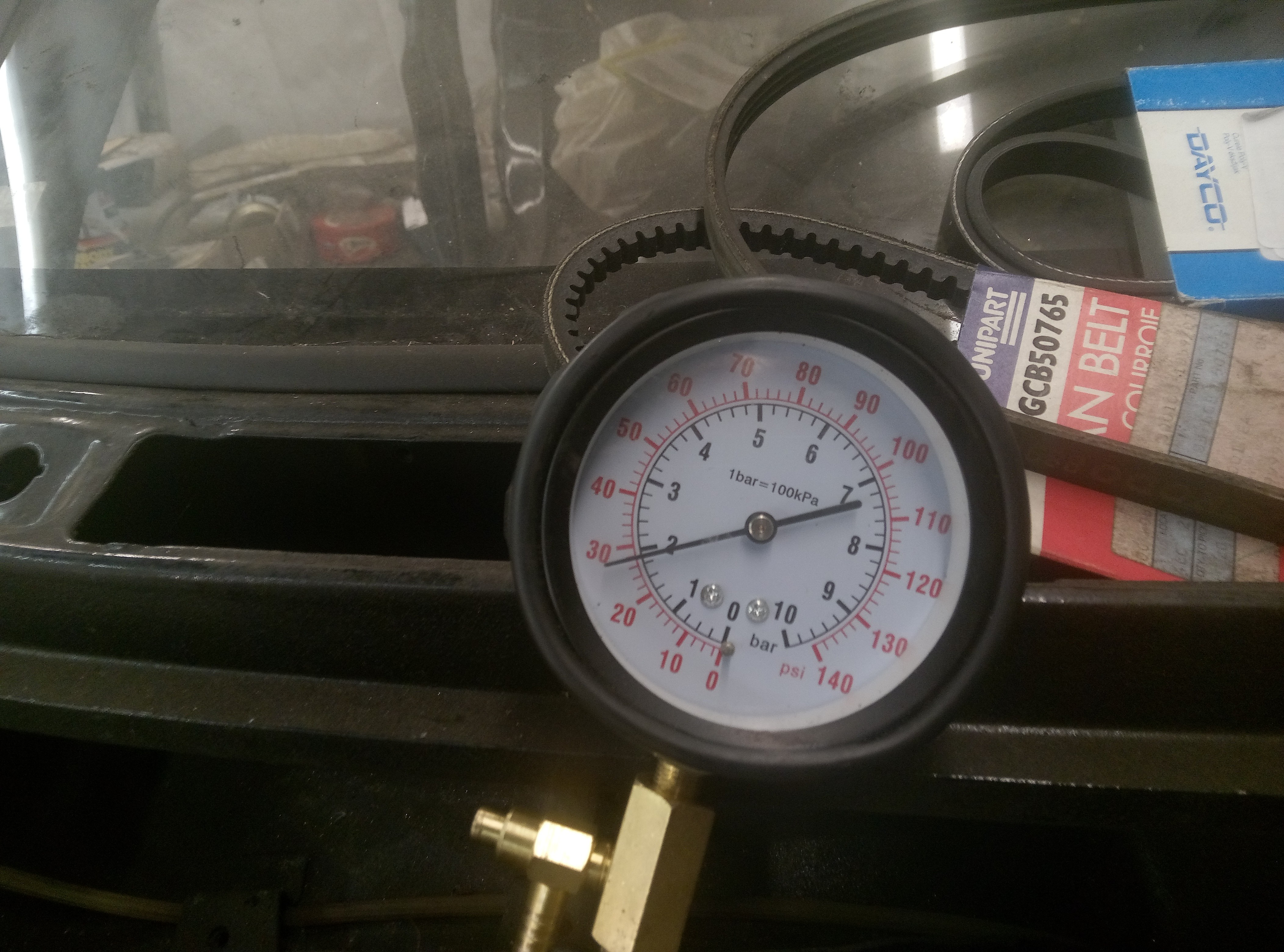

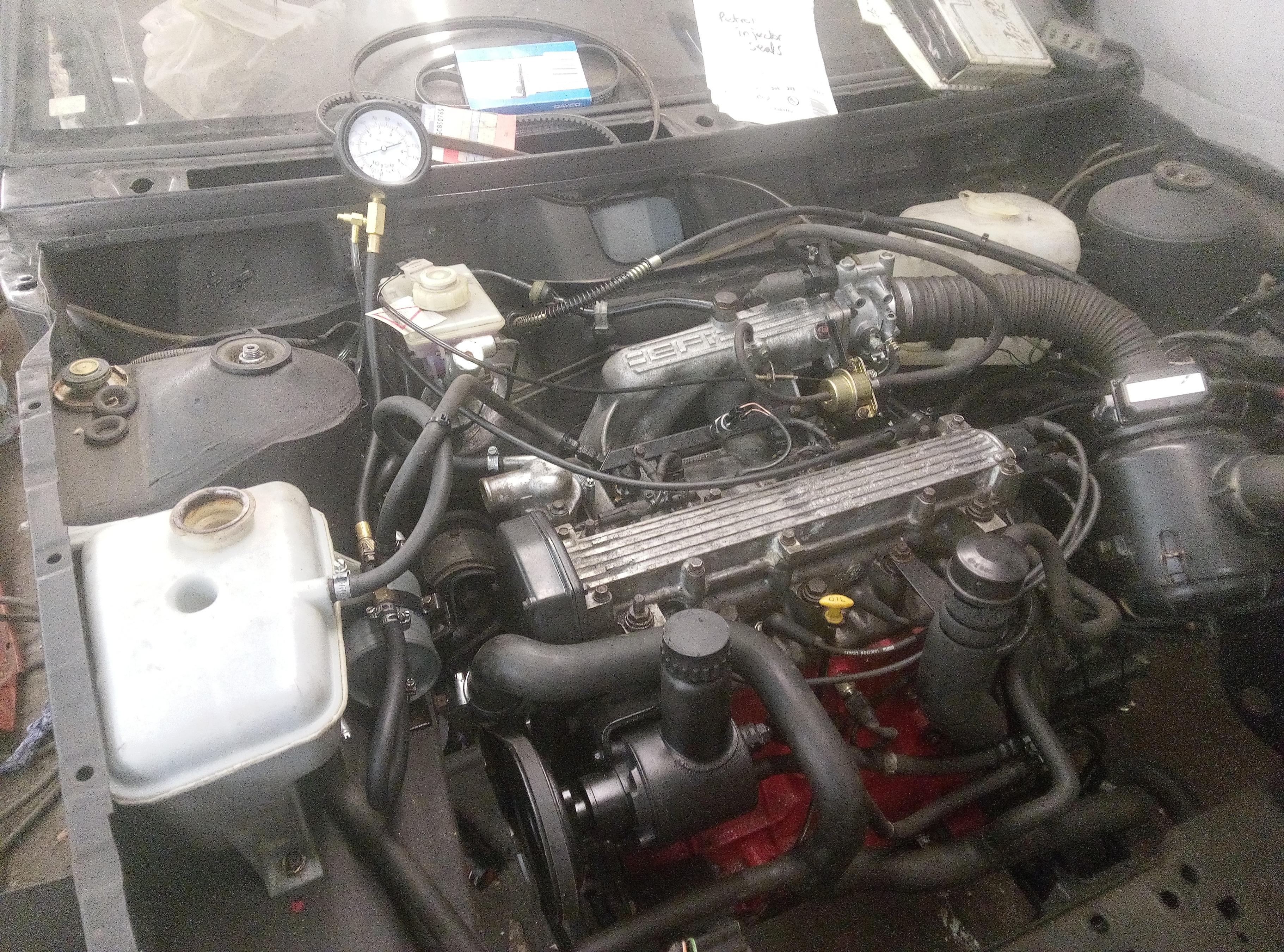

    This is how it looks now, made up a removeable mounting plate for the radiator, covering the cut out for the M16/T16 power steering pump & filled rad with Evan's waterless coolant. Engine started very quickly, when cranking the fuel pressure was about 40 psi, which is what I expected from the Volvo regulator, but it dropped to about 30 when the engine was running. I suspect that this is caused by either a faulty ballast resistor, or the replacement (I think Chinese) injectors are shovelling too much fuel in...it did restart ok, so maybe not the injectors at fault. I decided to investigate further when I have the garage doors open tho', finding the fault just before being gassed would be a bit counter productive . Only other minor annoyance was that the plugs on the injectors were a bit short, I modified them to get it to work, if they turn out to be ok I'll fit the new style plugs that I got at the auto jumble at today's show.

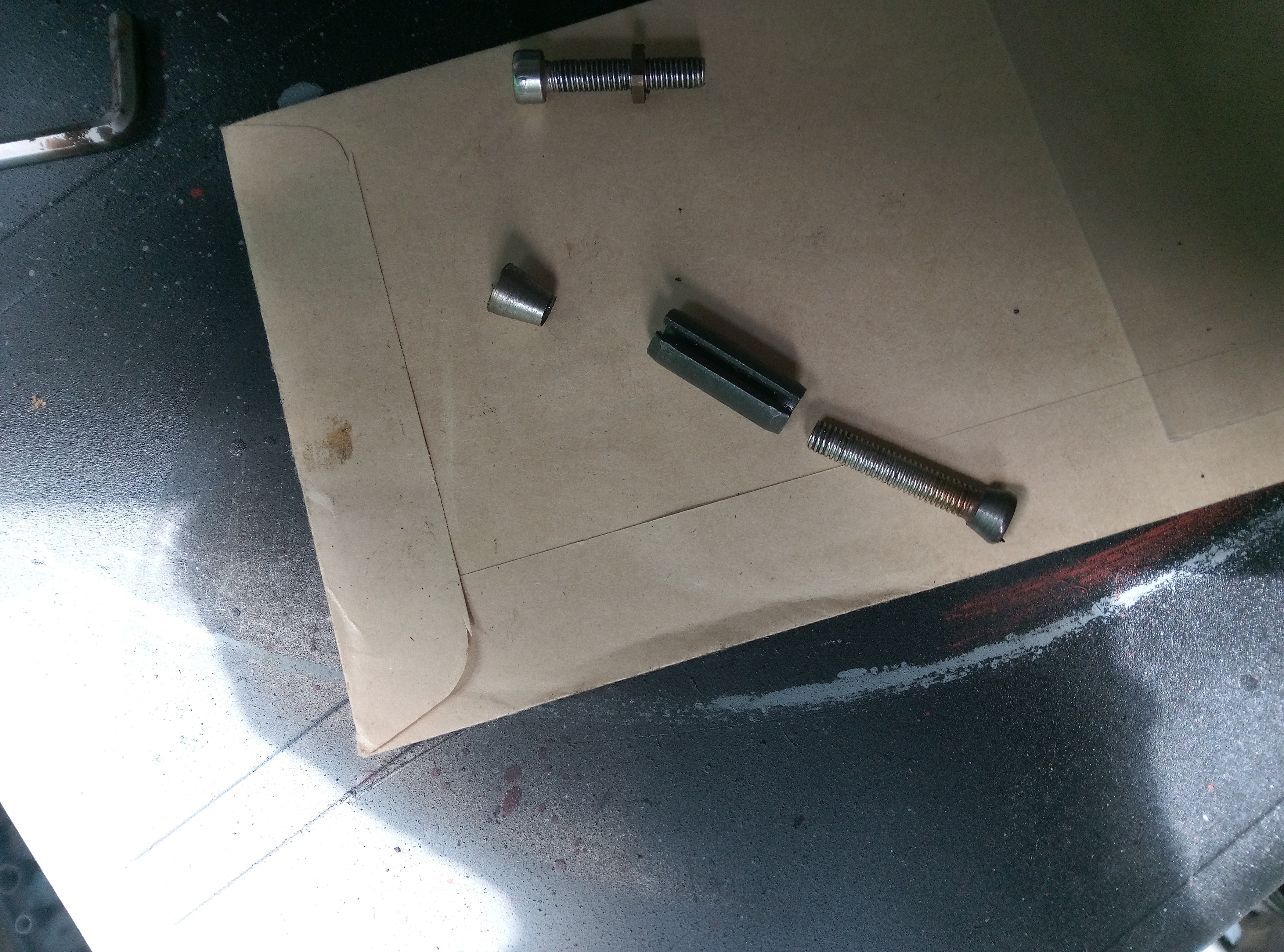

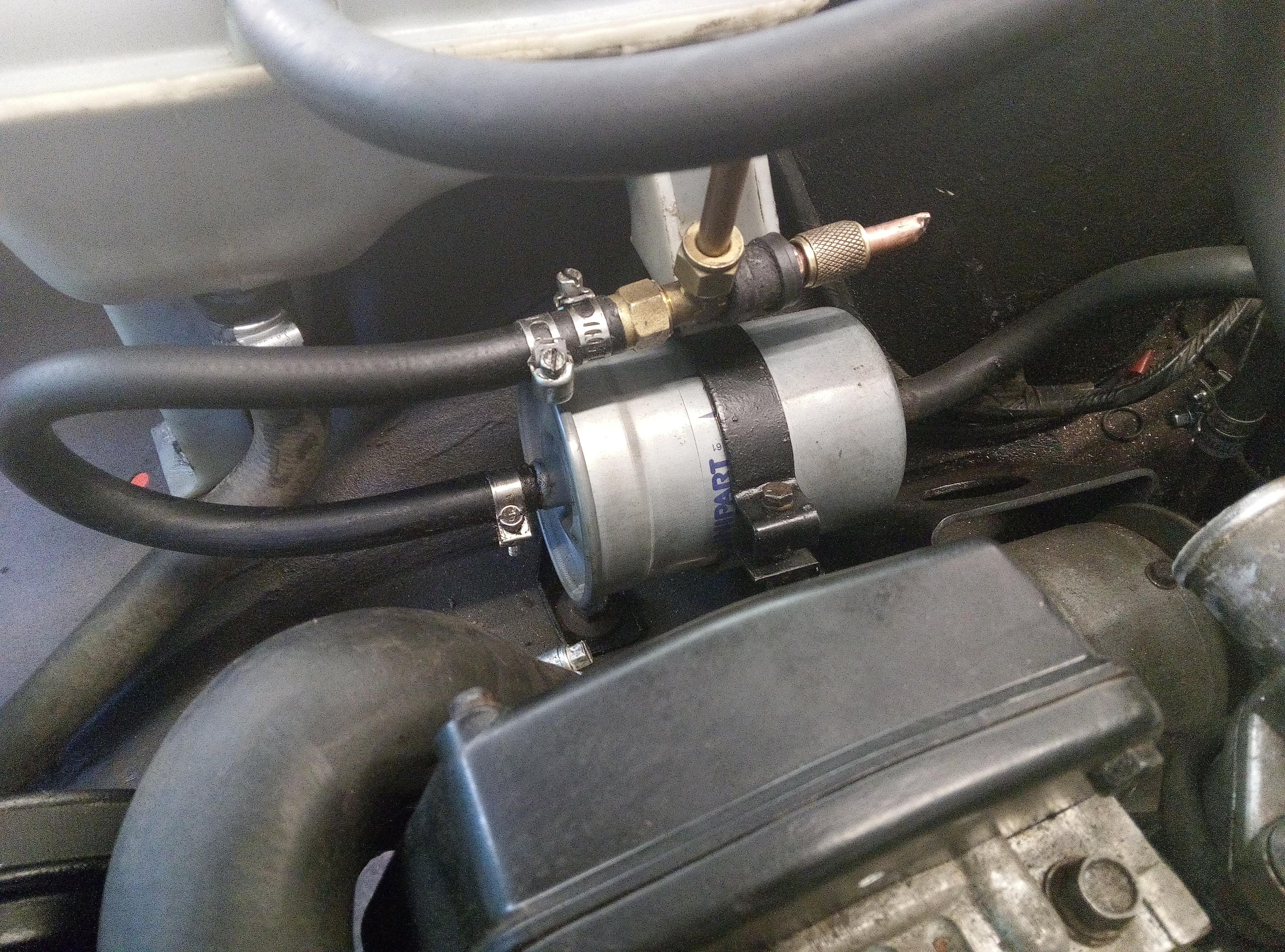

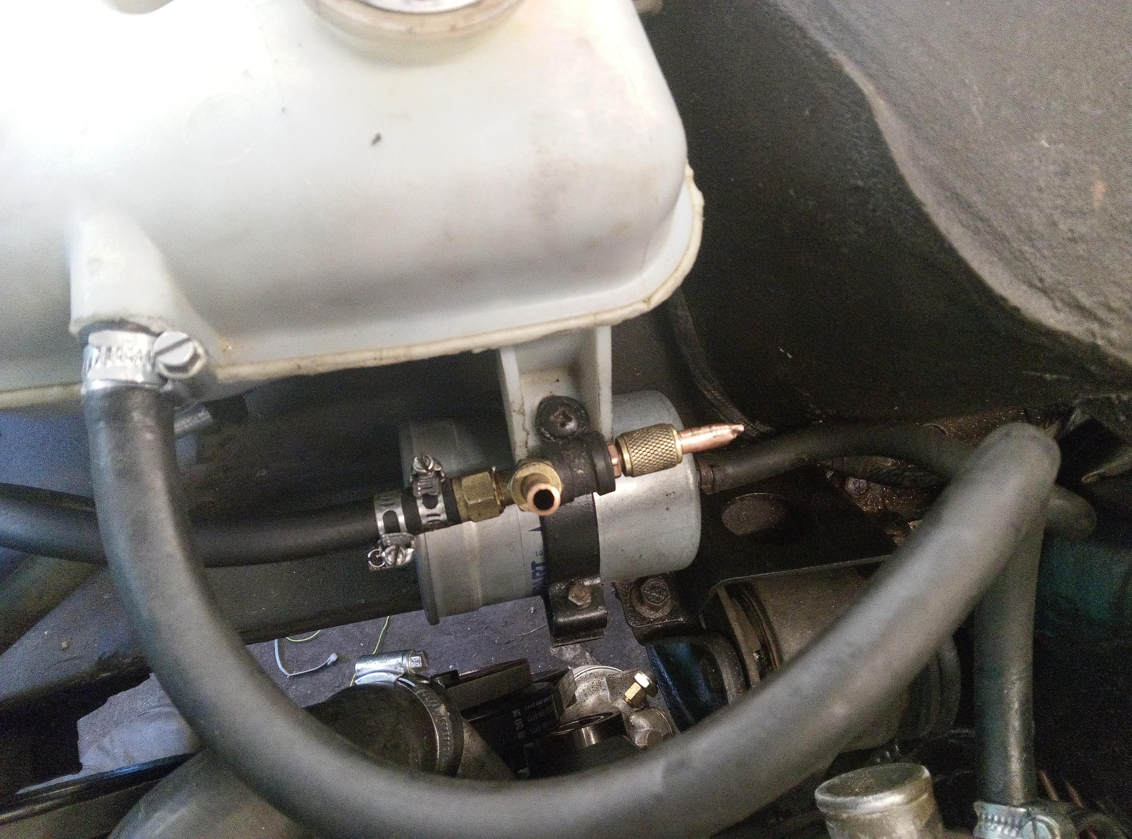

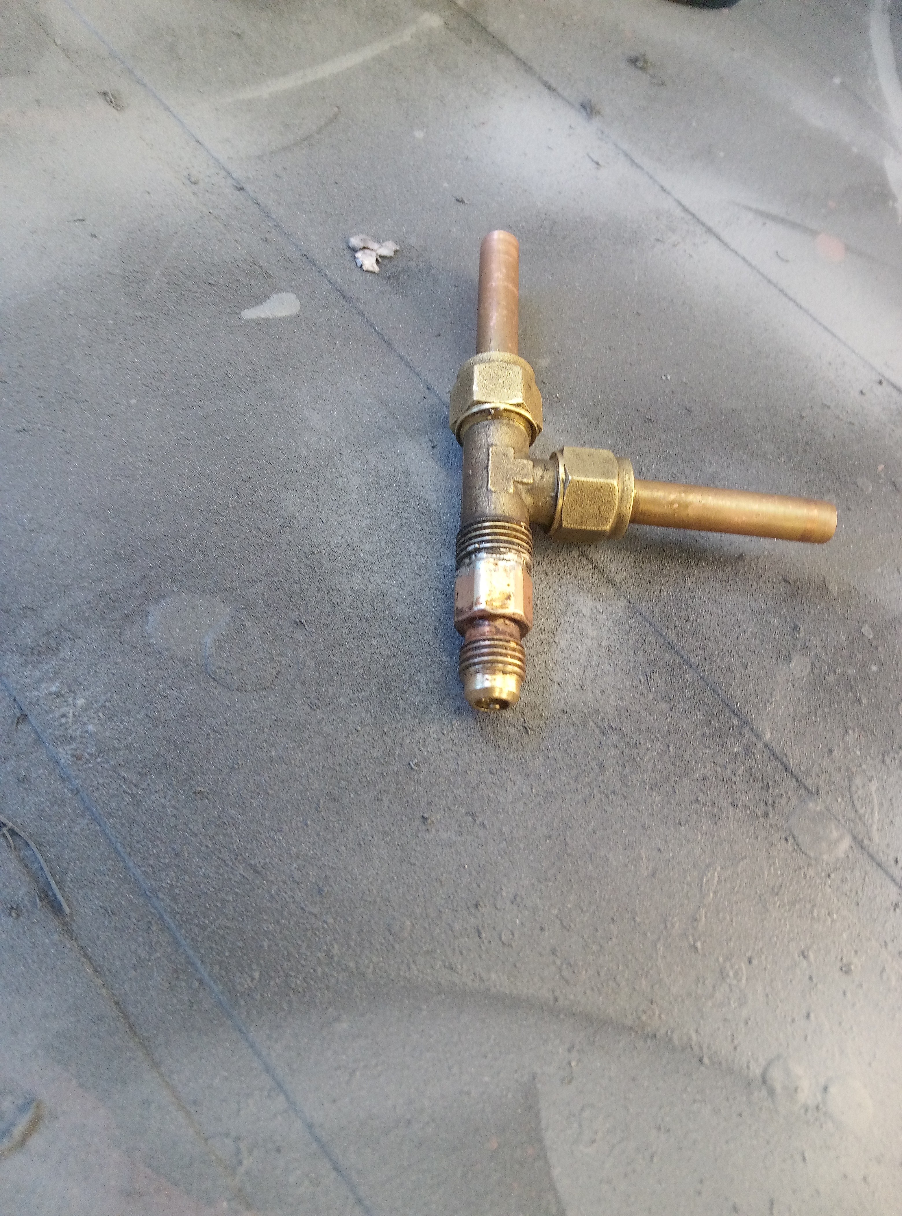

    Got a bit more done, there was a tiny amount of play on the gear linkage, so I made a roll pin end spreader up on the lathe, must remember that I did this if it is ever to dismantle...it is very tight now! Having a schraeder connection on the fuel line so that a pressure gauge can be fitted without having petrol escaping all over the place seemed like a good plan, so I did a bit more machining and soldering. On the minus side I discovered that the round fuel rail that Jeff kindly supplied only fits the old type manifold, I do have a new one of these, but was too idle to take everything to bits again to fit it! On the plus side I can assemble the old style manifold with the new genuine regulator etc so there is a back up plan if there are any problems with the volvo regulator etc on the newer style set up with the square rail....

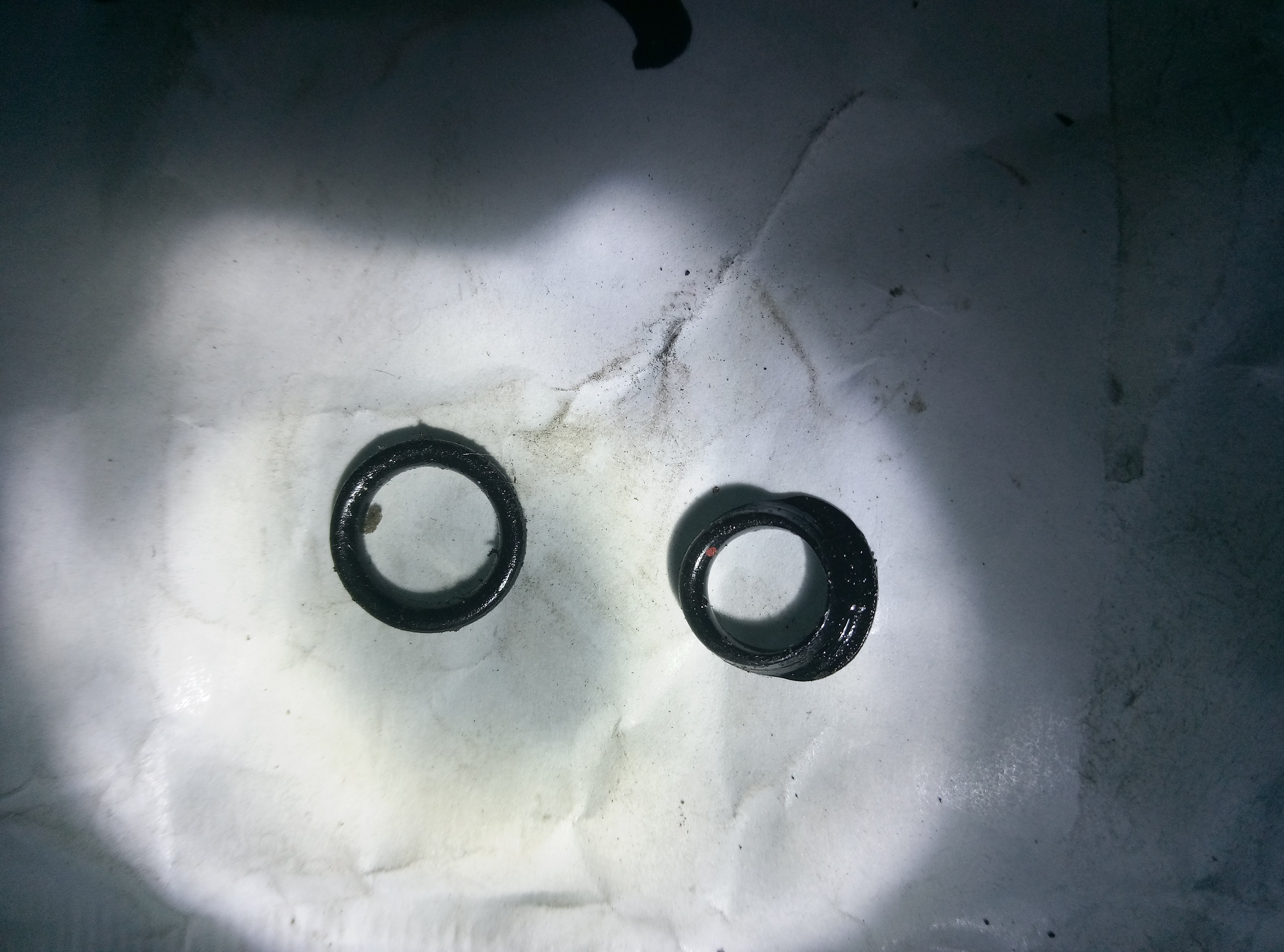

    replied

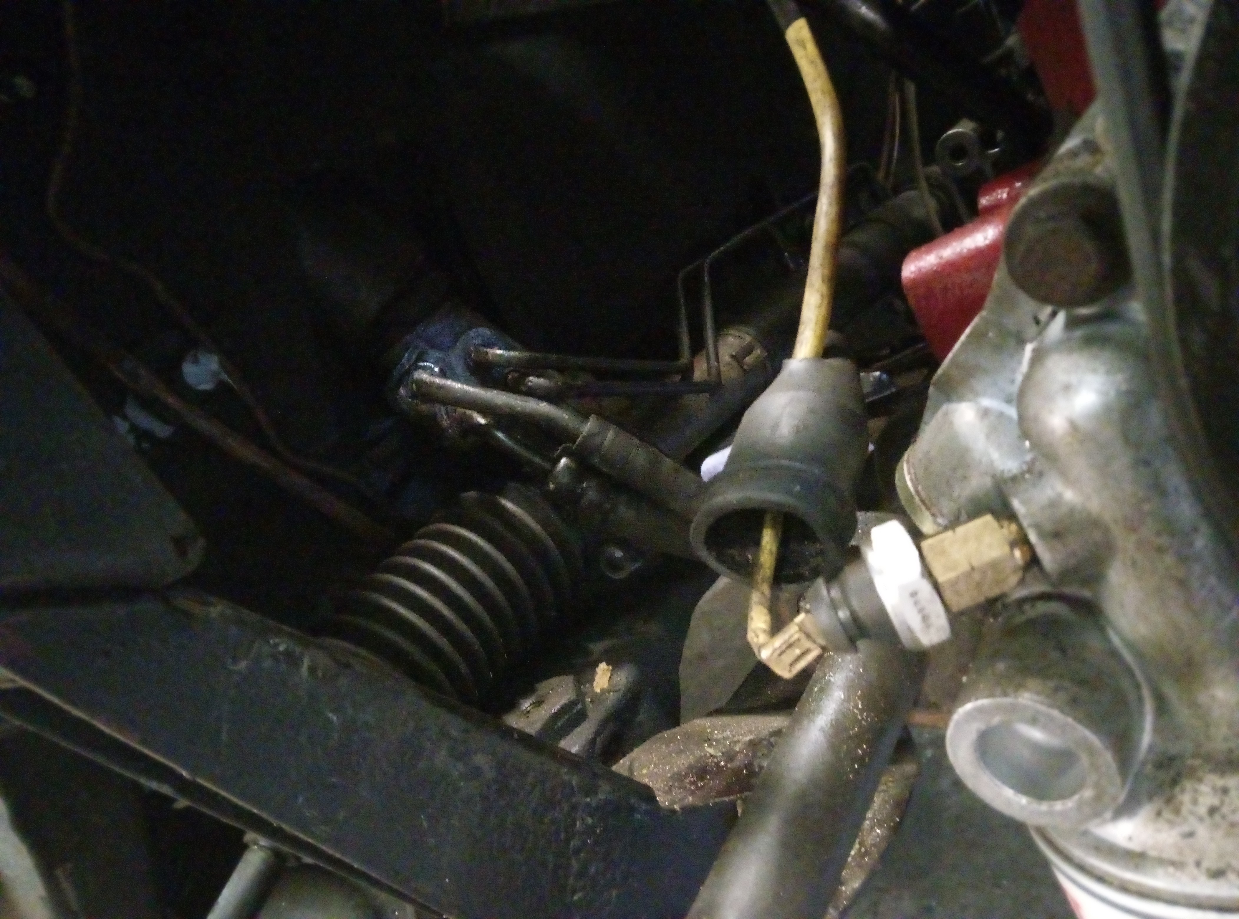

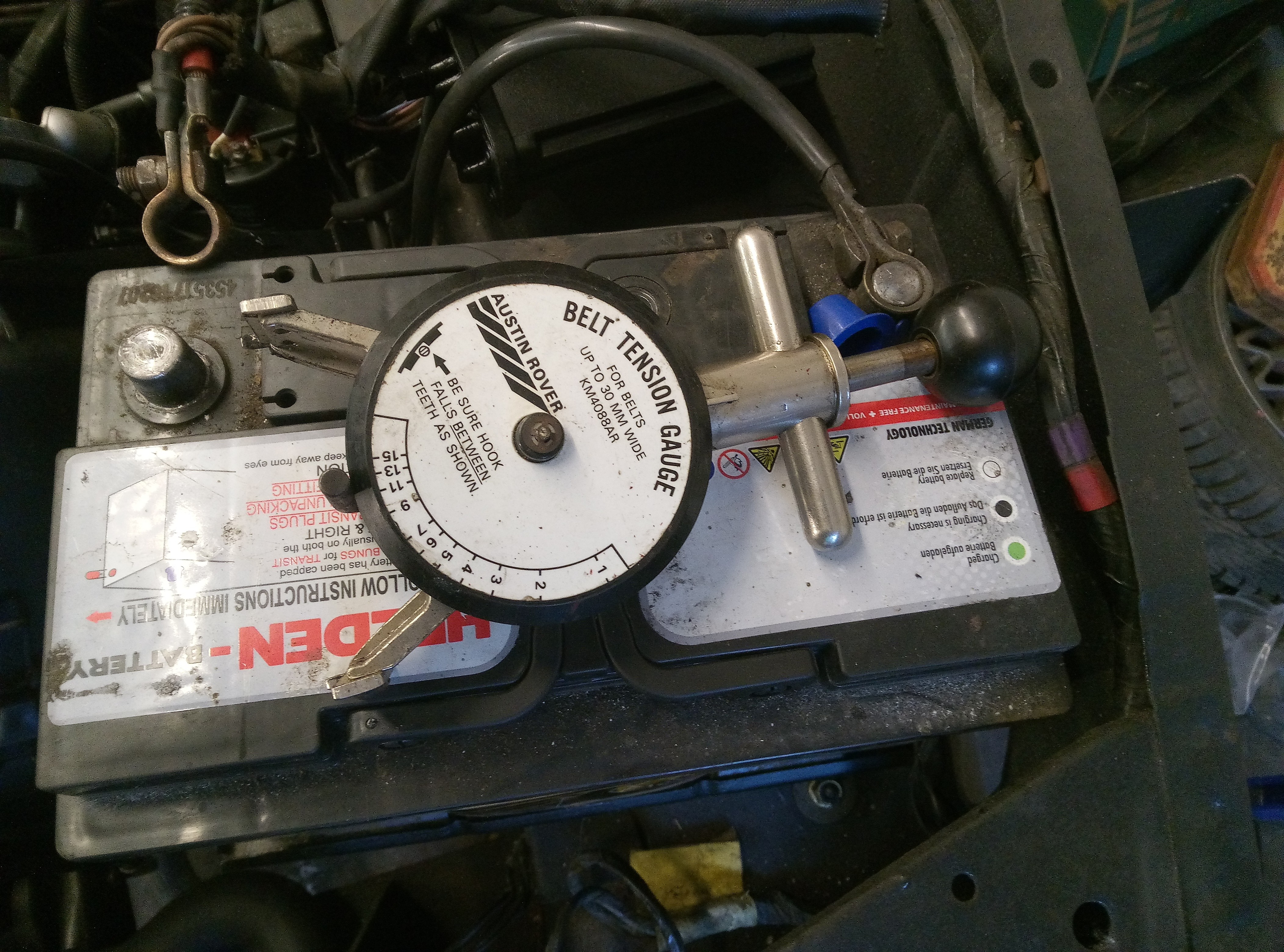

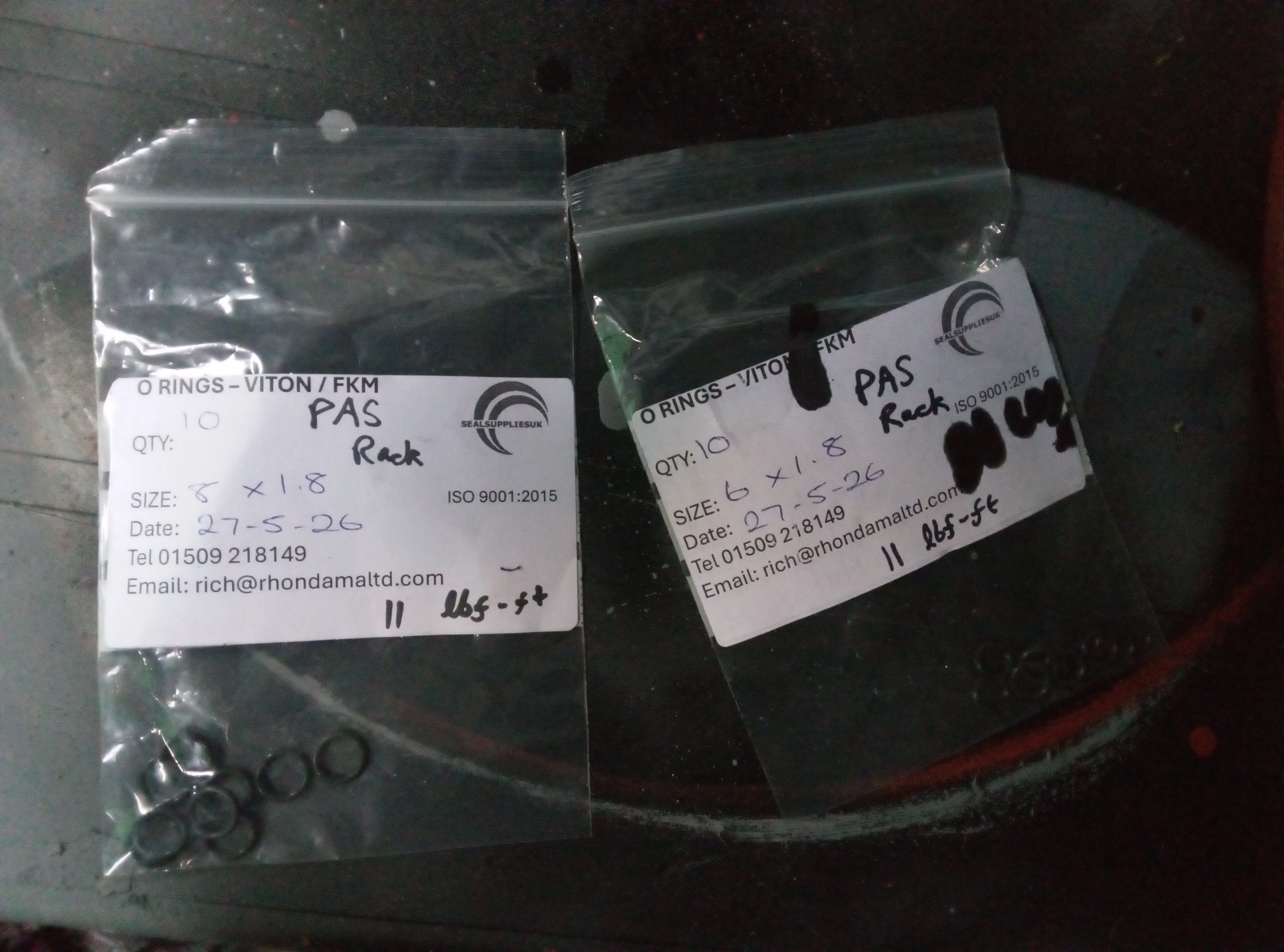

    Got a bit more done, PAS pump and pipes fitted. The pipe fittings on the rack are sealed with o rings, the old ones were mangled, so I had to work out what size they used to be... Ended up with 6 and 8mm id viton rings with a 1.8mm section. Hopefully they will be right and won't leak, they are a bit of a pain to fit & a crow foot spanner needed to set them to the right torque (11 lbf-ft, not very tight, unlike some of the ones I've dismantled over the years!). I used the AR belt tension gauge on the alternator and pump belts, these are a bit tighter than the belts on the diesel, using the tool was a good plan I think. Luckily I found a new bottom hose in my parts stash, the Unipart book and the epc aren't super informative, but the one I found is for the right type of water pump and seems to go to all the right places at the other ends (and yes, I did find the box of hoses when I was looking for something else)

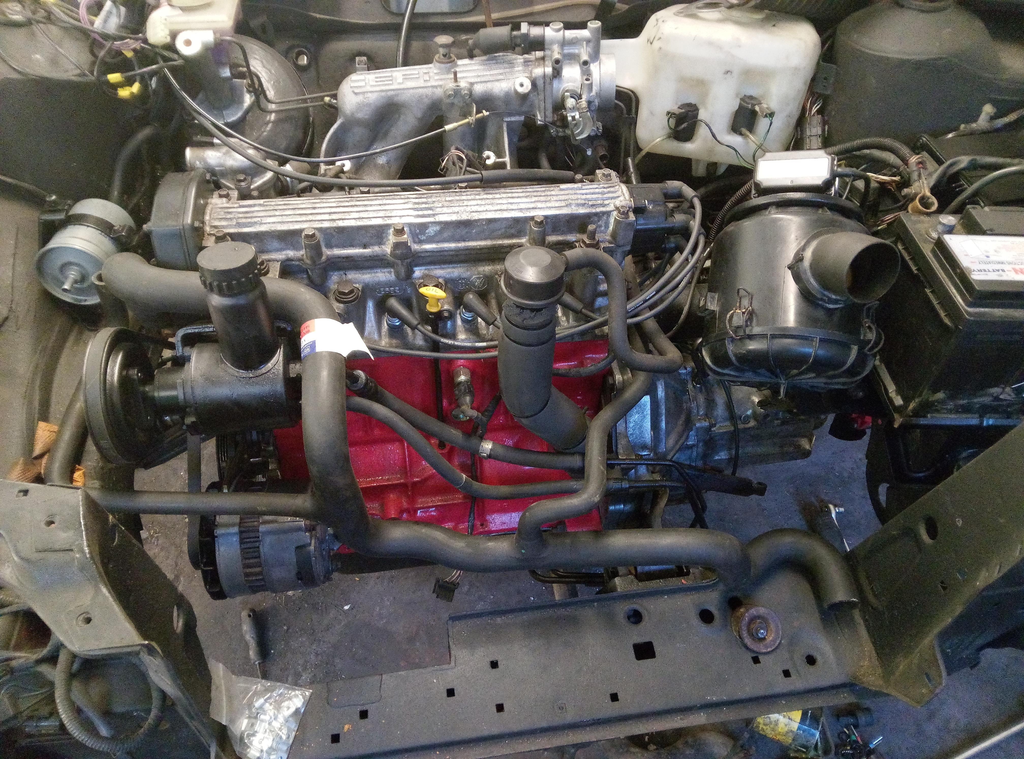

    Finally got the engine back in, the first couple of photos show a couple of mistakes that I had to rectify, a few more bits put back on, throttle pot set, still plenty to do, but shouldn't be toolong before it is running
