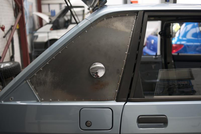

A Mini Van petrol tank lives where the back seat used to be, this increases range, a sort of long-range tank if a Mini tank can ever be called that. The rear C-post window on the right side is now a metal panel and houses the filler cap. Seams have had massive attention, and steel plates welded to the inside of the sils joining the floor, the spare wheel well has been eased out a tad to take 175-14 van tyres (80 profile). Countrydude's strut brace is about to go in. Corbeau recliner seats have beefed up seat frames and due to go in.
