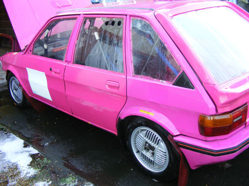

    In an exciting new link up with Project Mobility, we have acquired the following car:
    An '84 MG Maestro 1600 Group A Historic race/rally car in Tarmac spec
    It also came with all the gear to convert it for Forest events as well i.e. suspension, underbody guards etc.
    More info soon...

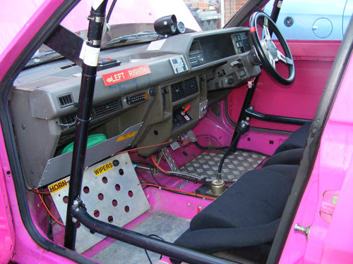

            VENDOR'S DESCRIPTION:
            This is an early R-series MG Maestro, that was built and used extensively by the previous owner as a forest rally car. I boughT the car in the late 90s and have only used it at most 1/2 a dozen times, but enjoyed it thoroughly. It is currently set up in Tarmac spec, but have the full set-up to convert back to forest spec.
            It is MSA logbooked, but will need new seats / harness's to become compliant
            I will provide some further pictures etc later but current spec is as follows
            1) Fully lightened bodyshell (lightened doors, perspex windows, internally stripped
            2) Full 6 point rollcage
            3) lightweight bucket seats, with 4 point harness's
            4) All brake / fuel lines run inside car
            5) Upgraded brakes, grooved discs with EBC red pads, adjustable brake bias
            6) Fully balanced R-series engine, twin webers, K&Ns, large exhaust manifold / system, passes all noise regs. really pulls like a train in a light car
            7) LSD 5 speed gearbox (same as early golf) Make of LSD unknown.
            8) Battery relocated to behind seats. Petrol tank cut in half - 4 gallon capacity.
            9) set of 6 powdercoated wheels in white with trackday tyres.
            10) Suspension fully powdercoated and polybushed. Fitted with ex Maestro Challenge LEDA 21 point adjustable's all round
            11) Power assisted steering rack fitted, without power assistance. Still light to drive, but sharpens up the handling.
            The car is tremendous fun to drive, and will keep up with many larger engined cars. Sounds great when you put your foot down. revs to 6500RPM.
            The other great thing is the simplicity. I've removed anything that doesnt need to be there, and if you look in the engine bay, then there's loads of space, and NO ECU, its got a distributor with Weber carbs, so very reliable and simple to manage.
            As mentioned above, its got a huge spares package including a spare Moto-Build Racing engine, complete with Weber carbs (carbs go for £250 on their own)
