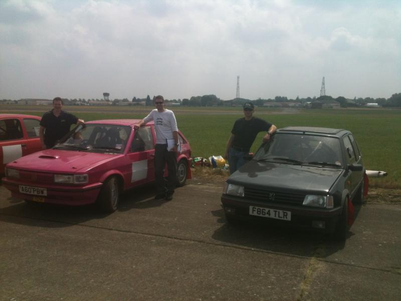

                      I've postponed the rolling road session today (again) because the exhaust is blowing (where the manifold joins the downpipe). The car was great on the TARGA RALLY yesterday -a joy to drive -and a good strong car for the hammering of the rough venue. Full report to follow...
                      • #56
                        It was a steep learning curve for me and my novice co-driver. The navigation was nails and we got lost for a moment several times. I also didn’t go the right way (or didn’t listen to his directions in all the excitement!) several times. I also overshot one corner on gravel, and ran wide (bouncing right over big piles of gravel) on another corner. The ‘360 handbrake turn’ below was a result of me realising that we were going too fast to make a hairpin, so I had to wazz it round the other way in the overshoot area.
                        Here's Steve Newland’s side of the story (my co-driver) who had his first experience of club motorsport (apart from schoolboy karting & a day at a rally school) on this event (rather fitting, given that it was part of National Motorsport Week to introduce newcomers to the sport!):
                        Co-driving for John was a phenomenal experience combining the thrill of being hurtled around a track by a precision driver with the pressure and responsibility of being the navigator. The exhilaration of a high speed 360 degree handbreak turn is fully matched by the sense of achievement that comes with finally navigating a flawless section. (Although no sensation will compare to being driven, full pelt and sideways, into a barn... nothing I'll survive anyway.)
                        Out of the car in the paddock is equally enjoyable and time was spent on car maintenance and reviewing pace notes which reinforces that you're a participant - not an observer. The event was professionally run and everyone I came across was friendly and welcoming, happy to share their tips for the track or talk about their cars. This was a privileged insight into the world of Targa Rally, the adrenalin rush of which is only just subsiding.
