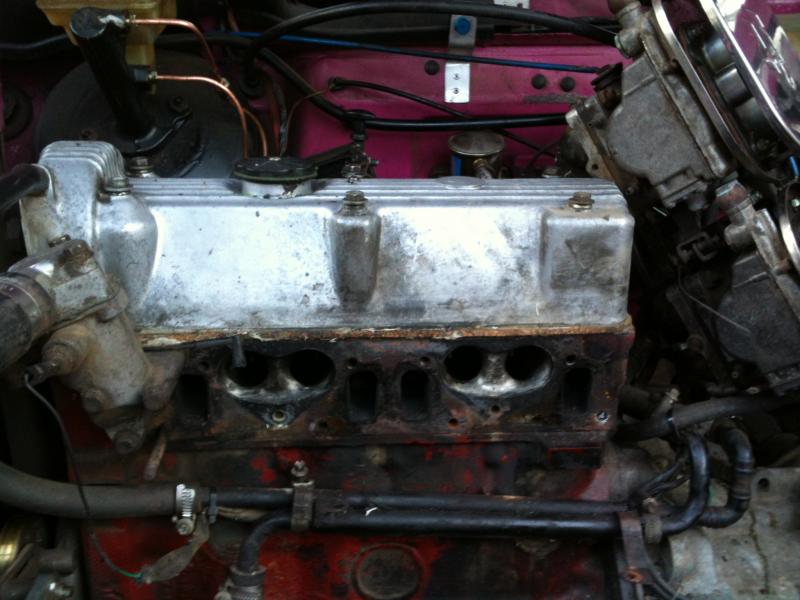

    All was going well this eve -welded a screwdriver onto the broken-off stud extractor and (with a lot of wiggling back and forth + re-welding) got the stud remnants out. About to refit the exhaust manifold but then it became clear that it wouldn't seal up tight against the engine block. The problem was the mating face was corroded so we decided to get it skimmed flat at this firm (hopefully in time to refit it on Saturday):

    Porting/polishing visible

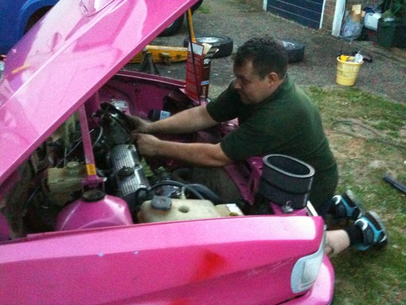

    Had another productive session on the car last night:
    -K&N filters oiled and re-installed
    -Brake system reworked (using additional lengths of piping) to split it. Now the system has a Front circuit and a Rear circuit (so if there is a leak somewhere you will still have 2 wheels with working brakes!).
    -Brakes bled with Comma DOT 5.1 synthetic brake fluid (top of the range)
    -pedal appears to be somewhat firmer (but need to road test it now to confirm)
    -Rear nearside brake line properly secured
    -12V socket rewired so that it is always live (even with Master Kill switch thrown) so that a solar battery charger can be used (or the alarm powered) while the car is parked up.
    -Bonnet stay (from a Discovery) fitted
    -Cockpit labelling finished

    Mark was over this evening and got the exhaust manifold off although it took a stud snapping in the block before it yielded. The stud remover then also snapped in the hole, so it will take welding a bar onto the stud to get it out now.
    The original snapped stud in the manifold sheared off with a stud extractor so it was drilled out and re-tapped.
    The Ign pull cable was tighted up (by unbolting its alloy mounting plate). I also put some copper slip on any areas of bare metal underneath for corrosion proofing.
    I went round the engine bay and put Alpha Rust Remover onto all the areas of rust that I could get to (although there are more under the radiator which are inaccessible).
