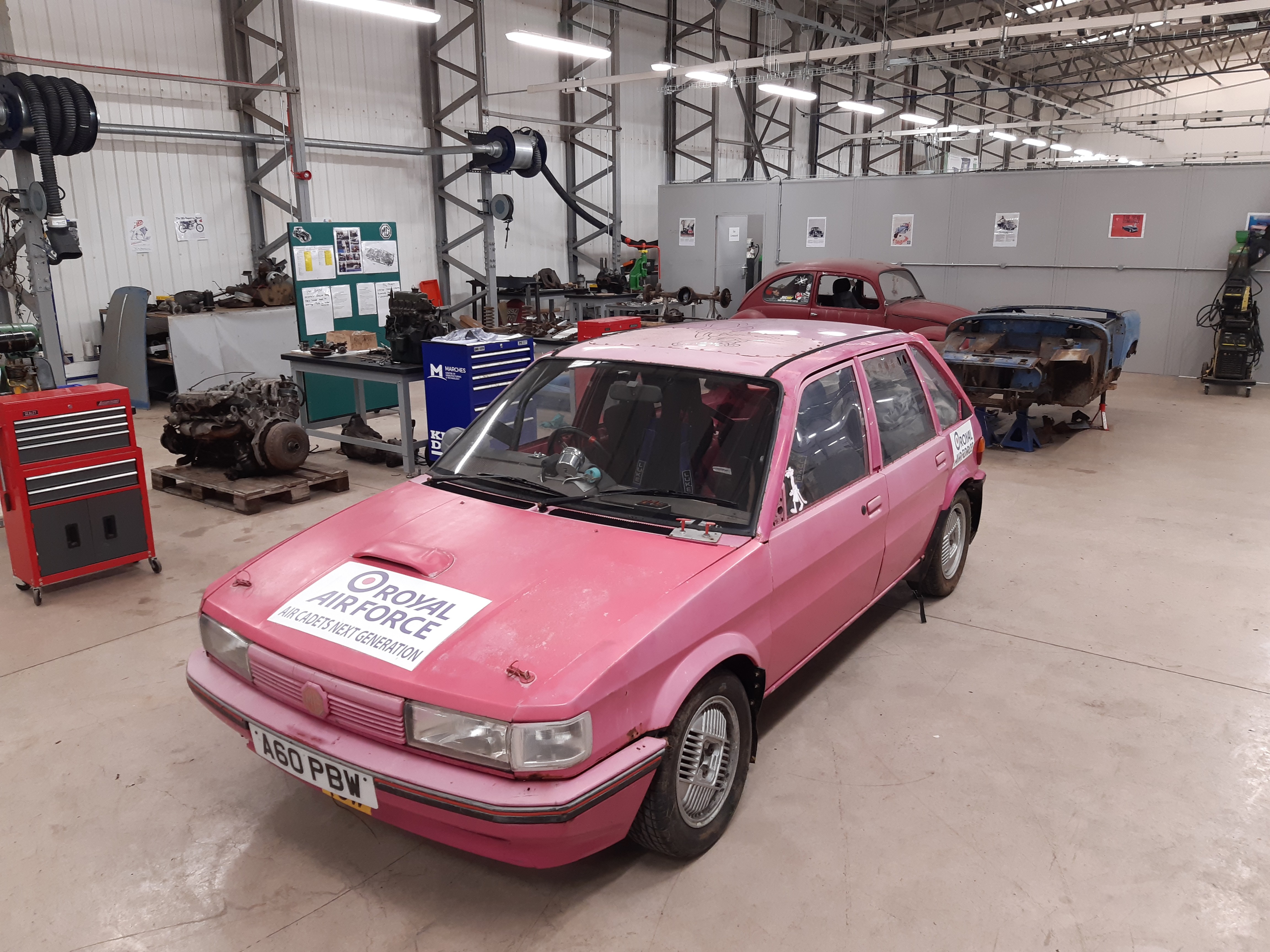

              • On Thursday 19 Nov 2020 a College collected the Maestro.
                The latest update is as follows:
                "we are looking to move the apprentices onto the Maestro in June to start inspection, servicing and repair of the vehicle. The first session will be to strip, clean/inspect the brakes and if we have time replace brake fluid and bleed the system.
                Can you remember when the car was last started ? as we will potentially look at getting it running again too."
                It could well be several years since the Maestro last ran. It was last MOTd in Sep 17, and I believe that it drove back to me in Jan 18 so this was probably when it last ran.
                • Update from College:
                  "The group have inspected all wheel stations on the Maestro and they have stripped down cleaned/copper greased the brake components. I have also got them to examine the brake pipes for corrosion throughout the car and they are currently writing up a report on their findings.
                  Further to this we have removed the leaking water pump to examine the cause of the leak and we have concluded that the bearing seal has failed internally so will need replacement. The apprentices noted a build up of crystallised coolant and further examined the thermostat and associated hoses.
                  Unfortunately during the strip down of the N/S rear brake drum it was noted that the hub nut had been cross threaded onto the spindle at some point in the past and , as such would not remove or tighten. I have taken the decision to remove it at the moment until we can potentially get hold of a new hub spindle and nut. (I will tack weld on a nut temporarily to allow the vehicle to be rolled when it needs moving)
                  would you be happy to look into a water pump and hub spindle ? I believe they are in the region of £15 and £70 respectively.
                  Once we can get these repairs done we can look at getting it running and moving again."
                  • Update from college [car recently moved to Shrewsbury]:
                    "We have had a look over the vehicle this week and have fitted the new water pump and stub axle.
                    We also identified a severe leak from the thermostat housing gasket which appears to have clocked off a long time ago ! The apprentices constructed a new gasket from scratch and so far, this is holding (no system pressure yet).
                    The Engine has been turned over and although slightly sluggish, is turning freely (to investigate further)
                    We currently have a no start situation with the vehicle and upon initial inspection, it is noted that there is no fuel getting to the engine. Although the fuel pump is activating it is not drawing anything from the tank at all. We plan to hook up a temporary replacement universal fuel pump today to hopefully eliminate this issue.
                    I will continue to report back as we progress through the project."

                              • The most recent info and photos of the carClick image for larger version
