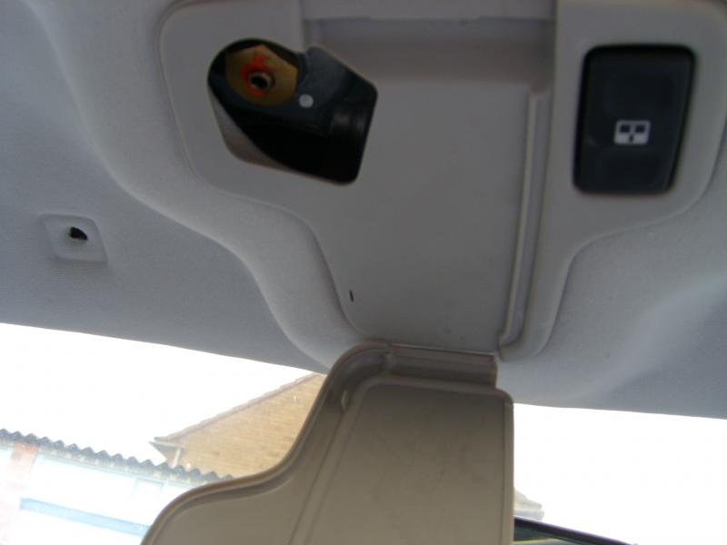

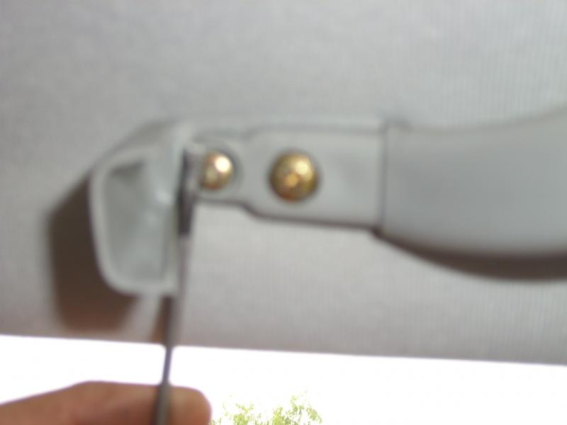

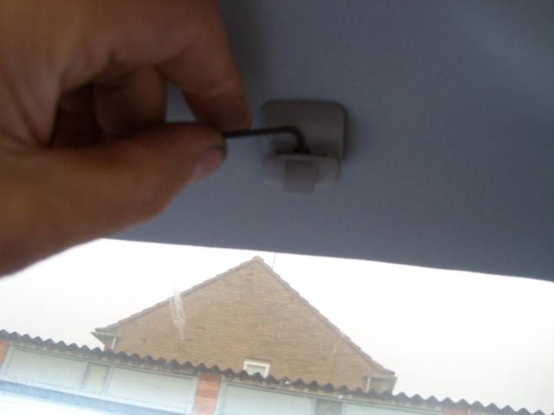

    Pull back the passenger sunvisor and remove the 2 screws
    Using a small allen key push down from the top the unclip the cover
    Remove the screw completely and pull sideways

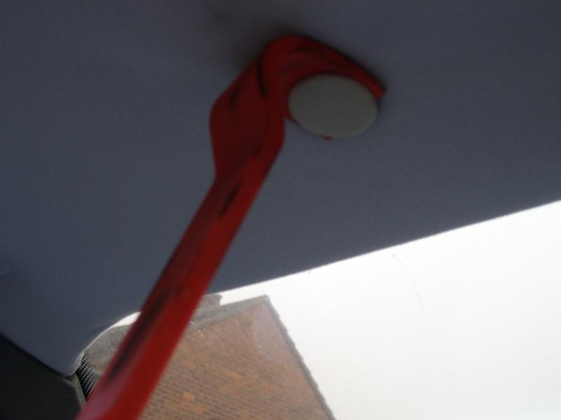

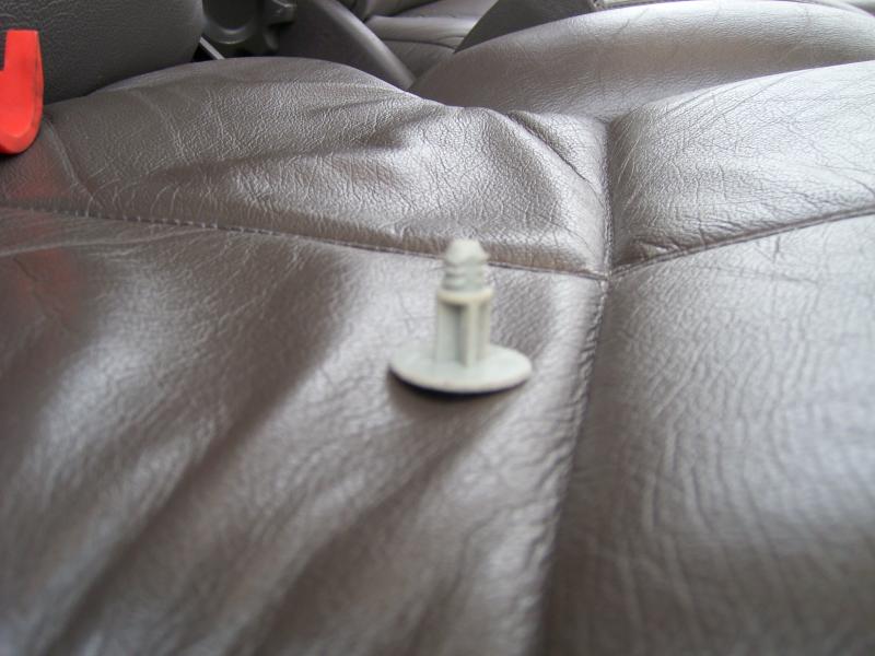

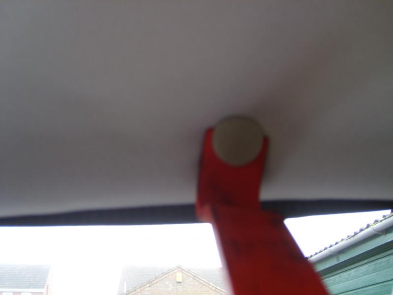

    Using a trim removal tool pull out the centre stay clip. If you have a small slot in this clip twist 45 degrees and remove as it has an L shape

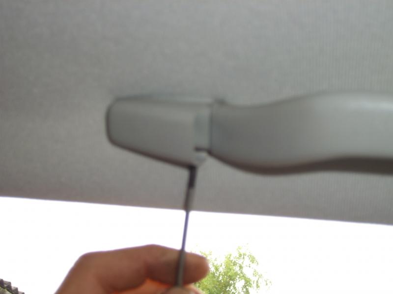

      From the passenger side front
      Using a small flat screwdriver remove the covers from the grab handle

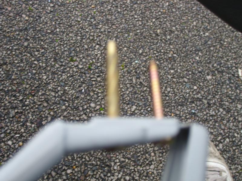

      Remove 4 screws and make a note that the outer screws are self tappers

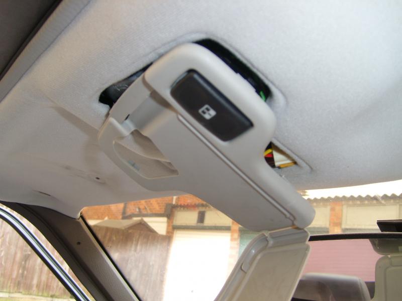

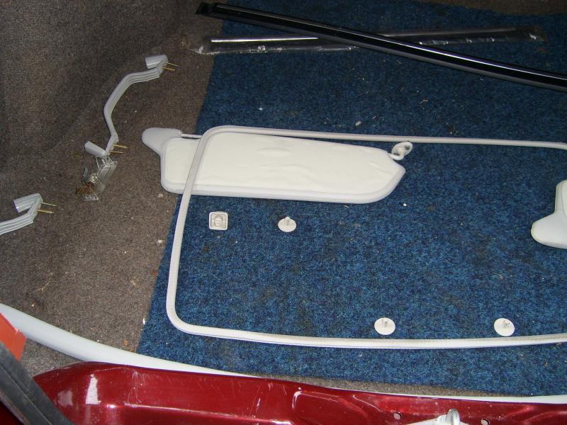

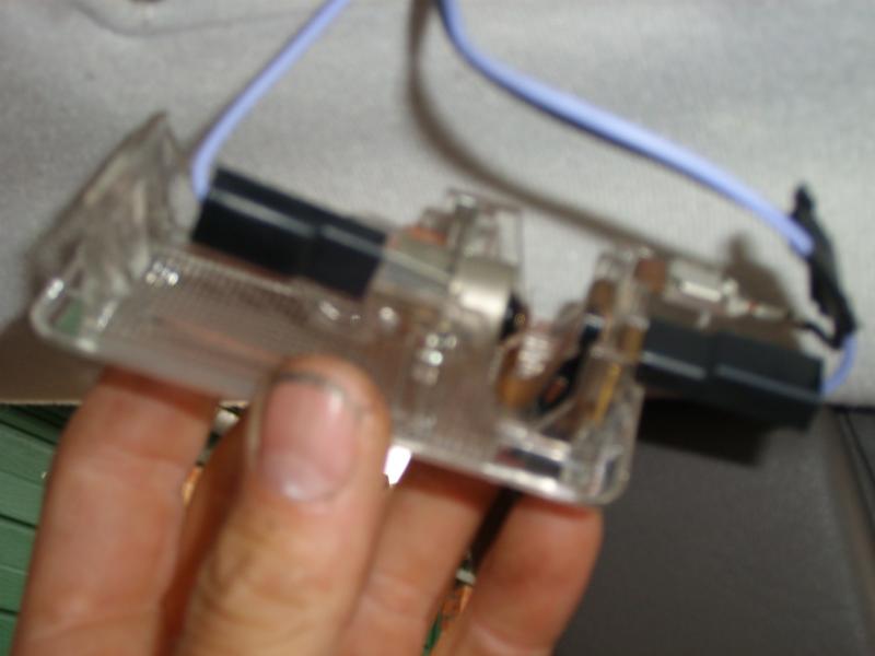

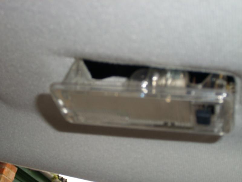

      Remove the interior lamp being careful not to break it
      Make a note of the wiring positions

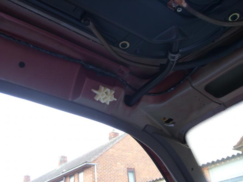

        Remove the stud from the drivers front, this replaces the grab handle
        The drivers side stud, this can be a cause of frustration later when putting the headlining back up but I have an easy way of locating the square hole

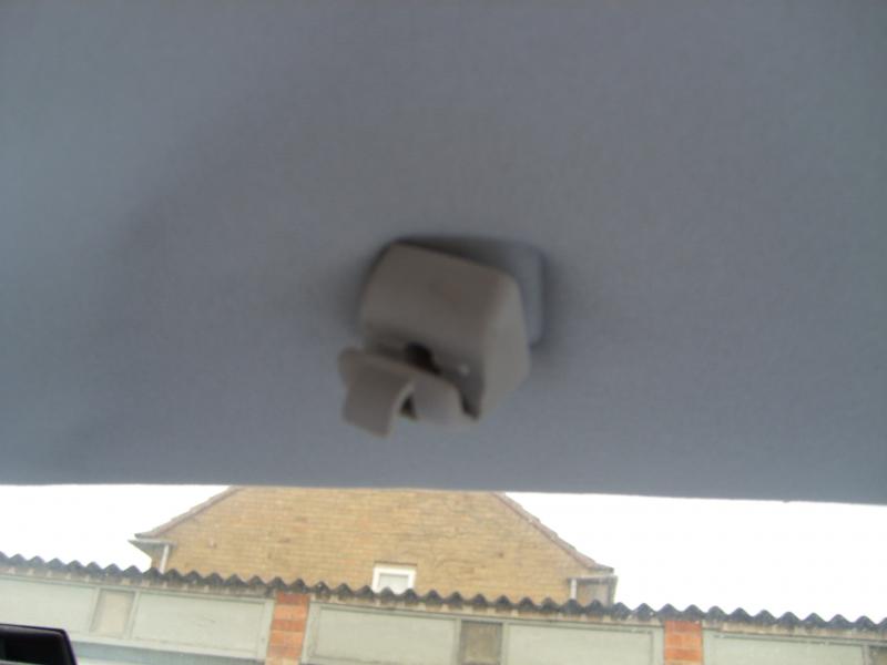

          Remove the drivers sunvisor, clips etc as before

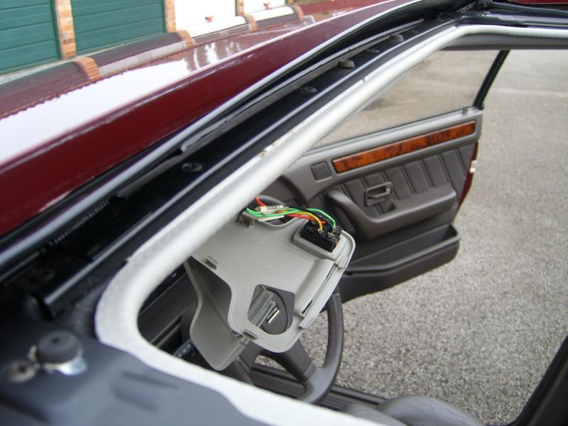

          Open the sunroof
          Remove the (in this case) electric switch cover
          From the front pull down the main switch housing
          Unclip the connections and remove the switch

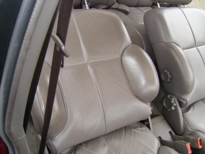

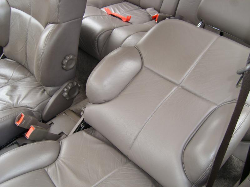

            The front seats should now be levered back and the seat backs lowered to their lowest position
            Put the car into reverse gear

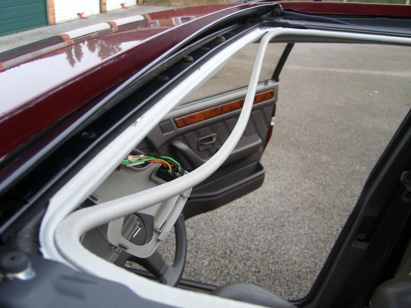

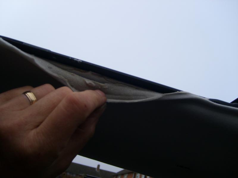

            Pull off the sunroof surround and pick off the material from it

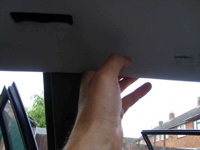

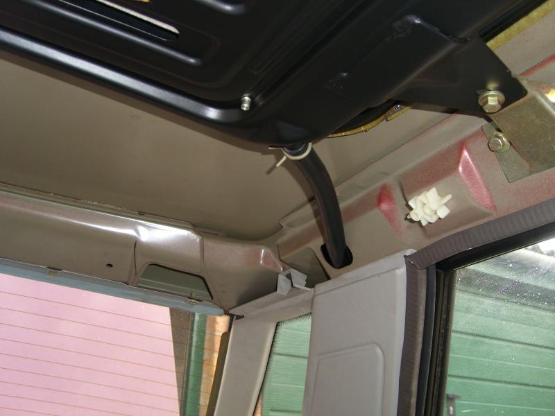

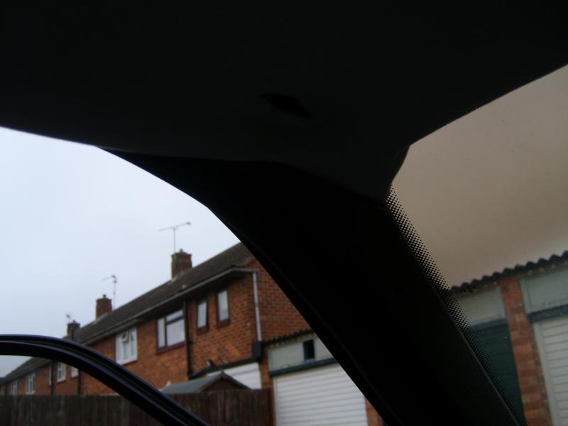

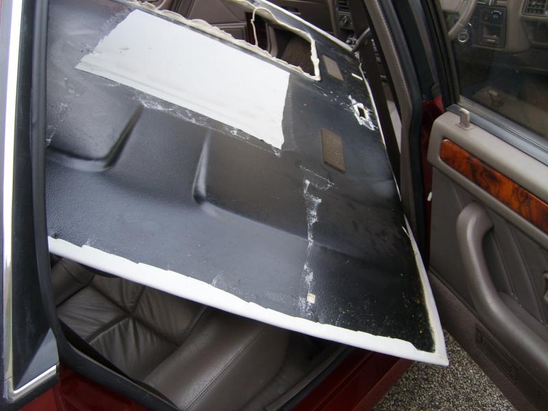

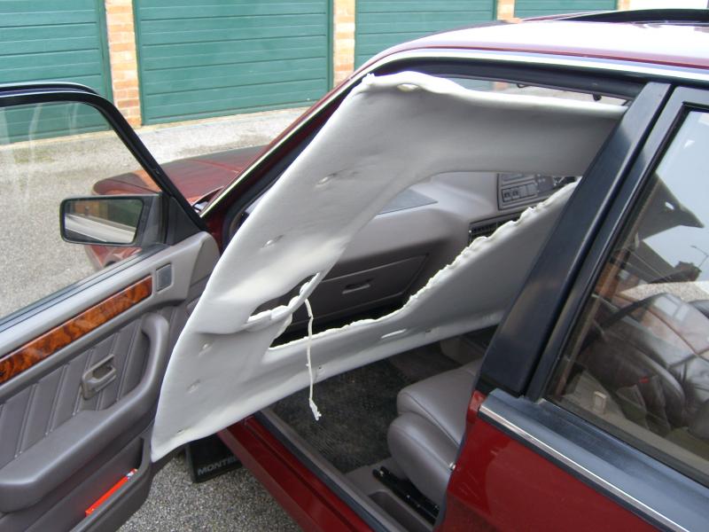

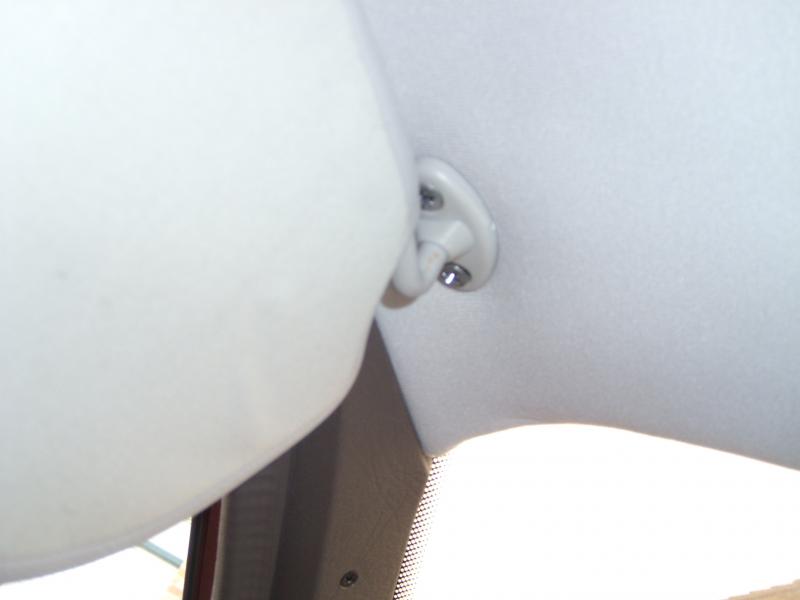

              From the passenger side pull gently from the top of the B post and top of the A post

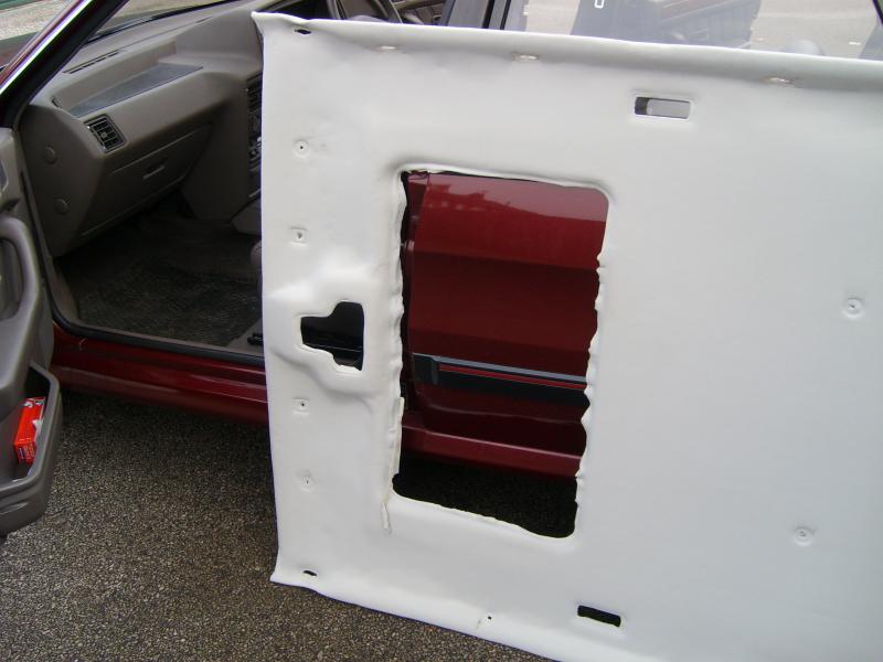

              Gently lower the headlining biscuit
              Push the rear of the biscuit up over the rear seat so the front of the biscuit goes under the steering wheel.

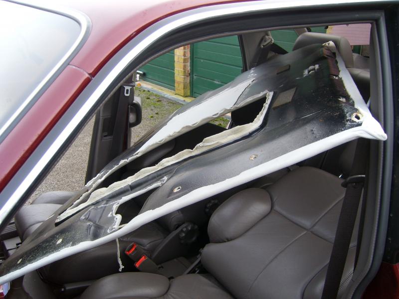

              Gently manouver the biscuit forward and out of the passenger front door
                More
                It's easier to remove the biscuit from the car if you remove the passenger seat but it can be done without as you can see.

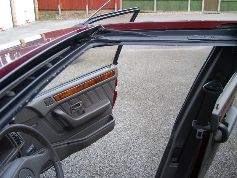

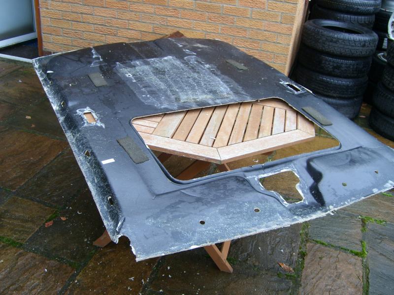

                As you have removed the biscuit you may want to clean all the sunroof drain tubes and if needed clean the roof as it's exposed.
                Clean round the sunroof surround

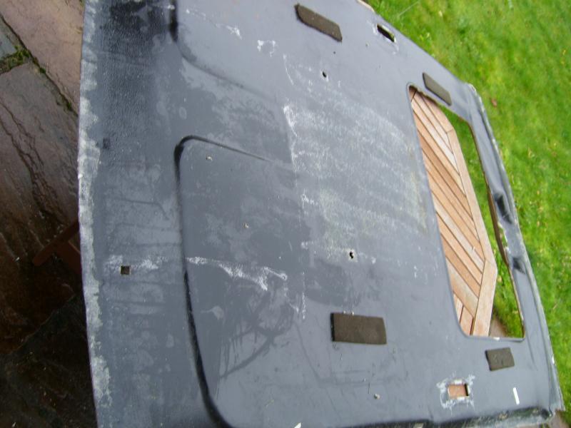

                  Part 2 will be cleaning the biscuit and repairing any damage like this
                    Part 2. Clean up and repair

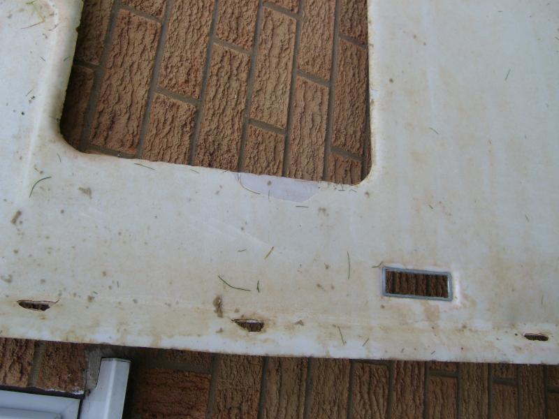

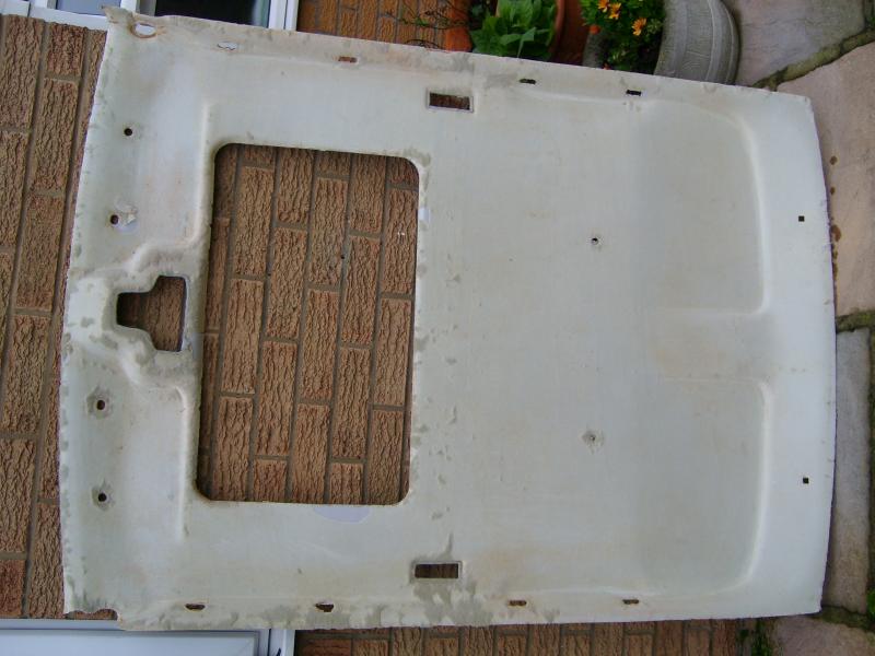

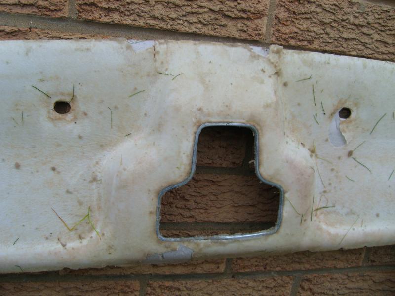

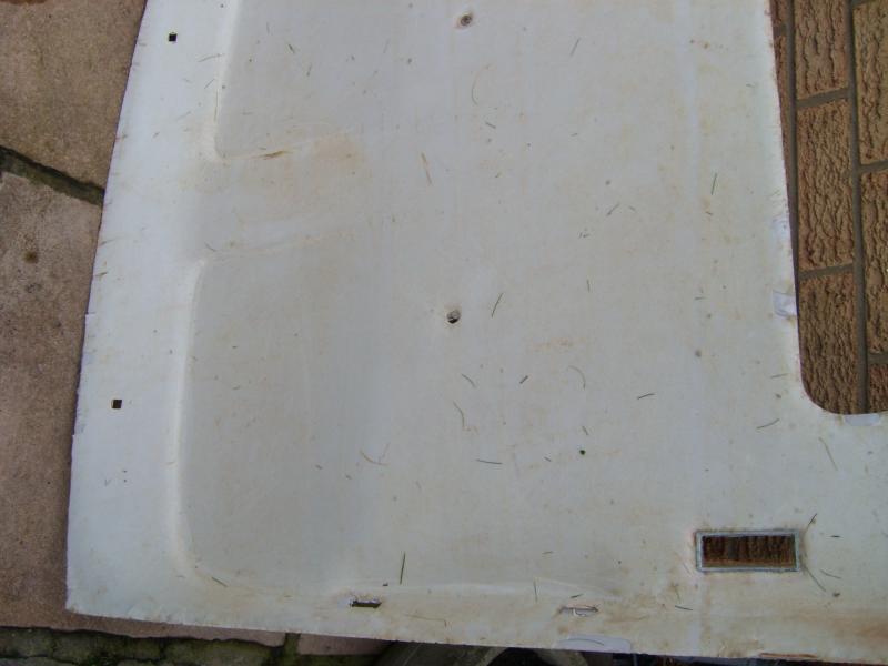

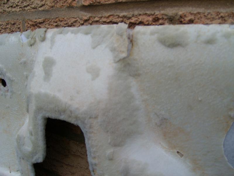

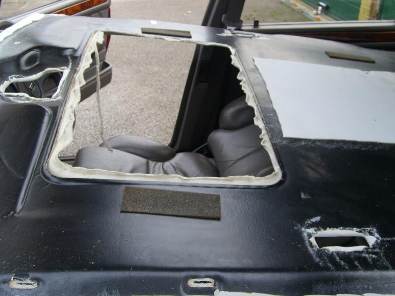

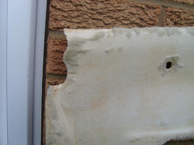

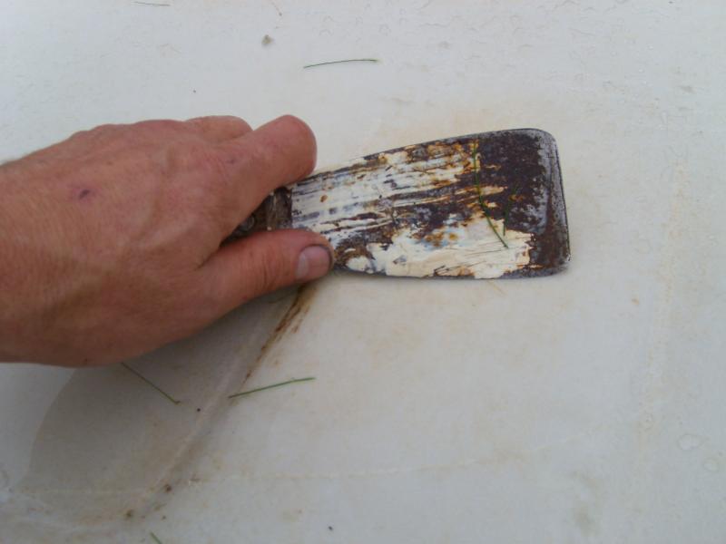

                    All of the old headlining material from the top and bottom has to be removed
                    All I use is a household scrapper, water and an old towel
                    First remove all of the old material
                      I use the side of the scrapper to remove the old glue etc
                      This damages easy to careful round here
                      All has to be removed
                      Go over it once then again and if required a third time
                        Turn over and now clean the other side

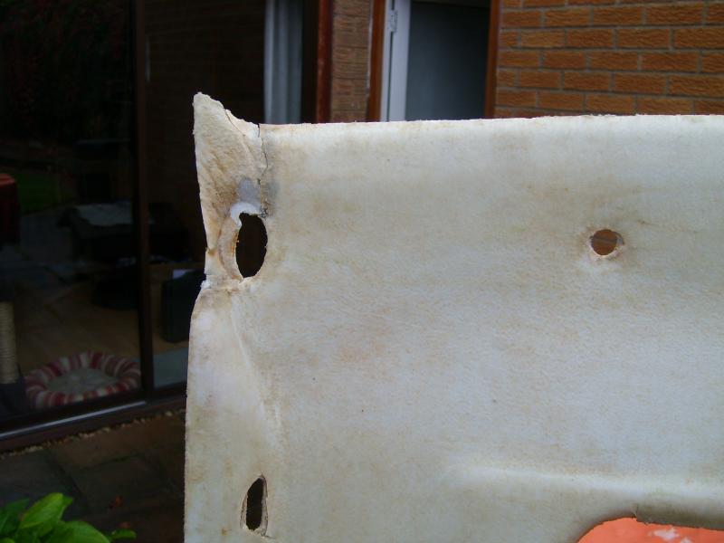

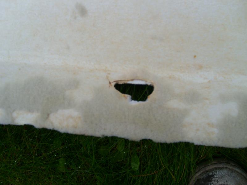

                        Remove the centre material

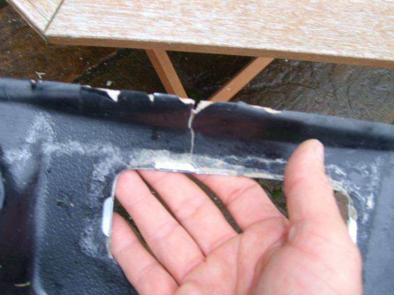

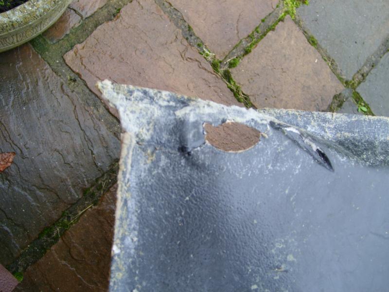

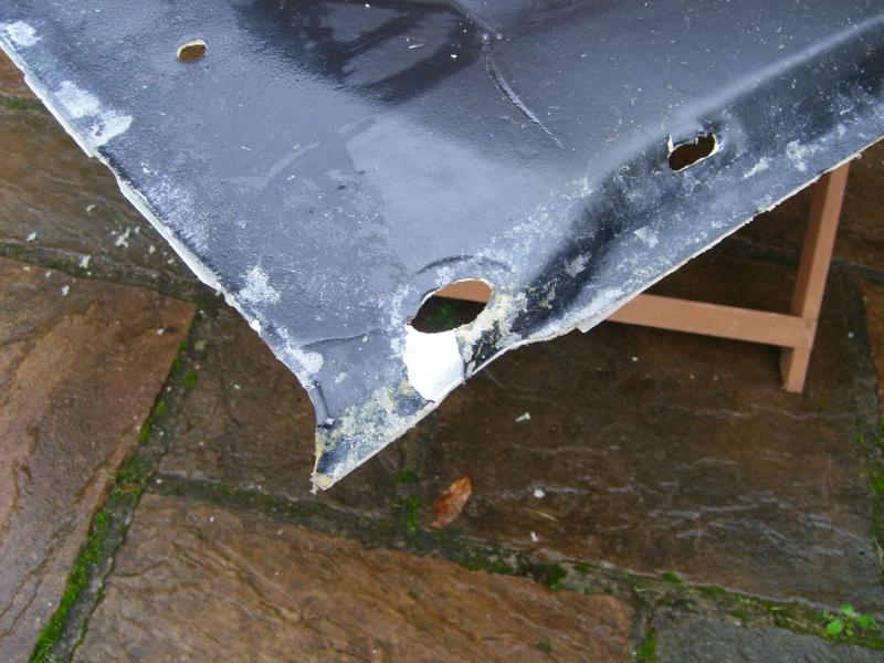

                        Damage here in two places
                          Now clean and ready for repair

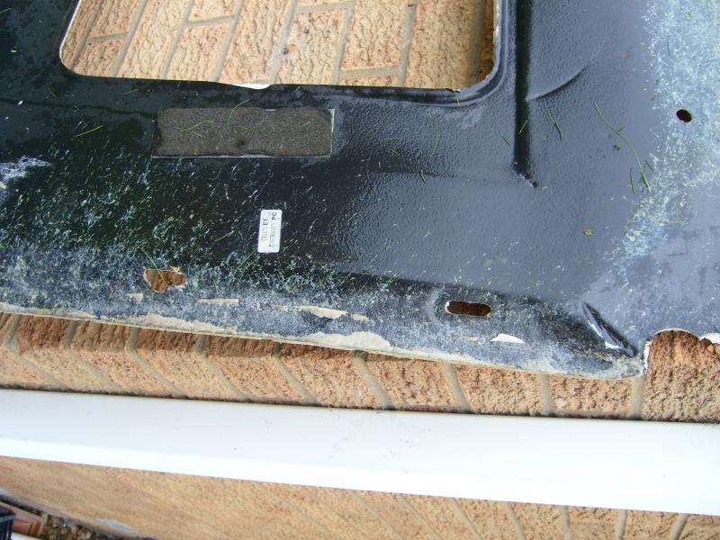

                          Damage also here

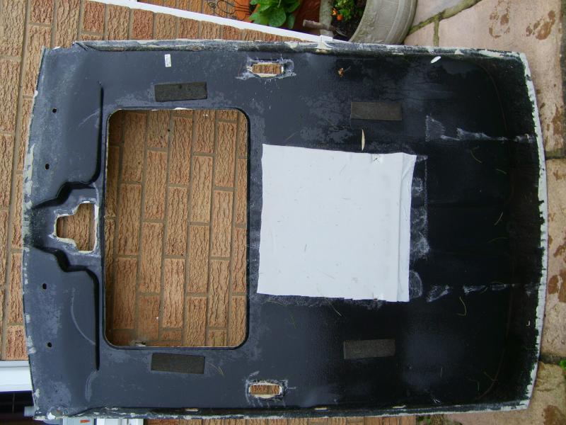

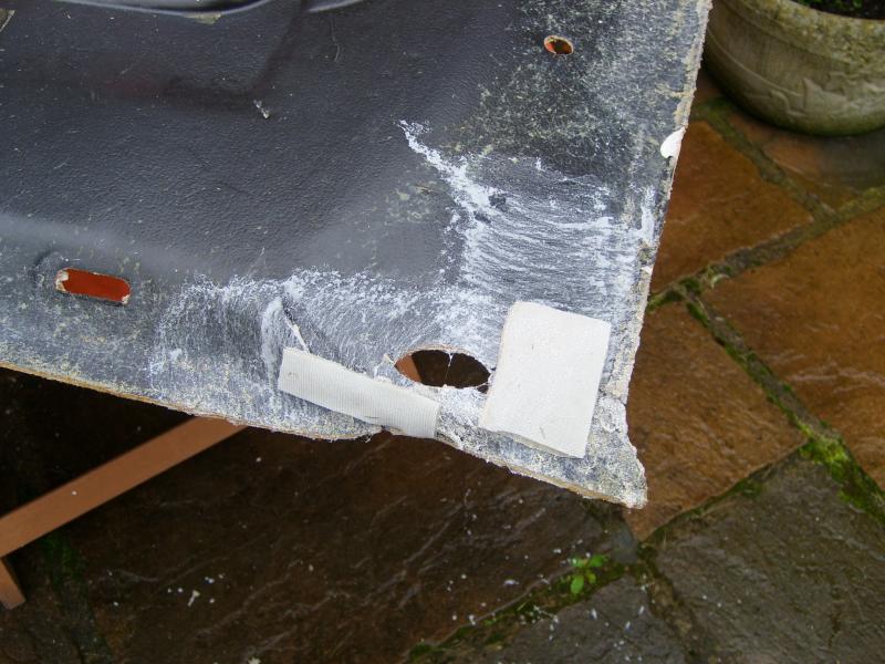

                          Cover whatever you are going to use as the base
                          The broken side is matched to see if all is there
                          You will need two of these
                            You will also need
                            Scissors, cheap superglue and either a knife or blades

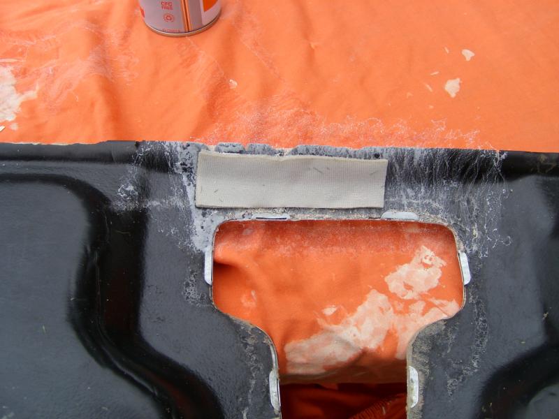

                            Glue any broken piece back to the biscuit and on any other damage that is needed.
                            After drying if any part needs to be strengthened,cut a small piece of material from the new lining you have a little smaller than any damage.
                            Spray a short burst of glue on the back of the biscuit and on the material and leave to dry
                            Damage like this will not matter and the lining material will cover it
