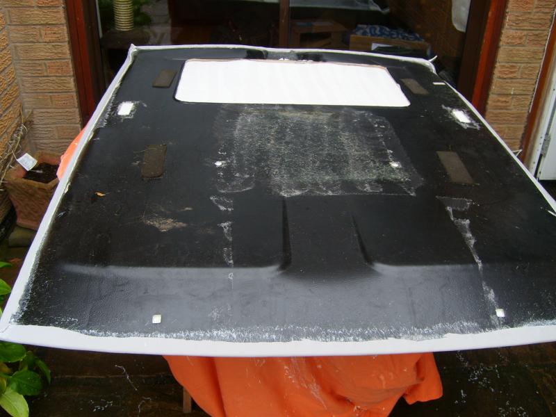

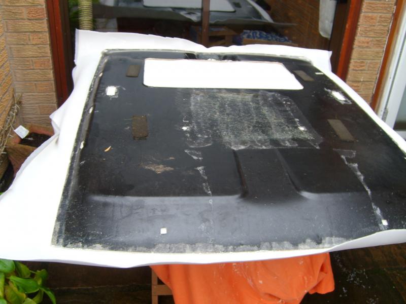

    Part 3 re-cover
    Gloves on

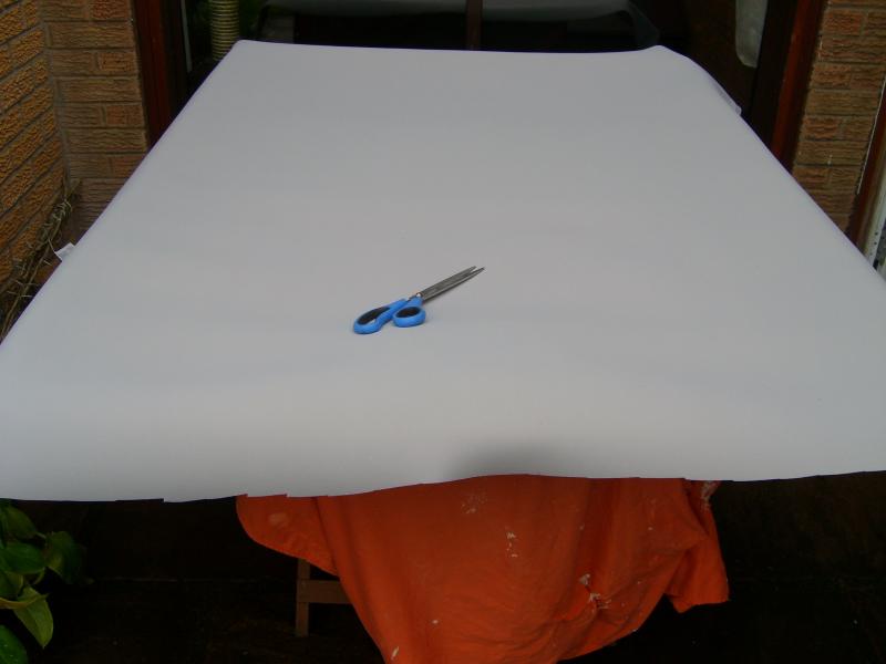

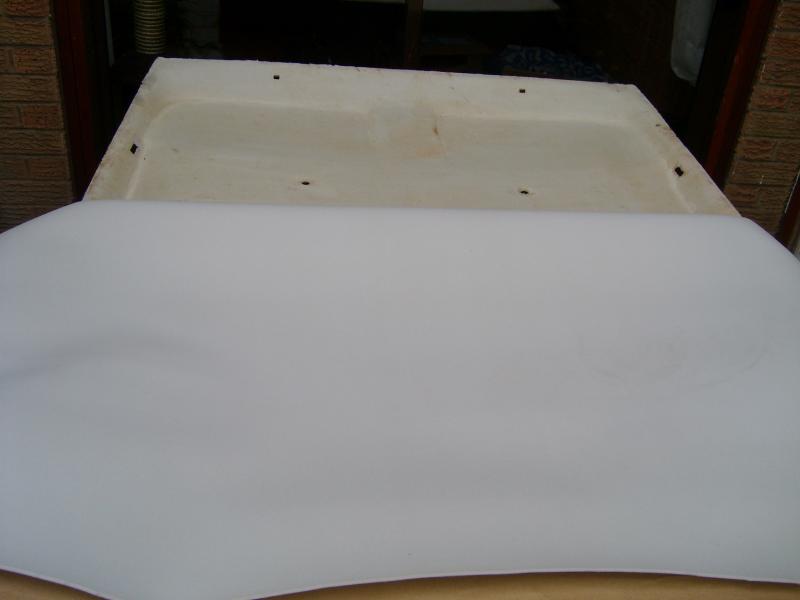

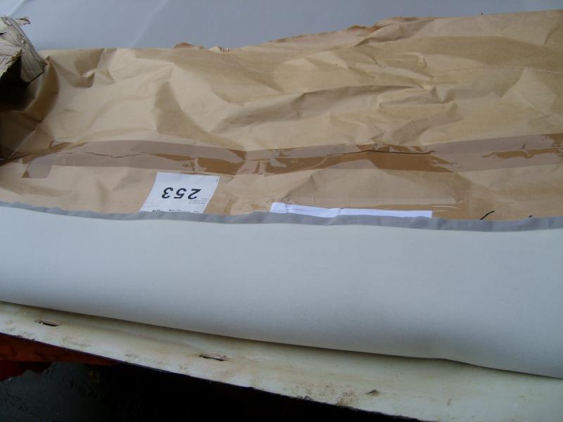

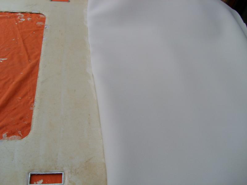

    Roll out the material from rear to front
    If you have ordered 2 metres that will be enough, if you have ordered more cut an overhang of approx 2 inches from the front

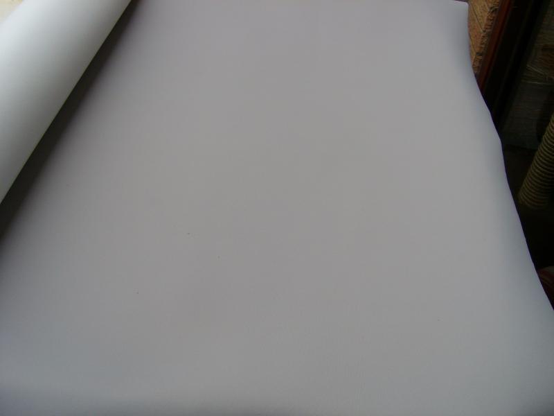

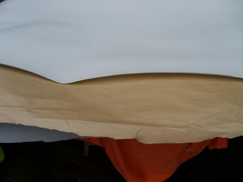

    Put the packaging in the top of the front and fold over the rear to expose the biscuit
    Shack a can and spray the glue approx 12 inches above and spray side to side moving from the rear to the front overlapping the pattern but try not to put any glue on to the sides. Then spray the material front to back again overlapping the pattern and trying not to cover the sides. Use plenty of spray on both but don't overdo it

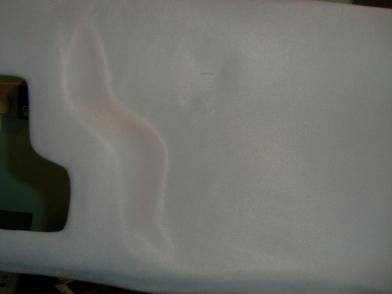

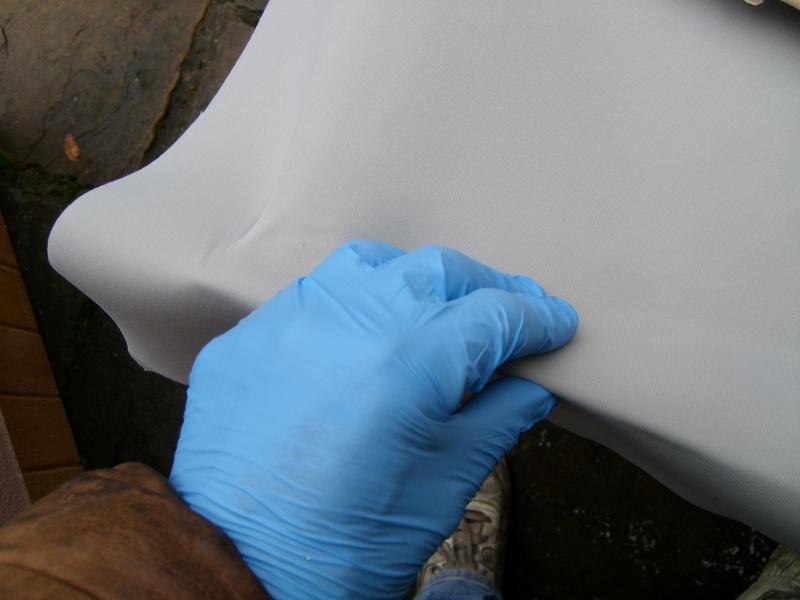

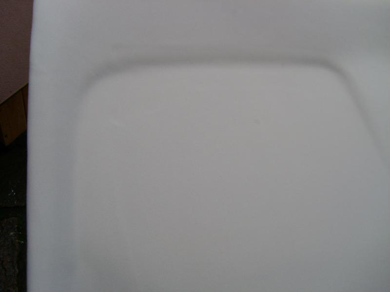

    Roll out the material gently and using the palm of your hand rub over the material.
    When you get to the indentations press down using the edge of your hand over the pattern and move over it pressing firmly, not too hard or you will ruin the material (hope you understood that)

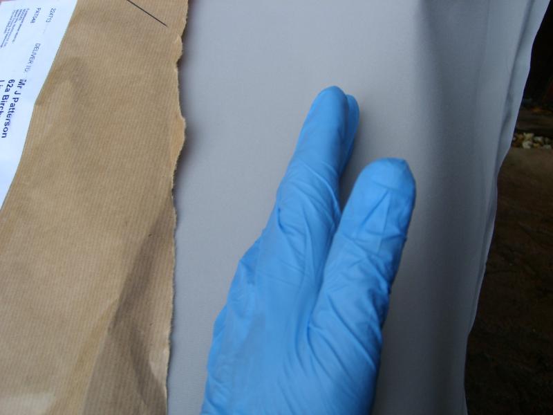

      Using the palm of your hand rub over the material at the rear
      Remove the packaging and cover the rear you have stuck on

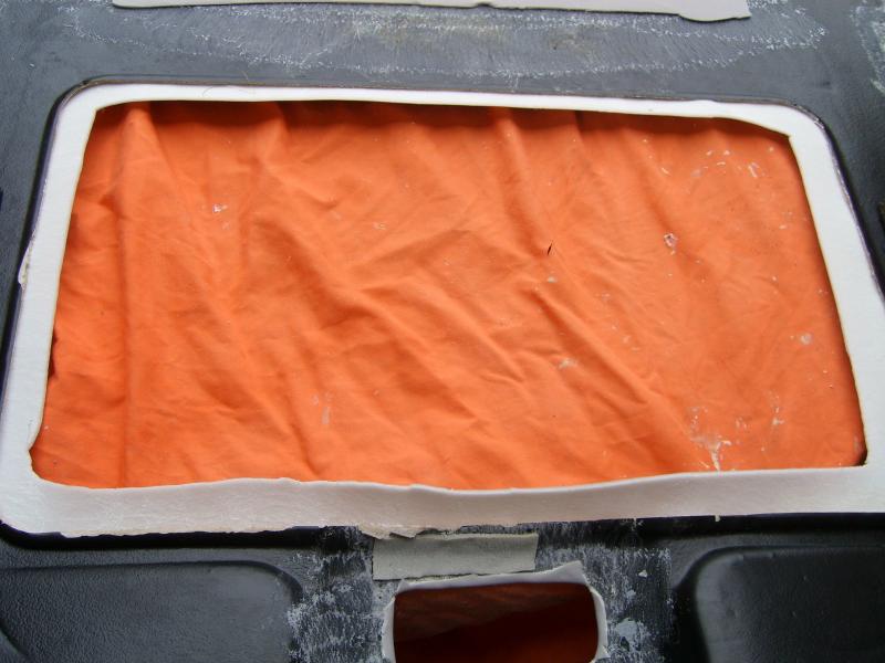

      Use the edge of your hand to push into both sides of the sunroof recess part

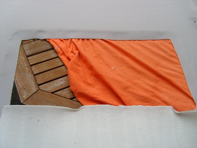

      Once done, using the packaging lay over one side and fold back the material

        Spray glue front to back on the biscuit and left to right on the material
        Roll the material over the sides and using the edge of your hand over the corners, move your hand front to back slowly and firmly.

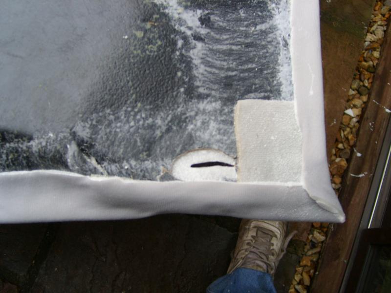

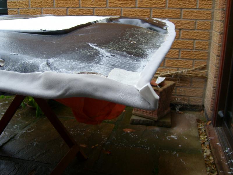

          Spray glue over the sides of the biscuit and overhanging material, fold over tightly but not too tight and press down, move from one side to the other
          Do all sides
          Press the corner parts together and trim off

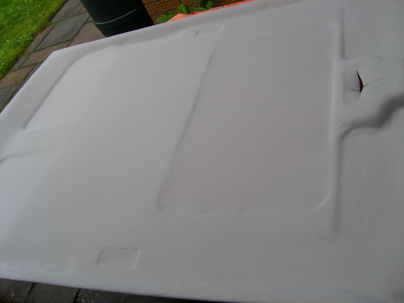

          Turn over and it should look something like this
          Press frimly again in the biscuit patten all over if you need to

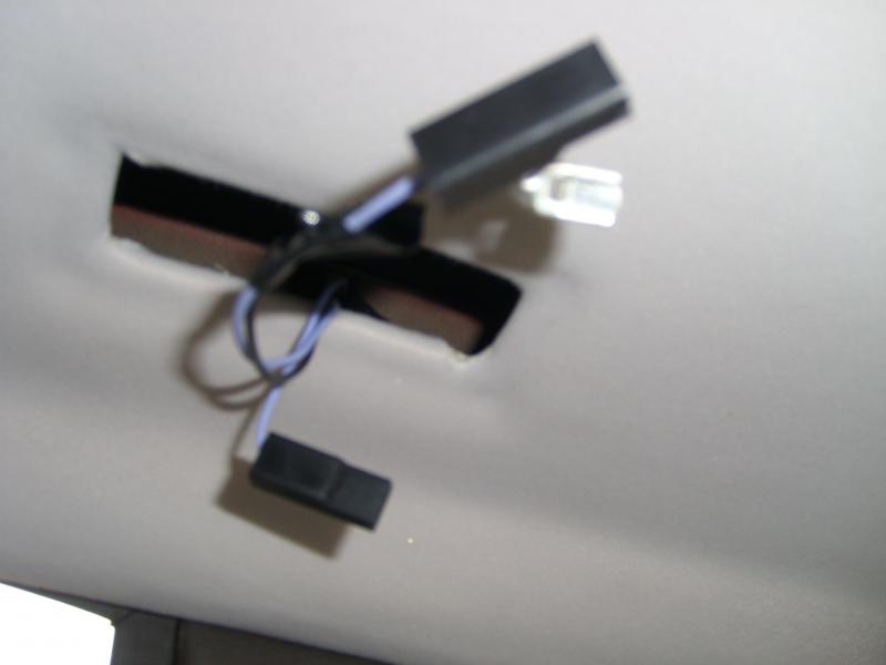

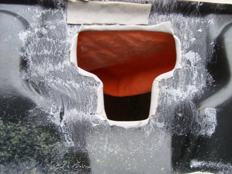

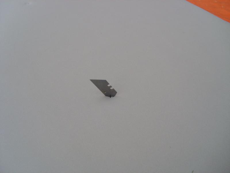

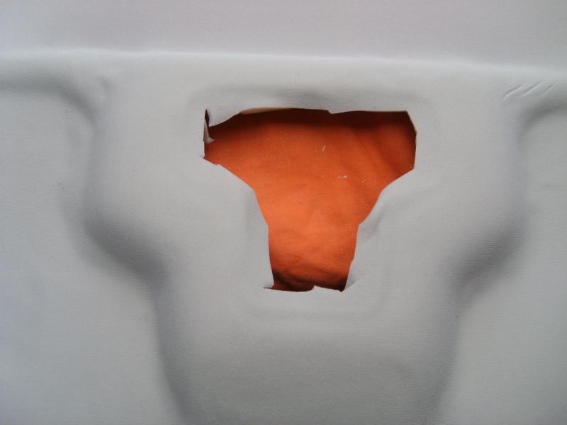

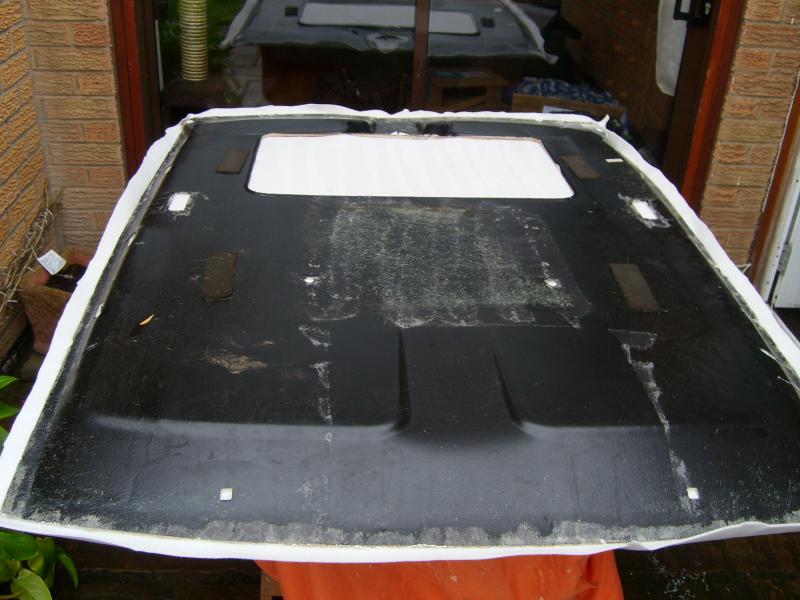

            Using your blade/knife cut a slot like this in the internal lamp hole
            Cut a pattern similar to the sunroof handle hole
            Cut the centre part of the sunroof opening BUT LEAVE APPROX 1 1/2 INCHES MINIMUM OVERHANG
            I CAN NOT STRESS THE IMPORTANCE OF THIS ENOUGH, you will need this excess material so keep it
            Turn the biscuit over, spray glue over the interior lamp opening and fold over the material
            Do the same with the sunroof handle opening

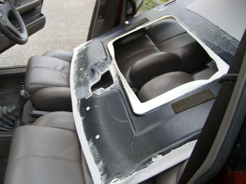

              Using the sunroof opening you cut out, spray glue over the rear and attach the material near the centre but approx 4 to 6 inches from the sunroof opening. This material stops the biscuit bashing in to the sunroof tray
              The sunroof opening should look like this with approx 1 1/2 inches of material overhanging.

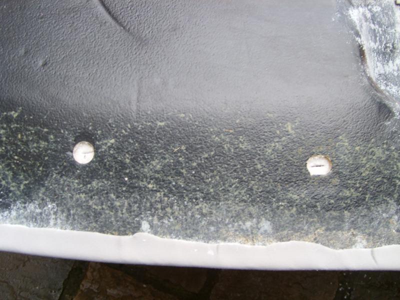

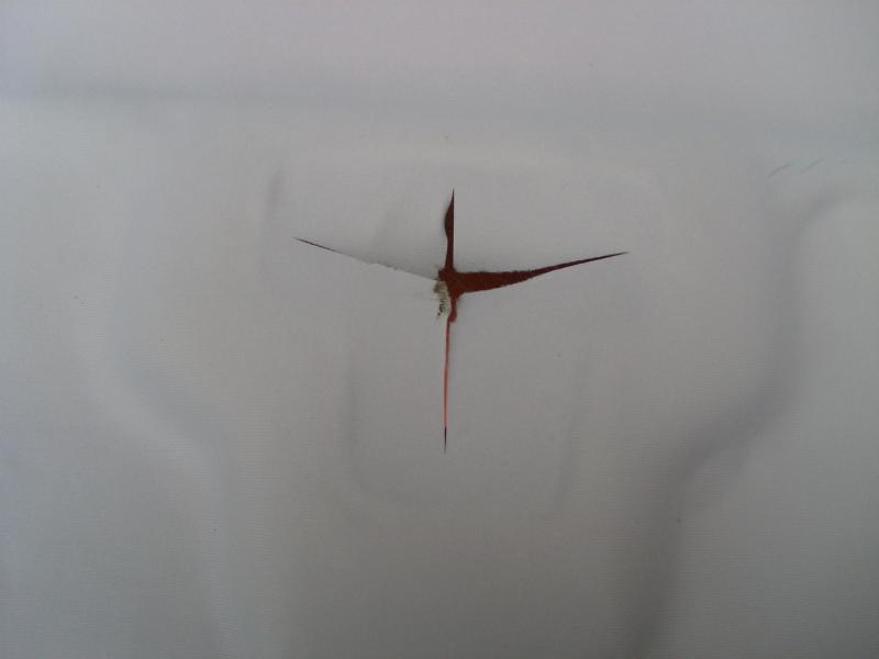

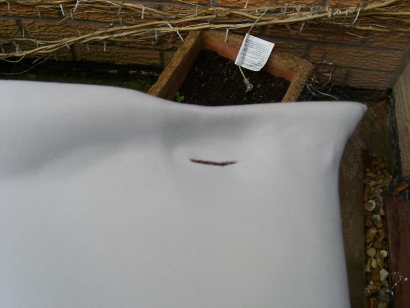

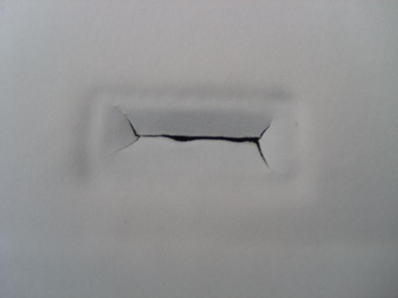

              Using your blade/knife locate the 2 centre holes and make a cross cut
              The next part you can do either with the material facing up or down.
              Locate the grab handle slots and slice one slot in each hole but try not to cut to the sides
              Repeat for the sunvisor holes.

                Locate the holes at the front and pierce the material
                Slot for sunvisor

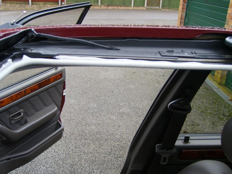

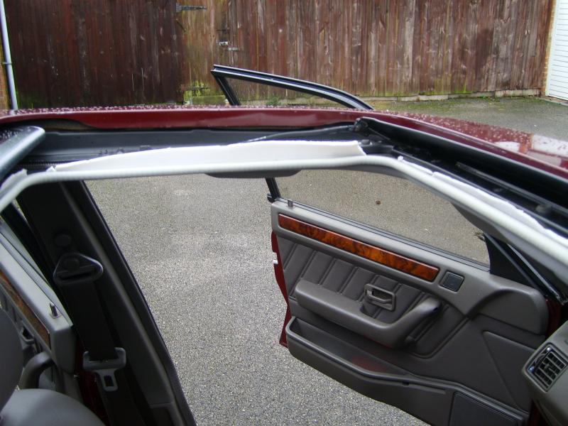

                  Put the car in reverse gear and manouver the biscuit back in to the car via the passenger front door.
                  Monouver the biscuit up over the rear seats to clear the steering wheel
                  Manouver the biscuit up to the roof and rest it on the top of both A post and B posts
                  Pull through all wires for the internal lamps
                  Locate the 2 rear sunroof tray clip holes and push both clips back in, this will hold the biscuit up now

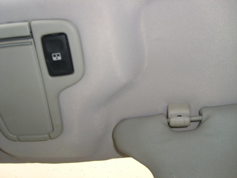

                  From the front passenger side, locate the sunvisor holding clip hole, push in so its back in its hole, put the screw back in and fold the cover back on
                  Locate the centre sunvisor clip and push up
                  Locate the sunvisor holes and screw in

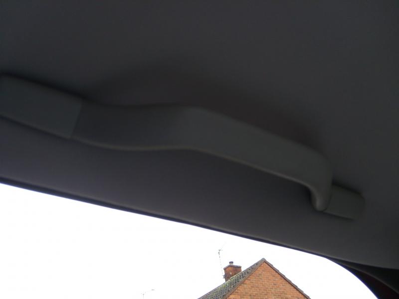

                  Locate the front grab handle, face up, screw in and fold the covers back on

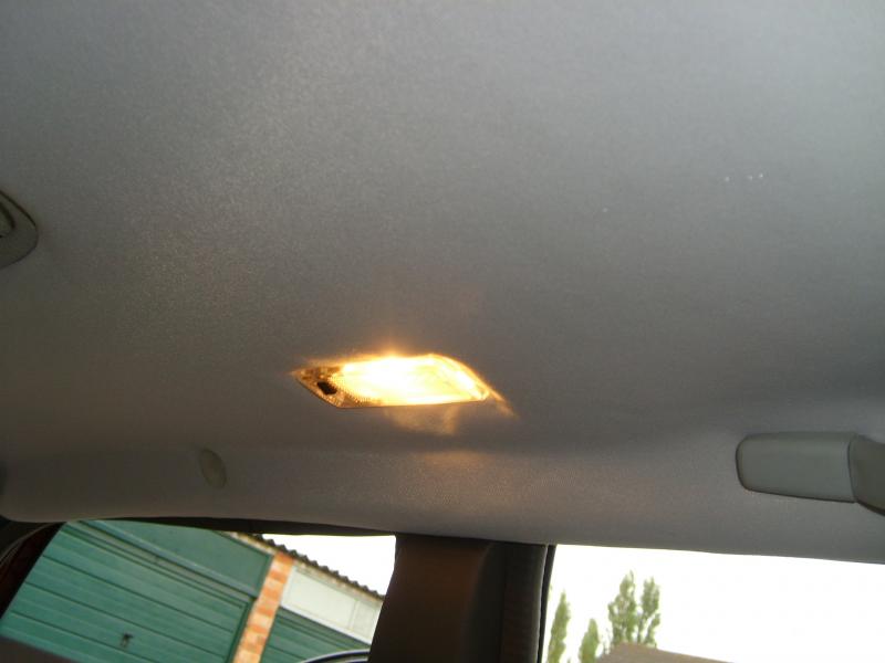

                  Re-connect the internal lamp and slide into its recess, check that its working
                  Locate both rear grab handles as per the front
                  Locate the rear long trim and offer up to the long overhang bracket. This trim goes over the bracket and holds the rear of the biscuit
                  Re-connect the drivers internal lamp, check that its working

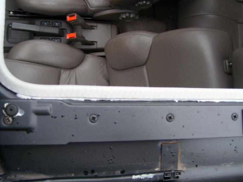

                    The drivers locating stud
                    Pull back the biscuit a little from the side.
                    Looking up from the mark you made you should see the square hole the drivers clip goes in.
                    Punch a small hole in the headlining level with this square hole and straight up from your mark.
                    Push the locating clip through the hole in the headlining, locate the square hole and push in.

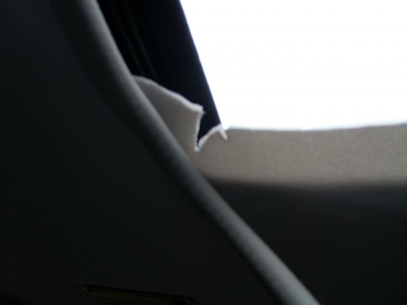

                      Last part is the sunroof surround
                      From any corner pull and fold over the excess material over the sunroof opening and push on the surround working round it. I do about an inch a time.
                      Corners need to be cut not too close to the surround
                      1965 Ford Zodiac Executive. Fab cruiser
                      1997 Jaguar Xk8 Convertible. New cruiser
                      2004 MGZT V8. Love this car
                      2004 MGZT V8, project for the winter nearly done.
                      • #26

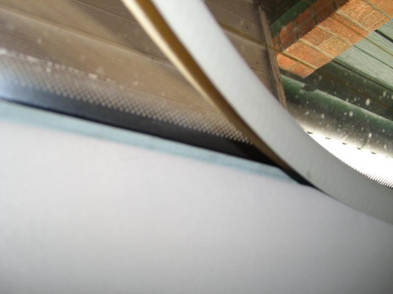

                        From the top of the sunroof opening you should have excess material
                        Trim using a knife/blade all so it's tidy without cutting into your paint

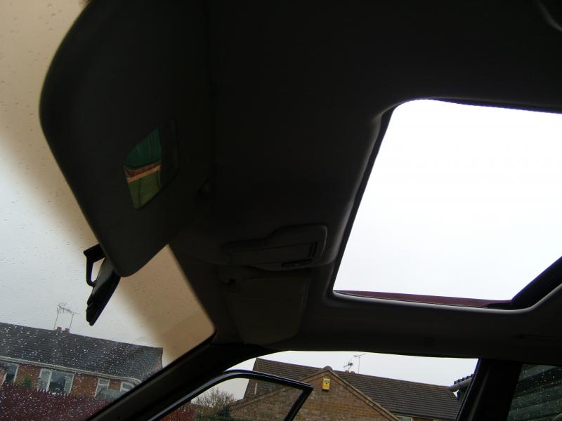

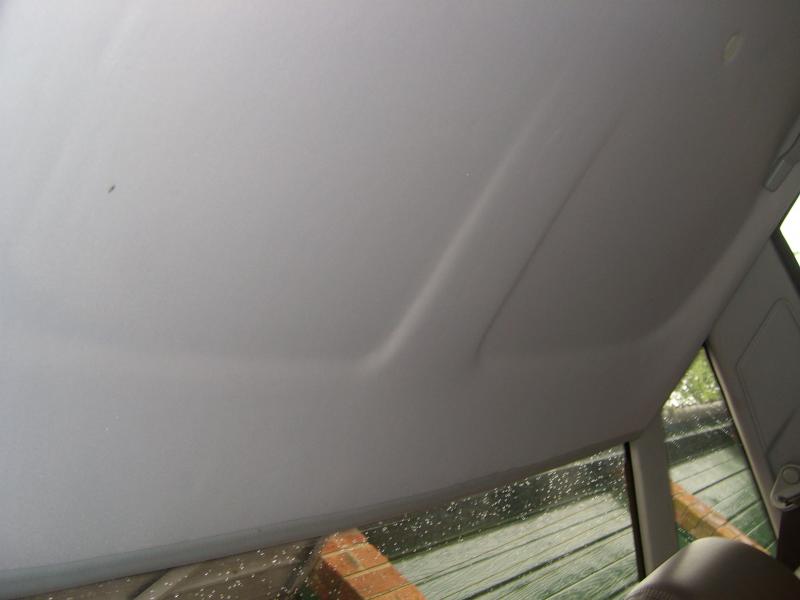

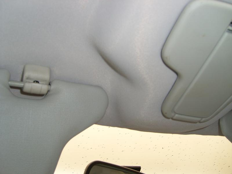

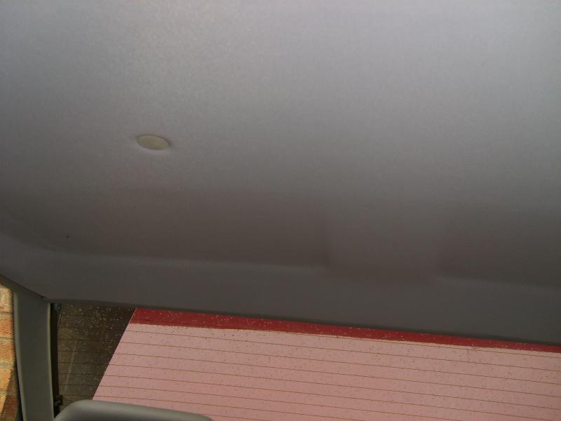

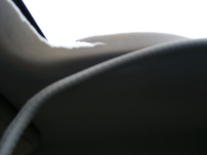

                          Your headlining should now look something like this with no saggy bits anywhere
                          There you have it, an easy job really.
                          A company would normally charge about 200 for the job, this cost me 27 to do and you can do the whole job in about 4-5 hours
