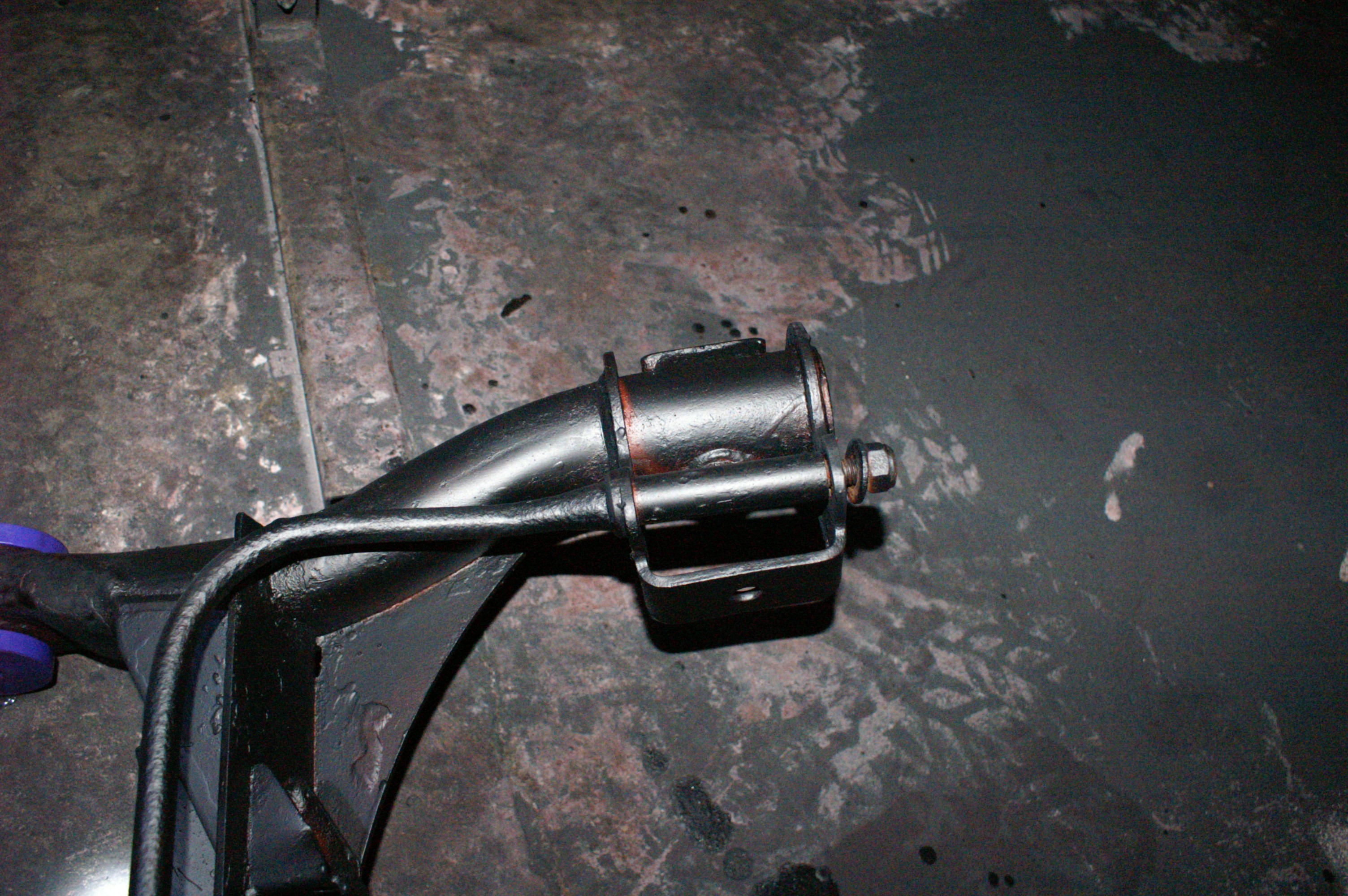

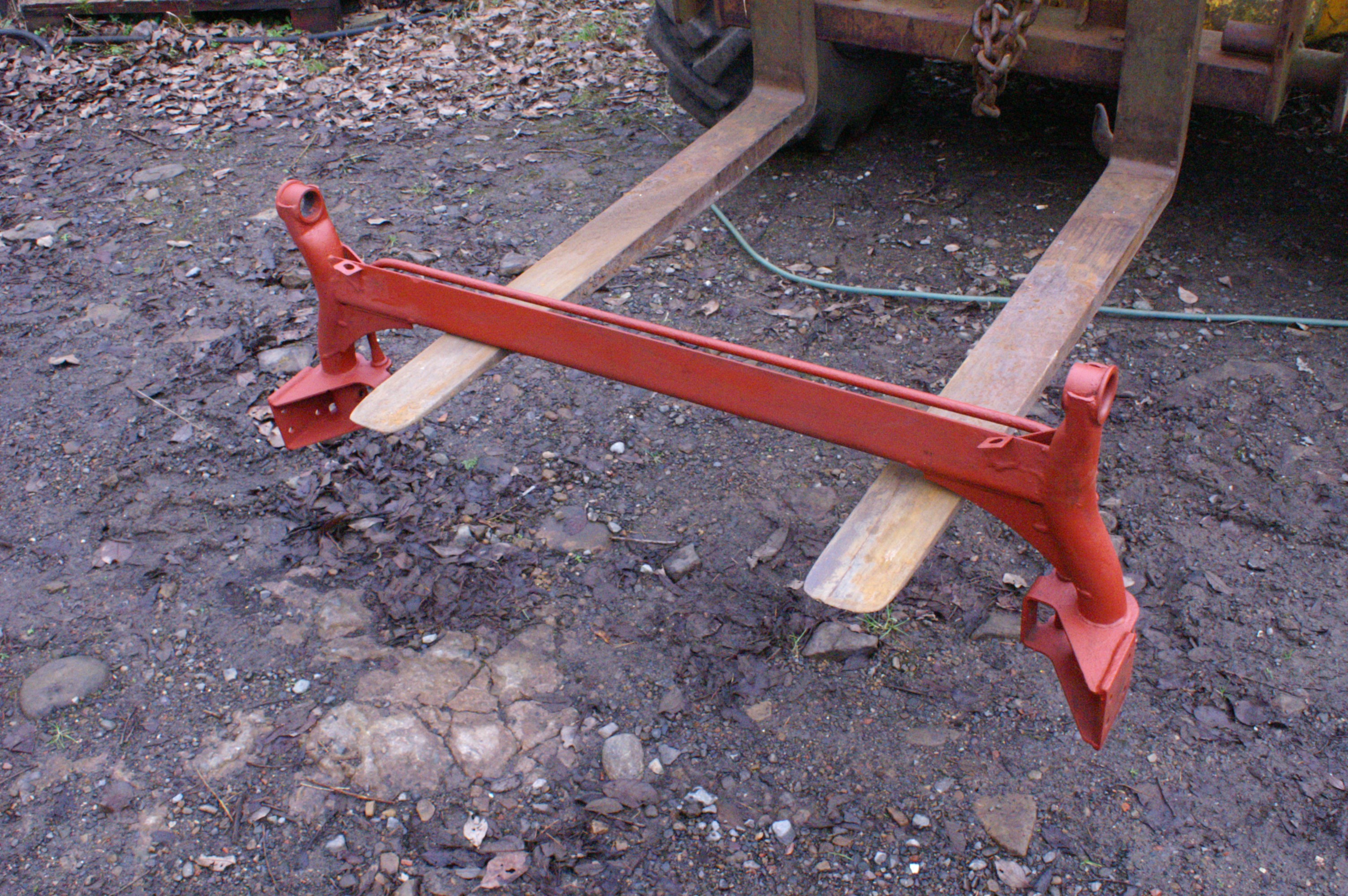

    all, does anyone have a picture to hand of the rear axle of a maestro turbo and the rear roll bar set up?
    i will be incorporating one into my MG1600 restoration so could do with good clear pics of the set up/mounting brackets and mounting points.

    I'll be able to take one tomorrow or sunday if nobody else comes up with one. It is an efi, but same setup, it fixes through the two holes on either side under the strut mount & follows the line of the rear axle, so very simple, but sometimes a pain to remove.

          here are some pictures, the later axles had the lugs fitted as standard, but early ones didn't...easiest way to fit an antiroll bar is probably to get a complete axle from an efi, which will be ready assembled. The spacer between the lugs is generally rusted onto the bar... Click image for larger version

            That's.fantastic Dr D, appreciate your time and Info mate.
