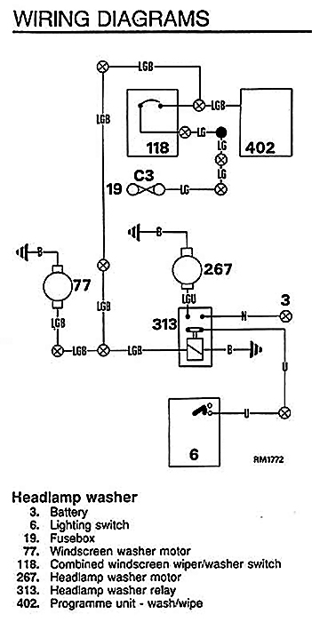

            Electrical aspects:
            Harness headlamp power wash HAM 4239 (NLA but I can make you a copy if you like ), Headlamp wash timer relay DRC8624/DCP 8495/YWM 10002 (all NLA). You might not have anything to plug the power wash harness into, so I can supply a wiring diagram.
            For Maestro fans - you can do headlamp power wash as above but using Rover 800 washer jets (if you can find any!!!) and a bit of wiring to enable the harness to plug in.
              Wiring Diagram:
                Originally posted by Simon View Post
                For the water plumbing:
                7 litre tank,Tee piece (go to car accessory shop and get one that is about the same as the jet hose stub which is cheaper than nearly 10 for a genuine MG Rover one), lengths of hose to suit the tee piece/jets as follows:
                Tee piece to RH jet 650mm, Tee piece to LH jet 380mm, Tee piece to pump 1650mm. Suitable jubilee clips for hose/stub connections (5 off). Pump AFU 4145 or GWW 197 (both NLA), Grommet pump to bottle ADU6418 (2.27). That will get the water side of things sorted.
                Electrical aspects:
