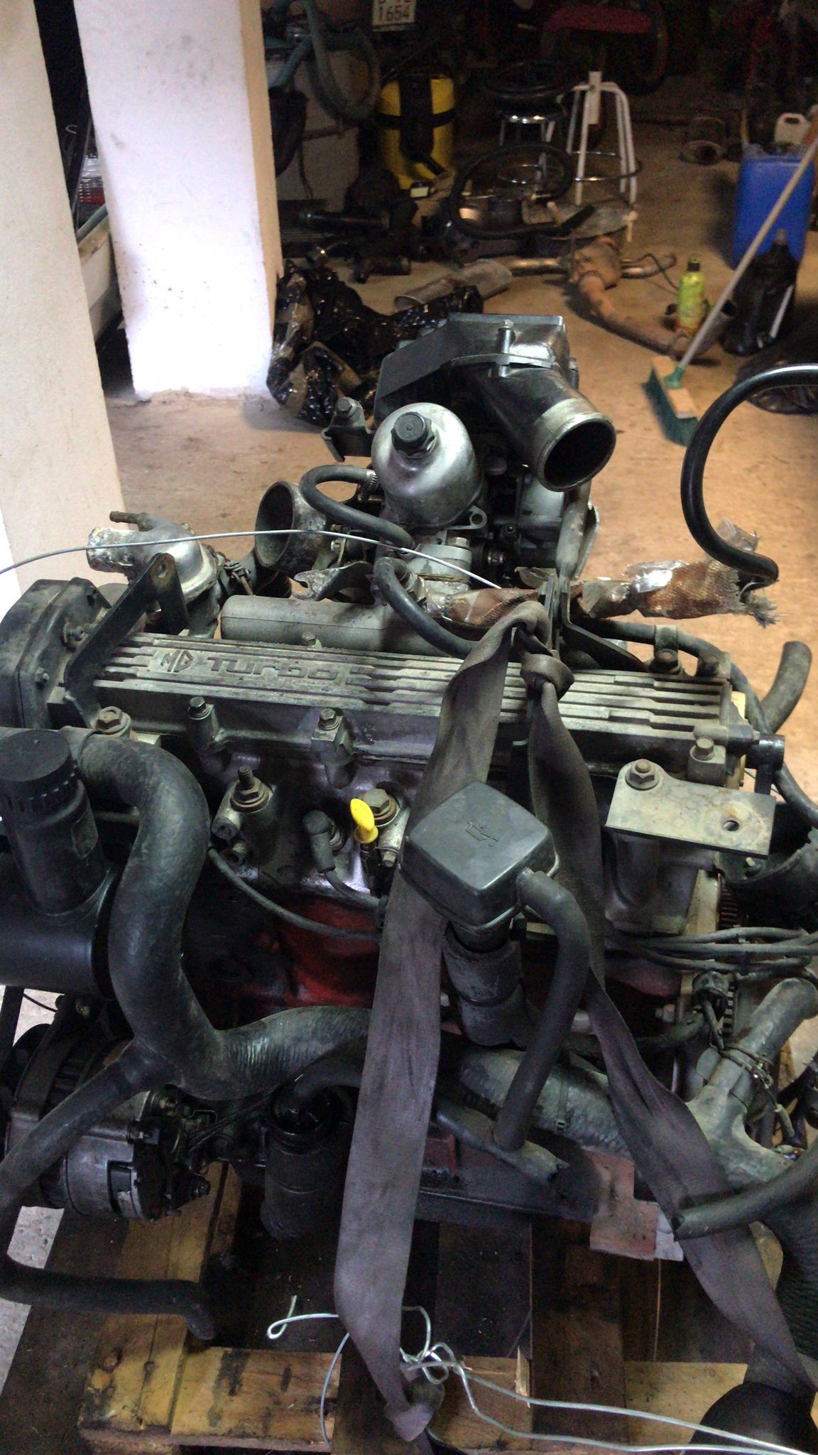

    Hello, After many years looking for a turbo engine in Spain, I finally found one from scrapping but when I disassembled it I found that it needed an almost complete reconstruction.
    The engine has this reference: 20HC85

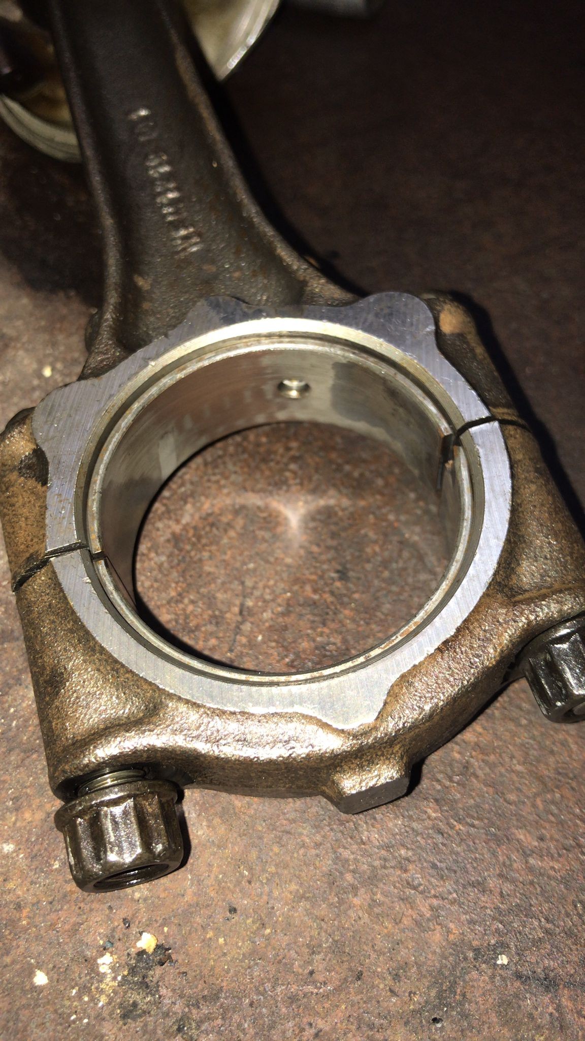

    I removed the connecting rod bushings and it has a coppery color and the piston rings have a lot of gap.
    Where can I find compression and oil piston rings and connecting rod bushings?

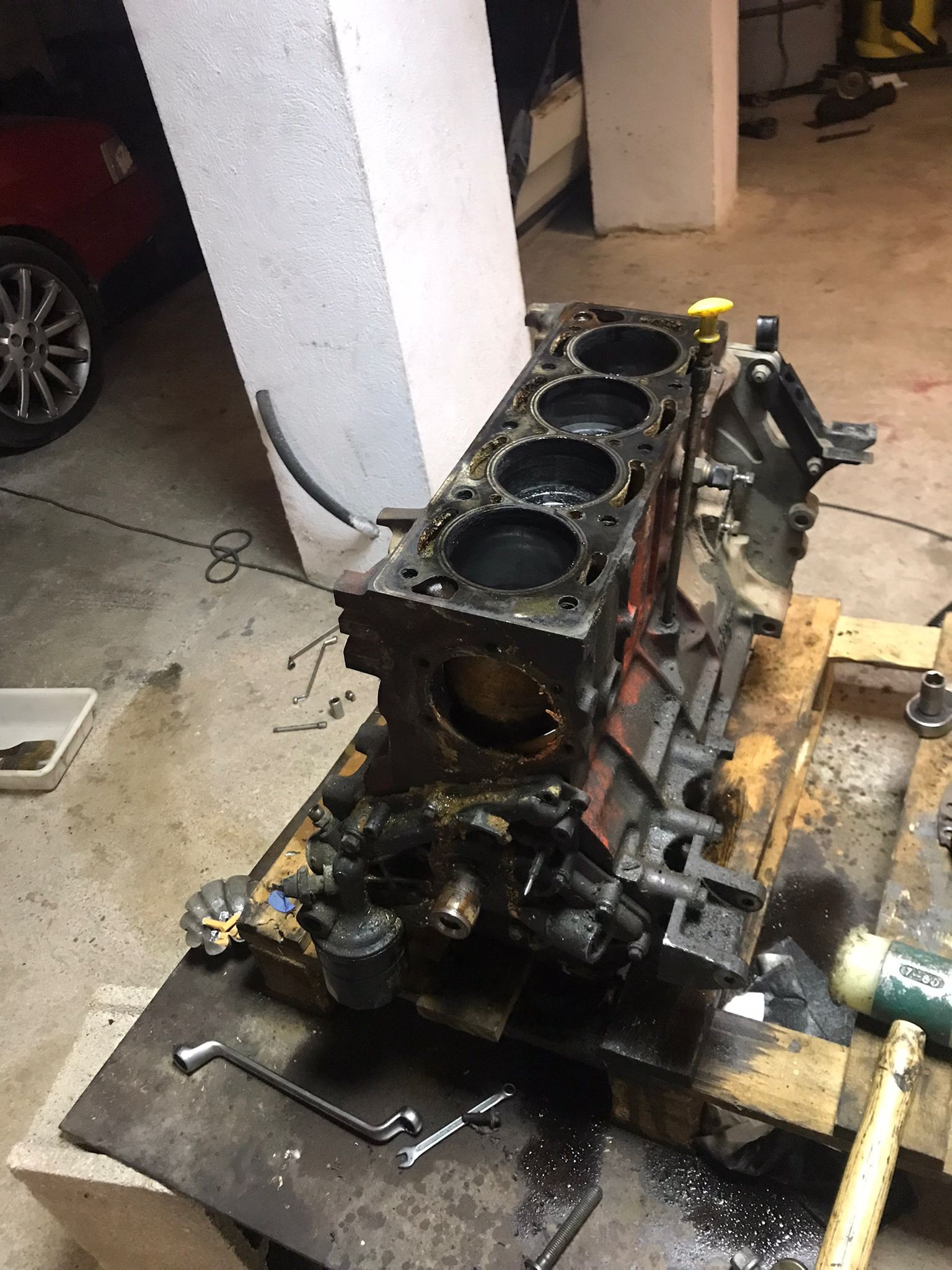

    Another question I have is how can I know if the cylinders are in tolerance? What measures should I take?
    I have a 1992 carb engine and a 1993 efi engine, the EFI engine is in very good condition and I will use some parts if I can't find new ones.

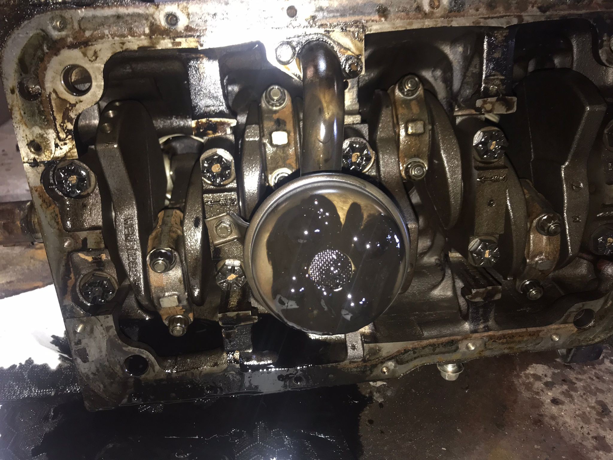

    Is the crankshaft the same on all engines? the one on the turbo model has some worrying marks.
    I have a thousand more doubts which I am investigating little by little and I will comment in this post those that I am not able to solve by myself.
    Any advice and help is welcome, thank you very much
    Pistons, con rods etc are obviously different but piston rings are the same as an efi if standard BHM1531, main bearings are the same BHM1153, Thrust washer again the same BHM1295, Con rod Bearing is BHM1505. Carb, efi and turbo engine blocks are the same, the only difference with a turbo engine is the return hole for the turbo drain. I got mine moved from the original engine put into an carb block. Rimmers did have standard piston rings on their website. I was lucky in buying an unused carb engine with new bearings in it and used those.
    Although the conrod bearings have a different part number they were exactly the same as the carb ones after I had measured them. With your tolerances it would all depend on what needs to be done or if you're swopping things and how much is worn out.
    Crank has a different part number for a turbo but the part number is only listing a set including bearings and dowel and not only the crank. Part number for the crank set is BHM1584 superceded by LFT10007, efi and carb is BHM1583/LFT10006.
    Again I used the existing carb crank after measuring it as it was the same as the turbo crank, i'm guessing the part number difference is the con rod number being different to an efi/carb.

        With the engine completely disassembled and cleaned I took it to a machining workshop to check the tolerances and they asked me what the engine code is, I told them it is 20HC85 but in my workshop manual there are only references 20HF50 20H and 20HE15. Does anyone know what engine my engine code refers to?

          The later letters are later years engines. 20HA is a very early type engine that was re-worked and called 20HB. 20HC is about 1985-87, 20HE is 1989ish and would be the type that moved the oil way. The tolerances are not affected. 20 means 2 litre overhead cam. Your engine should have the number on the top of the block facing the front.

            Apparently the engine needs a new crankshaft as it has a crack and +0.1mm oversized pistons and rings. Connection rods are fine.

                  I finally got the bad news that the replacement engine also has a bad engine block. The grinding machine tells me that they are looking for oversize pistons and segments. Does anyone know if anyone sells oversized pistons for the turbo engine? Connecting rods and crankshaft are in good condition.

                    I don't think you'll find any as they're now rare. Depending on your budget you can get pistons made to your own specifications which would include piston rings

                          Finally the grinding workshop will eliminate the current cylinders and insert new cylinders and machine them because I have not been able to get pistons +0.25. I have a doubt, the turbo enfine has the hole for oil different than the carb engine but the cylinder head looks like the same. Can I use the carb engine with the turbo cylinder head and viceversa? What cylinder head gasket I must use?
                            The cylinder head for a turbo is not the same as an efi or carb engine. Valves are different. The carb engine can be use but you'll need to insert the turbo drain pipe at the back of it. The headgasket and manifold gaskets are turbo specific but you can use a good payen head gasket if needed. Manifold gasket had metal surrounds on the ports. If you use a cheap head gasket and manifold gasket they won't last long before they blow.
