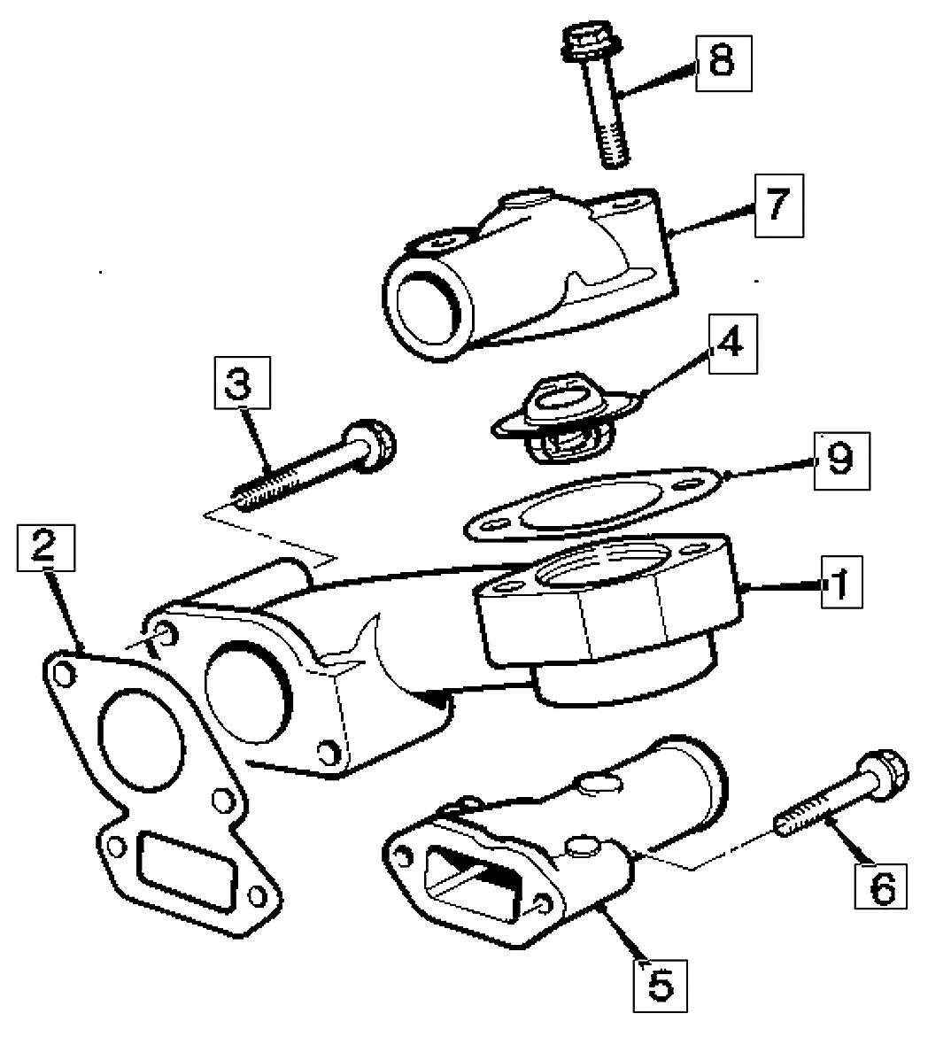

        This is what i need if anyone has one. Not sure what else it fits or what other cars had them.

          All prices from Rimmer Bros incl VAT. NLA=No Longer Available. On Back Order means they've run out, meaning its effectively NLA anyway...
          1 CAM9422 Housing-thermostat x1 - NLA
          2 CAM9423EVA Gasket-housing to head x1 - 22p
          3 FB108141 Bolt-housing to head x2 - 55p
          4 GTS106 Thermostat 88c x1 - £4.20
          5 CAM9431 Elbow-water inlet x1 NLA
          6 FB108091 Bolt-water inlet elbow x2 - £1.90
          7 UAM4299 Elbow-water outlet x1 - £5.35 but on back order, but AE Wilcox has one in stock
          8 FB108091 Bolt-elbow x2 - £1.90 but it is 24ct gold plated
          9 PET000201EVA Gasket-water outlet elbow x1 - 19p
          Last edited by Simon; 11th September 2014, 15:39. Reason: Reason for Editing:PET000201EVA
            All of these bits are unique to the 1.6 S Series engine from 1984-1992, The Thermostat elbow dome shaped thingy is unique to post October 1988 models on both Maestro and Montego.
              Thank you. After I posted that mesaage, I did manage to phone rimmer brothers. I bought what I hope is the correct bit and should have it by next week all being well. The chap I spoke to actually seemed to know what I was talking about. He did say bottom part unavailable. All being well the top bit I will just need.
