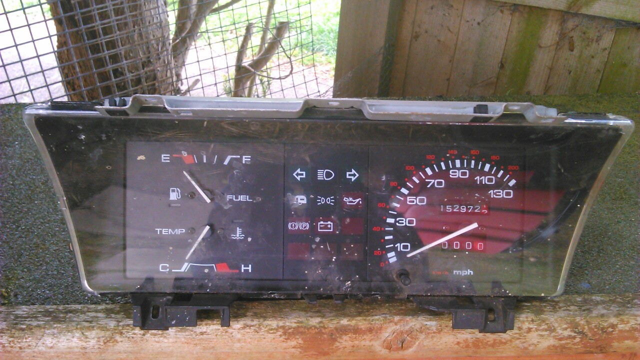

    Got some will send you a picture later. I will be at POL.

          Sorry Neil been busy.
          Dug them out, any good?
            Tip: Use a normal table fork or similar to gently prise off your old speedo needle (note where the needle's zero point is first though and take care as the needle is a bit fragile) then you can remove your old speedo head from the back of the cluster thus preserving your recorded mileage in your new cluster. Also check for any blown illumination or warning lamp bulbs at the same time.

                    Only just saw this Oli, perfect.
                    Assume it has the glow plug warning light too?
