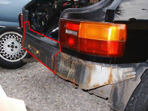

    ...any rear panels for a plastic-bumpered Maestro?

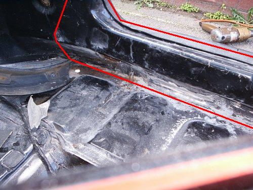

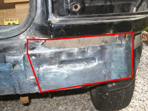

    The panels I mean are highlighted in the attached images. I feel they need to be replaced with full new panels rather than welded or filled; (enough of that already).
    So I am looking for these replacement panels, and am unsure as to where to get them from, and what the prices are...

      Try Rover Steve, the boot panel is still available, over 100 quid though...
      Gareth
        I was given a price of £100 for a Monty saloon back panel from Magnum. I can only presume the Maestro one is around a similar price mark.
          Yep, as Gareth says, still available from Rover, and around £100. That's about the only place you'll get one too.

            The 2 end panels that your after are only available from rover as well, there 20 pounds each and I had to wait 3 weeks for the LH one.
              Why can't you just treat and patch the panel you already have? It doesn't look too bad to me.
                I've done this job, Steve. The rear panel includes the boot floor up to the spare wheel, then there are 2 small panels each side to accommodate the rear lights. You have to unpick a lot of spot welds! It's a lot of work but then you know it's all rust free. I was offered the rear panel for £100 from the dealer in Bedford about 2 years ago but then bought a NOS one from the MMOC for around £50 - have you asked the club(s)?.
