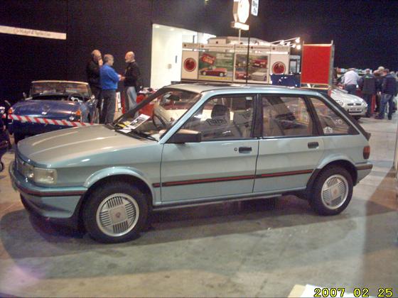

                It's good to see the progress on this car and that others are taking their cars to MAPS to have them restored. As many will know, I used them to do some work on my MG Maestro 1600 after being seeing the work that they did for David West on his MG Montego Turbo.
                I believe they are probably unique in that this company does work to an exceptional standard and not only are they sympathetic to our cars, they own a fleet of MG Maestro and MG Montego Turbos and they are members of the MG 'M' Group.
                I could go on extensively about the quality of their work and the depth of their expertise (both mechanical and bodywork) but this picture speaks for itself. Next year I am hoping to get the other side done - if they are not too busy doing everyone else's cars!
