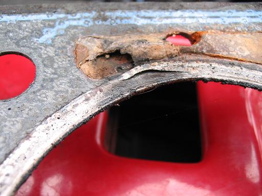

    I have also put a photo in of the typical head gasket fault on a diesel engine. Symtoms are presurised cooling system even when cold overnight, white smoke on start up, using coolant with no signs of external leaks and in really bad cases, the engine locks up and cannot be started because coolant has filled the piston up.

    Your photo show that head is off the block, can you still do it the same way with head still on block ?
      Yes you can.
        Yes you can.
