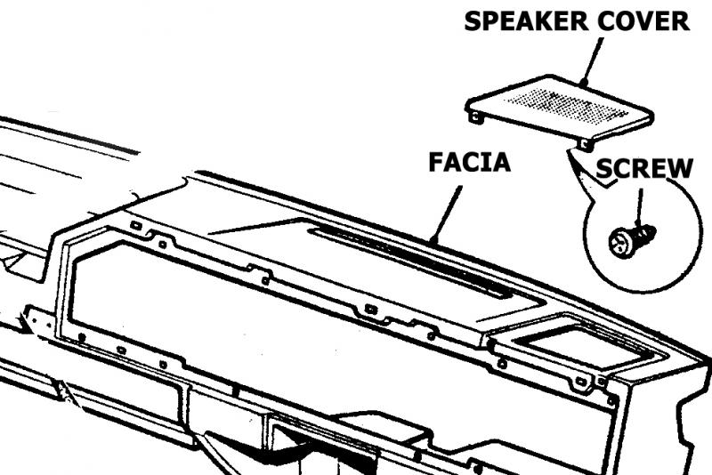

        I'm going back to 1991 when I last did speakers in a Maestro with an early type dash, so apologies if I've got it wrong, but from memory:
        If you remove the instrument panel surround by pulling it away, then you will see the two screw heads that fasten the O/S speaker panel to the fascia. These are hidden from view by the instrument surround for neatness, which is causing the confusion. Undo the two screws and the speaker panel can then be lifted away from the fascia, revealing the O/S loudspeaker. This can be unscrewed and removed.
        Replacement speakers on those are 4" (or 100mm) size. Most speakers have slightly elongated mounting slots anyway to cope with the vast amount of installation possibilities. For replacements, try these:
        http://www.ebay.co.uk/itm/PHILLIPS-C...-/351008144190
        This diagram might also help you:
          Simon is spot-on with that.
