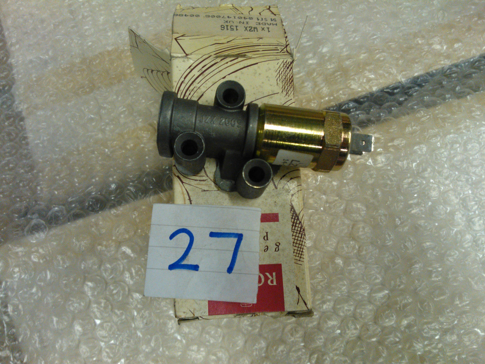

                  here below are pictures of an ORFCO valve and a vacuum switch. It could be that you have only the the orfco valve fitted. A photo of your carb set up would confirm.
