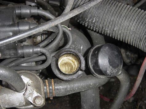

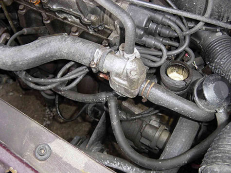

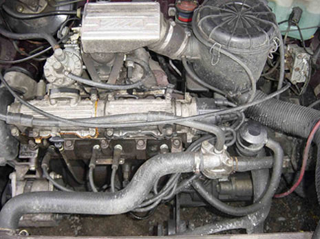

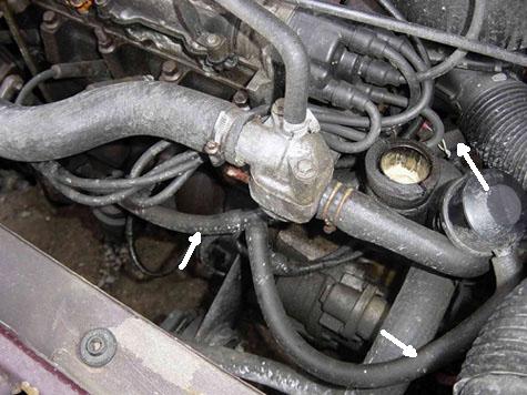

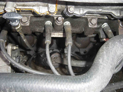

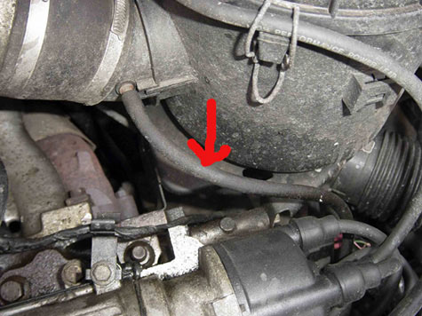

          Finally borrowed the digi camera from work and took some pictures of the oil pipe work.
          1. Picture of the oil filler tube with the cap off….anyone for Hellmans?
          2. Picture of the oil pipes – seems fairly obvious which pipes they are but would appreciate confirmation.
          3. Picture confirming my car has the extra pipe to the air filter
          4. Wider view of the engine bay

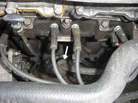

          5. Picture showing what I think is the oil cleaner (between the two centre spark plug leads)
          Burgundy 1987 Maestro 1.6L
          173,000 miles.
            Hi, You have correctly identified the oil seperator (pic 1) The breather hoses are straight forward one from seperator to tee piece, then tee piece to oil filler cap and tee piece running under air filter round to the carburettor. (pic 2)
            Regards gary
