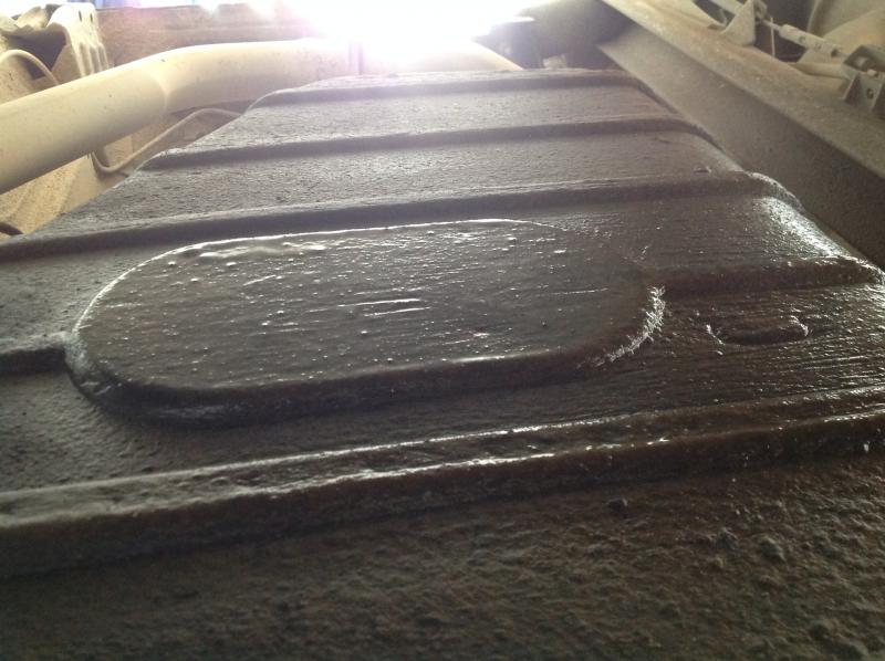

    This is something I should dealt with years ago ! Now I don't know where to start I think it's more noticeable when I fill the tank right up .Can anyone give me any pointers ? What is easiest to cross off the list first ?

    IF it isn't the fuel filler pipe corroded then it is usually the fuel tank seam that is leaking.
      re tank
      it sounds like the seam of the tank only half fill tank and you mite not waste fuel till you get time to replace or repair your tank
        Thanks for the replies,do I just follow Haynes to remove ? whether it's a diesel or petrol ?
          There are 4 bolts and both pipes to remove. I'd suggest a replacement tank will be easiest but difficult to source these days sadly.
