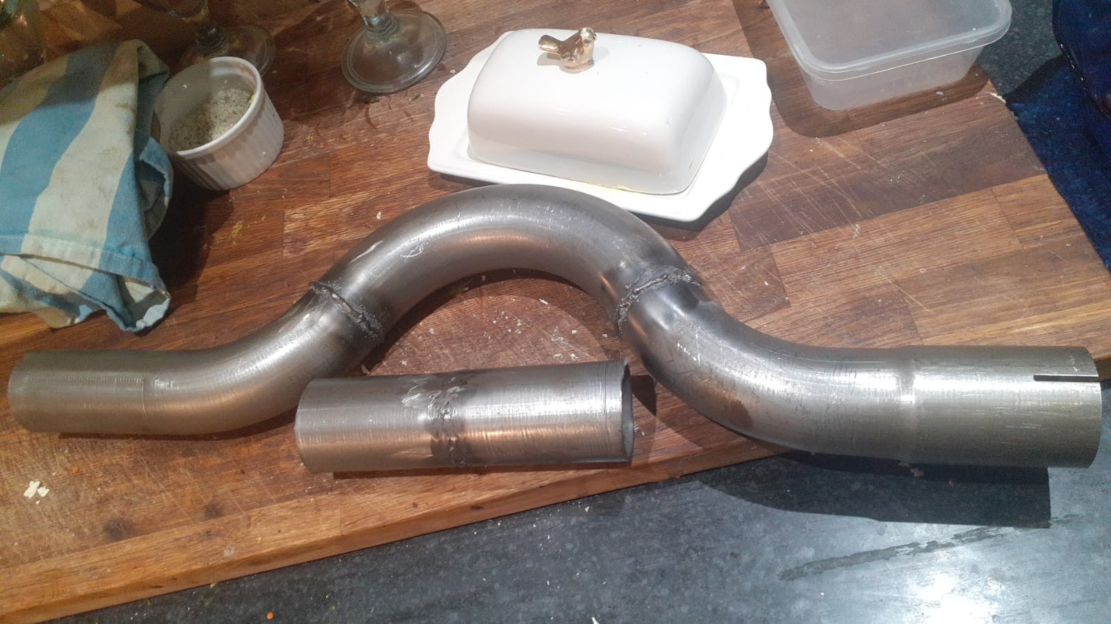

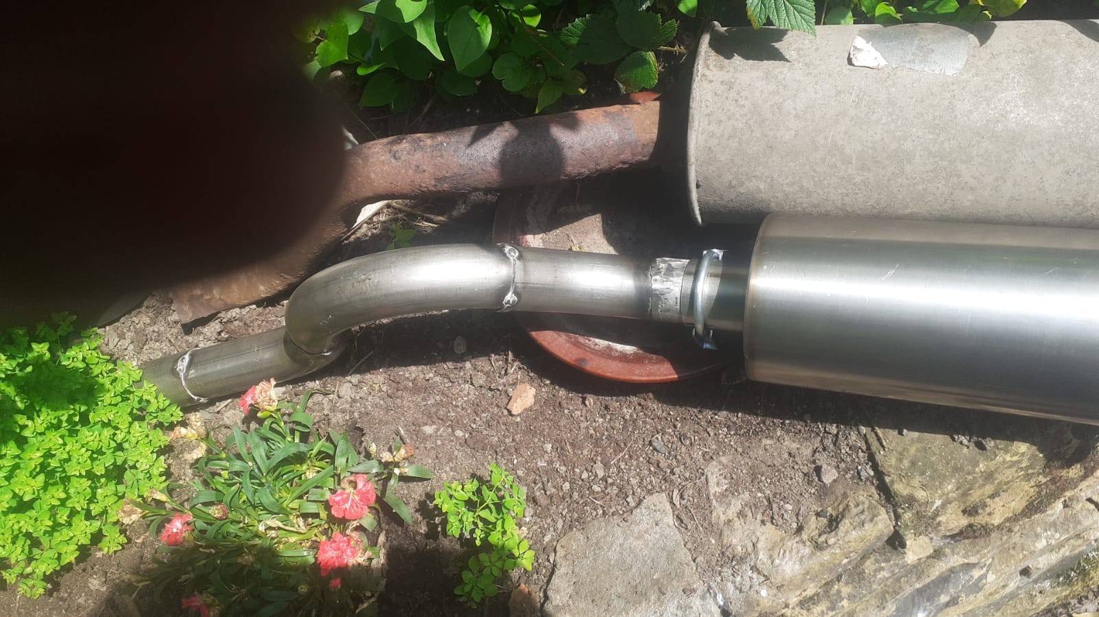

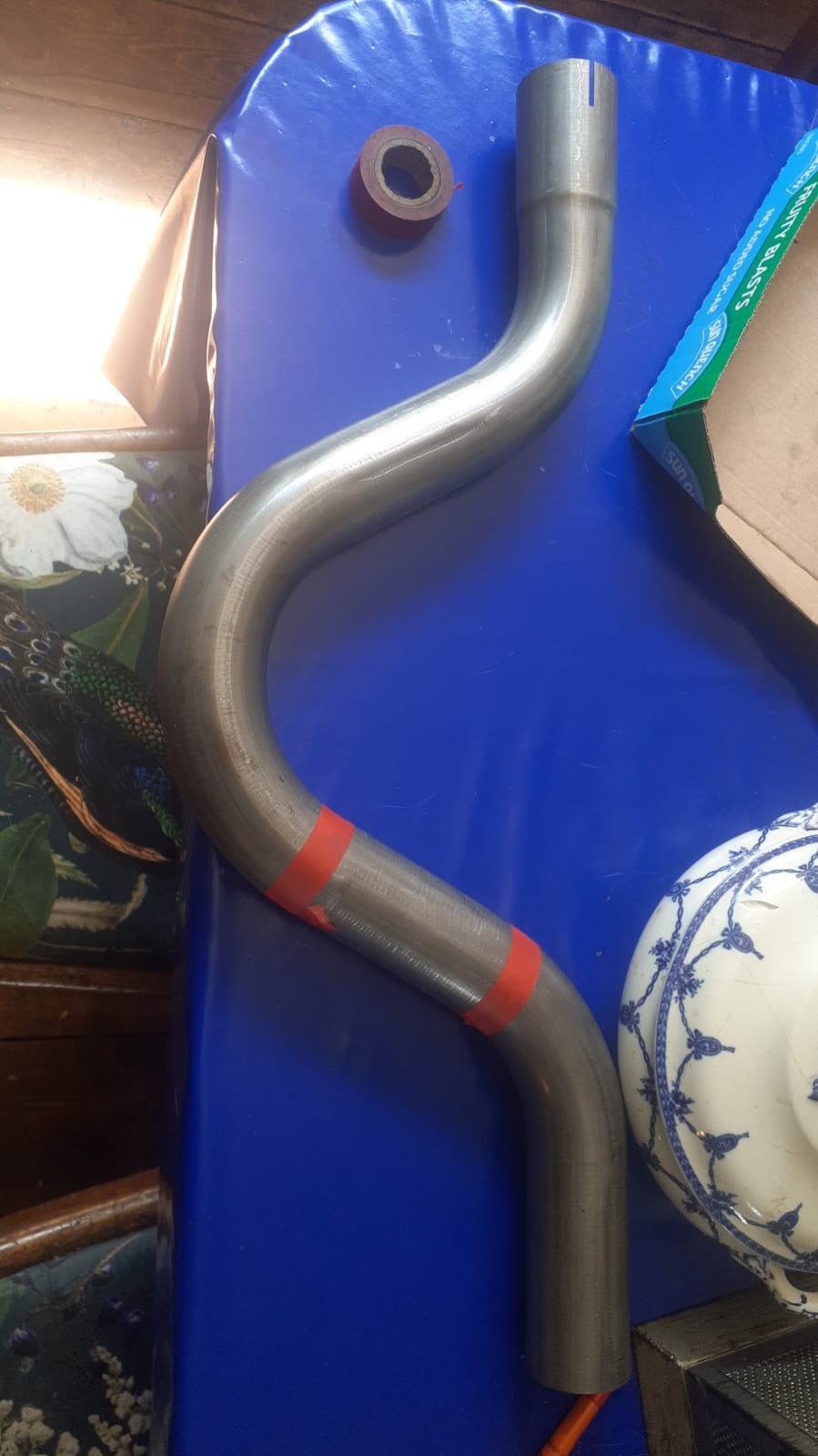

    Made a custom over axle pipe then fitted a stainless can
      Had to lower height of over axle pipe and angle slightly thank god for inverter migs the fluxed wire once you get your head round it is ok then fitted a stainless backbox with u clamps all bits were on eBay I'm very pleased it has less back pressure than previous smaller bored zorst and noticeable difference in engine braking
        Cost £40 for backbox £28 for over axle but bit against my religion I always used to weld up old ones however not as easy to source these days
