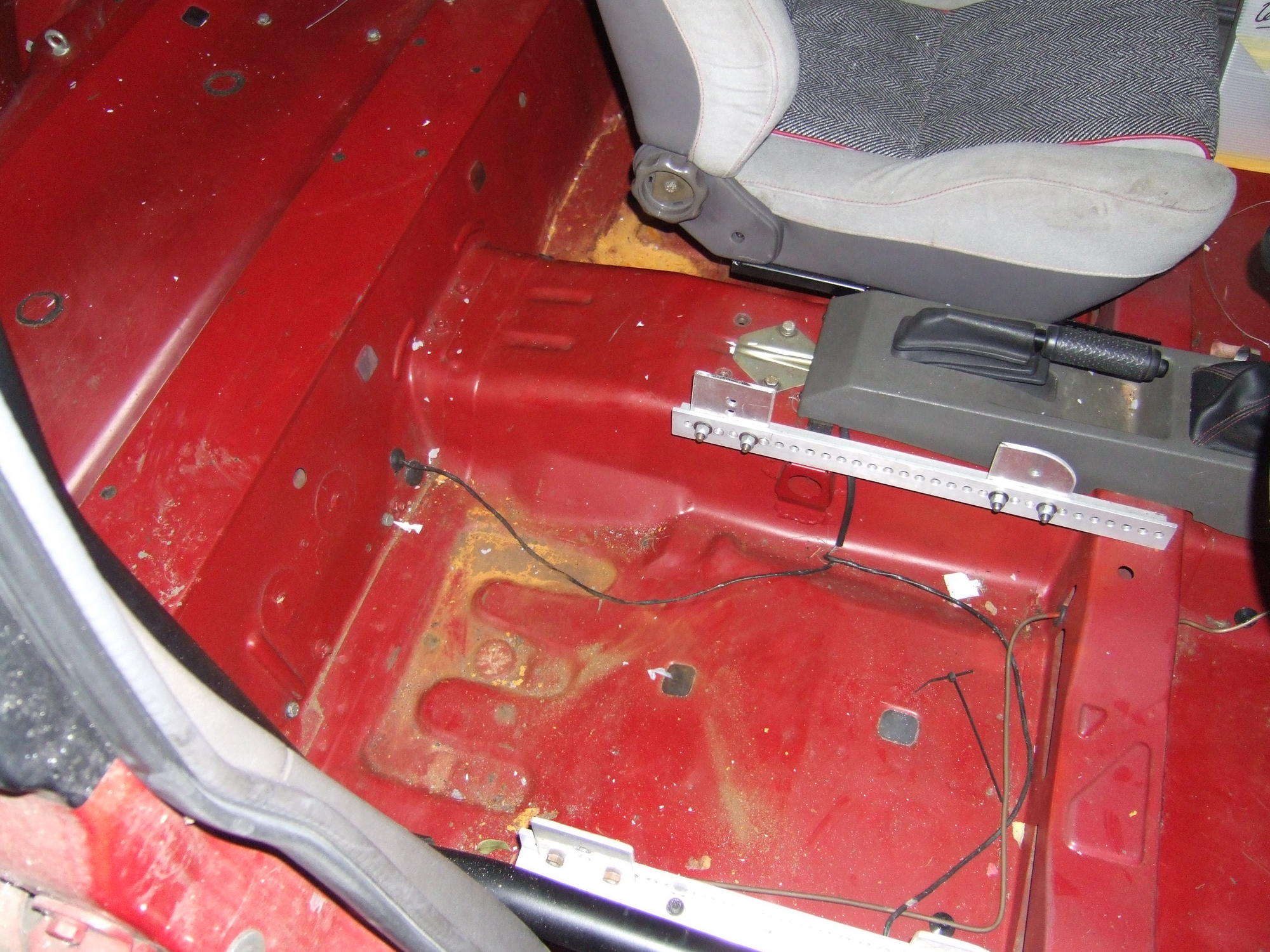

                    few more pics

                        Floors look in good order,which is a good start.
