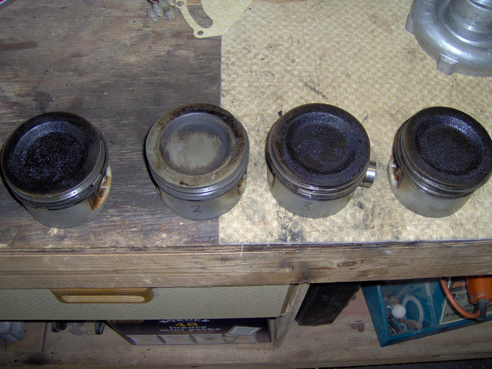

        Hi Pete I have already done a deal with tonyrs but my brother is also after a set of standard size, do you have any pics.
        thanks painter
          thanks painter
          Hi, Just taken pic below. As you can see they will need the crowns cleaning, and I can only find two of the split rings at the mo' - the others have gone walk-about, but they are around somewhere! Let me know what you think!
          Club Secretary
            pistons
            Pm'd you pete
