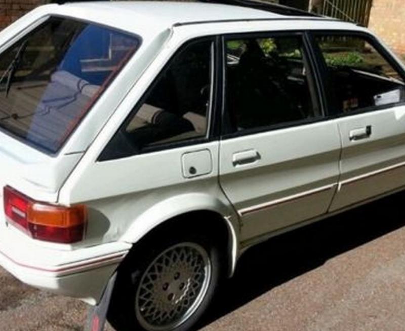

                  Is it just me or has this car been badly repainted with different shades of white on the doors, badly repaired rear arches and rusty sills?
                  The pictures don't match the description (or the price).

                    Looking at the photos I can see some possible rust on some of the door bottoms and/or sills, but can't see obvious problems with arches from the photos (maybe your eyesight is better than mine)

                      The arch has been repaired - probably with a repair panel. This doesn't look rusty. Above the arch where it meets the scallop, there are bubbles of rust and in the picture attached, it looks like the panel near the repair has been filled very roughly. Maybe it's a bad photo but it looks like a pretty rough repair. In addition the sills are rusty as are the doors.
                      As to value, I'd hate to say as values are clearly on the rise. Rough examples are now fetching the sort of money previously reserved for unmarked cars. However this car needs more money spent on it for it to look smart than the £1500 they are asking for it.
