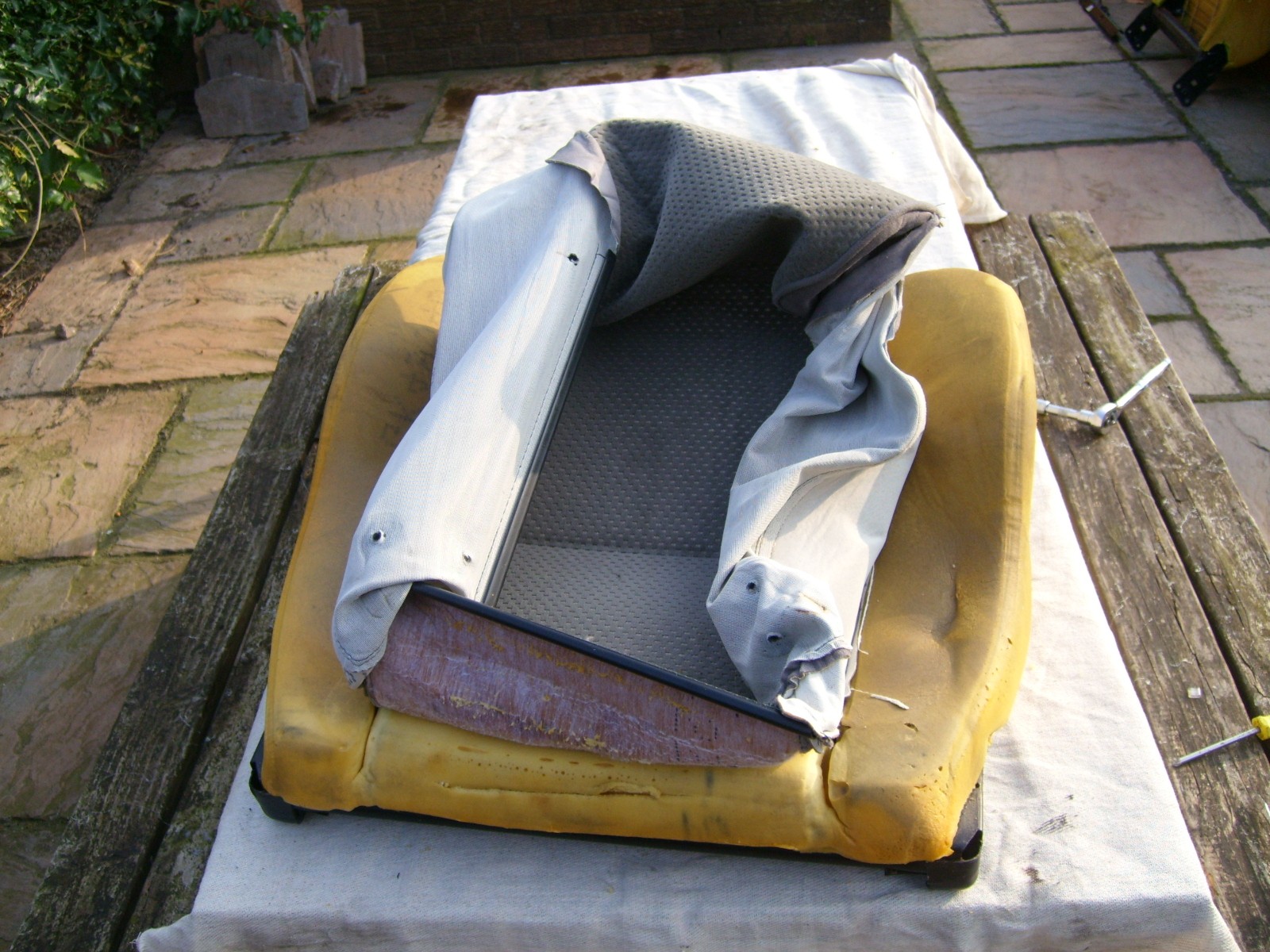

        Turn the base over and remove the sides of the base cover
        Turn over and remove the front and rear clips each side from the mesh surround
        Remove the four wire clips (two each side) from the centre of the mesh surround and retain
        Remove the long flat
        Turn over and remove the cover

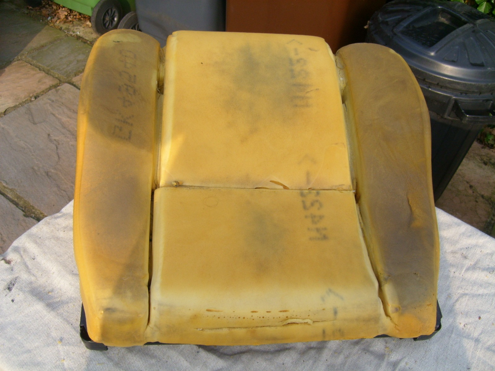

          Old wornout base

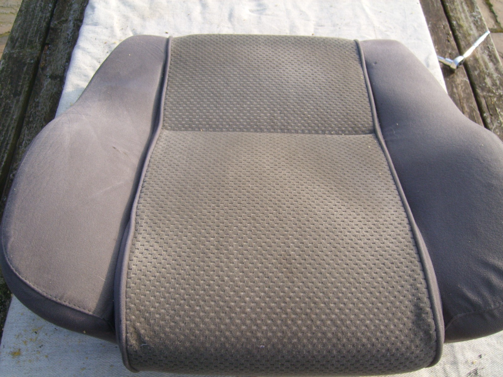

          Replacement base back on with cover
          Much better
          To put back together is the reverse of stripping it down. Remember to line up the holes on the cover

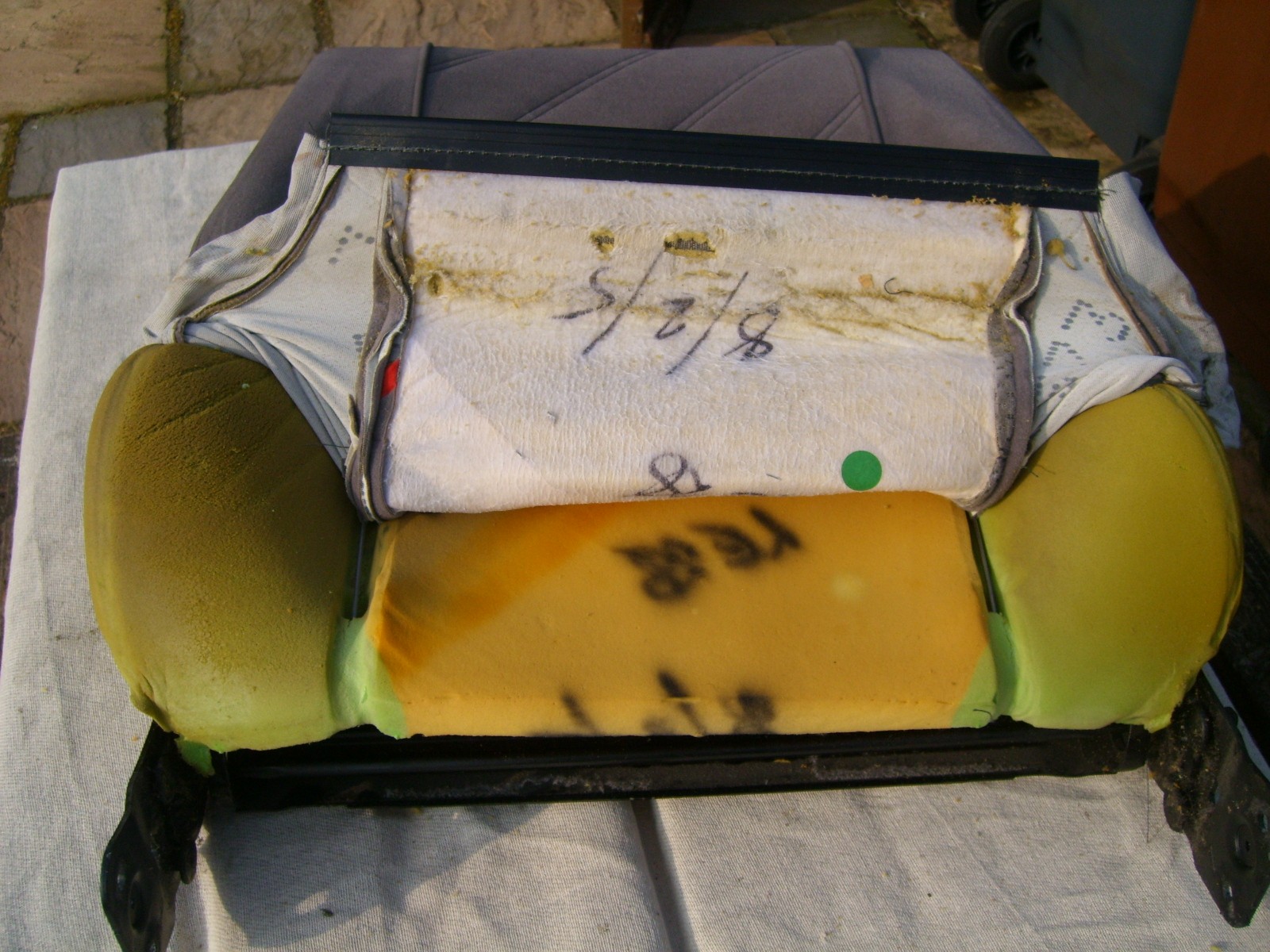

            Slowly push remover the cover while pushing down on the foam until you see two clips either side of the foam
              Turn over and remove the two long wire clips
              Push the cover up to the next point which is the top of the long wire clips
              Turn over and remove the clips by twisting and pushing noting the position on the mesh

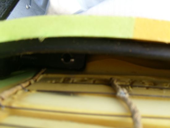

                Remove the springs from the mesh and surround and retain. The front and back remove easily but the middle spring is tensioned. If you dont have a hook use a screwdiver
                Remove the two clips and retain. Ease of the foam from the surround
                You can now separate the foam/mesh enough to get a screwdriver on the tube retaining parts.
                Squash them inwards

                  Old seat foam
