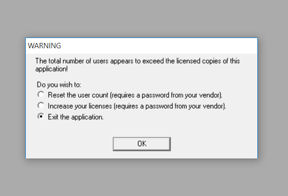

                    Hi Garry - thanks for the download.
                    requires i password - see images below
                    please advise - thank you.......
                      Hi Mike,
                      I can tell that your running that on Windows 7 or above. This software was probably written for Windows 3.1, forget it on modern versions of windows.
                      You will need to use XP Mode as gharper is, or you can use the Windows 95 VM i've made. Whatever works for you best, nothing wrong with choice
