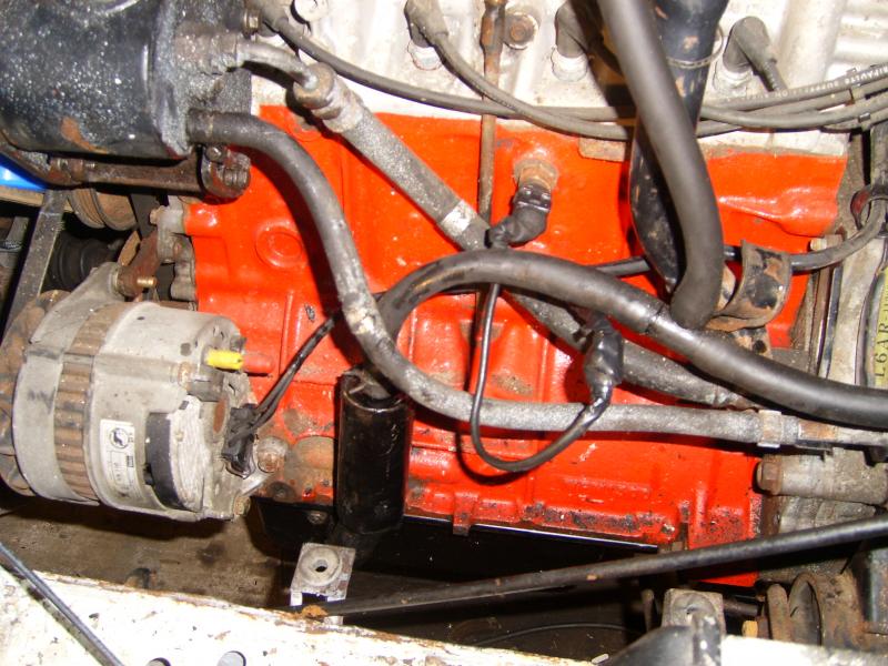

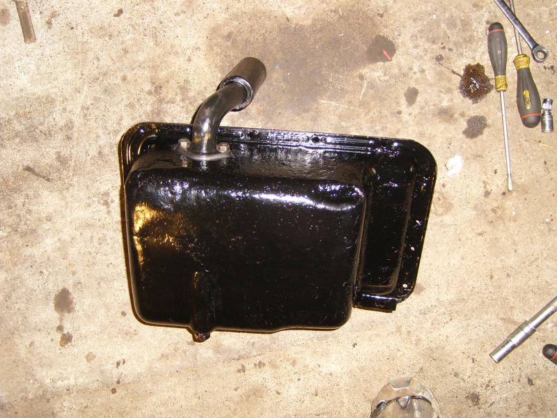

    Sump cleaned up and sprayed black.

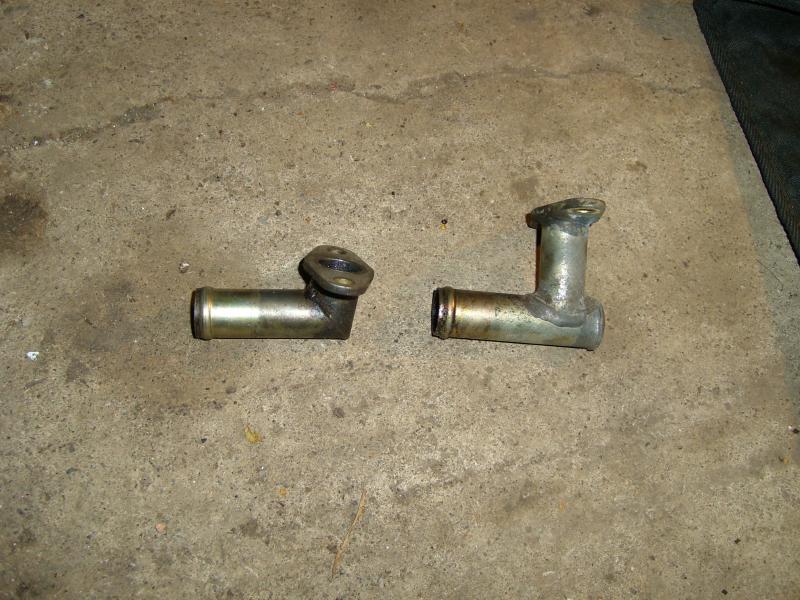

    Turbo oil elbow sourced.
    Hopefully more to come on friday
      Today
      Turbo elbow changed, spot the difference and what a pain to do.
      Sump now on
      Power steering pipes tidied up, removed the long metal pipe under the crossmember as it isn't needed

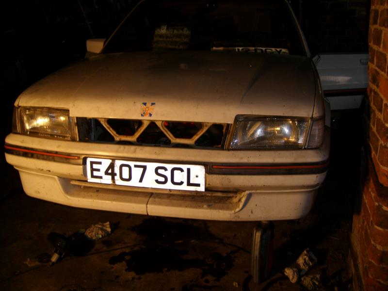

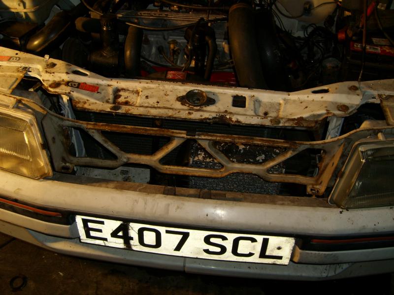

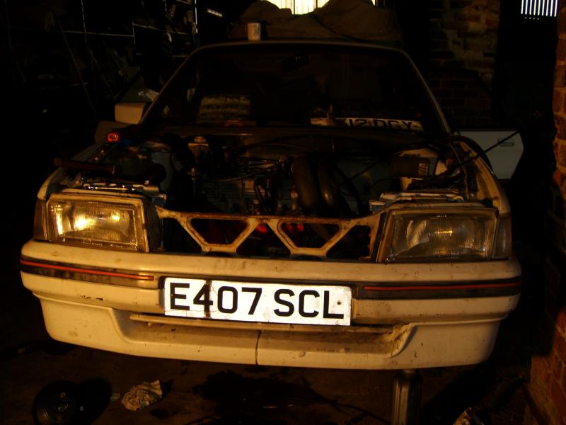

      Front panel and lights on
      Intercooler and pipes on

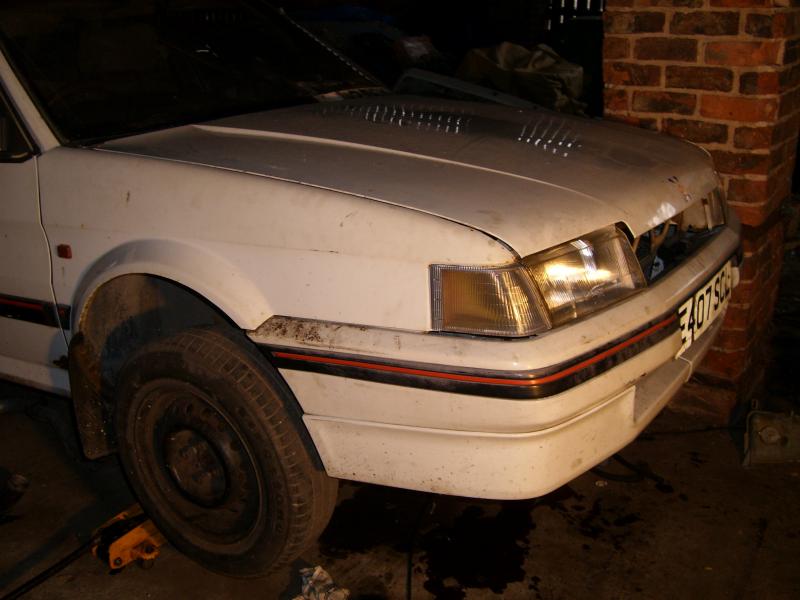

      Front bumper on

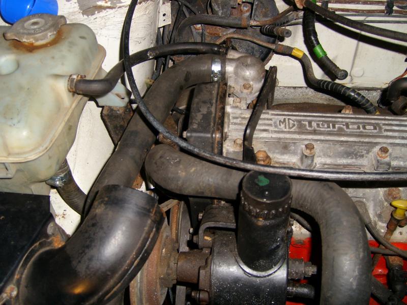

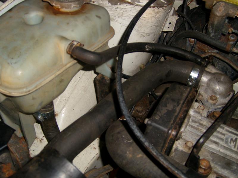

        Coolant pipes on
        Expansion pipes on
        Bonnet on, looks like a car now
        Front indicators on

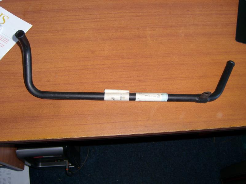

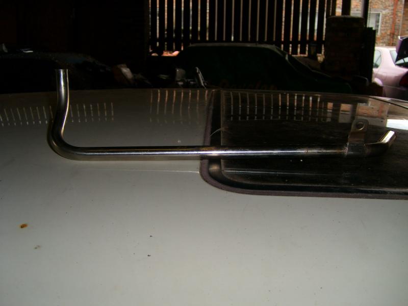

            This arrived yesterday, a brand new rear water pipe for an MG Montego/Maestro Turbo.
            I will be putting on my last spare stainless steel pipe though as more copies can made from an original.

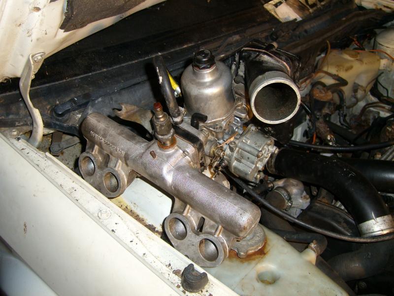

              Tried to put the water pipe on first and....nope, had to remove the exhaust manifold, put the pipe on and re-attach the manifold.
              Re-attached the inlet manifold and spotless inside carb

                  Radiator and fan on
                  Slam panel on and bonnet catch on
                  Grill on.
