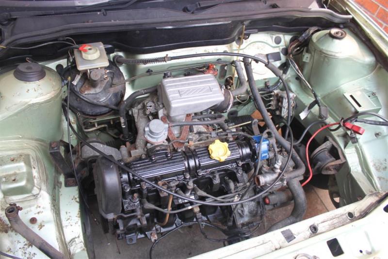

        On Sunday the replacement engine was lifted in and bolted into position. We didn't manage to do much more than that due to the oppressive heat and we moved on to less demanding jobs elsewhere!
        Today I spent an hour or so routing cables and connecting things up before the sun and heat made things hard-going. Maybe a couple more weekends and it should be running!

            Looks like a gold seal engine there, with its black cam covers.

              Today was a very productive one! In fact, it's almost ready to run!
              We started by fixing the new exhaust to the car. Well, this job was actually started two days ago and involved a lot of choice words! Due to the far-sighted vision of the designers, to put a new down pipe on an S Series engined car you first need to remove the front anti roll bar. I bet that went down really well at Quik-Fit back in the day! We finally managed to get the down pipe in by removing the two U shaped clamps towards the centre of the ARB and left the end bushes in situ. This allowed one person to pull the ARM down whilst squeezing the down pipe over the top of the ARB...after feeding the down pipe through from above! What a farce!
              After getting the down pipe in place the rest of the exhaust went on with no fuss at all.
              The car was then put back down on to all four wheels and the steady job of connecting pipework and ancillaries could begin proper. This job much aided by the presence of another Montego 1.6. It's great to have a reference point to see how things should be routed or attached!
              Everything is now in place apart from fuel pipe on the tank side of the fuel pump (I forgot it is a larger diameter than the carburettor side!). I also forgot the essential fuel filter, too.
              When refilling the coolant, everything was going well until the previously fine steel coolant pipe below the radiator holed spontaneously and deposited four litres of fresh coolant on the driveway. I am hopeful there's some suitable copper pipe amongst the spares stash that can be used to replace this section.
              Other than that, some fresh petrol and a charged battery should see it run. Fingers crossed!

                Excellent work! If it has trouble firing when all is connected up, test the fuel pump to see if it is working properly. Yours looks like an aftermarket one, and in any case they don't like being left to dry out - it shrinks the diaphragm!
