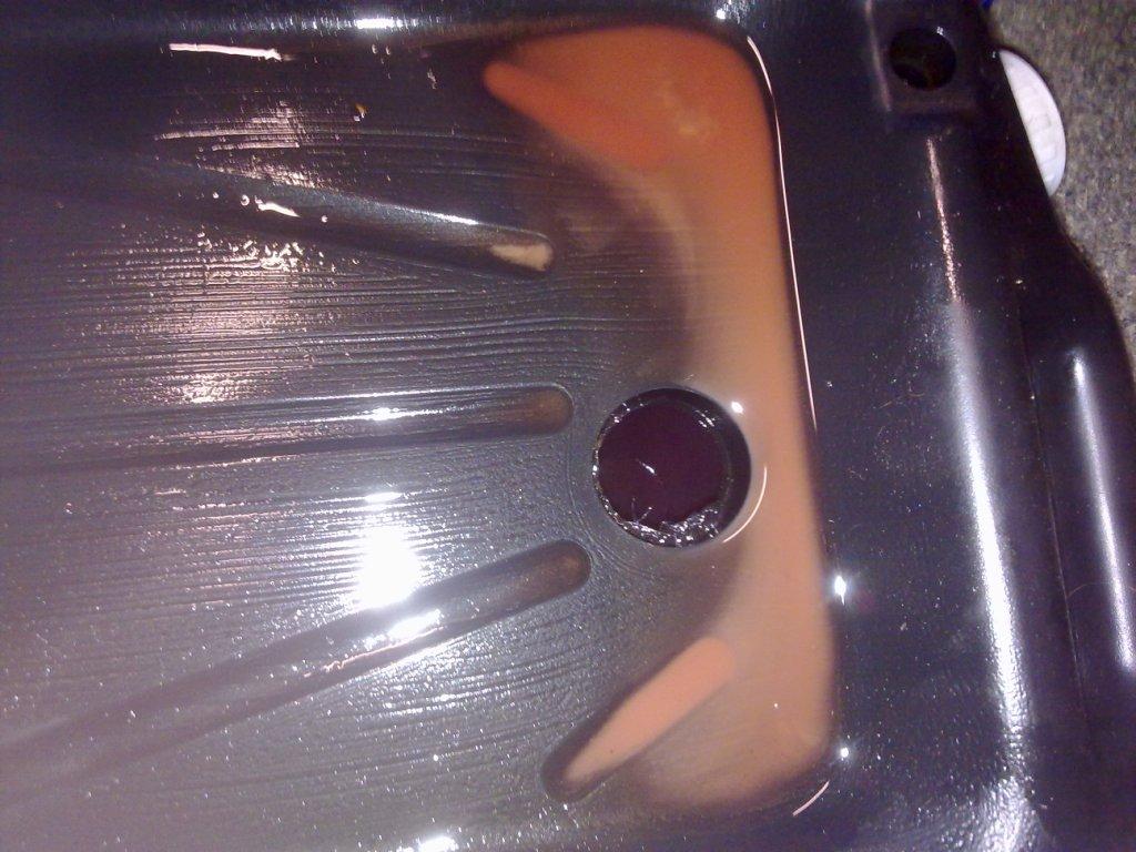

        Sign of it been looked after having pink gearbox oil. Thats the proper MG rover spec stuff.

                  Genuine rover gearbox oil (MTF94) is golden coloured not pink. If the gearbox oil is red there is a fair chance someone has put ATF in there instead.
                  MTF94 is the recommended oil these days
                  10w40 can be used but needs changing regularly. (40k interval I think).
                  If you have a torsen diff (non standard) then you should use MTF94 to ensure it works properly.

                    The above is the same stuff I put in mine when originally re-commissioning the car and its definitely a red/pink color. Which both me and the mechanic that works on the car thought was strange but it was. If anyone orders the above let me know the color please.
                    The comma mtf94 I put in after the proper MG Rover oil was golden colored.

                      This is the colour of the oil that came out of my gearbox (the shade is probably more accurate at the bottom off the pic than at the top):

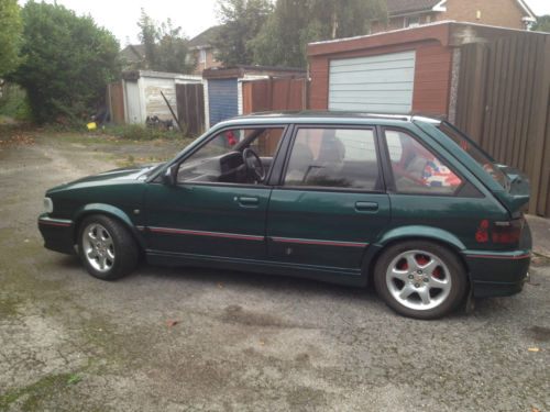

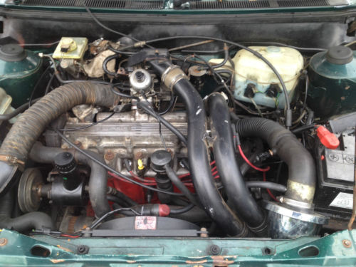

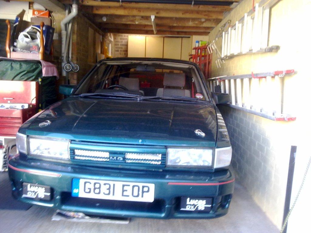

                        OK! Here Goes - the first is as sold, with the state of the engine bay at that time. The final one is how it was before I started work last weekend. I'll do a couple more general shots this weekend, as all other pics I've taken have been of the 'memory jogger' type ready for reassembly!

                            Mine was also from Rimmers but in the 5 litre can rather than the 1 litre bottle. Definitely golden coloured in mine.
                            I've not come across the pink stuff before but if it in a bottle labelled mtf94 then it'll be fine.
                              Looking well as is Pete - I see it has early montego turbo intercooler pipes. Will you be returning the wheels back to standard cross spokes? I have full sets of 5.5J and 6.0J if your looking? Another one getting restored - good stuff!
