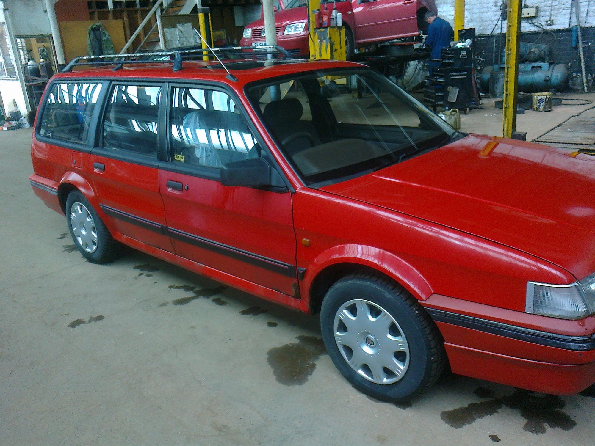

    This is one of the 2 that I got in march this year. I went to Nantwich for this estate (aka mrs mop ) for parts for the 1.6 estate and a gear box for my van. When I got a look at it I thought it was to good to brake so she has been sat since I got it.
    That is up until 2 weeks ago when in a moment of madness I thought it would be good to get it on the road so I booked it in for a mot and drove it the 25 miles from my mams drive to my work for mot. There was some strange noises from the nsf suspension but we made it

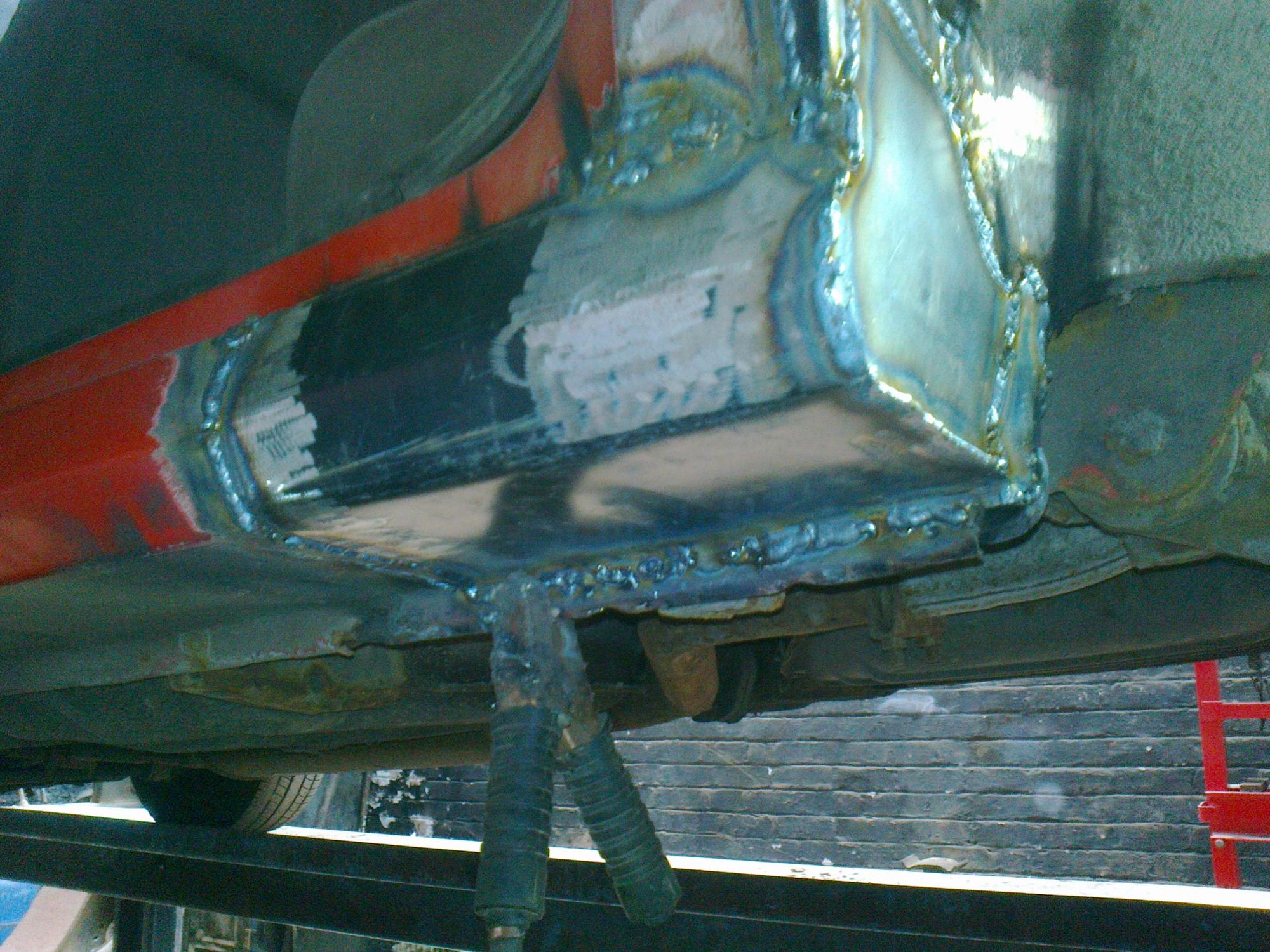

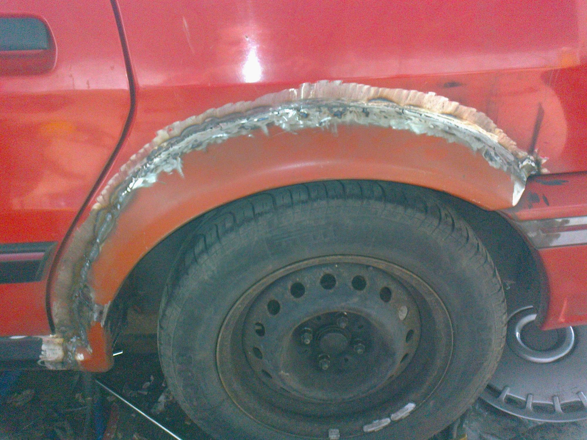

    When the tester got a look at it the nsf spring mount had corroded and snapped of the strut she also needed the usual welding to the rear of the sills and rear arches

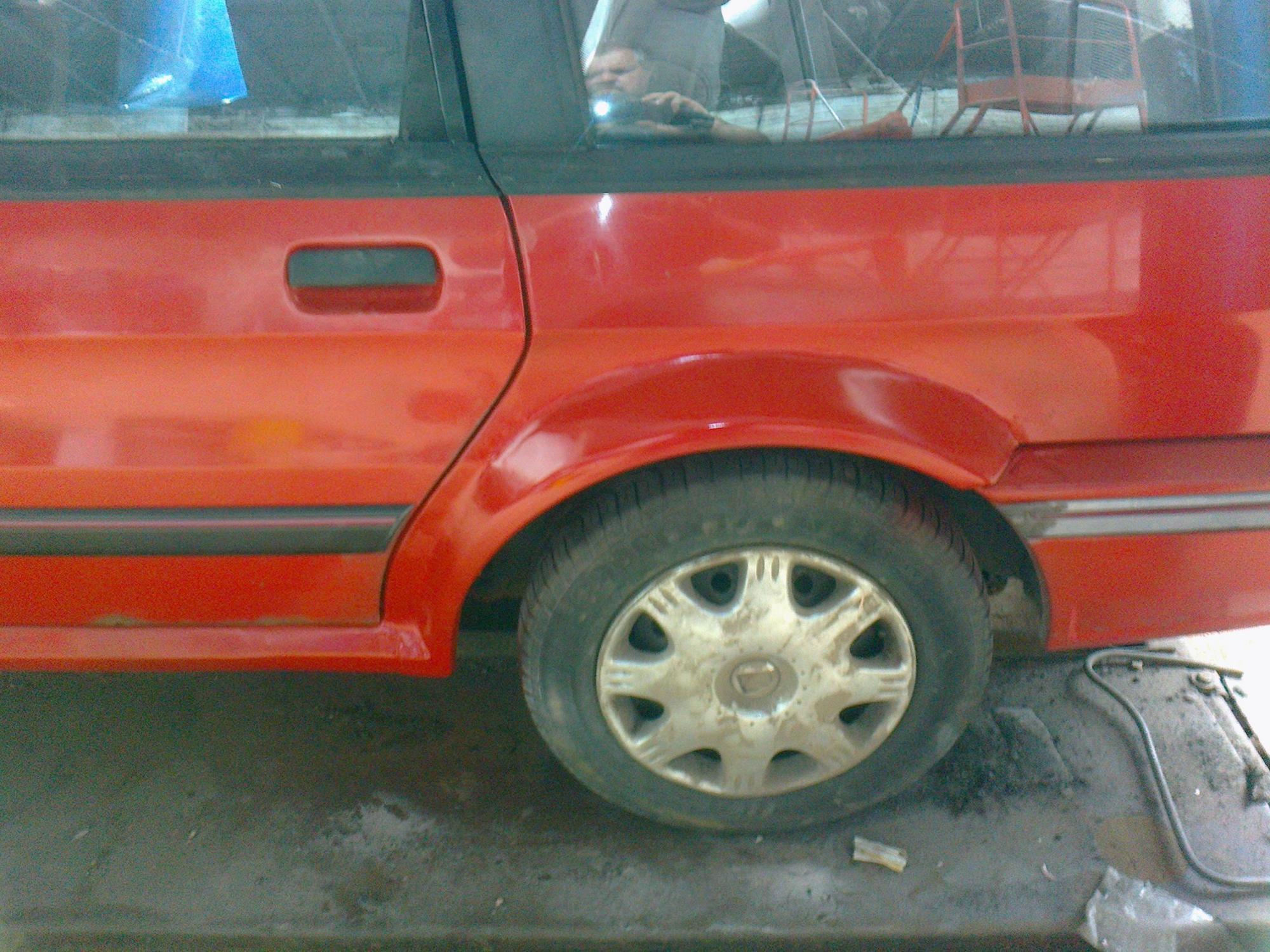

    So I replaced the nsr arch and sill end, and patched the osr until I get an arch, the strut was swapped of the spares car and she is on the road

    Tidy bit of welding there Pete
      To much practice I keep buying the wrong cars
