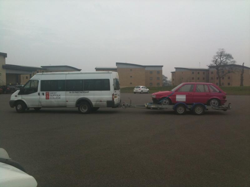

    Hi Jay, good to hear from you! Yes, the Pink Panther's on long-term loan to the college. We're hoping to use this forum thread to communicate between those involved on the car, so do post updates, pics, questions etc. on here in due course...

    Update from the College's Press Officer:
    This story is now on the website and has gone to the EADT
    http://www.westsuffolkcollege.ac.uk/...ing-the-season
