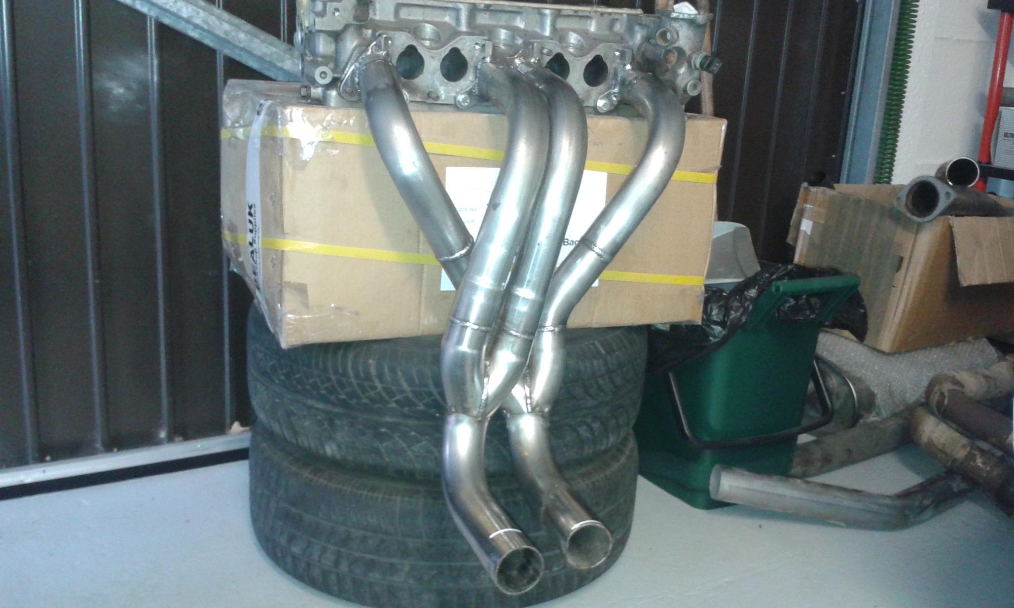

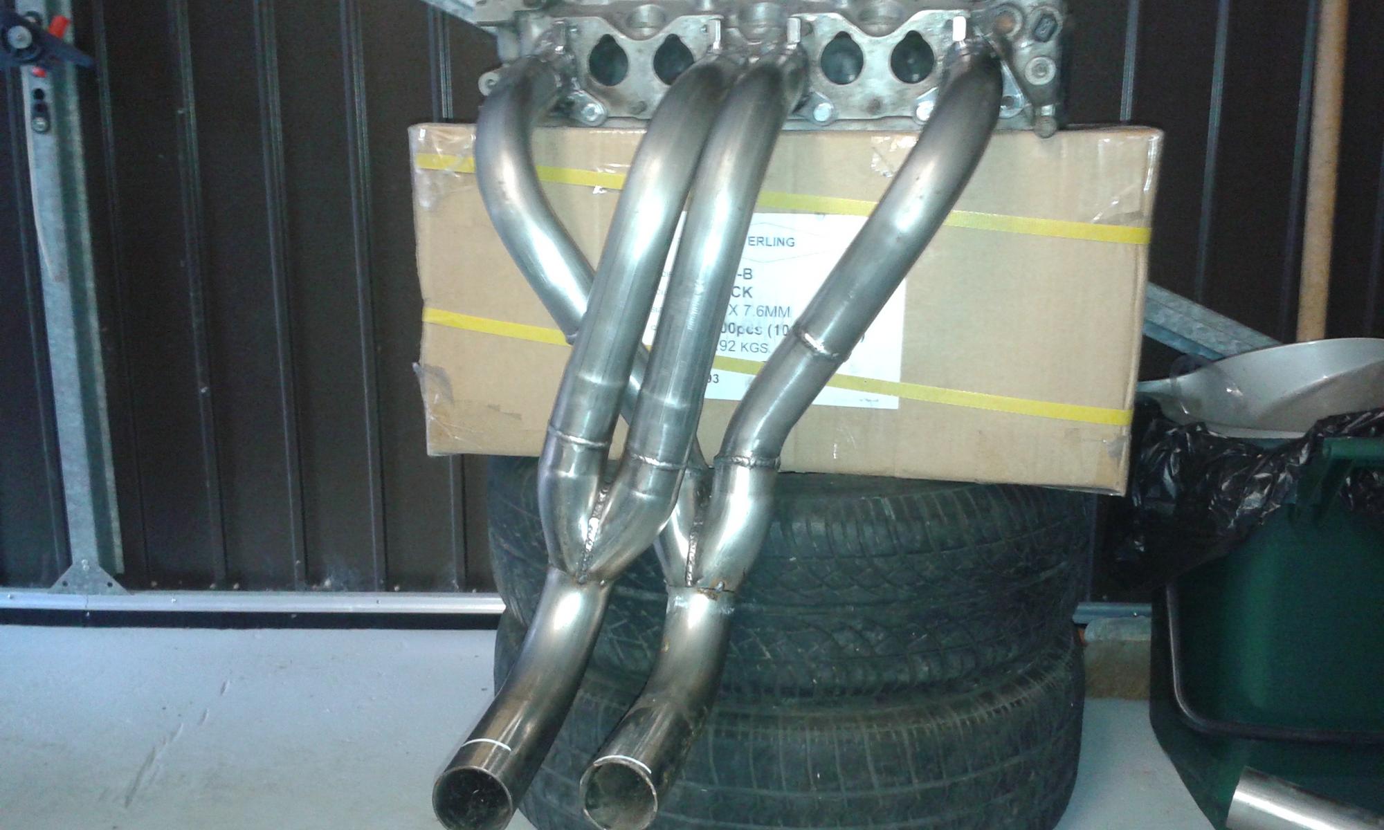

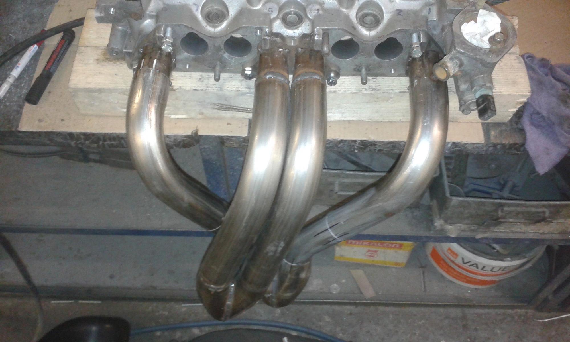

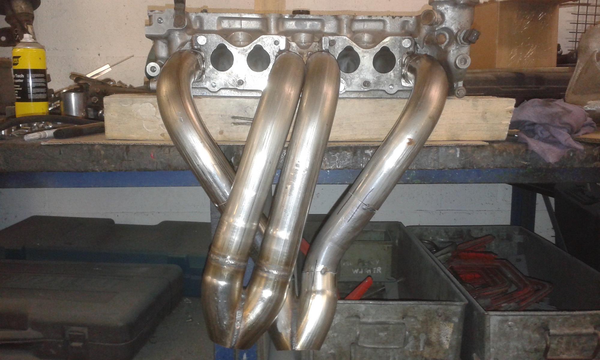

      Hi Russ, had looked at what moto build, and other companies, had to offer but for me this will be a project/build/resurection on a tight budget.... if its something i can fabricate myself and it takes weeks and only gains 1 hp then im a happy man Can buy Y piece sections but none i found to be short or close enough together to fit where i wanted so homemade is the way forward. Once the manifold is made ill move on to the rest of the exhaust. The head has been on and off numerous times but is slowly getting there.
        Looks like it will be better than anything you could buy if there was anything available!
        Great work!

          That fabricated manifold looks absolutely fantastic
            I was told by quite a few people back in the day that the standard O series manifold with a big bore down pipe was hard to beat hence no 4 branch manifolds. I am in Lancashire as well if I can be of any help with anything.

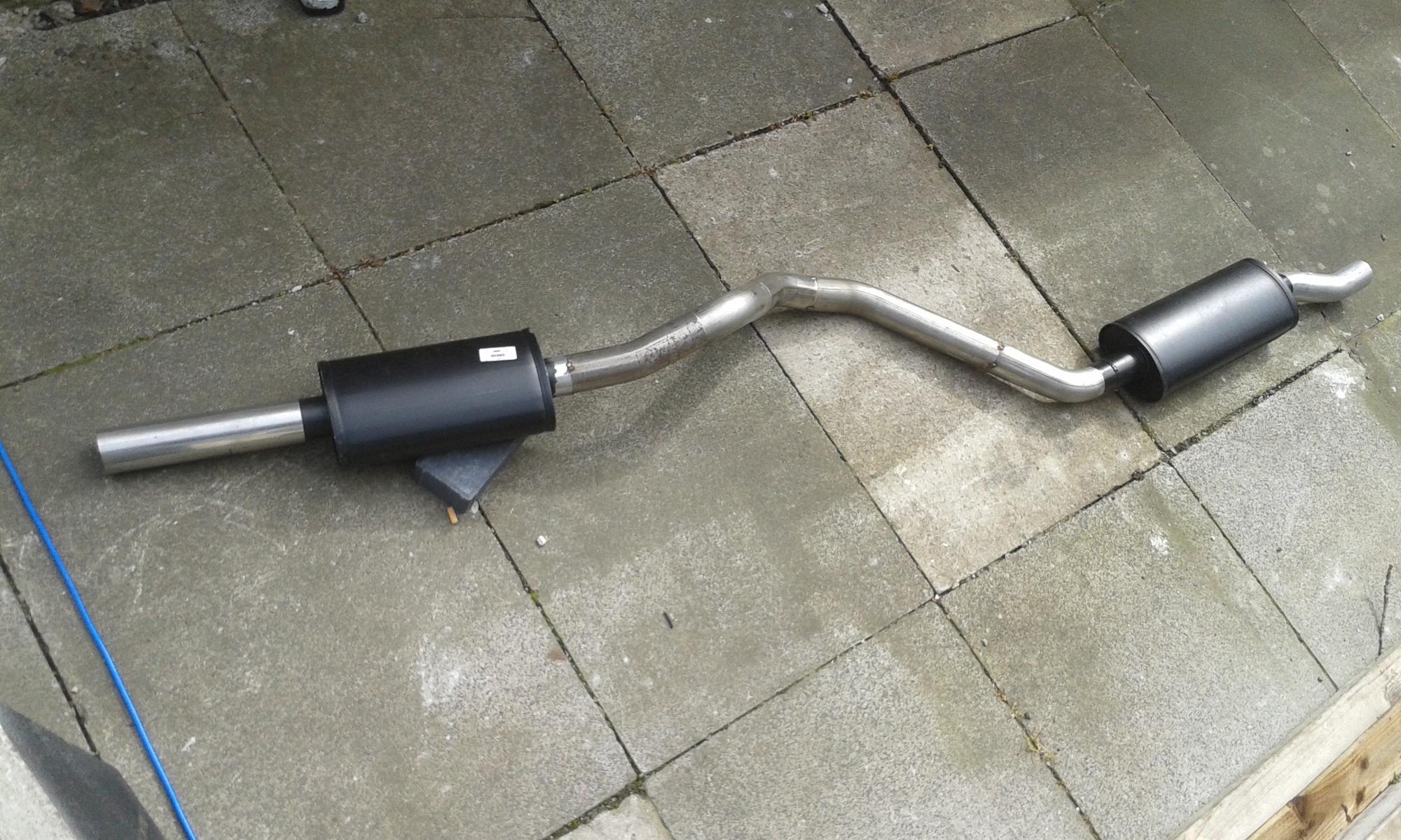

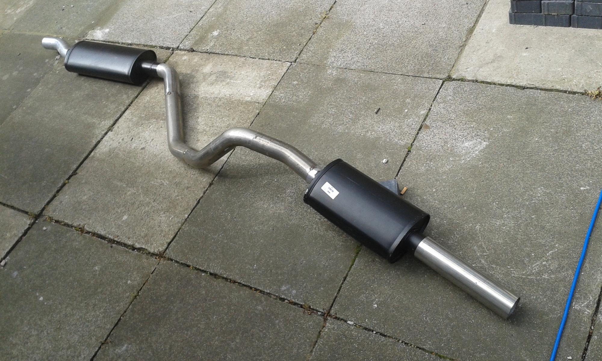

                    Finally got some time to myself at the weekend and managed to get the exhaust all tacked ready to weld then hanger brackets is all thats left exhaust wise. Once again bits of exhaust kept for 20 odd years that ive cursed falling over have now become usefull :-)
                    • #25
                      Excellent work there. Just remember you need a join in the mid to back piece so you can thread it over the rear beam otherwise fitting it will be a sod to do I think.
                      I wish I had that many exhaust bits lying around in my garage. I still need to make myself an exhaust for my van.
                      What are the noise regs for you? You may find you can ditch the middle box if they aren't too strict.
                      • #26
                        Hello Mr E T V, noise used to be 102db but not competed for 5 years now... 2015 licence and year book is in the post to me as we speak :-) gone for 2 silencers to be on the safe side, however... its gone if im somewhere close. The pictures dont show but i have a join about 8 inches behind the back box quite rightly as you pointed out, to allow assembly.... something i found the hard way when fabricating the manifold.

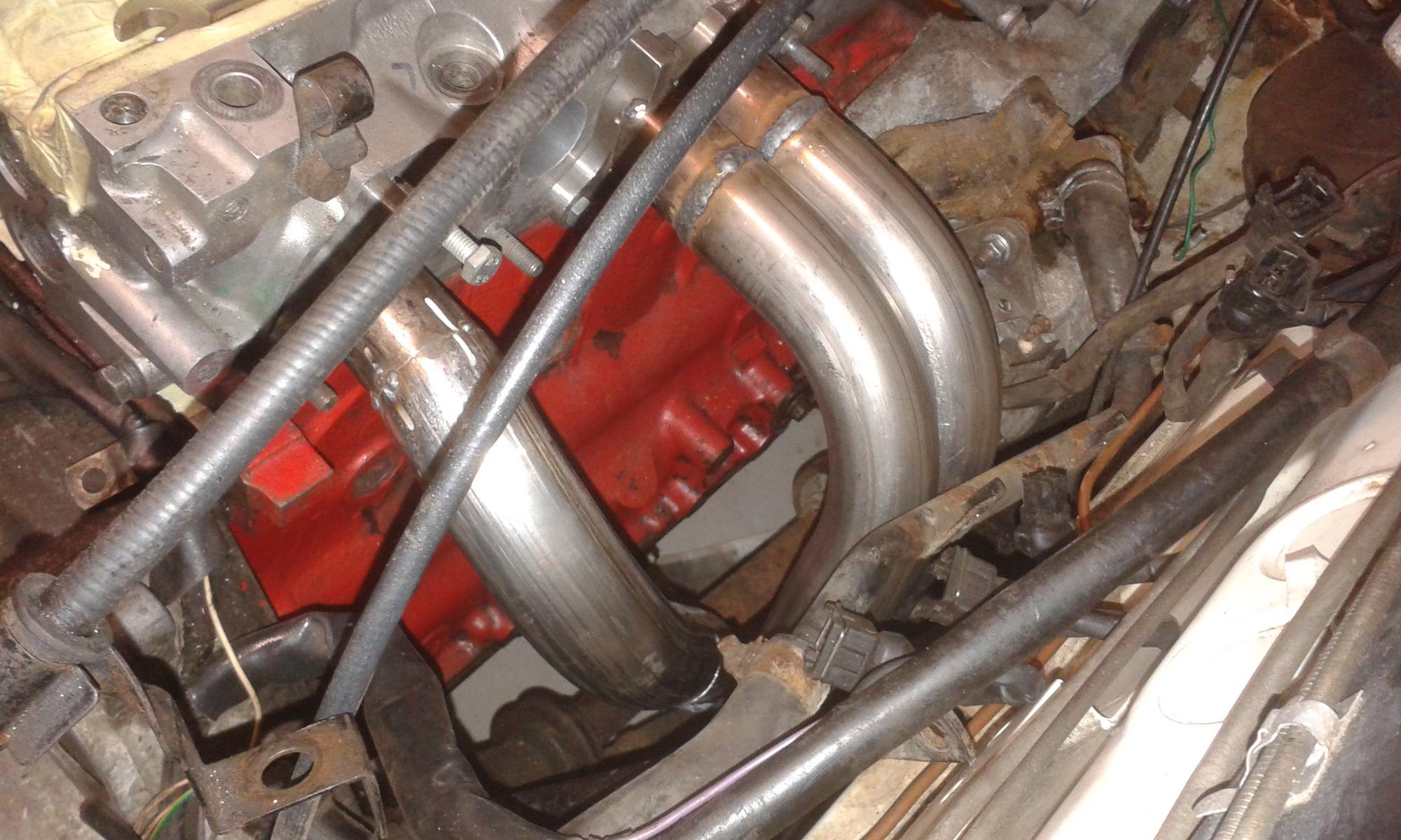

                          Looks great. I find making exhausts really enjoyable. Your manifold looks like you need to drop the subframe to fit it? Does look good though
                          • #28
                            Hi Ross, its like a rubix cube.... will only fit one way, up a little with one down and left with the other... lots of swearing and it fits with subframe in place ;-) I havnt read all the threads but am guessing your the guy to ask.....?? after many a discussion, will the torsen diff, from 220 turbo/820 and so on, go straight into the maestro box?? or is it mith?
