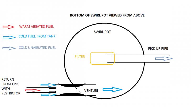

I never thought of having an external swirl pot Mal! Good idea and I think there would be room to fit it as well. I saw one on ebay but think there are too many outlets. Cant quite get my head round exactly how it works. As I understand, the warm fuel from the return line enters the swirl pot venturi slowing it down I guess. The cooler fuel in the tank enters the pot also and is picked up by the pick up pipe and is fed to the fuel vapouriser and carb. I'm sure I read that some type of depression is created in the pot but not really too sure.
