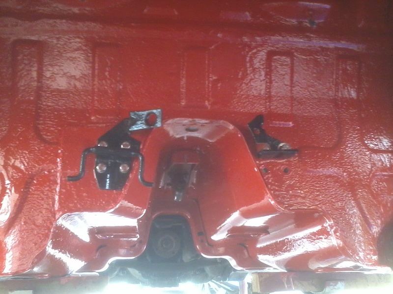

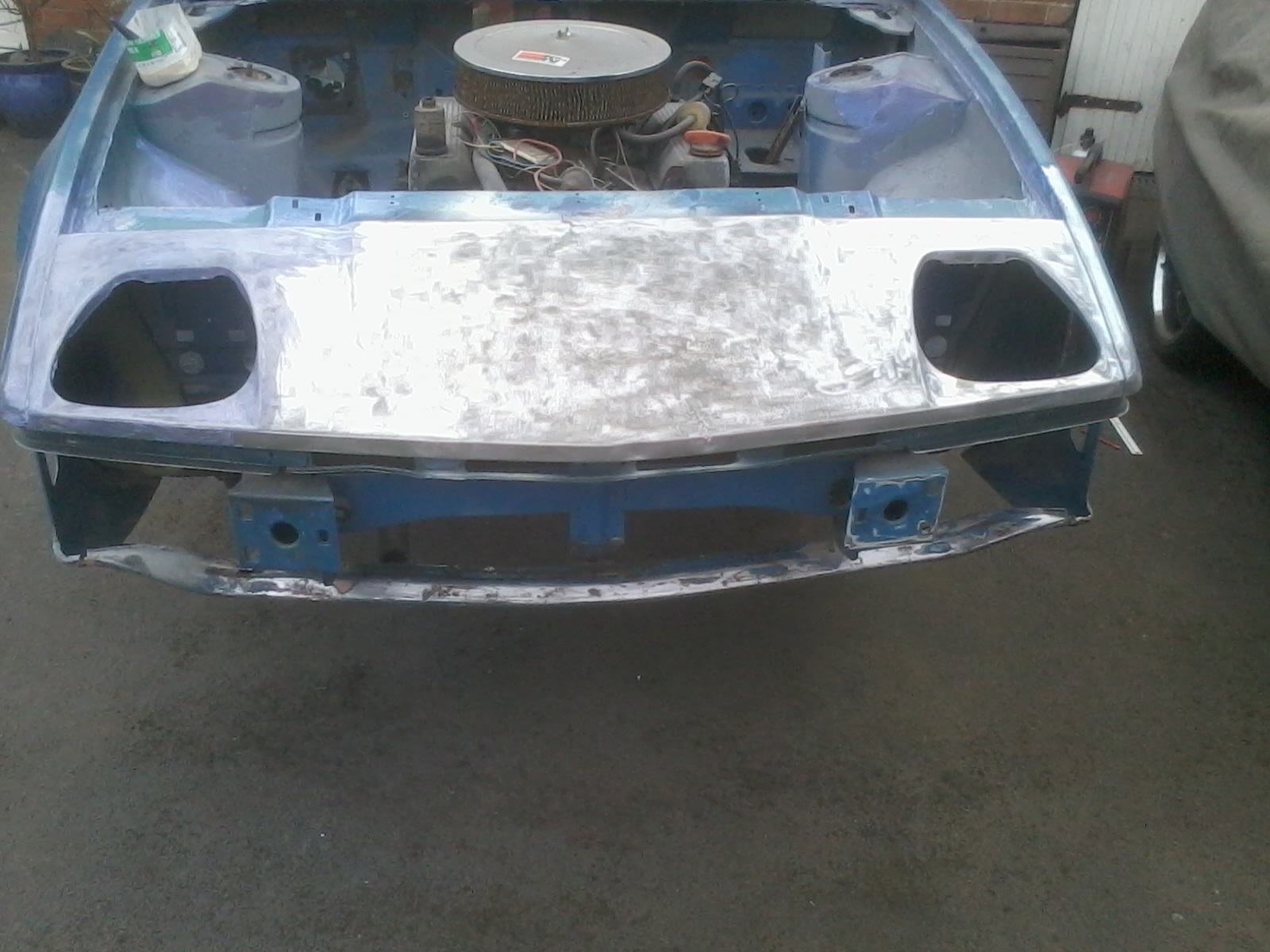

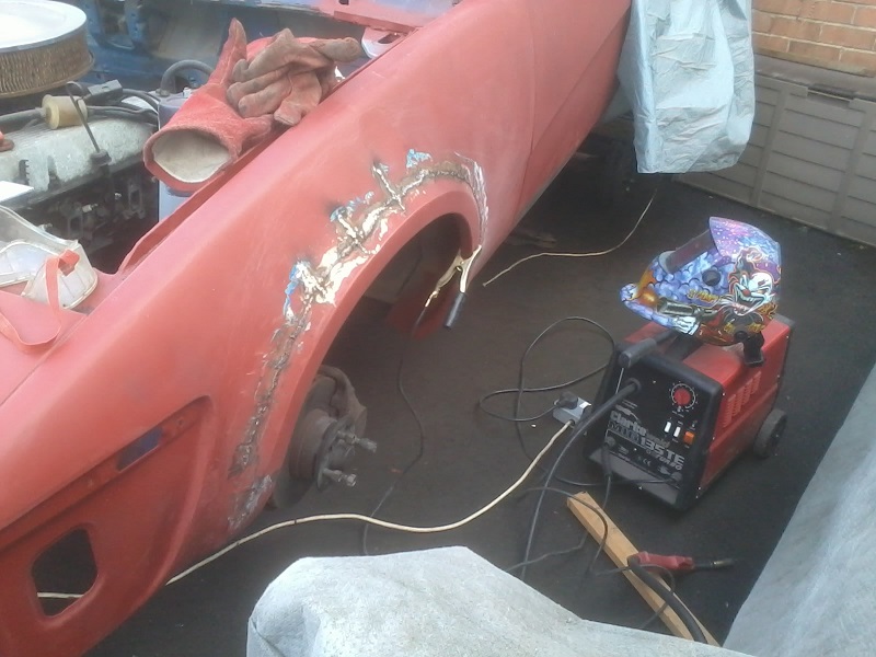

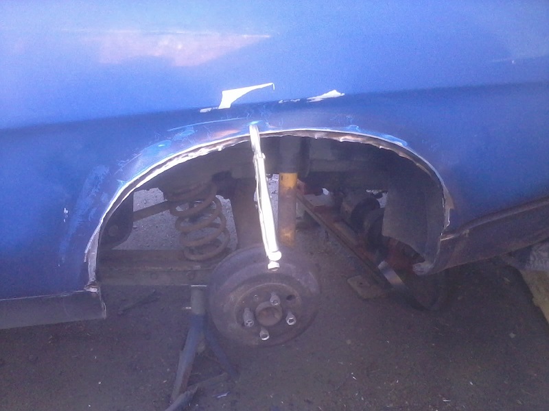

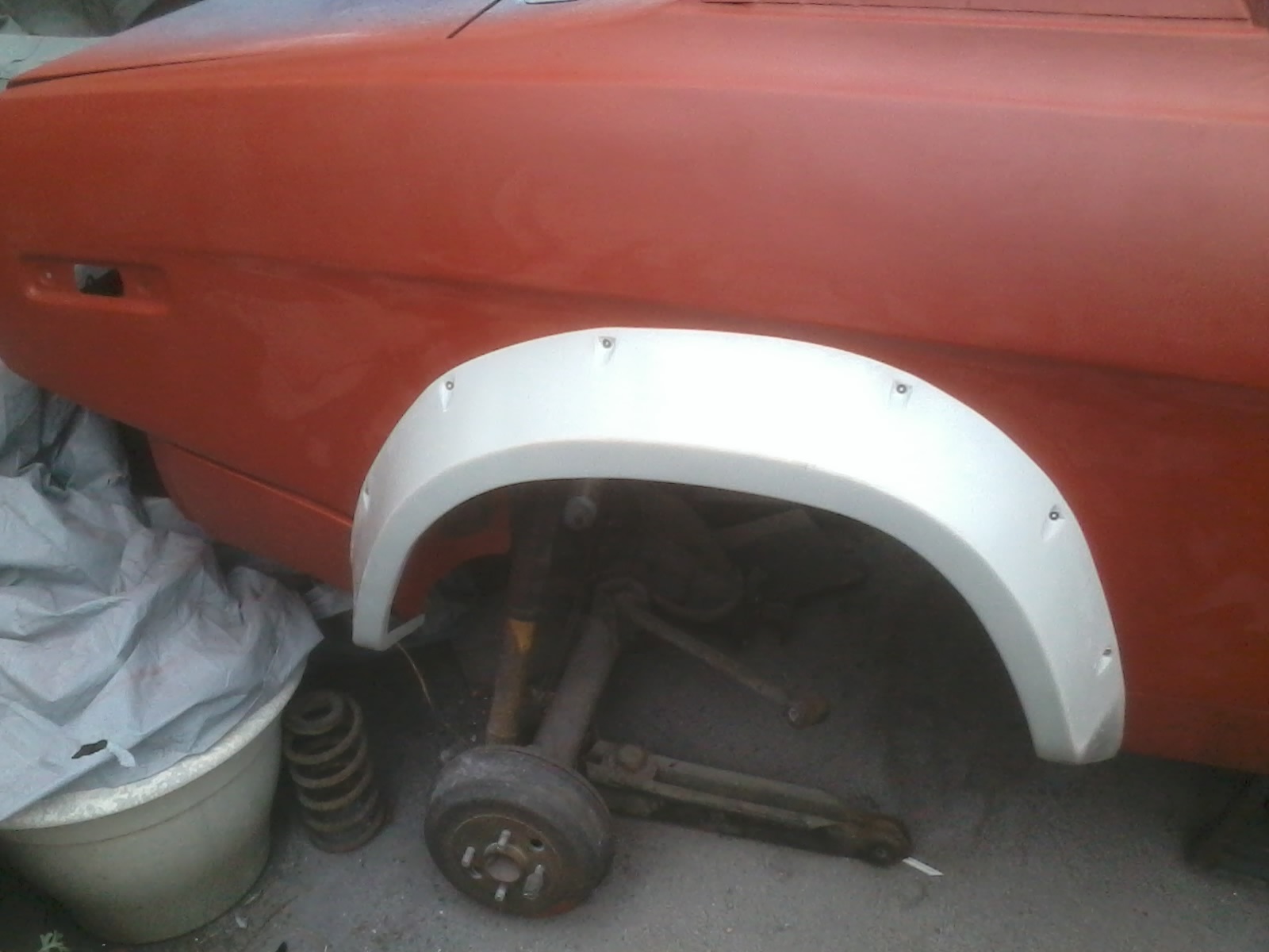

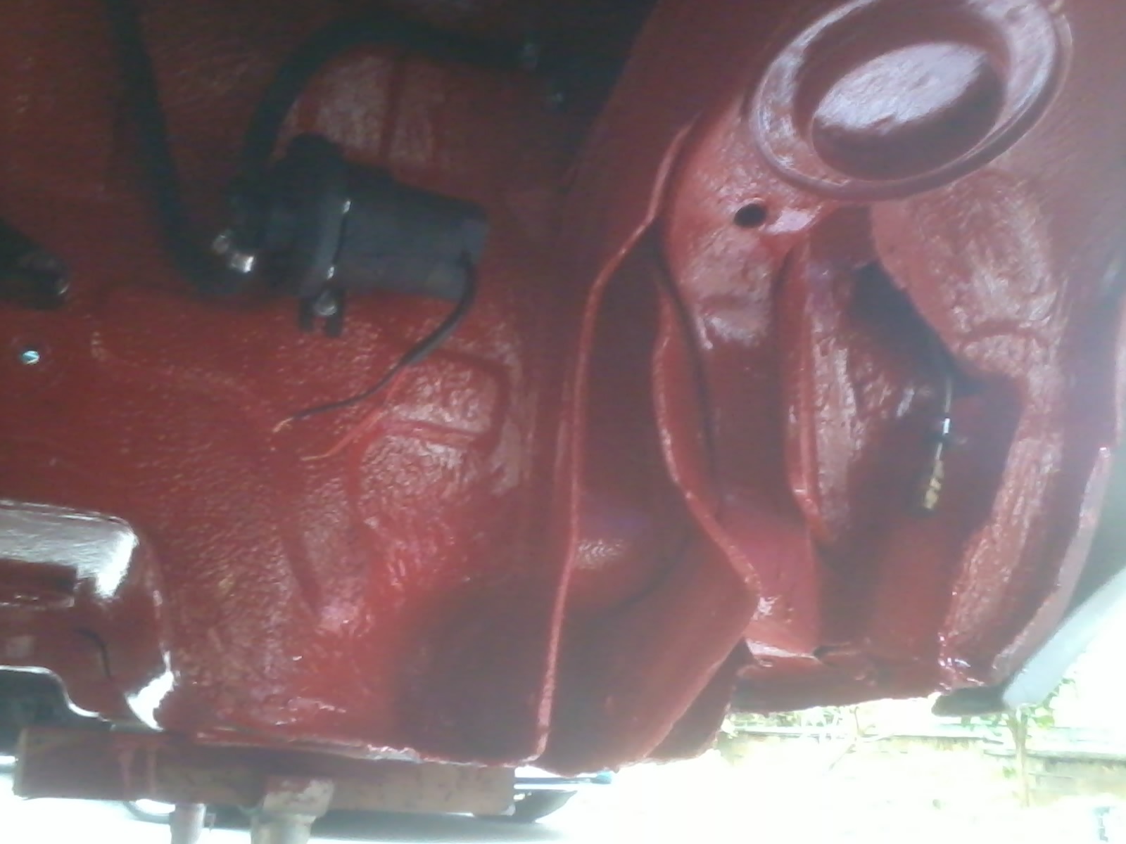

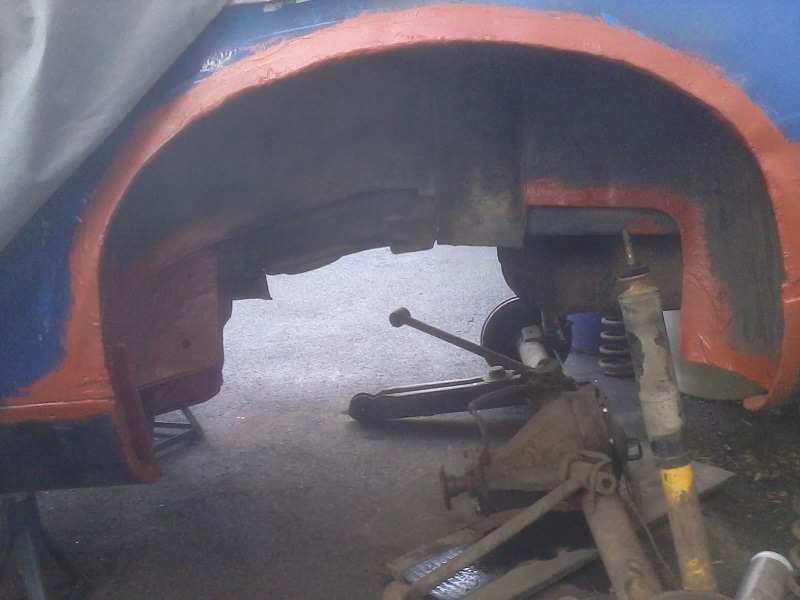

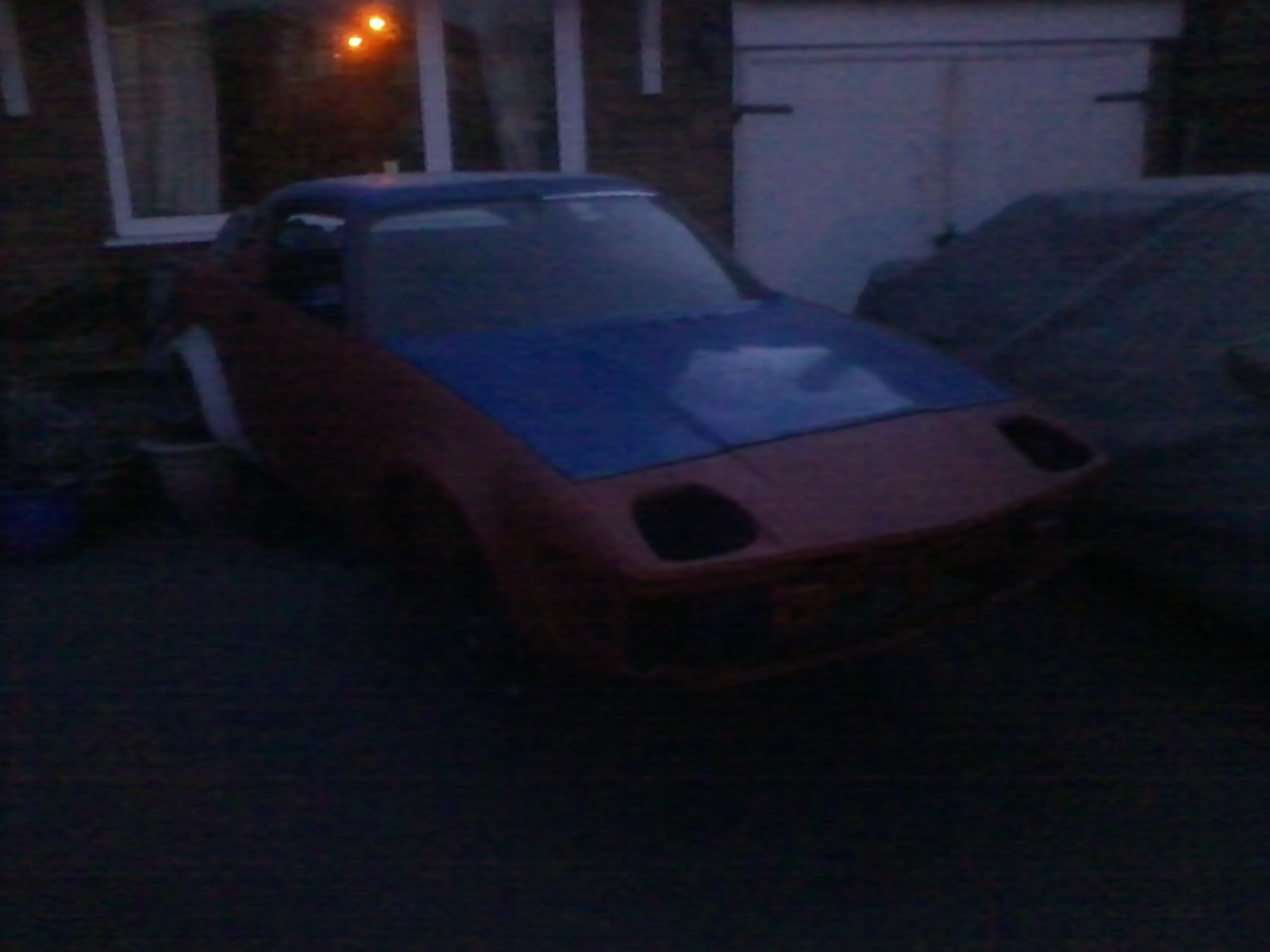

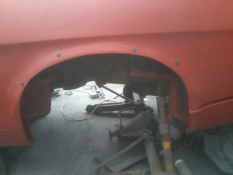

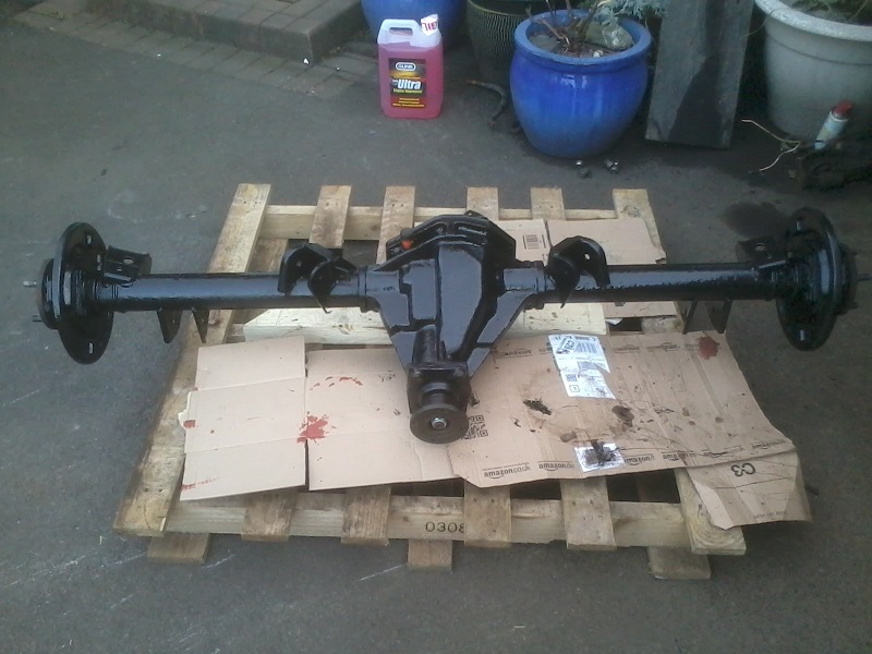

    Hi, not been here for months. Still got Jum and will be staying that way but just no spare time to play with it yet. I've been busy sorting my TR7 and will hopefully be running by the summer. So far have done most of the welding needed, cut off the back arches and welded back to inners to accept the 10x13 Revolutions which will fill the tarmac arch extensions. The rear floor pan needed a bit od welding as did the front floor pan but the rest of the car is sound. I've stripped the back end and painted all the axle and suspension components and will hopefully have the axle back on at weekend complete with new poly bushes. Here's some pics so far.

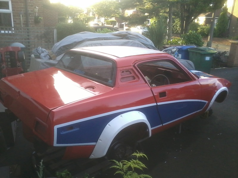

    More pics

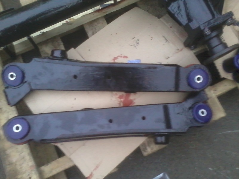

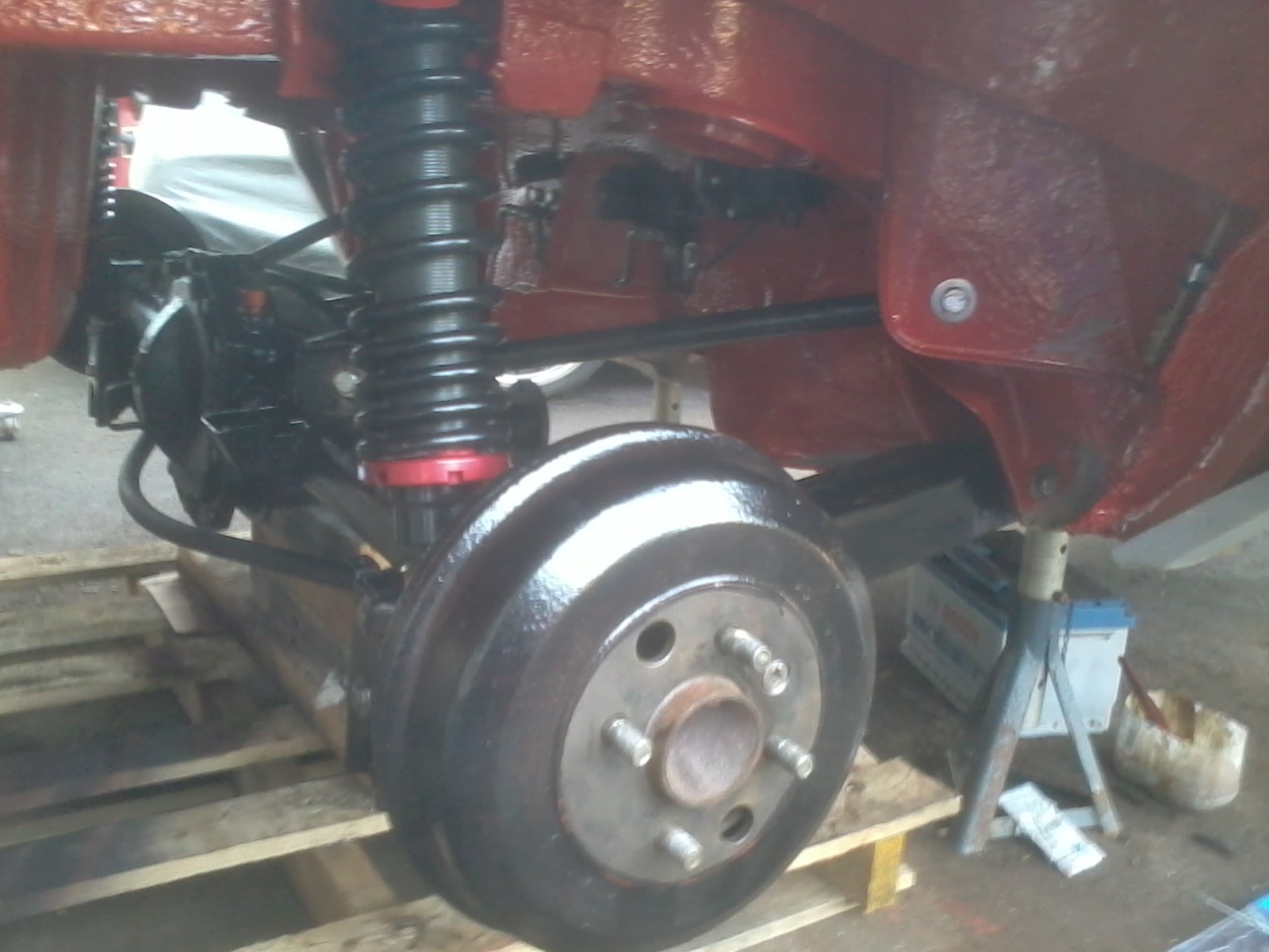

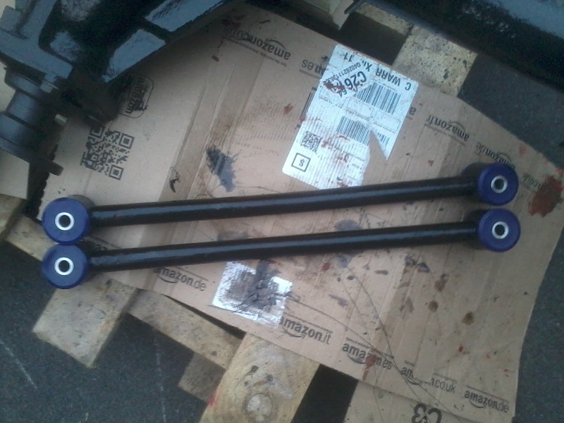

          Poly bushes fitted to rear arms and links.

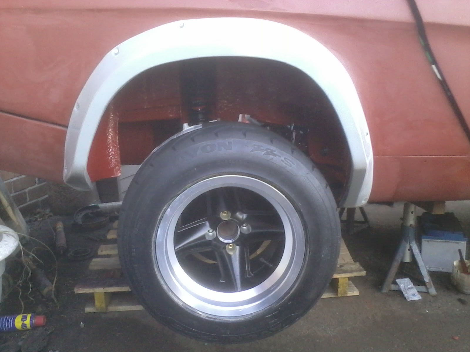

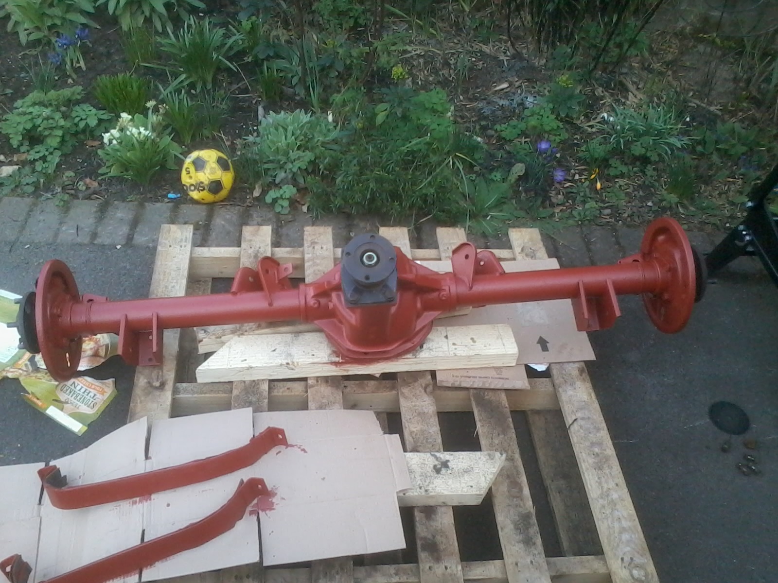

                    Fitted back axle with coilovers and tried my Revolutions!

                      Is that a 5-speed axle or one from an SD1?
                      Membership Secretary
                        It's the original 5 speed with 3.08 diff. The 5 speed axle was essentially an SD1item but shorter track.

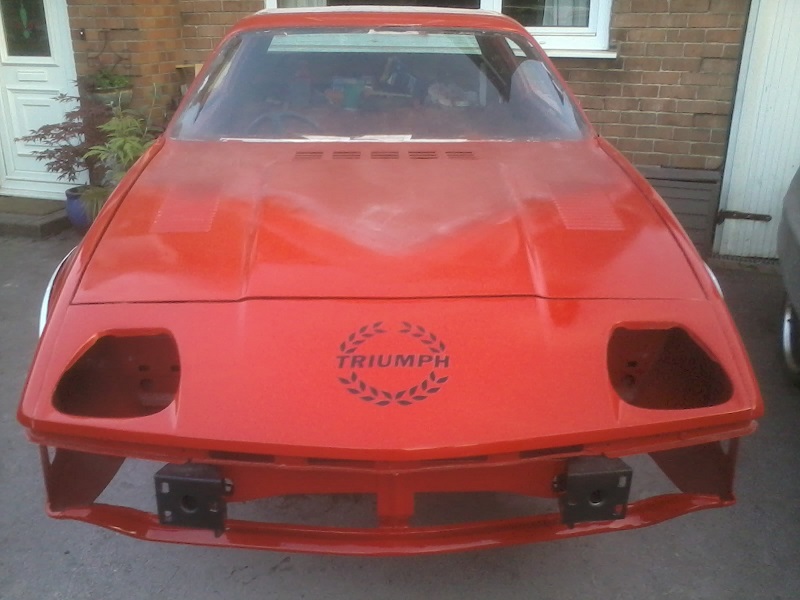

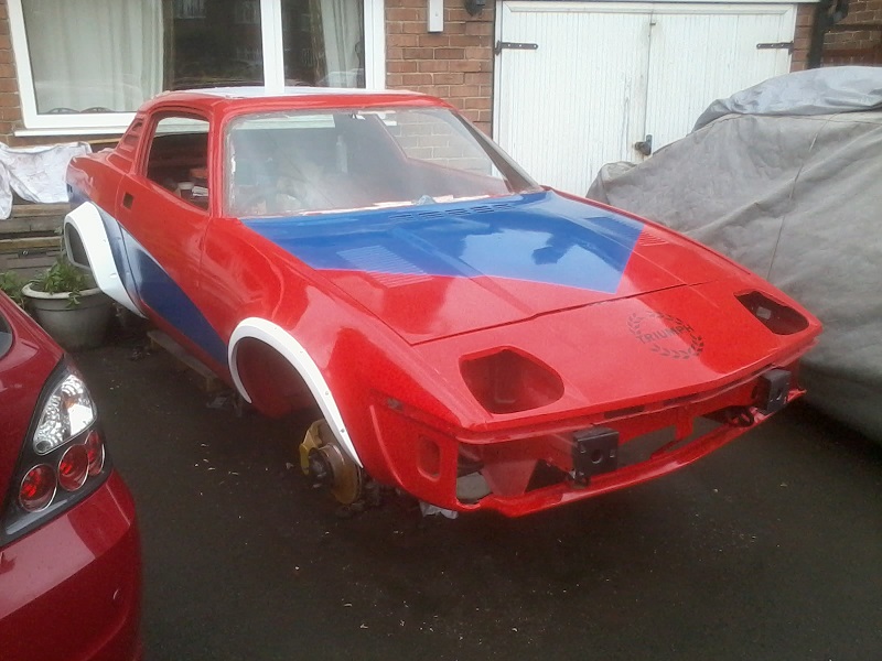

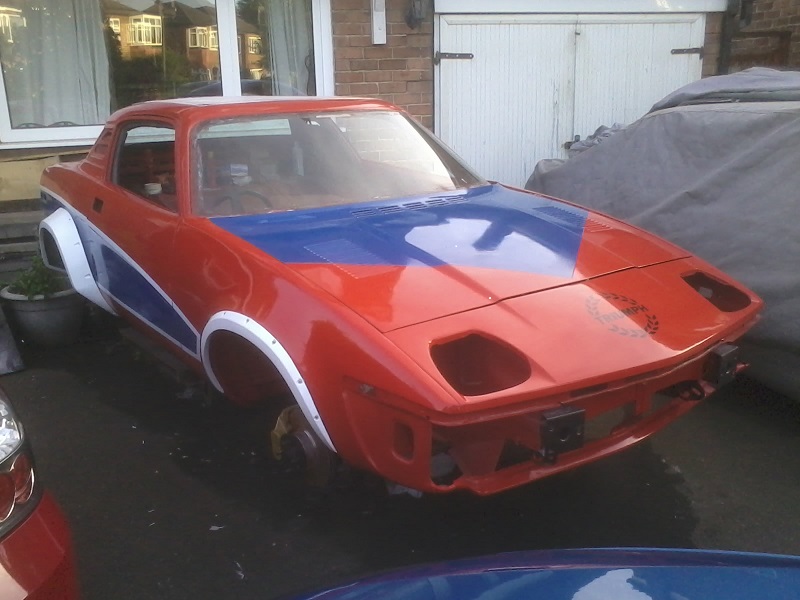

                          Just a progress update, but getting there. Painting mostly done inside and out, ready for wiring loom and engine bay ancillaries!
