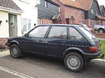

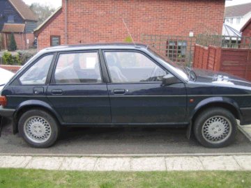

        Have you got any more pictures of the car?

        Sounds like you have a very late Maestro 1.3 Clubperson there. These usualy come with 13" steel wheels, as for the very last year of Rover production I am unsure whether it should have 14" steelie's, but I doubt it.
        I bet the steering is a little heavy...
        PS: Looks like Midnight Blue to me.
          Yes. Have texted wife as where to reg documents are, but I think this is registered as a 1.6.

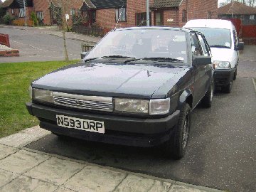

            Could this be an apple 2000 model as its an N reg, however the windscreen wipers aren't LHD which is common on the apple 2000's.

              That is a under statement I had forgot what it was like to drive a car like this, choke, no power steering, windy up windows, no central locking!! takes me back to when I was 17, and my Triumph Herald.
              Yes, I think it is midnight blue. Oh! the heater blower doesn't work
                          I did have to look twice then... You would think it was an Apple2000 car with being an N reg. Perhaps it is, but the wipers on this particular car have been converted at some point?
                          I did have a look at the Monstro archive CD, and there was an article in October 2000 issue about these Apple2000 cars - to quote:

                          Some time ago we came across a company called 'Felgate Enterprises' who could sell LHD and RHD versions registered on 'N' plates...
                          ...The latest information from them was that stocks of the Maestro 1.3 were very limited, with RHD versions selling at £4,750 and LHD at £3,995...
                          ... For more information, contact Parkway Service Station, Ledbury.
                          The mind boggles.

                              I've got some more info on the car:
                              Date of first reg 01/06/99 (Decl/d manuf 1996)
                              VIN/Chassis No SAXXCHWD8**80179
                              (Ok the 2 asterisks should be A V)
