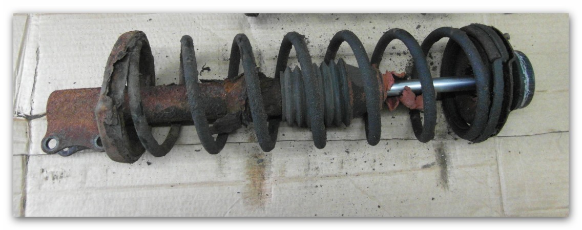

    I found something else out, not all struts have that drainage channel, the one that collapsed has no sign of one, the petrol one I was sold in error did, so I will just continue with the regular oil spray, making sure none gets near the brakes.

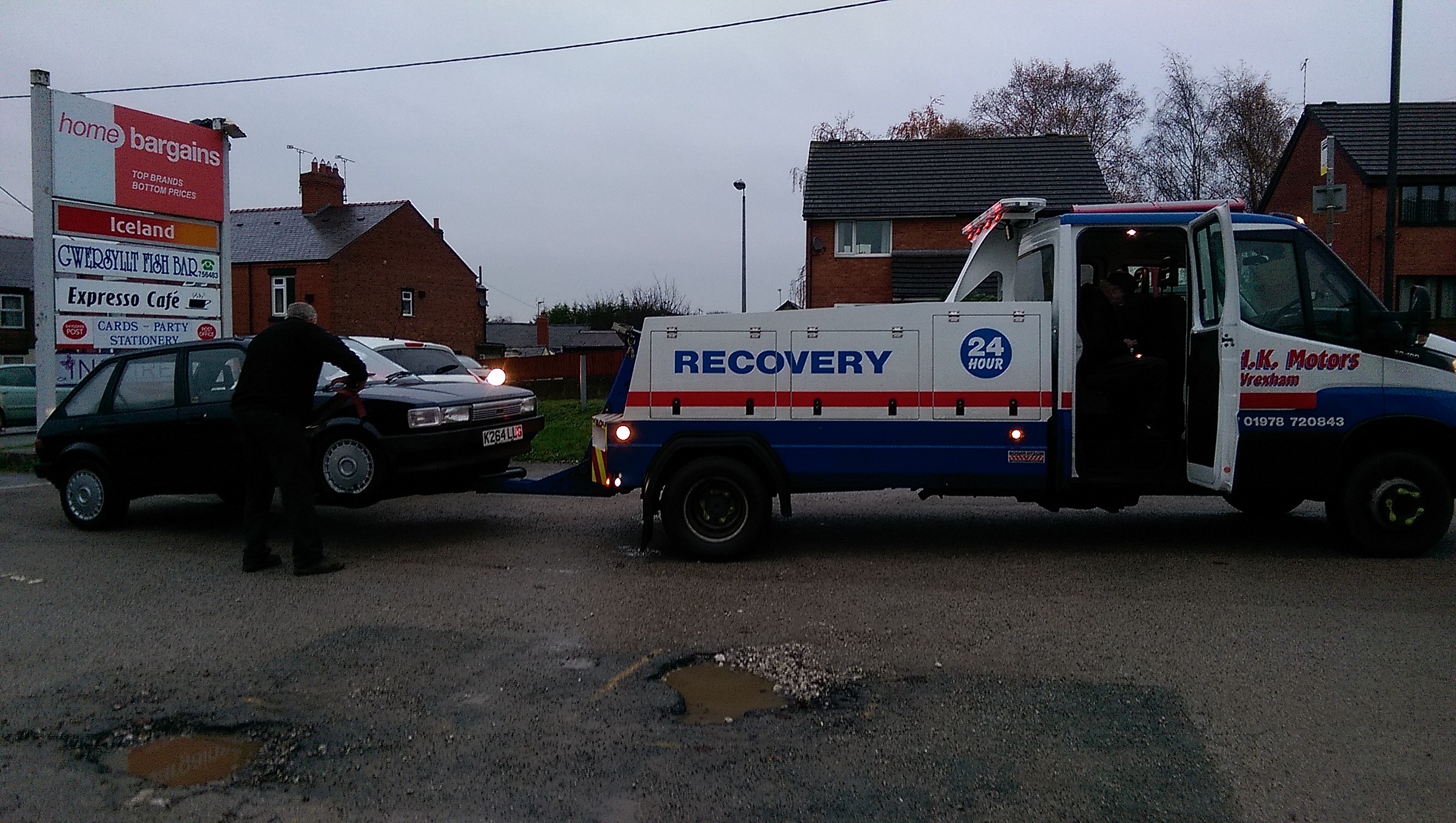

      I apologise for the slow reply but I did do a quick note in the thread about fuel pumps, I ordered the new strut that Robert (City X) suggested on the 6th of Dec but it was very slow arriving due to the Christmas post (Hermes) it arrived on the 13th.
      I did another Google search (Monroe 11082 Rover) and my car came up straight away, using Rover instead of Austin did the trick.
      As John DR Diesel suggested, fitting springs is not to be taken on lightly, I took it slowly and carefully but got the spring compressed enough to fit the assembly together.
      Fitting it to the car was hard work work but it was pretty straightforward thank goodness.

        Just on a general note. I was aware that there are two different strutt lenghs, but don't know why? Does one give a different ride height to the other, or is there another reason. Which modles had which?
          Looks like you did a proper job, and the spring compressors look nice.
          Jez, I don't know about ride height but the springs come in different lengths to.
