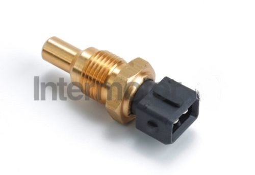

Check and clean coolant temperature sender. Had one where the connection was dodgy which made the engine think it was cold when the connection broke and correct when it was OK, so it kept bumping up the idle speed at strange times. It also richened up the mixture for the same reason.

Hi, do you mean follow the same procedures with idle valve, potentiometer and 30 second reset ? If so no I haven't. I've gone through a process of elimination, I read about the Lucas injection system and the crux of it said 'if one of the parts don't work - then it doesn't work at all'. We've replaced the fuel ECU with a new one, idle valve too, cleaned up throttle body am in the process this weekend of changing the temperature switch, transducer and short speedo cable. Then we know it's not a defect part and could be the wiring, there is a Bosch garage close by who will look at the wiring if it comes to that. I might well give it a go as you suggest when engine is cold see what that does, it's a 11/1986 car. At the moment the temp gauge is showing the temperature at just past the quarter stage whereas before it would show just before the 1/2 way. As you see from the photo (and this was best time, only once when it was this low) it's just under the 1000rpm, "normally" it'll hover around the 1000rpm.

According to the various documentation I've read this seems to be the weak link in the system, we're changing this over the weekend.
