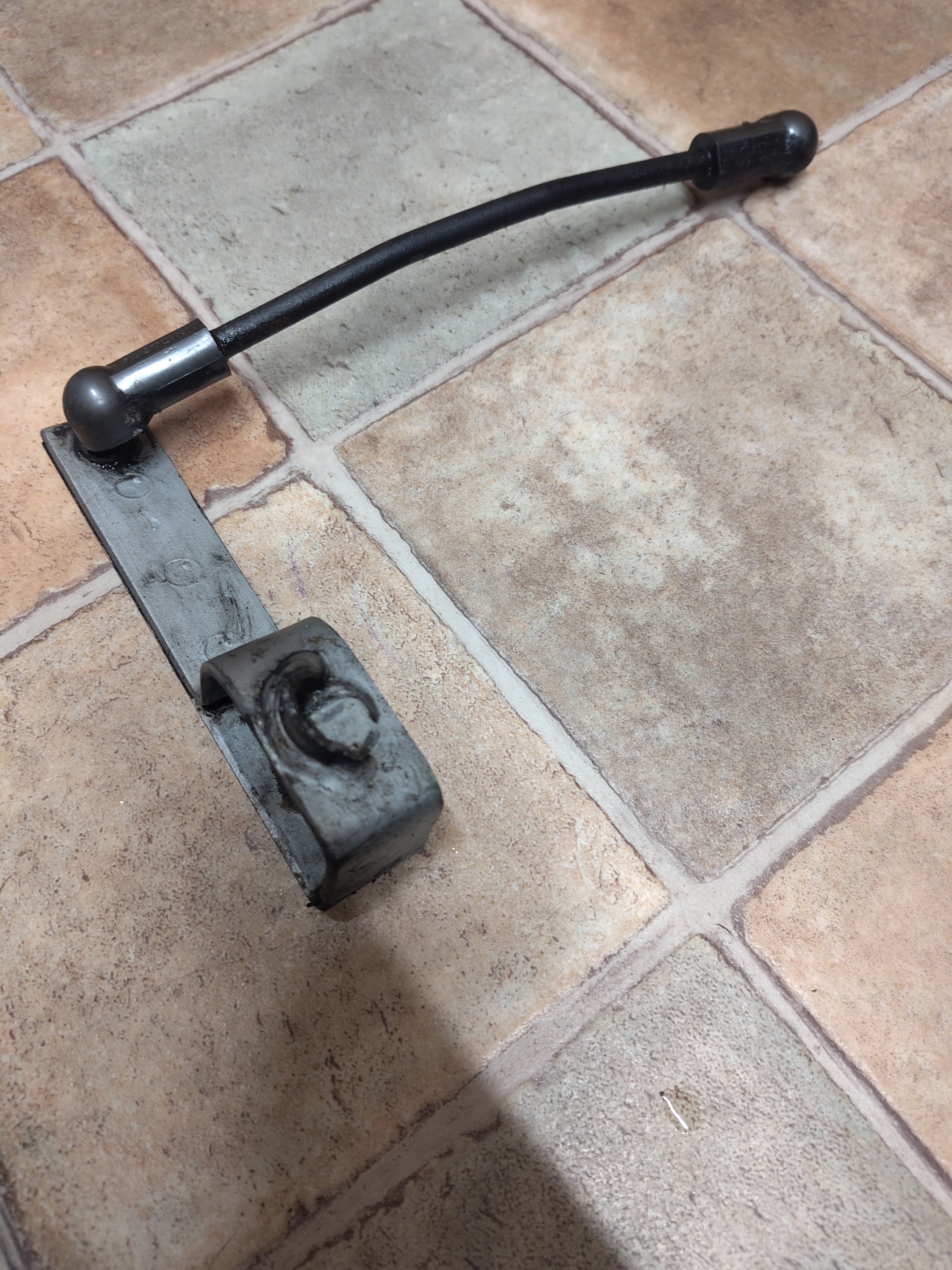

    Hi does anyone know where I can get a gearbox for maestro 1.6 s series 5 speed brokedown today gearstick floppy car will not move
    Gearbox or linkages?

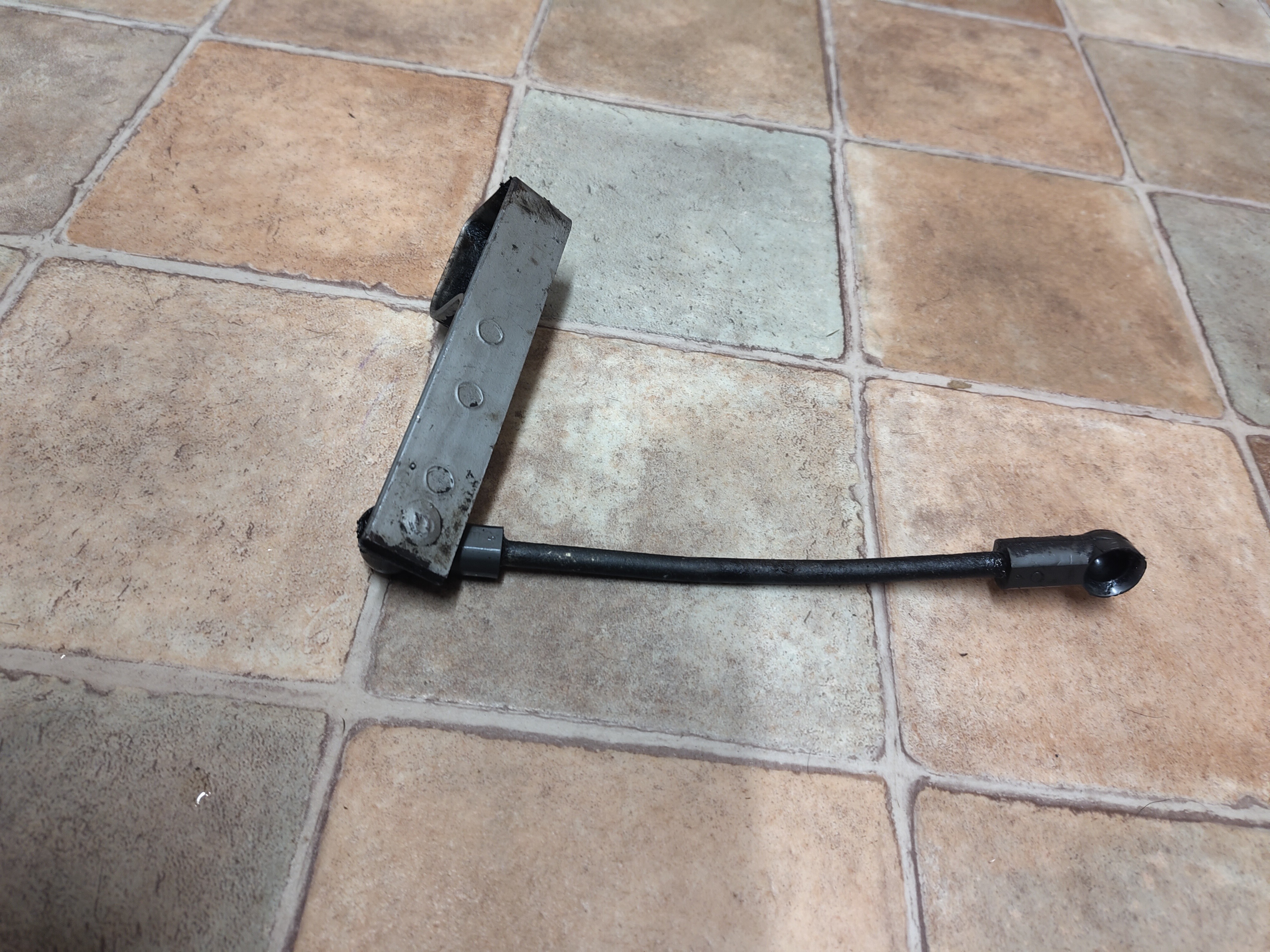

      Hi Jeff AA found this part has snapped and the rod is bent has shown in the photo
        It weren't the gearbox I thought it was they found out that part had snapped and the rod is bent.they just towed the car back to the house
