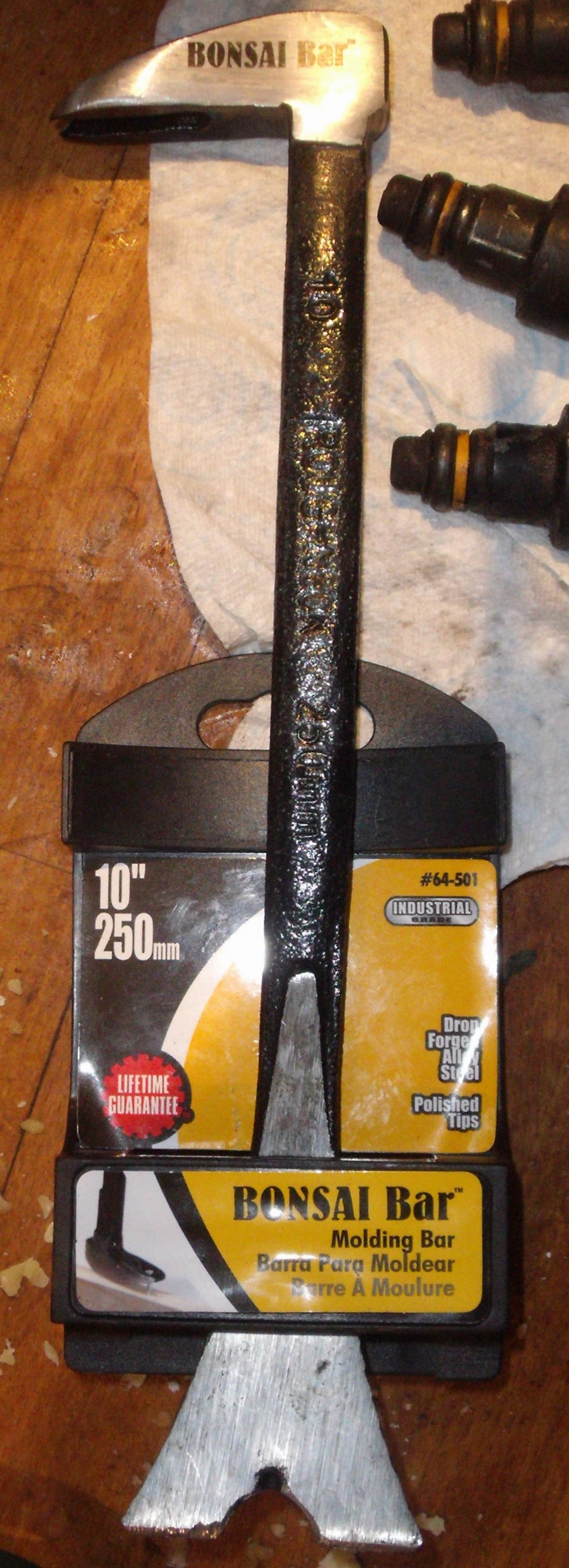

                    Just to update this thread on a useful tool to extract hard-to-extract petrol injectors. Mine had been in for 26 years since new, with engine running very poorly on petrol. I decided to change fuel filter and injectors myself after being quoted well over £100 by a garage, just for the labour. Fuel filter was easy. Injectors would not budge from the cylinder block though. I cut out a basic tool especially for the job, starting from a 250mm BonsaiBar by Roughneck which I obtained from TravisPerkins for just over £8. I used an angle grinder to grind out the shape of the bottom of the injector into the flat part. Then positioned the bar at the bottom of each injector in turn and hit the end of the bar with my hand. Eventually all injectors came out using this method, without any damage to the injector. Below is pic of my bespoke bonsaibar, and another pic of my extracted injectors, all filthy and carbonized at the end. One of the end caps of the injectors had also broken.
                    Click image for larger version  Name:	bonsaibar2.jpg Views:	1 Size:	1.41 MB ID:	323371

                      Nicely done, I've never had to use anything other than a screw driver
                        I love it when someone re-purposes an existing tool. Will take a trip to Travis Perkins and get one.
                        Well done.

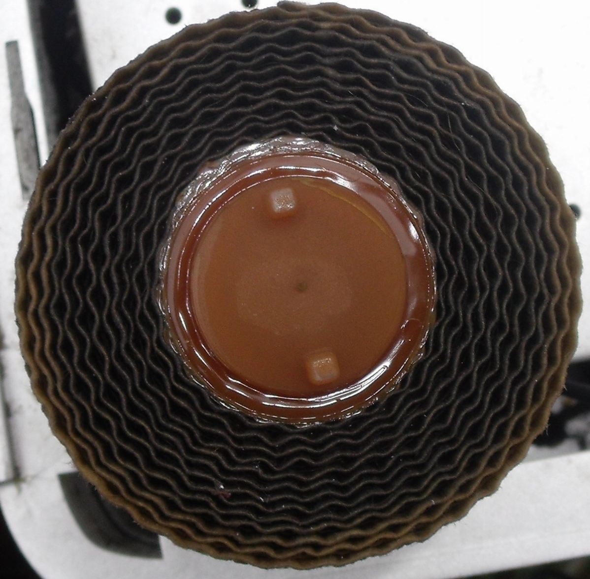

                          Also took some photos of my old fuel filter inside, as contrasted with what a new one should look like. It was pretty bad. Car is running much better now, unsurprisingly.
ID:	323459Click image for larger version
ID:	323460Click image for larger version
