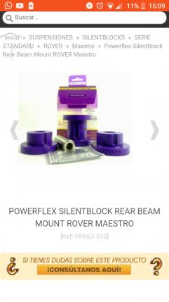

    Does anyone know if it is valid for montego?
    Click image for larger version  Name:	Screenshot_20171029-150950.png Views:	1 Size:	14.2 KB ID:	323215
    Yes, it will fit your Montego, they are usually easy to change too, just one bolt to take out at each side.
      Ok, thanks you doctordiesel77

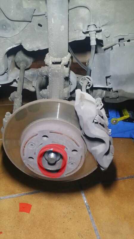

ID:	323233 hello, I have to change the transmission on the gearbox side, but I do not know in which direction the bushing thread turns, on the rear wheel on the same side I know it turns upside down, can someone tell me in which direction the thread turns lead?
          On the front everything turns the same way.
          The only nuts on the car that are left hand thread are the one on the back wheel that you already know, and one inside the gearbox, that you might never meet
          John
