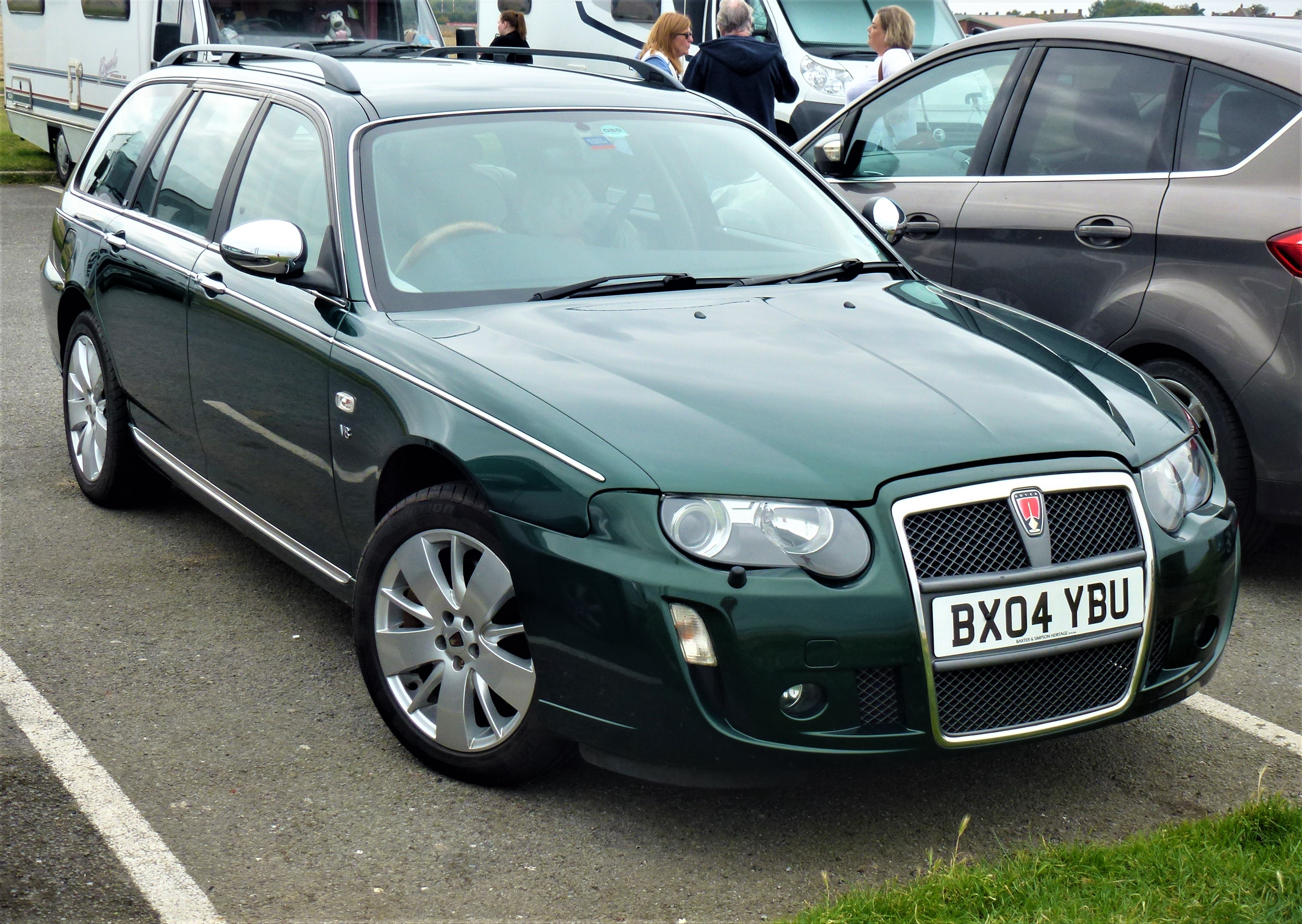

                            Yes. One of 8 RHD connoisseur se built. It was the first production V8 Tourer built and the only one in BRG. It was the factory's car. Currently 19800 miles.
