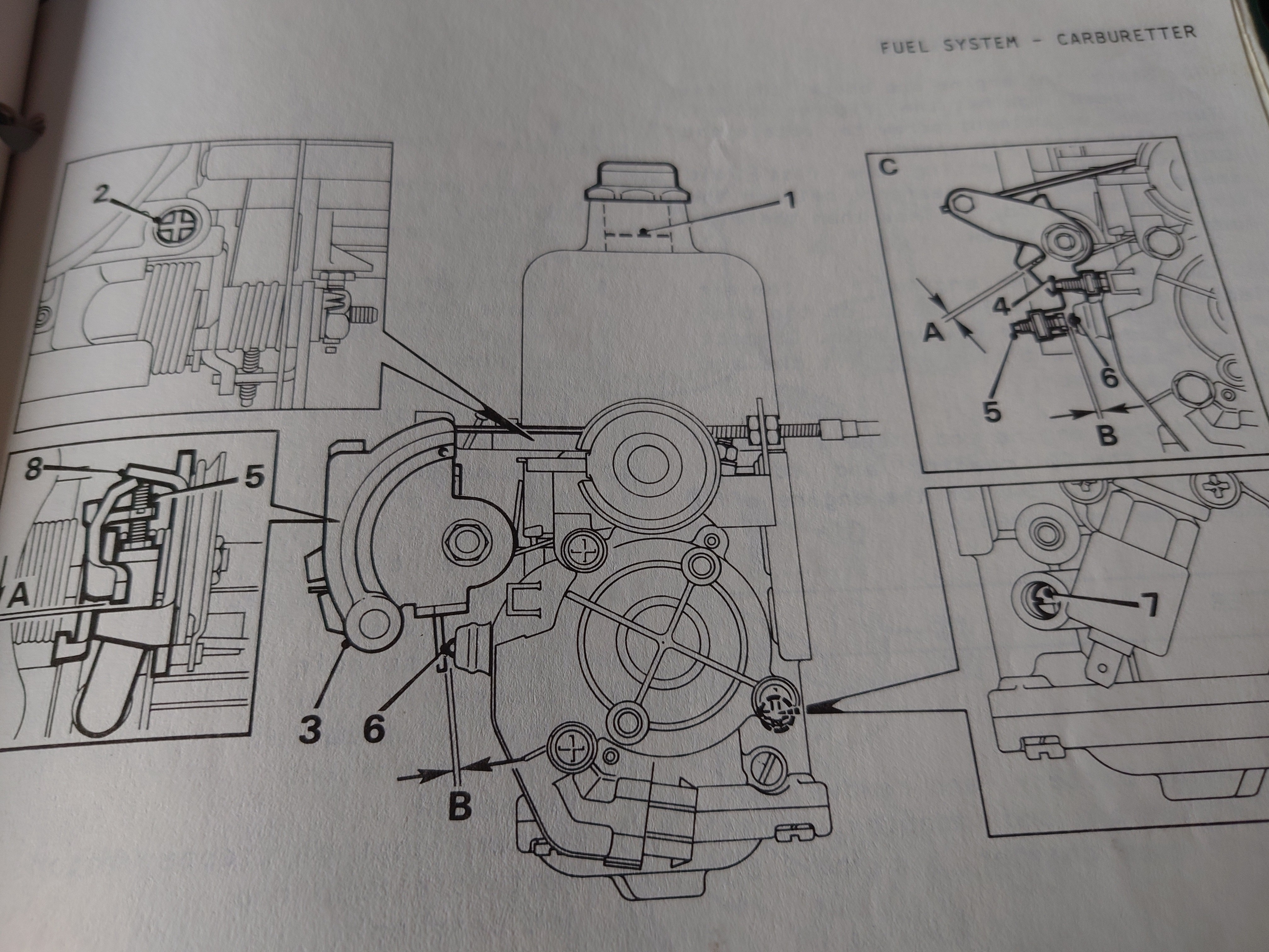

        It's a bit complicated typing it out so i will take pictures of my manual and post them up for you.
          First parts
            Next parts
              Last Parts
                If you can't read anything or don't understand let me know
