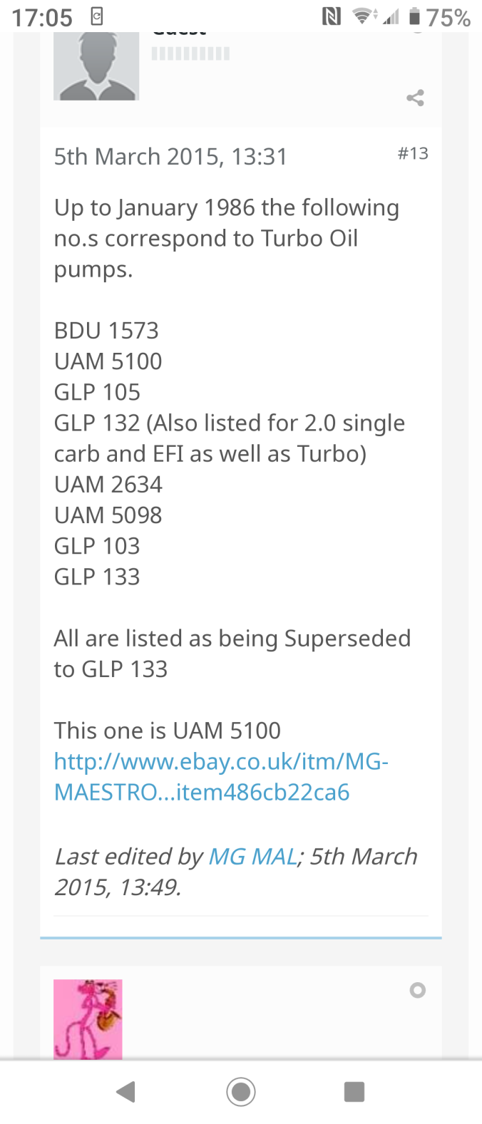

      In Rimmer says the pump UAM5098 is for T series but I read in a post that the pumps are the same in O series and T series. It will work correct in my montego turbo engine?
        Whats the engine number? And here have a look
          I took a look at that post but i want to be sure. The engine code is 20HC85. Thanks you
            That's not the engine number, should be on the plate on the top front part of the block
