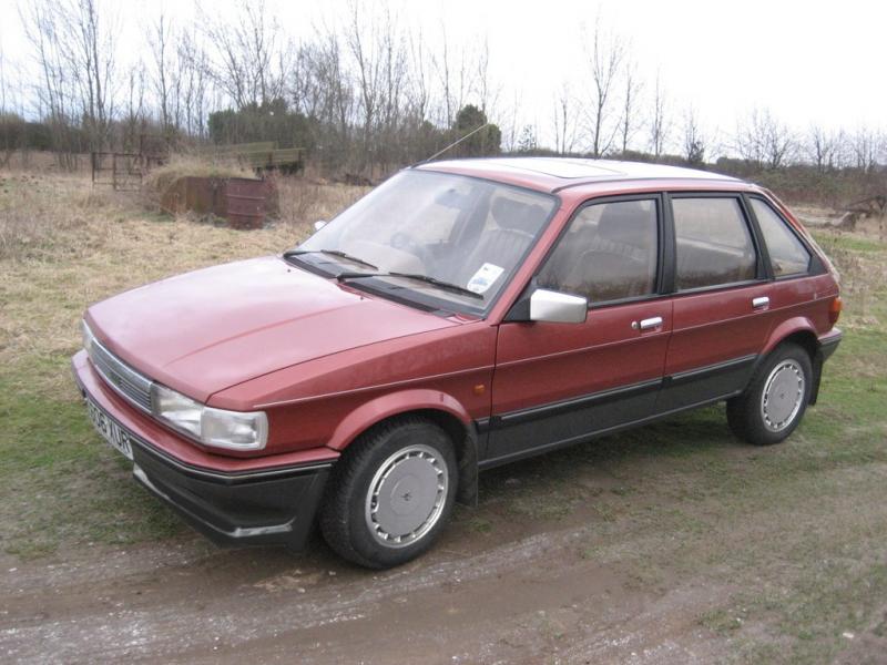

                    • #40
                      Thanks for that simon, is that your car? Looks good, where did you get those decals from?

                        Whats the latest on this mate?
                        • #42
                          Aha, yes there has been some progress:
                          Ages ago the head was removed and on closer inspection the oil seals were literally burnt away on the valve guides so a full head set was ordered, head refaced and a rebuild:
                          Head is back, all shiny and ready to fit. Got head bolts and new shells too. Even though the head was in fairly good (although dirty) it was far from flat so it was skimmed.
                          Then After much deliberation I decided to go for new pistons as the bores were showing slight wear. After much waiting Vic sold me his old forgies from Mental for a good price so a rebore and bottom end rebuild has taken place there too!
                          I have a stainless exhaust from Evo Al who did me a good price, so I am well on the way. Engine bay is empty so I can press on when work allows.
                          Stripped down and a lick of paint
                          So I have the block at a friends lockup under a sheet waiting for the right time, as you can see the oil pump was stripped down and rebuilt, rebored out to 86 mm for vic's old pistons with their old war wounds! looking good! I will have to sort this out soon now as I don't have a car at the weekends now as I have people selling for me now! Deffo need a second car.
                          I am going to use the old clutch, as there is a few miles left on it, so apart from some Mgf wheels as I have decided the Countryman deserves the Cross spoke wheels. I think I am ready!
