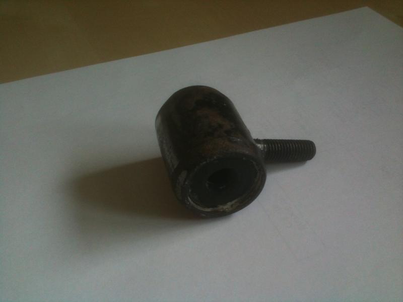

I was also looking for this bush. I couldn't find anything, except the VW Golf parts that have been mentioned in another thread which I did not want to use as they don't quite fit (slightly too large). I opted for re-using the outer case, after burning out the old rubber and extensive de-rusting and re-painting. For the internal rubbers, I ordered 2 x SPF3786-10 from superflex.co.uk at £9.78 + VAT each. They are too long for the outer case, so I cut the end off with a hacksaw. The ends I put to another use on the vehicle, so I used the whole bush. I managed to get the new rubbers into the outer case with a vice, and extensive use of red-rubber grease, after filing the ends to give them a slight angle. So far, so good. They seem to be flexible enough to allow the anti-roll bar to work, although the rubbers seem pretty stiff when you put them in. Also a lot of money saved I think.LPG Converted Montego 2.0gsi 1991 - are there any others?
Originally posted by Doctordiesel77 View Post... that part number did not seem to come up with anything on superflex web site though.......
Incidentally, I just remembered I did not use a vice for that particular bush. I tried but failed. I had to use a large bolt, washers and large spanners each end to get the bush into the outer casing. That one was stiff and I only did it after bevelling the ends.
The bush I got was an off the shelf product which fitted perfectly, apart from being too long. i.e. 32mm outer diameter, 10mm internal diameter. I should imagine that to make a bespoke product would be considerably more expensive.LPG Converted Montego 2.0gsi 1991 - are there any others?
